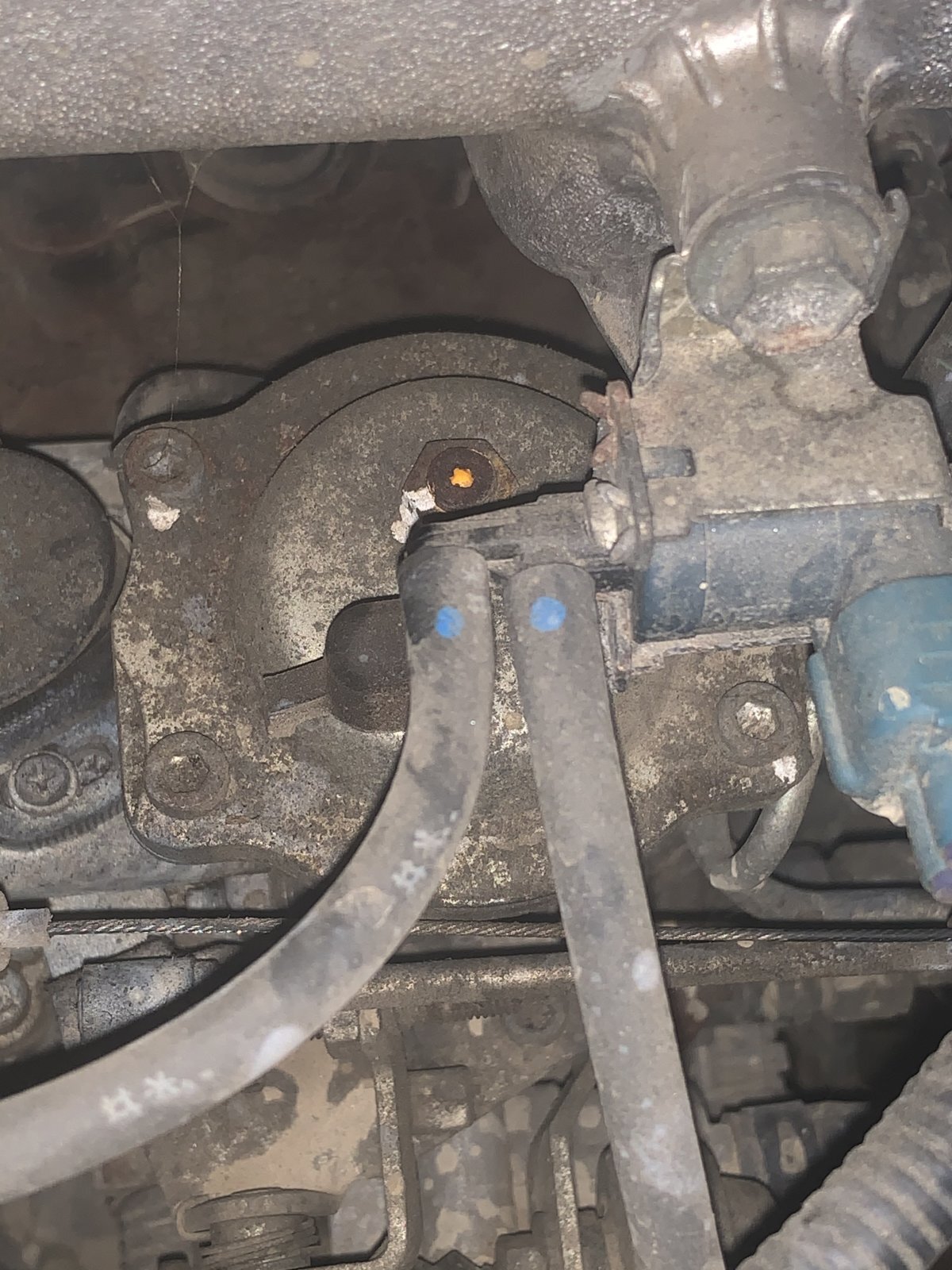

Dose the top of the injection pump look like so?
Looks like it has got one
