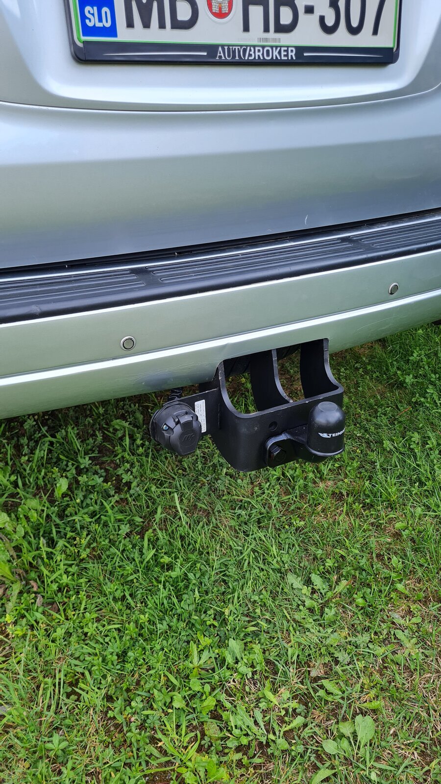

Got one! :)
Success !
Same as mine, but I see they went for the easy option with yours and cut a section of bumper away instead of slotting it. Still does the job though.
Did you get it from a towbar fitting place in the end or wait for Toyota ?
