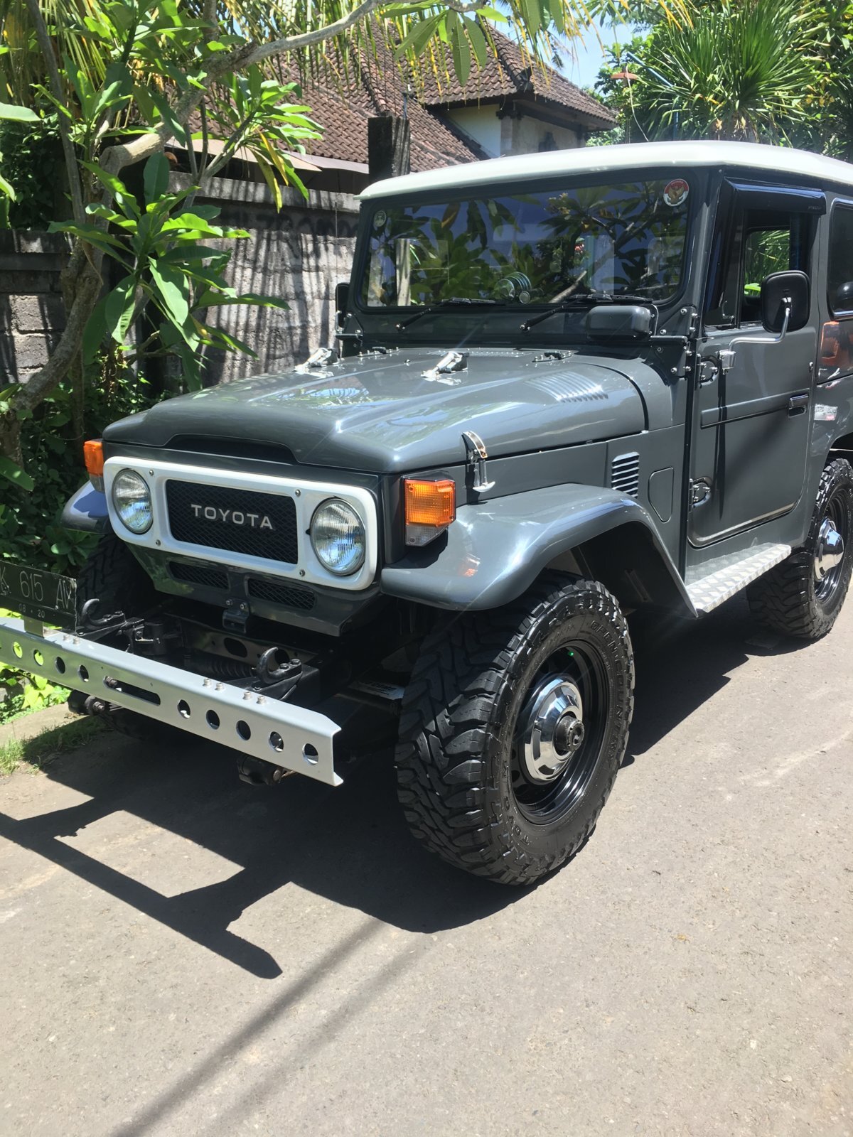

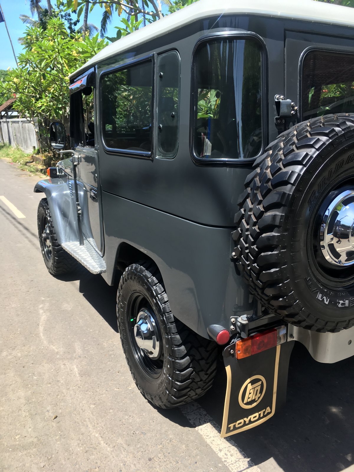

    I am considering purchasing a 1981 FJ40 Cruiser. This one has a 3 speed transmission which I thought was only limited to older models or am I incorrect?
    The car is in A1 mint condition inside and out.
    How sort after is the 3 speed as opposed to the 4 and what could I expect to fetch if I sold it on.
    I will be importing it from Asia to the UK

    Hi and welcome to the forum. Wow! That looks lovely. Personally with no experience, I would keep it stock as the nearer it is to original the more value it will retain. Jmho.
    What sort of cost is this going to be if you don’t mind me asking?

    Hi and welcome... Nice looking truck (US spec by the indicators) but the 3 speed gets alarm bells sounding for me....
    3 speed was linked to the F engine and that combination ceased production in 1974.
    74 onwards was 2F with a 4 speed - different bell housing, clutch, hand brake position, etc.

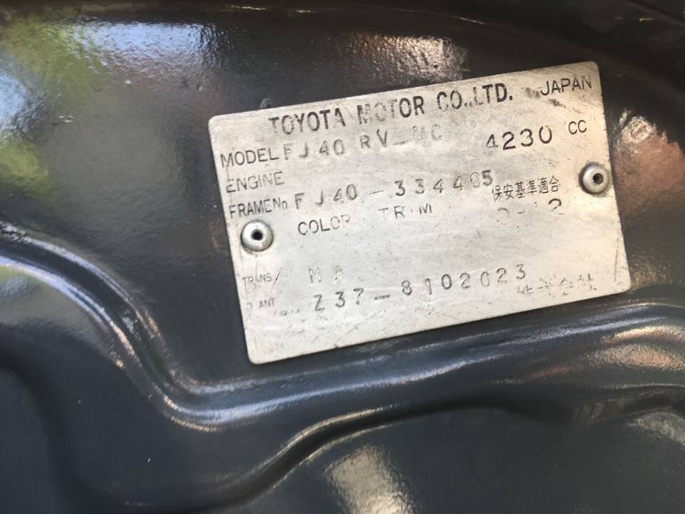

    I think you need to get them to send you the VIN plate details and a photo of the same, then we can investigate exactly what it is/should be.

    Hi and welcome 3speed is not right and the indicators r not 40s but it is a cool looking cruiser it's a big :thumbup: from Tony it's a 40s.

    So attached is some documentation they had with the VIN. I tried to search online but im not sure if I was doing it correctly.

    Having run the VIN number, it is quite interesting...
    Between 80-82 they build some FJs with either 3, 4 or 5 speed g/boxes and although designated as General, Europe & USA no 3 speeds went to the USA. Your vin designates it as a RHD. All of these were attached to 2Fs so you should be able to track a 4 speed box for it - maybe in France or Germany as they had a load of 2Fs. It appears that the 3 speed was a limited option for those 2 years.
    The indicators are not right for the year nor is the position of the bonnet locks. The indicators look more like 70 series (early) but I'm guessing.
    I wouldn't think the 3 speed is worth much because I don't think it will fit the bell housing on an F engine, pre 74 and it suggests that it is limited to those 2 years 80-82. But it also suggests that the 4 or 5 speed were specific fitment to those years so some measuring and research would be necessary to get the right 4 speed box. Somewhere I have the ratios so I'll try and find it check if it was specific to those years, etc..

    Nice looking 40 and learning a lot from the replies. Agree the indicators look like 70 series but easy to swap. Is it me or does that VIN look tampered with.. the 4's look added?

    All too confusing for me. So it is an FJ then? With a 3 speed box? Still looks lovely. Drop a nice 80 series 4.2 auto in there and I think I'd buy it!

    Yes Chris it is a '81 FJ40 with a 2F (4230cc) and a 3 speed box. Without some serious checking, but I think that combination could be quite rare.
    The 4s do look odd but my vin plate is similar - stamped without guide lines - and mine also looks like it was created by a operative who had too much saki at lunchtime.
    If you are going to mount the correct indicators (originals are no longer available but there are some replica ones) and move the bonnet clips to the right places then there will be a couple of small holes to repair so make sure you get the correct paint code and type with the truck info as this is not, IMO, a stock 40 colour.
