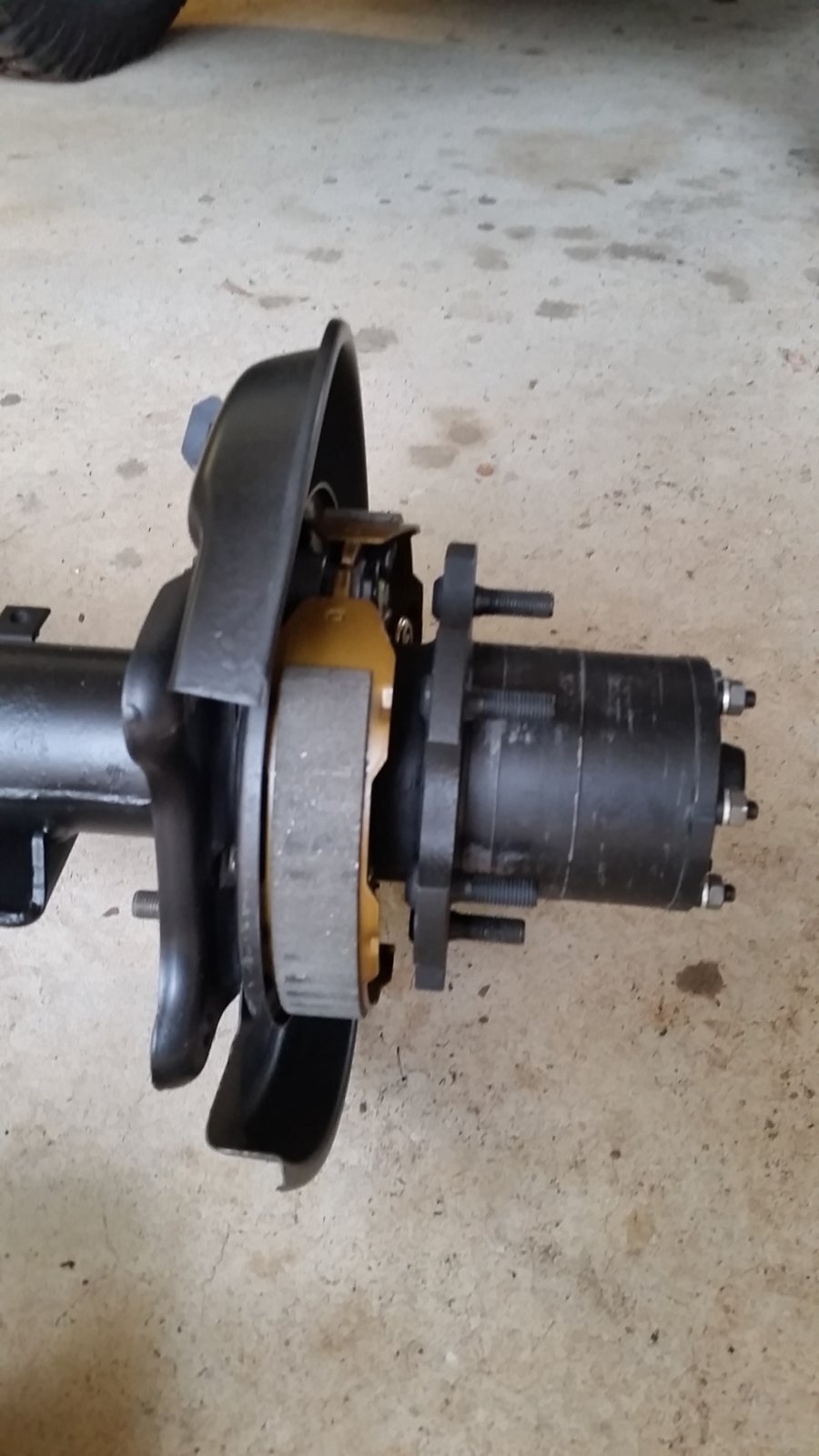

The rotors on both sides were very rusty. Lots of crap in the hand brakes too. I cleaned everything up with a wire brush in the drill and then etch primed and painted with Satin Black Metalshield. Should offer some protection.
I bought a heap of parts off ebay and from Repco. In a cruel twist of fate only the repco parts were wrong so the brake rotors have to go back. Assembly begins:
I saw a cool post on using old bearing races with a slit cut through them to seat the new races. It worked really well.
once the races and bearings were in it was time to put it all back together.

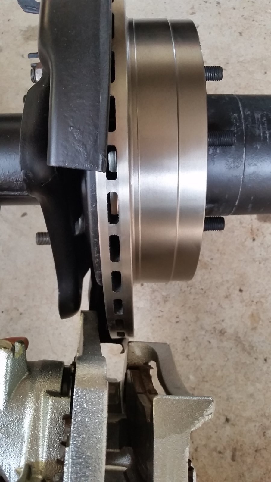

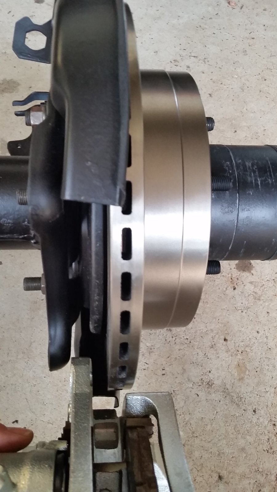

I finally got the right rotors, 68mm total depth. Now I'm really stumped. I can put the rotors on but can't get the calipers
in place. I've compared calipers and they are identical to the old ones so that's not the problem. I've looked at the Toyota rear brake rotor catalogue and the next size up is 103mm depth which is too much. I'm thinking that the hub/axle is somehow not seated properly? Could the oil seal not be seated properly? It was flush with the end of the hub... Is this possible? Any help appreciated.
