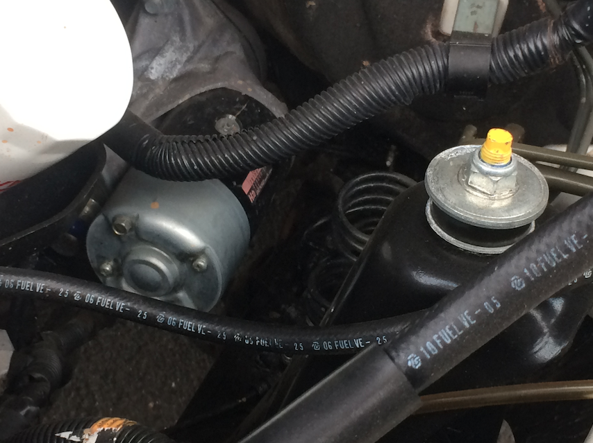

Just a couple pic from my 99" HZJ105 100 Series. I don't know what this part is and it seems to be leaking water slowly? Should it be plugged up?, help people? ID here would be good. Looks like some sort of valve.

ac condenser drain, though looks like you are missing a drain hose to the bottom

That's the complete and full A/C drain pipe. Just make sure to keep it open.
