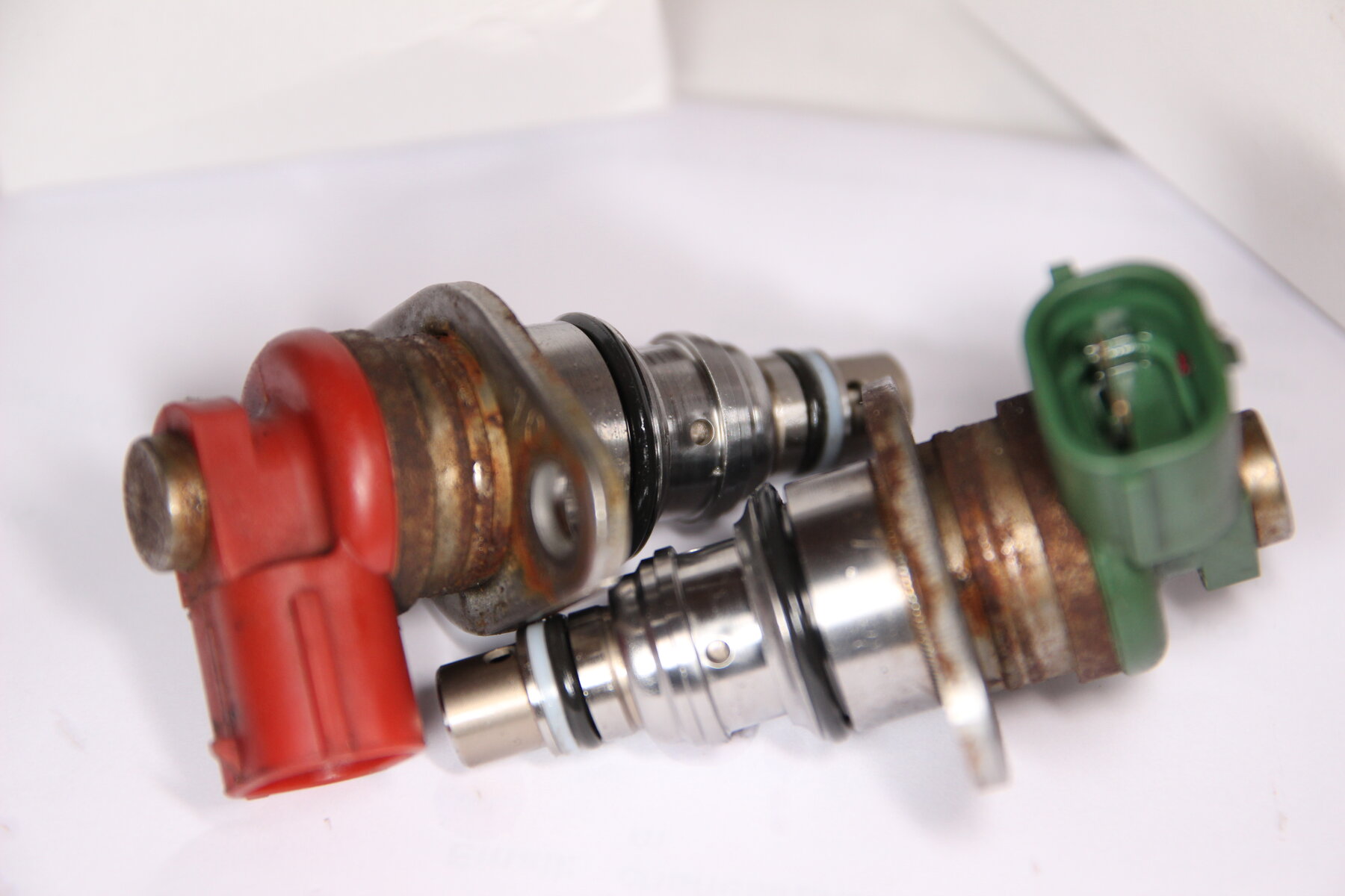

I had a look at these SCVs and came to the conclusion that Techstream is telling the truth.
The books says to pull the connector off and measure the resistance of the SCV, should be between 1.5 and 1.7 Ohms at 20ºC.
These were reading 1.2.
Suction Control valves are waiting for me at the Post Office, I'll pick them up and fit tomorrow.
Behold the cause of the problem.
These are the 'Suction Control Valves'. £168 delivered.
Took me longer to chat to a mate and have a brew than to actually change them.
I removed the air filter housing lower section to facilitate access, quite straightforward once that's out of the way.
The Colarado now sounds much happier, no hesitation and pulls like it should do.
