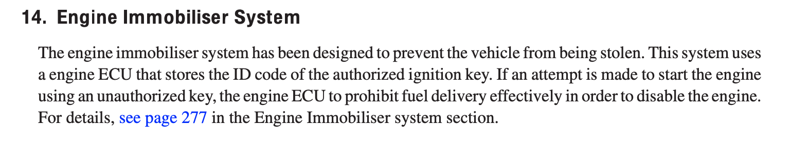

Look in the owner's manual for how the immobiliser works.
Attached 4 pages.
2001 90 series lit up a key symbol but i never noticed because everything lights up on the dash and goes out when the truck starts .
Bent key turned out to be my problem so computer decided it was an attempt at theft .
