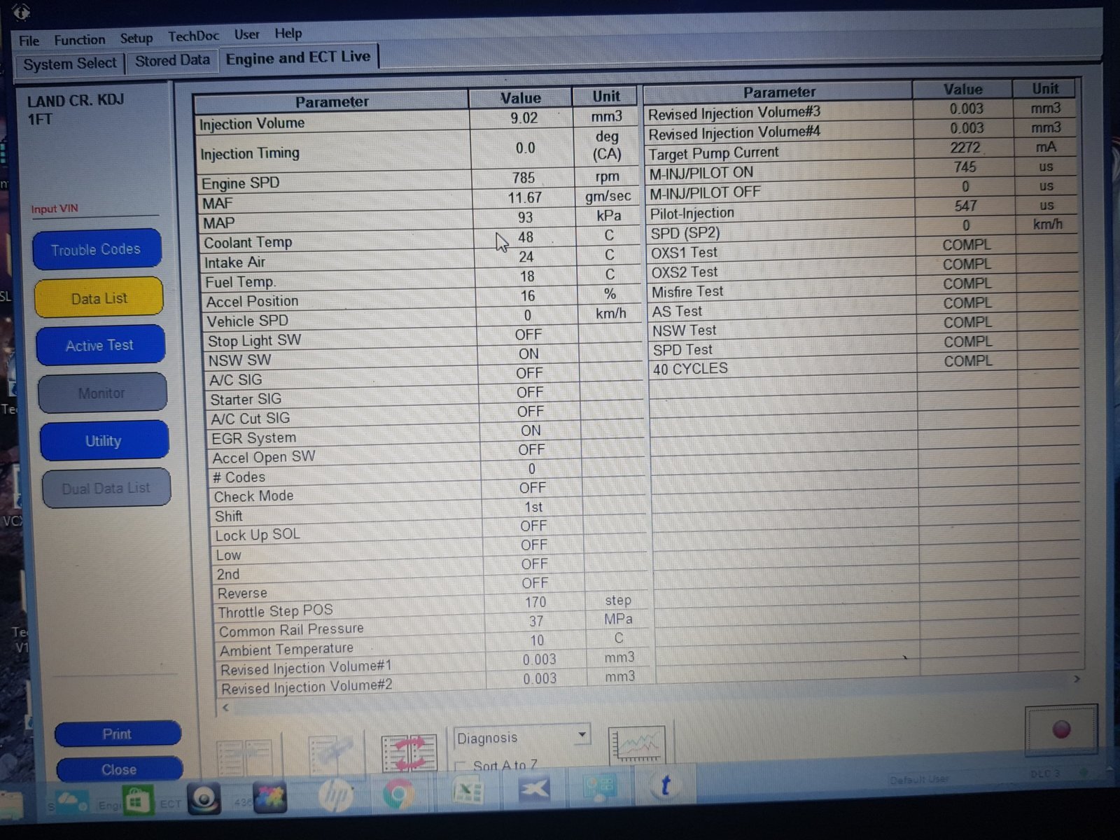

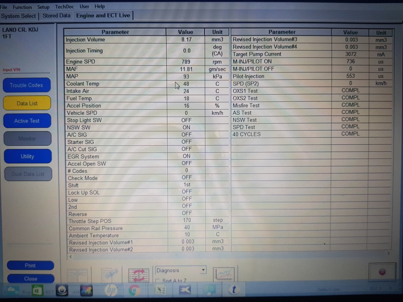

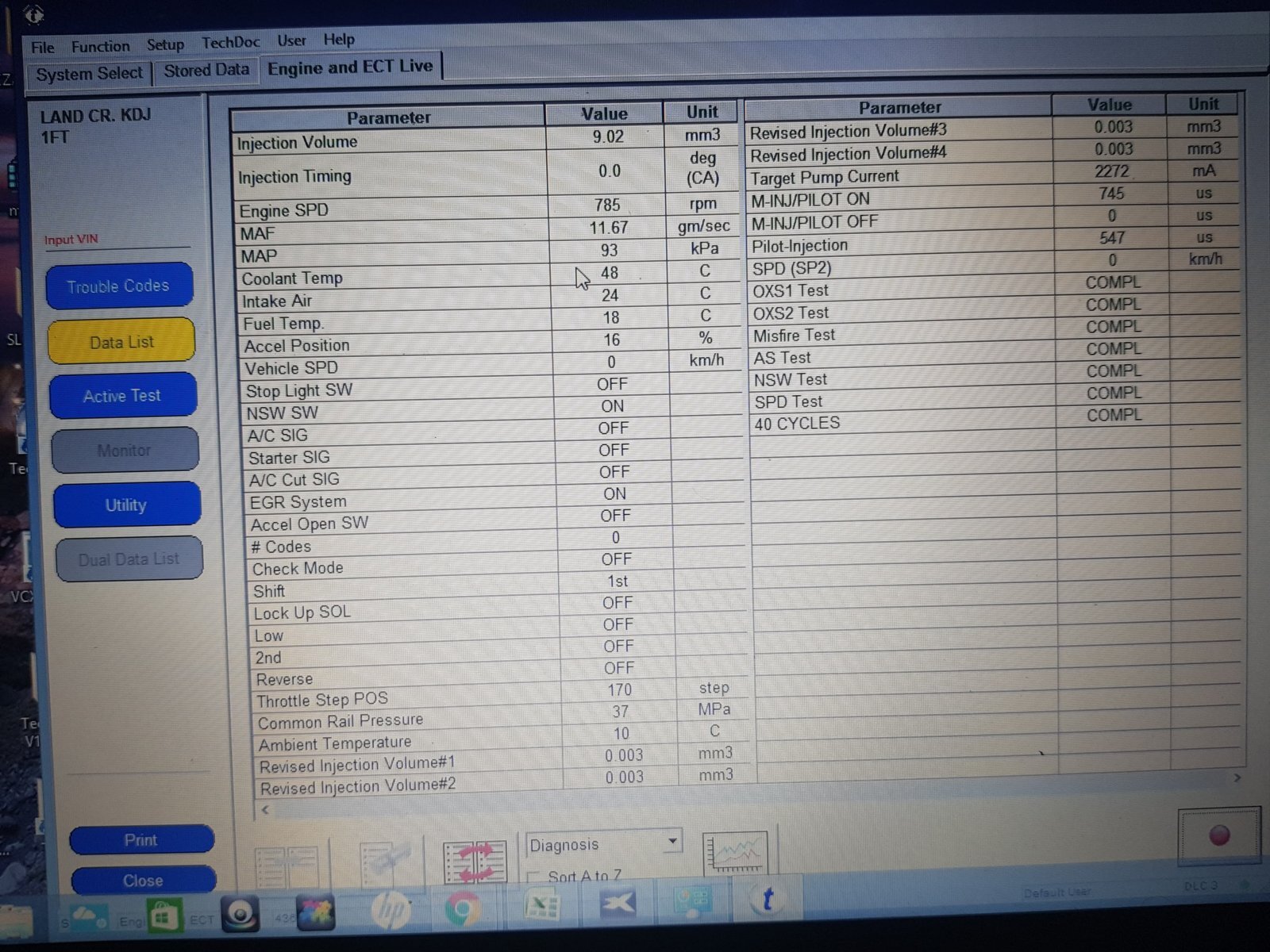

For some time I have a problem with error 32 (1) which notoriously returns and with slightly more loud engine work when cold. the motor is silenced when it reaches the operating temperature. I checked the compensation of injections and it seems that it is ok. What puzzles me is that all injections in my land cruiser have 2 pins. so how should compensation be done? I will add with code 32 (1) means at techstream fuel pump malfunction. Someone may have this problem and can lead me to the solution ?? I also shut down the techstream view. greetings.
