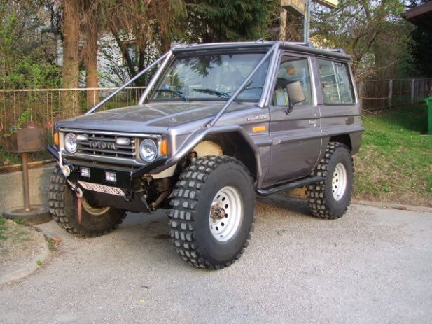

this is a 70 with what looks to be 37" tyres or bigger and I can pretty safely say is is standard height suspension, maybe 2"
http://www.njuskalo.hr/auti/toyota-land-cruiser-lj-70-oglas-4838233
