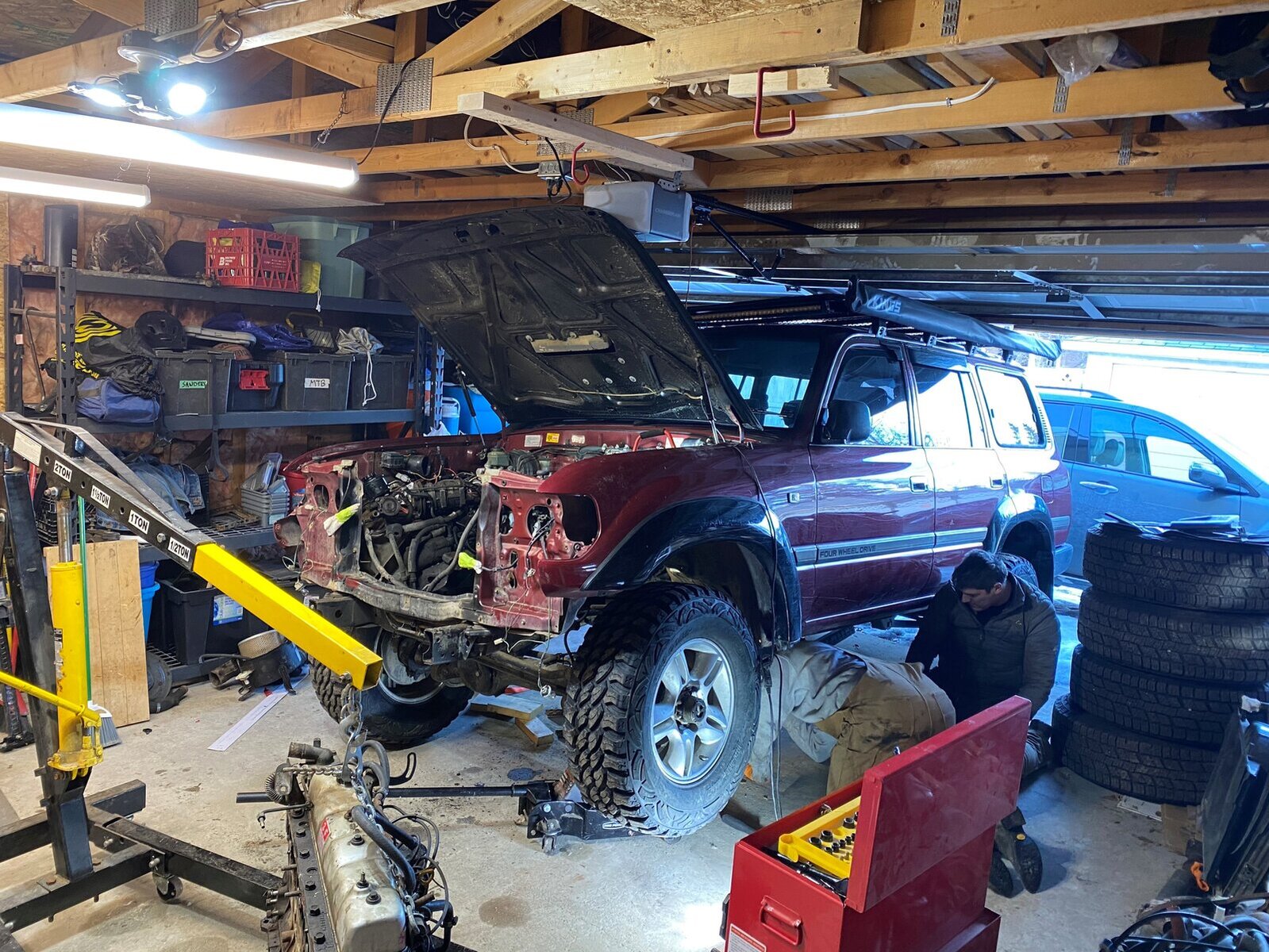

Howdy!
This is my 1990 Australian 80 Series currently with 3F motor. I shipped it back home to Canada (Alberta) and that carb does not like the cold temp and higher altitude. I was able to find a 3FE to swap in for more reliability. I was hoping that there was some information or tips on a swap. I searched the forums and it seems like the majority of users are swapping in diesels.
I also have a garage with relatively low ceilings and was wondering how much clearance is needed to pull the engine from it. Will the whole front end need to be taken apart?
Any information that can be provided is hugely appreciated!!

you wont need any more height than the 80 as you lift the engine off the mounts and draw it through the front of the vehicle. the centre of the front clip is removed. along with the headlights, rad etc.

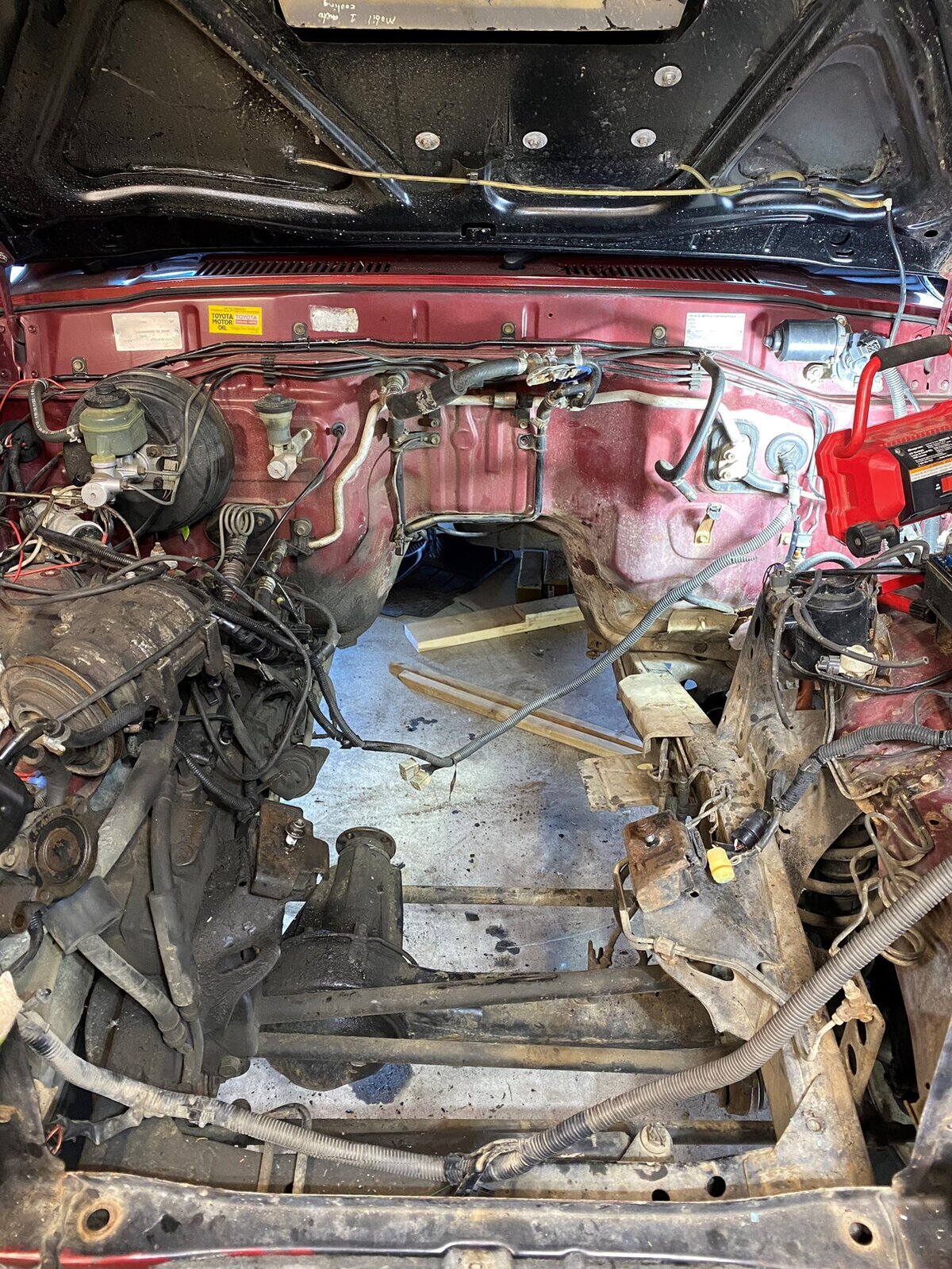

The old 3F is finally out! Ready to get going on the new 3FE now. Had a question regarding the fuel system. Currently I have two fuel tanks on the truck from factory.
Do they both operate as separate tanks, as in both have fuel pumps or does the reserve dump into the main? Wondering as I have to swap in high pressure lines for the new engine.

i vaguely remember the early carb petrol may have the switch over solenoids. so it draws from the sub rather than transfers the fuel to the main. the electronic injection engines transfer the fuel to the main tank.
have a look underneath, if there are two solenoids its the switch over set up. if there is only one and a pump, its the fuel transfer system.
