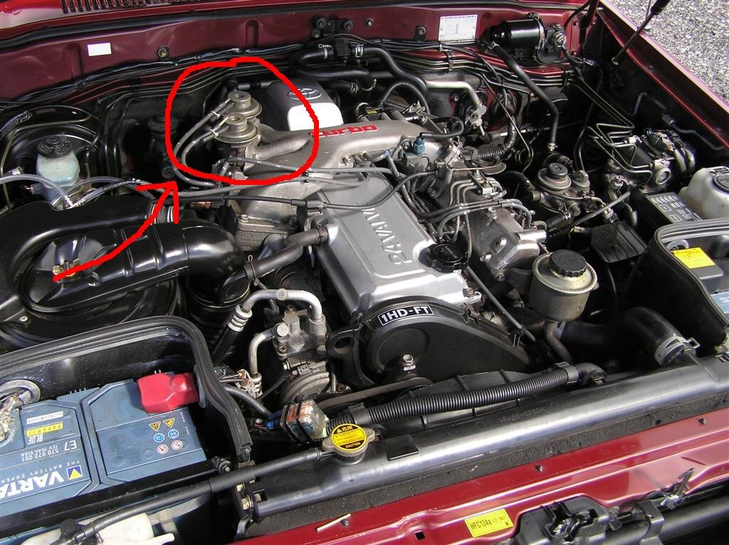

If it has EGR it'll look something like this..........

Only not usually as clean as that....
Thanks TP. No there's nothing like that on the top of my engine.

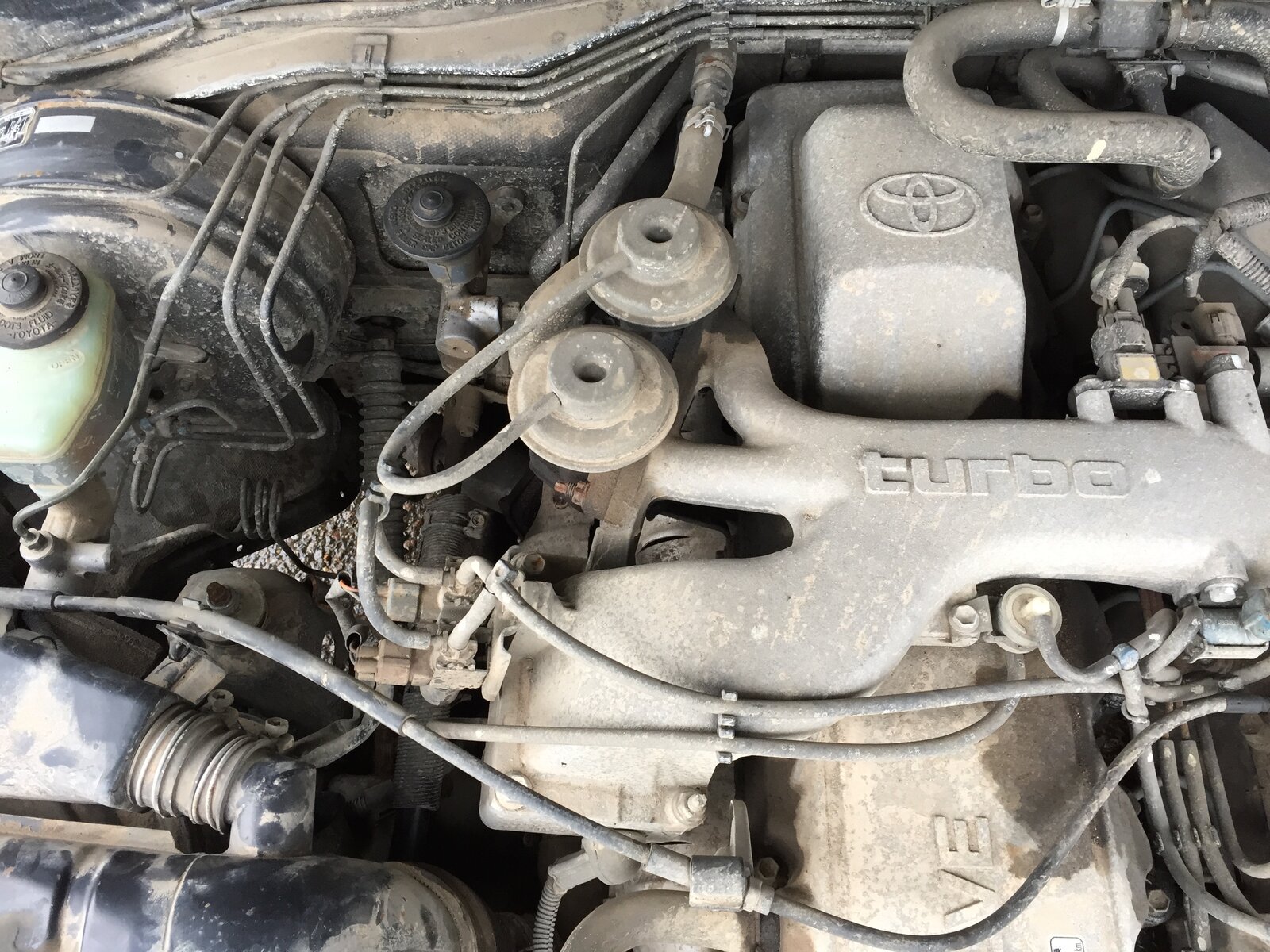

This is how mine is plugged in, not sure if its right or not.
Looks like yours have been disabled by disconnecting the vacuum feed. When working, the large metal valve assemblies should be connected to the small electrically operated valves just below them in the pic. Disabling them this way, if the large metal valves themselves don't seal 100%, there can still be some leakage of exhaust gases into the inlet tract. That's why it's probably best to remove or block off the valves completely. Still better than having them connected though! JMO
