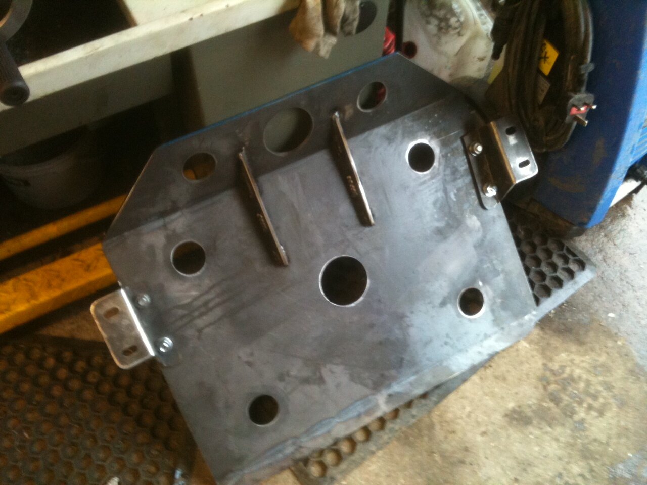

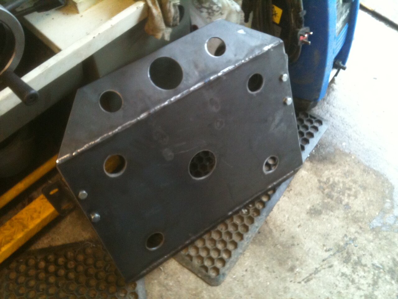

Now, I hope Karl won't mind me posting this, but as much as I desire one his most excellent steering arm guards, buying one for me would be akin to JW buying a ready made diff!! With a garage full of steel, tools and a burning desire to make stuff, I set about making a front bash plate this weekend. It's very different to Karl's and no, I am not selling them :snooty: It's 6mm plate and there is also a rear bracket not shown here yet. That stop the plate bending, or being pulled off when reversing in deep stuff.
[attachment=3:th0tlttg]photo 5.JPG[/attachment:th0tlttg]
The holes do make it lighter. It really did weigh a tonne. And they allow cooling air. I did mesh them over but it look horrible.
[attachment=2:th0tlttg]photo 4.JPG[/attachment:th0tlttg]

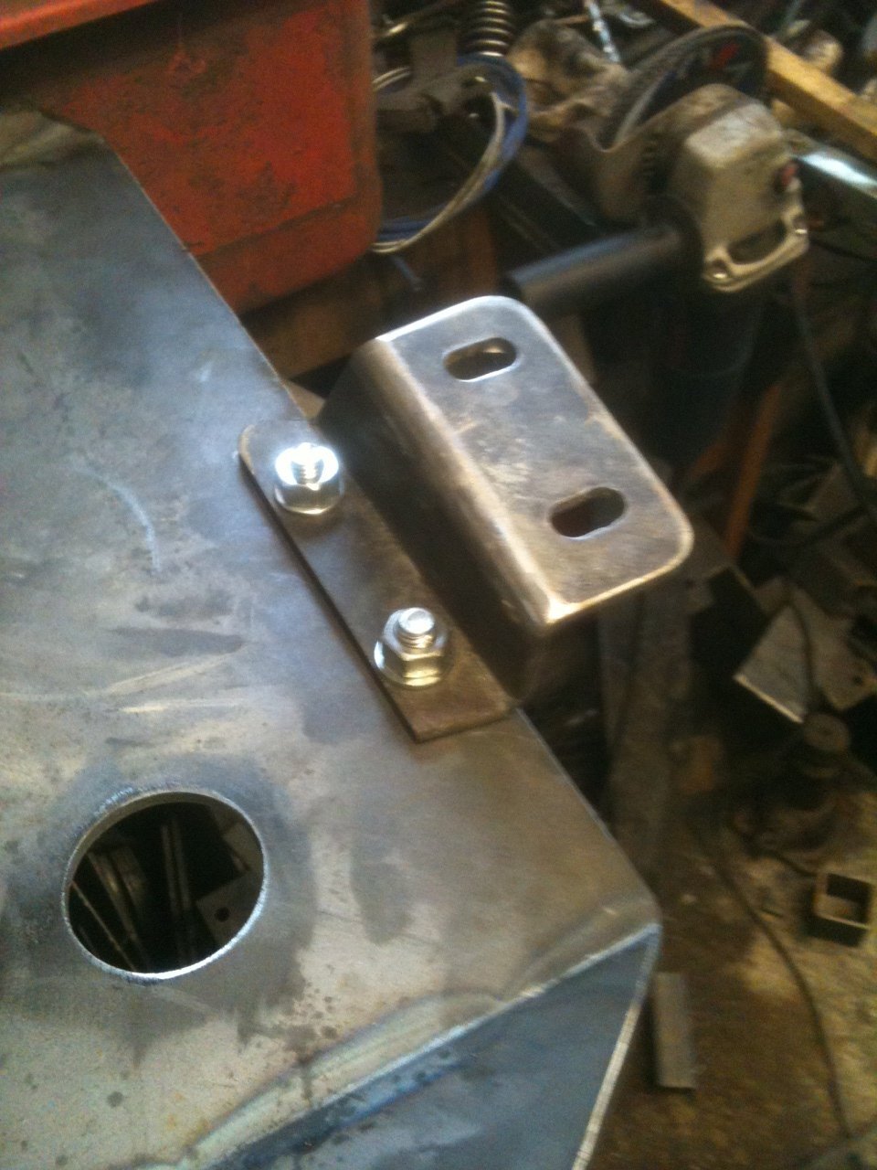

Brackets (ooh, slots! I love slots)
[attachment=1:th0tlttg]photo 3.JPG[/attachment:th0tlttg]

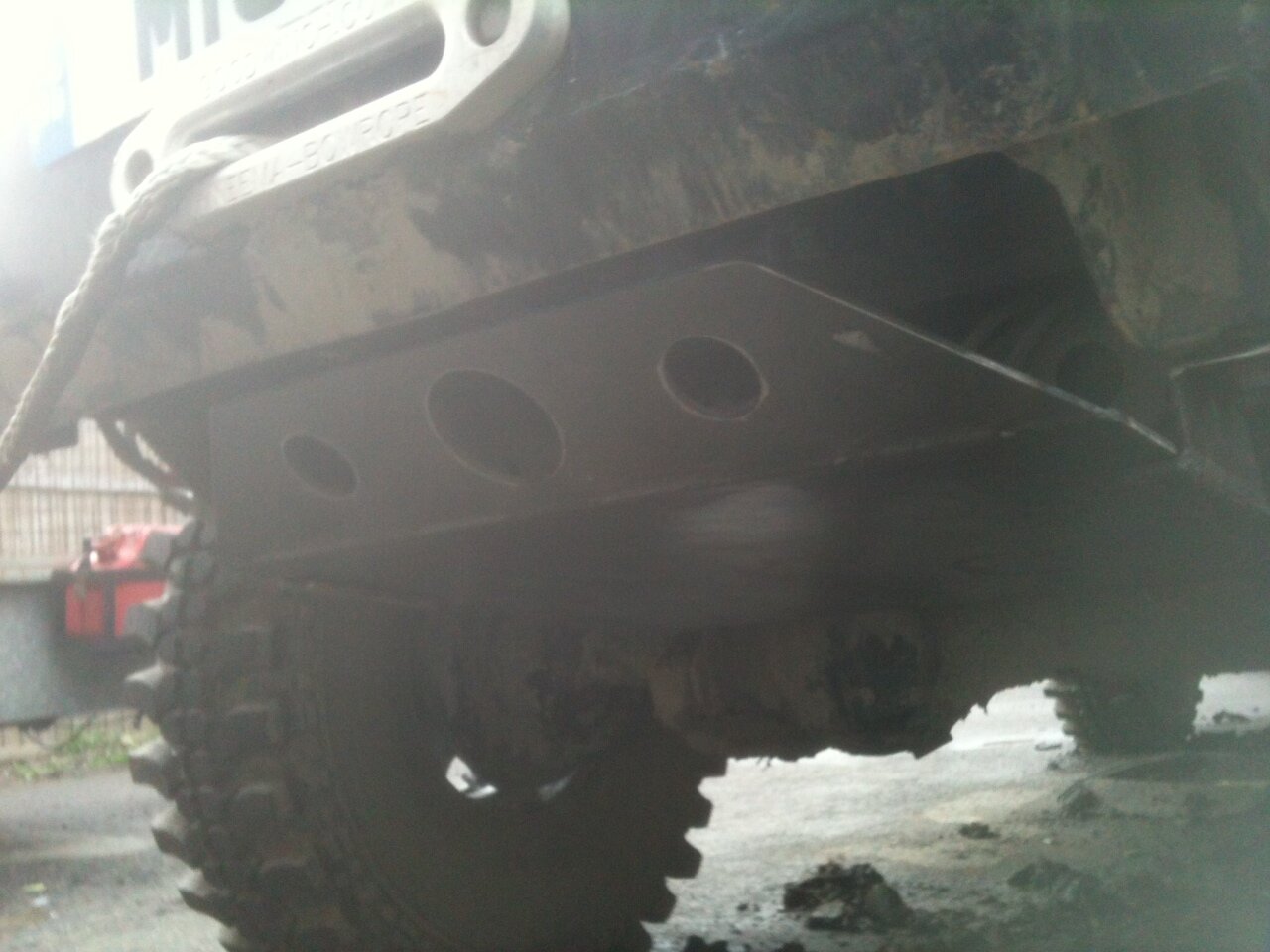

Offered up
[attachment=0:th0tlttg]photo 2.JPG[/attachment:th0tlttg]

Sorry Andrew - we must have posted at the same time. Missed your question. Well, the two front holes mount onto the towing eye points along with the front winch bumper so I had no choice but to go with 12mm x 4. The rear mount is petty beefy and made from 50 mm equal angle and some 12mm flat. There is an adjusting slot between the two naturally which is held with 2 x 10mm bolts. The main purpose of this is to withstand compression if I hit the trailing edge. No point having a big plate if all it does is crumple into the steering arm it's designed to protect. However, when you reverse up in thick goop, it's easy to rip a plate off. OK so mine has pretty good ground clearance on its 37's, but it's possible to get stuff lodged in there. At present the mount is held to the cross member by 8mm bolts into the same threaded holes as the original tin plate was mounted to. There is a small kick in the back of the plate so that in deep mud it should tend to climb rather than dig. There are other assorted holes under there which I may pick up on once it stops RAINING.
