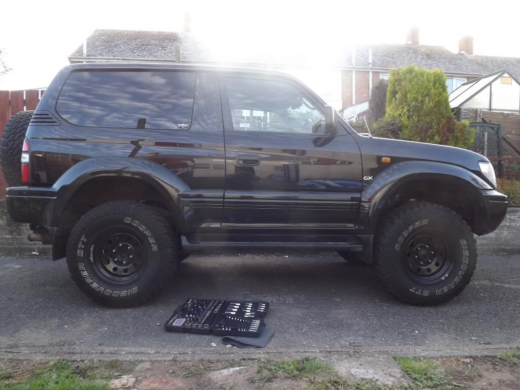

Body lift is fitted and i have mixed feelings about it , i'm thinking tyres need to be bigger and my once extremely light steering is now much stiffer . I've heard this can cause problems but i can still steer with a finger and thumb gripping the wheel so i'm just gonna hope ,without much sincerity , it frees up a bit with time . Front bumper will need some tweaking to fit properly as will the back . Gear and diff stick are fine as i only went up 40mm and so is the rad though the fan guard will need some brackets made up before it can be refitted .
Looks good ..... but i can't help wondering if it looked better before the lift ?
Nevermind its done now i will get some pics up tomorrow after i've refitted the sidesteps .
Changed my mind , sidesteps are on and all my doubts have gone :icon-biggrin:

Believe it or not Andy the lift only added about an inch but visually the change is dramatic .
