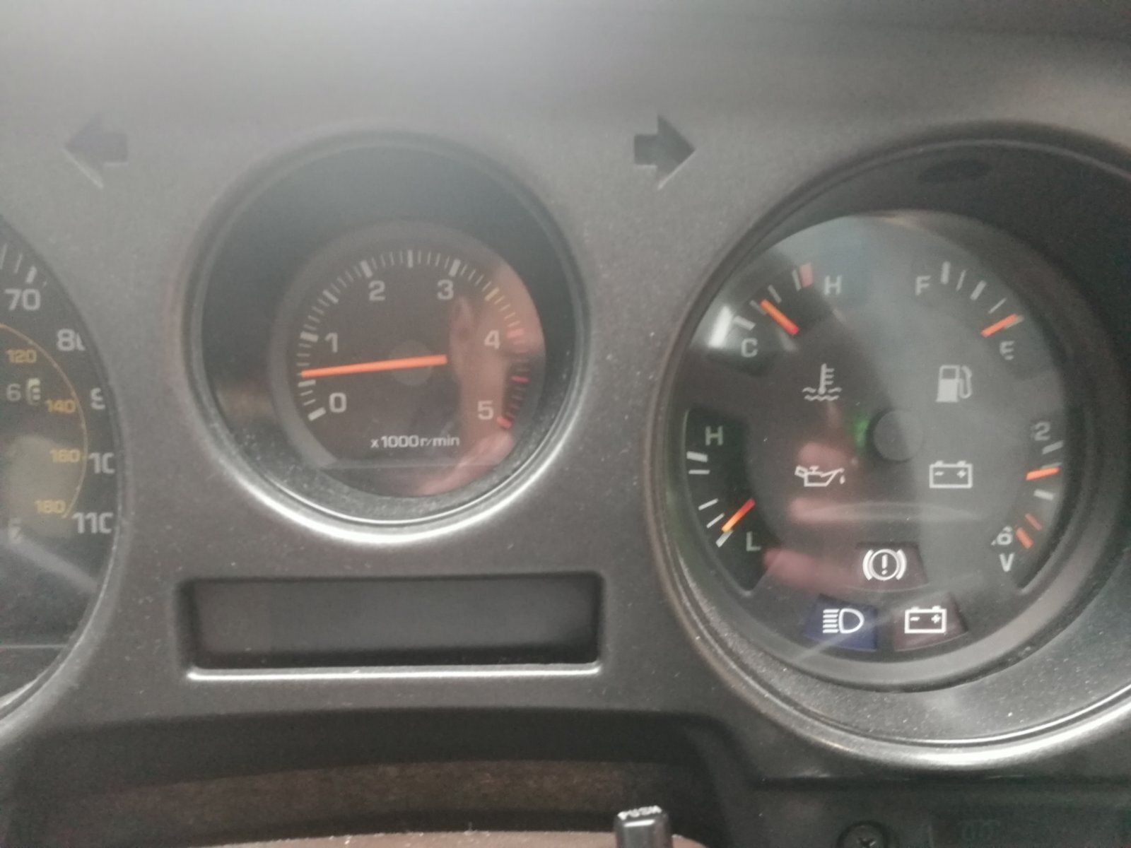

Hi Nick,
I had 3 60’s in a row back in the 90’s, I have a 100 now but I do miss the 60’s, re, the oil pressure, Toyota oil pressure gauges are notoriously inaccurate my 100 reads low, if I were you (for peace of mind) I would fit an in-line oil pressure gauge under the bonnet.
Steve.
Hi NickThanks Steve for the tip.
I was actually planning on doing a pressure test before installing a mechanical pressure gauge on the car.
Just as a matter of interest, what was the oil pressure like at idle on your 3 60-series?
Nick.
Hi Nick
My gauge (HJ60) reads at the first mark when its warm and idling at about 700rpm.
At 45mph it reads at the sevond mark then slughtly over rhe second mark if going faster.
The sender is down by the starter motor and may be covered in crud. Worth cleaning off the contacts, probably wont change things as it would likely just fall to zero if bad but something to rule out.
I am also planning to upgrade to a new pressure gauge at some time once other stuff is taken care of.
Good progress there
Nick.
Hi Nick, when I had the 60 the oil pressure was the same as it is now, showing quite low. That said I thought the engine was sweet and so I never investigated
Let me ask a question, if like on a Colorado and a 120 there wasn't an oil pressure gauge would this worry be an issue?
Not far of my reading TBH, especially considering your car is idling higher than mine.

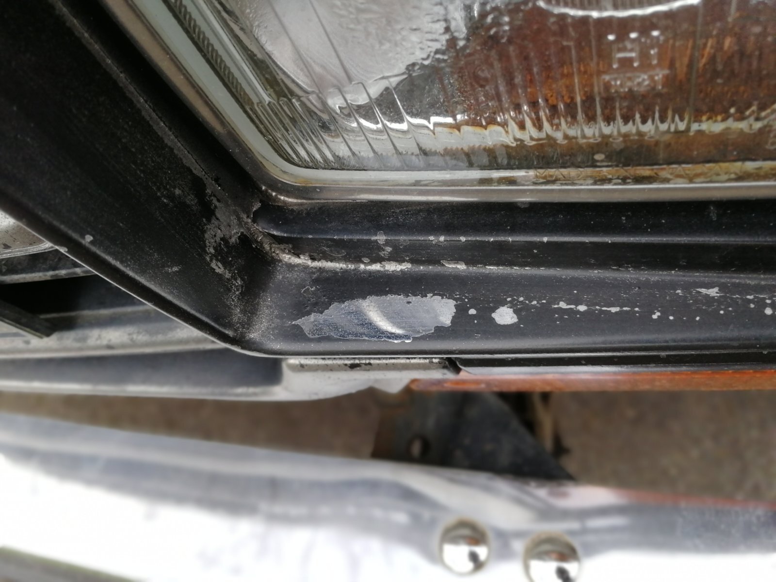

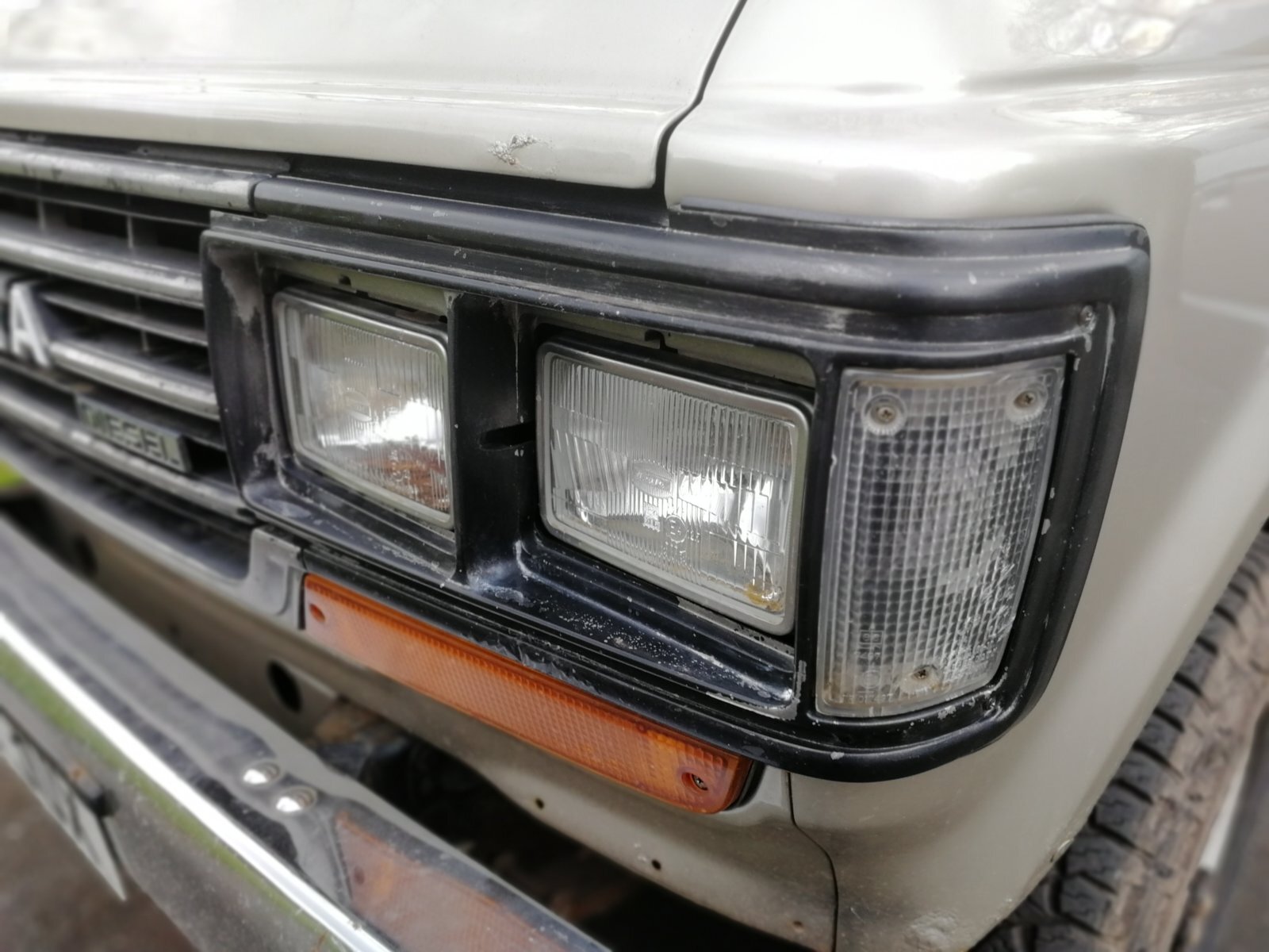

There is an amazing chrome paint on the market that fills and chromes, gives a proper finish, not cheap and as I’m on my phone can’t search for it at the moment.

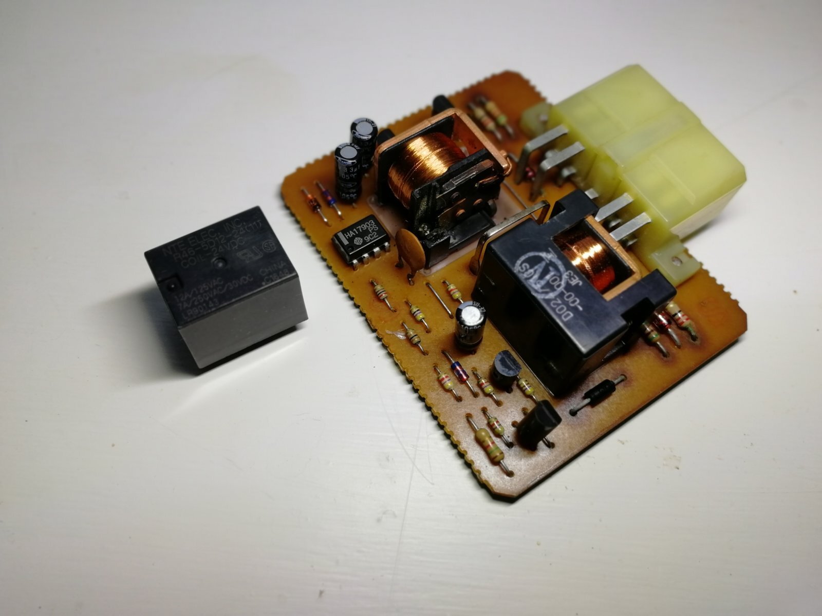

If you get stuck for any electric window parts let me know, I have the complete set I removed from my vehicle when I converted it to manual windows.
