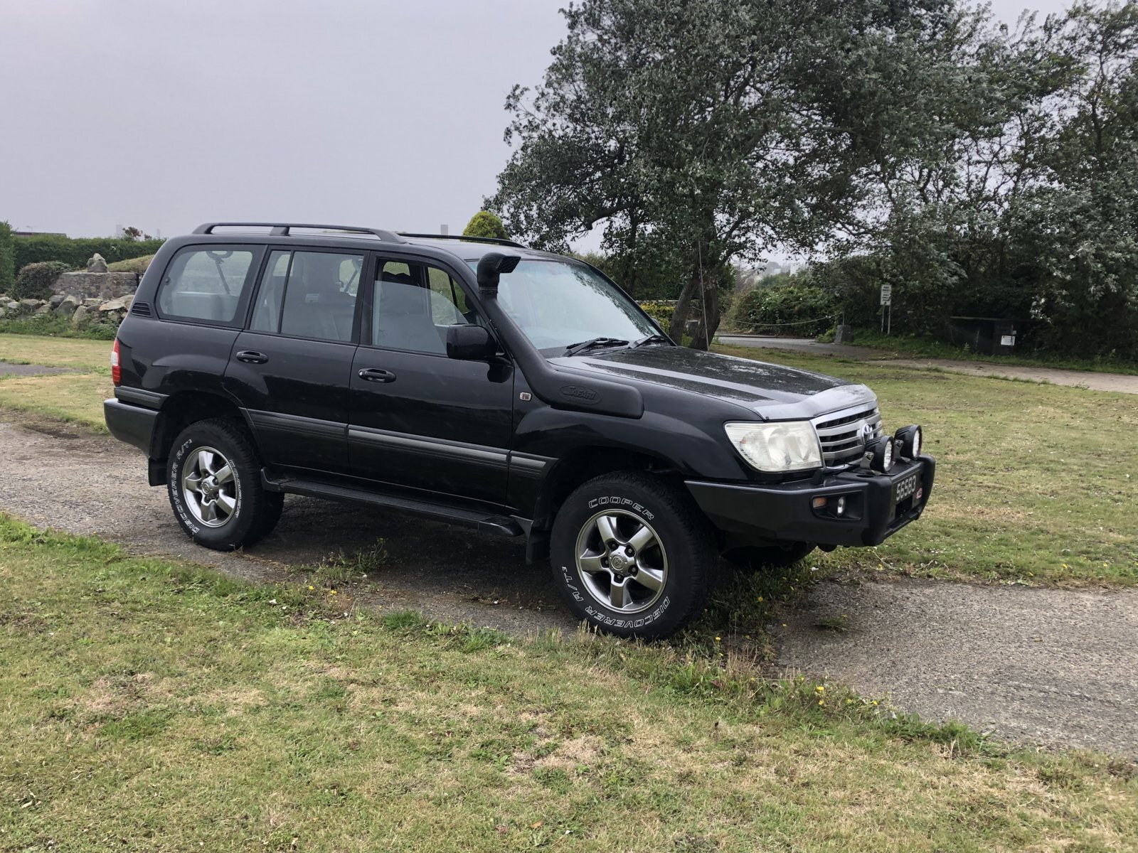

This is mine with 275/65/18’s and a 2” lift, I think 275/70’s would be ideal but tricky to source over here. I would also need to change the tow bar set up to hang anything bigger underneath.
