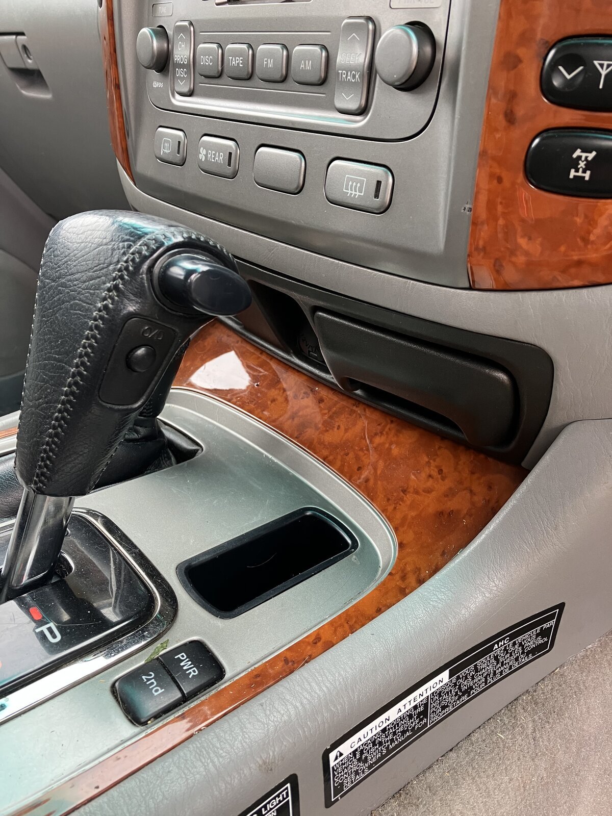

Hi Neil, if you have disconnected the dash AHC lights you could also take out the now defunct controls and add part number 58839 60040 IMG_0394.jpeg
