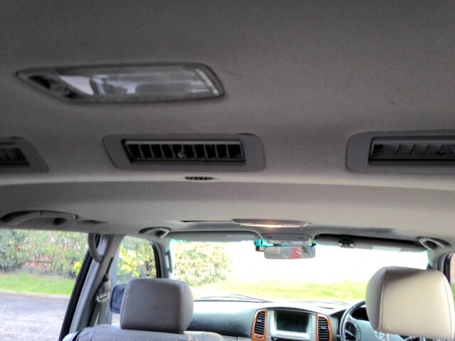

I've been sold a Black Widow cargo barrier by BOAB for my Amazon VX. I can't get it to fit and it seems the roof lining is too low where the barrier meets the roof. Where the barrier should meet, the roof lining lowers a few inches for about 6 inches or so in length, given it has rear vents & aircon / heater controls here (see pic). I presume the Amazon GX doesn't have rear vents etc and therefore the roof lining is flat from front to back, so the barrier might fit a GX. Can anyone confirm if this is the case ?
