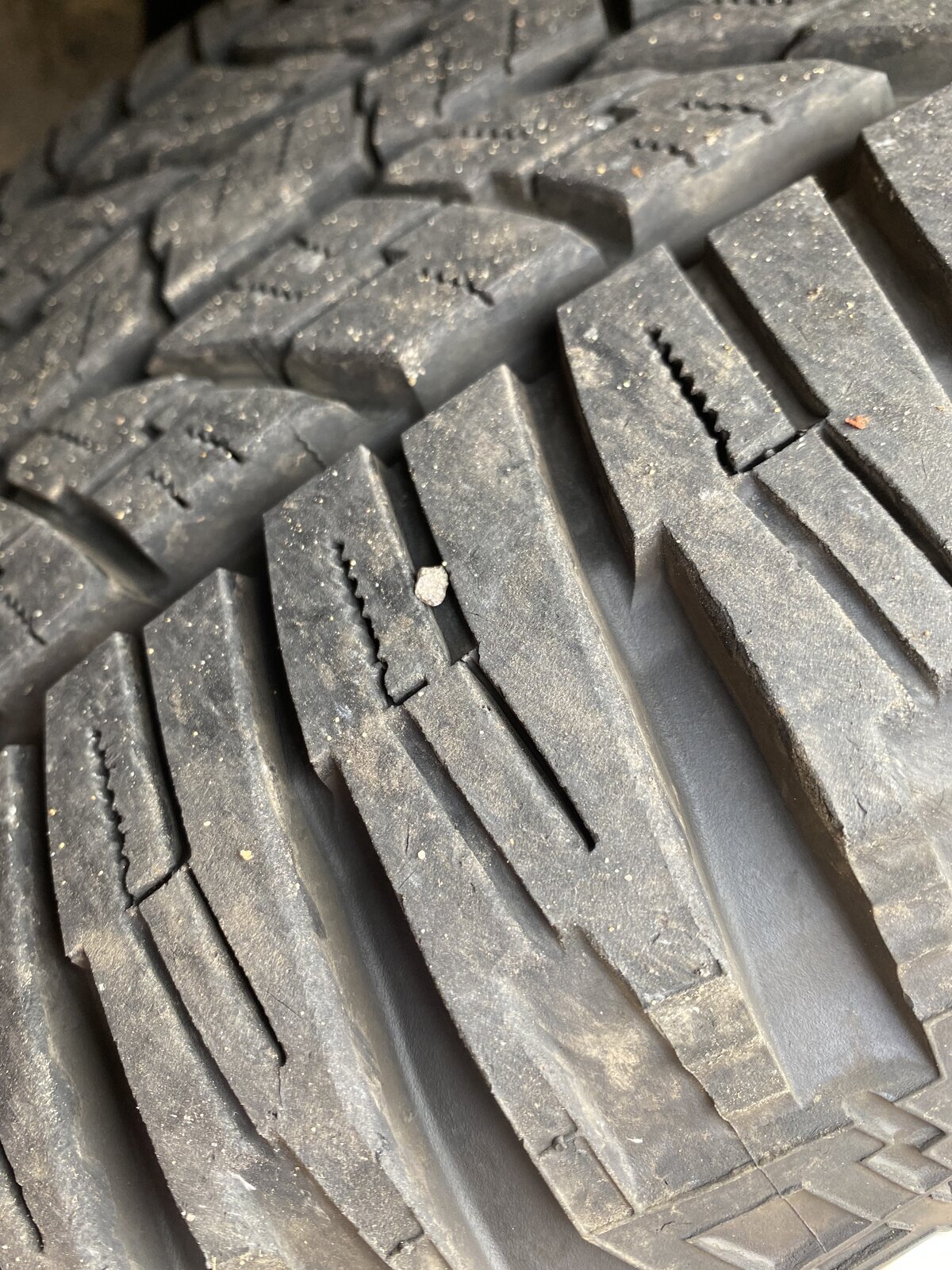

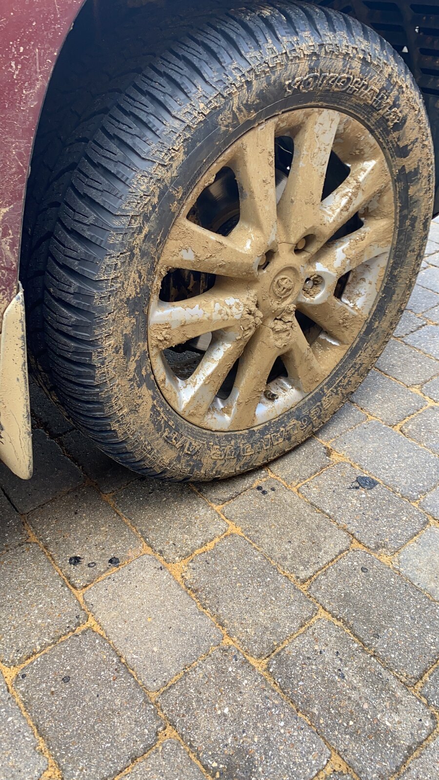

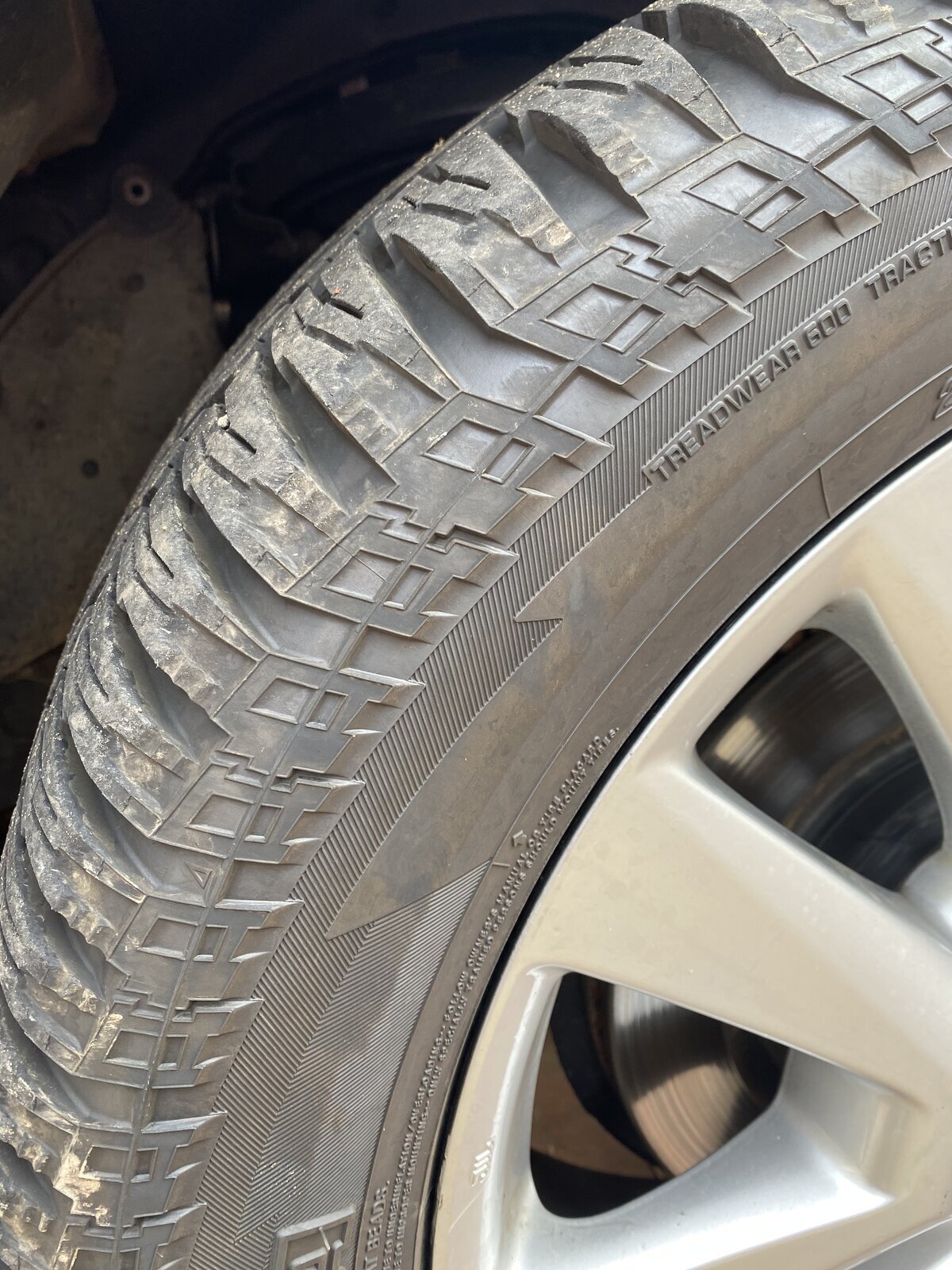

Hi Brett
within factory specs these are the best off road suitable tyres I found at that time. They look good and reasonably priced. I took mild off road into mud n they were very good didn’t skid or slip. In that thick mud Felt like driving on normal road.
With these tyres I got 21.3 mpg with most stop start traffic so these seem to be good on road as well
