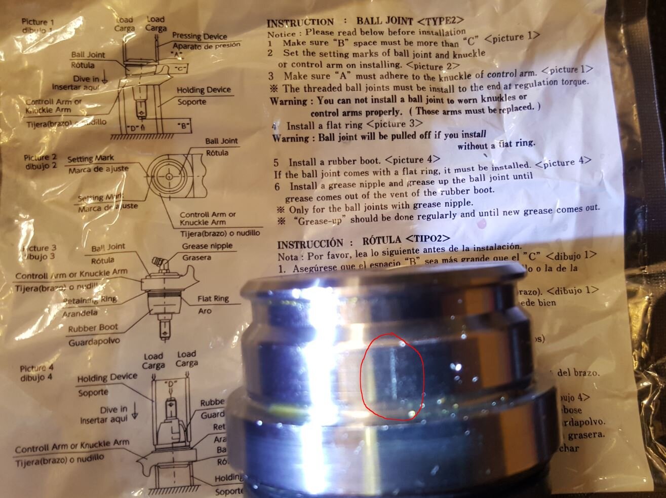

Received the 555 ball joint today; it says Made in Japan, whether believe it or not. On the boot removal (I understand it is pressed in situ without the boot) I do not see much grease. I'd prefer the grease rather being squeezed out during installation rather than a void left to be filled with water and dirt. What grease is suggested to coexist with what 555 put there?
Also, the included instruction says a mark on the joint 'must adhere to the knuckle'. It is barely seen and not exactly matching to their picture. I'd say there is slightly less-pronounced mark at the opposite side of the joint.
Anyone can shed a light on that?

"Must adhere to the knuckle" - I understand as being the press you use for pressing out the old joint - that the pipe used on the receiving side when removing old one has to press on the arm/knuckle and not on the joint. (I.e. inaccurate translation).
I used a sturdy C-clamp to press out the old, and in the new. Went very well. Just make sure that the new one is a really tight fit -- if the new joint "falls" into the hole, you need a new A-arm.
To remove I simply knocked off the circlip then you can use a BFH to thum the old one out - not difficult at all actually. Beats me why Mr T don’t sell these as replaceable items. When I pressed in the new ones I didn’t have any instructions about lining up any marks, so here’s hoping…. When the ball joint was torqued to spec the boot compresses a lot and will seal, fairly substantial boot compared to OEM, don’t think there’s much room for more grease unless some has escaped in transit.
Getting the new ball joint in straight is key, as UHU says. That’s where the press was very useful….
