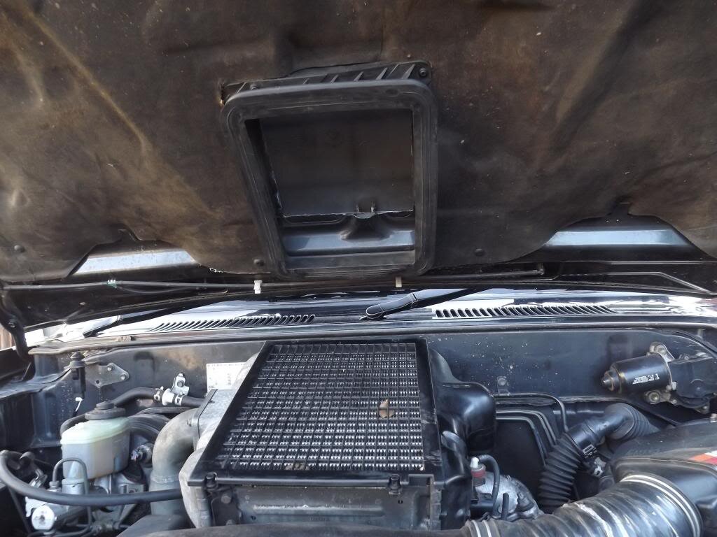

Just age Stu when it arrived from ebay about 3 years ago it wasn't in great condition and its just deteriorated since . No leaks as yet but its a case of when rather than if . It's an old school family business i'm using and he reckons the new core will be more efficient than Toyota's own and as Allisport use the same it helps to take his word for it .
It's not worth splitting hairs over 50 quid even if its a 2 hour drive to Swansea and back .

Shayne, if it was in better condition when you got it then what deteriorated it like this? Have you got any mesh on the inside of your scoop to stop big flies/possible stones passing through and damaging those fins?
It has a plastic grid over the top Beau but i will be adding some stainless gauze when it goes back on .

As for what's killing it i would say water , my old a/c condensor was the same aluminium just corrodes and goes brittle with age .
Yeah a finer mesh would probably help. When you're doing good speed bugs can certainly cause some damage to the fins over time.
With regards to corrosion, have you thought about painting the new one then? Should make it last even longer. I don't believe it will effect cooling properties. If anything, I've seen/read how on front mounted intercooler a black painted cooler has led to lower inlet temps vs without. Don't know if this is due to the sun or what...
I will speak to the guy doing the repairs about it , I would guess they are dipped in some sort of sealer because this one has lasted 20 odd years without paint which is no mean feat .
My Shogun one was painted matt black Shayne. Acid etch primer then matt black should help I would have thought.
