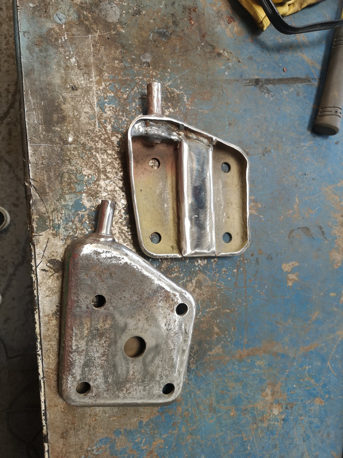

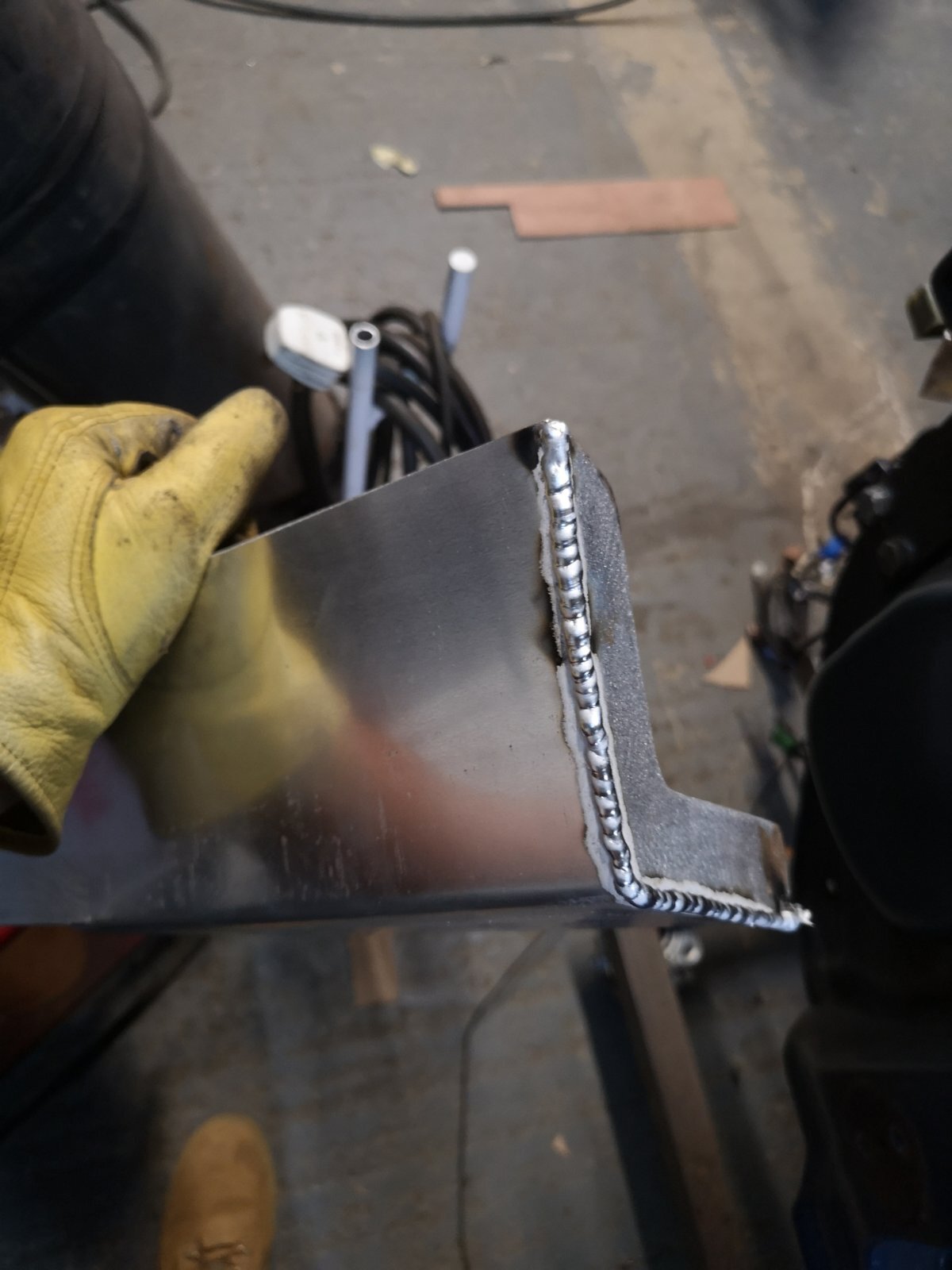

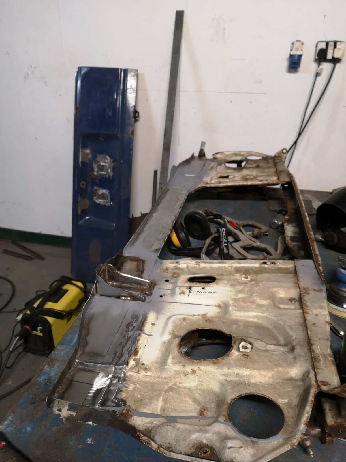

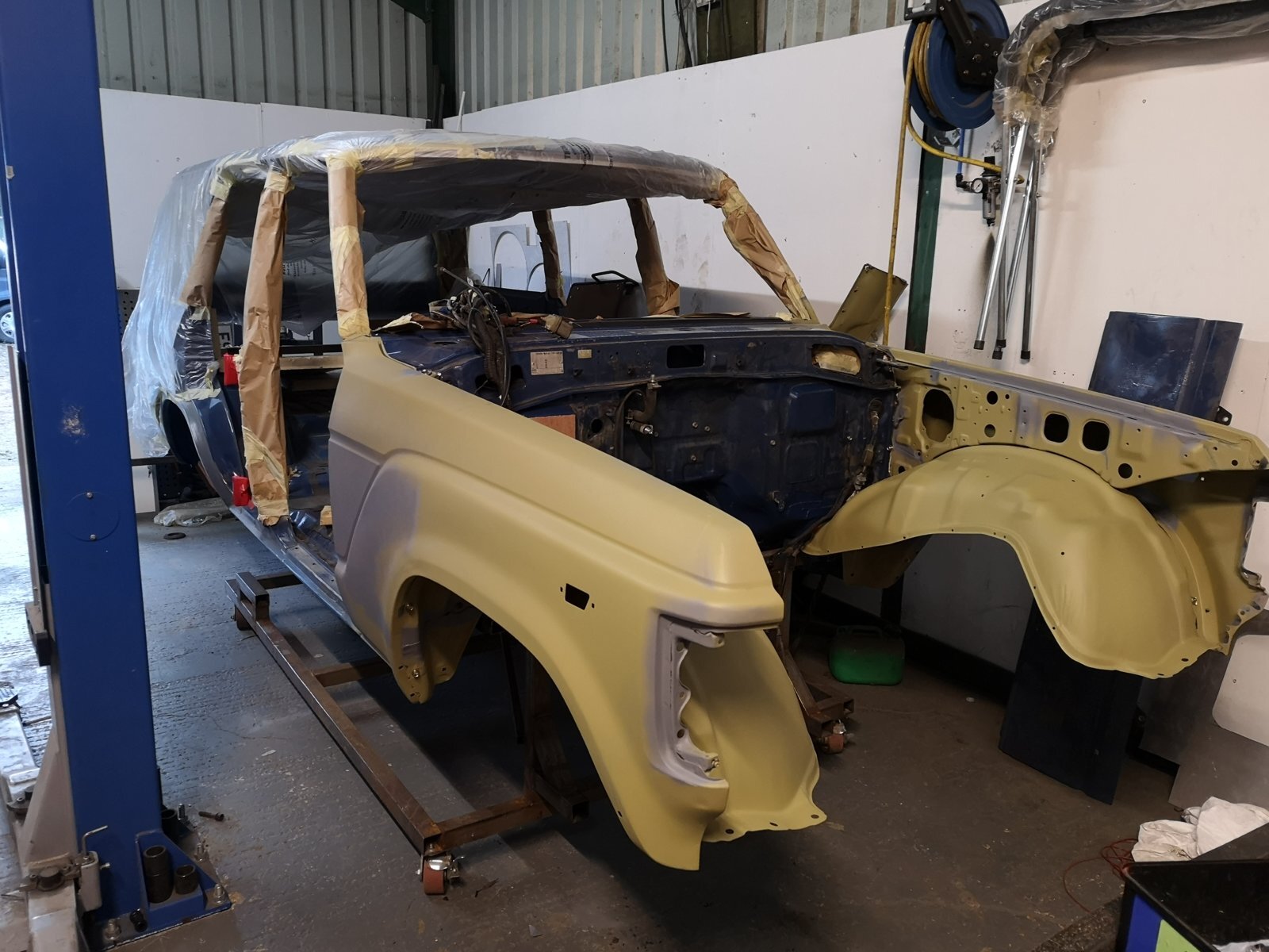

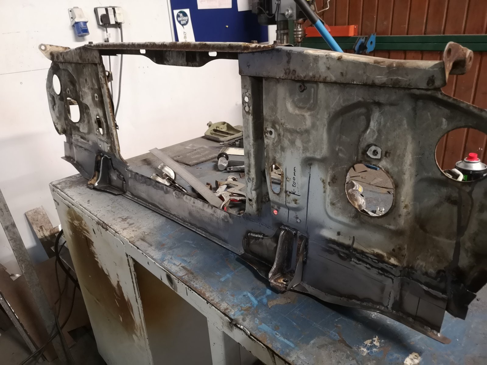

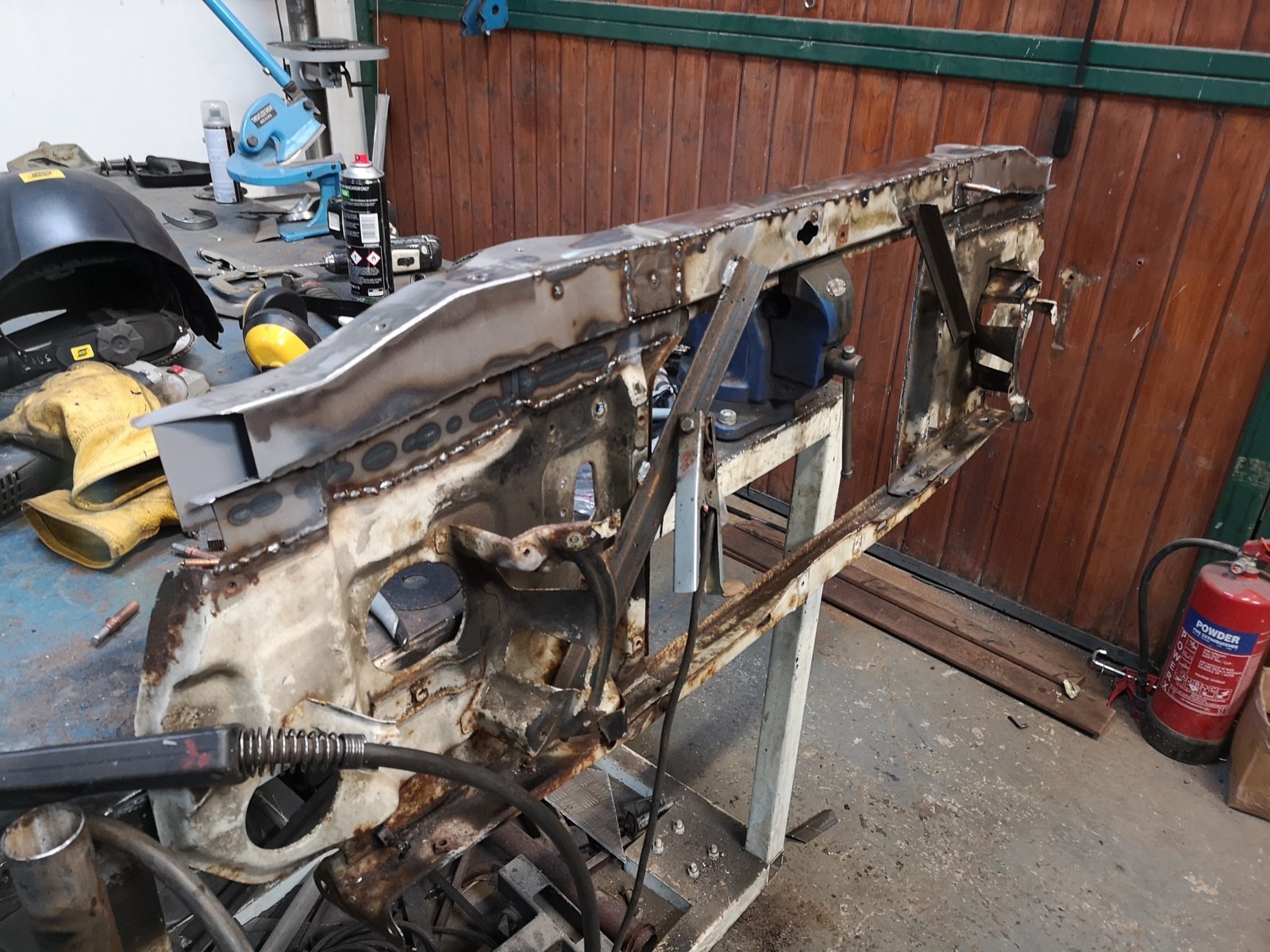

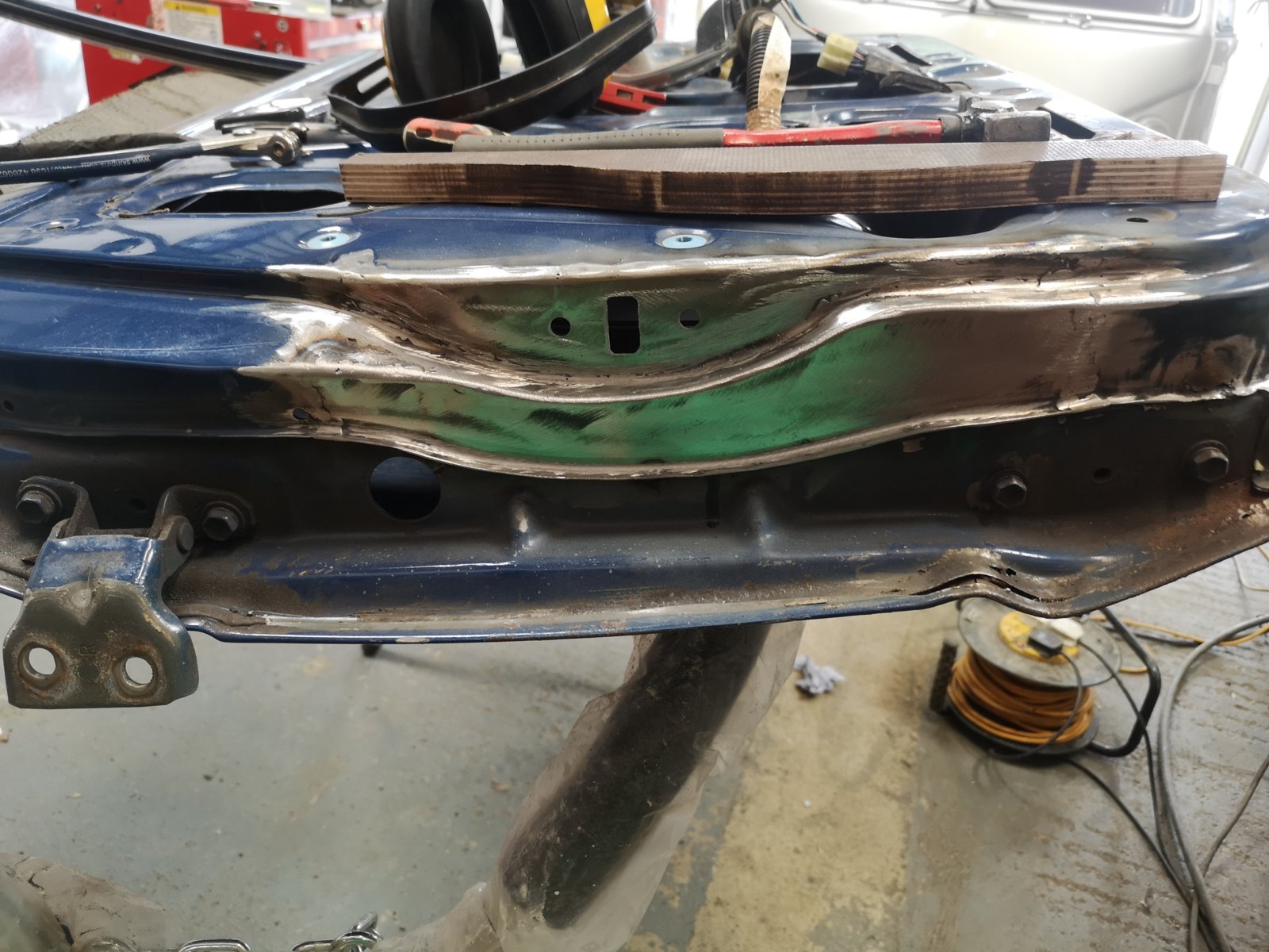

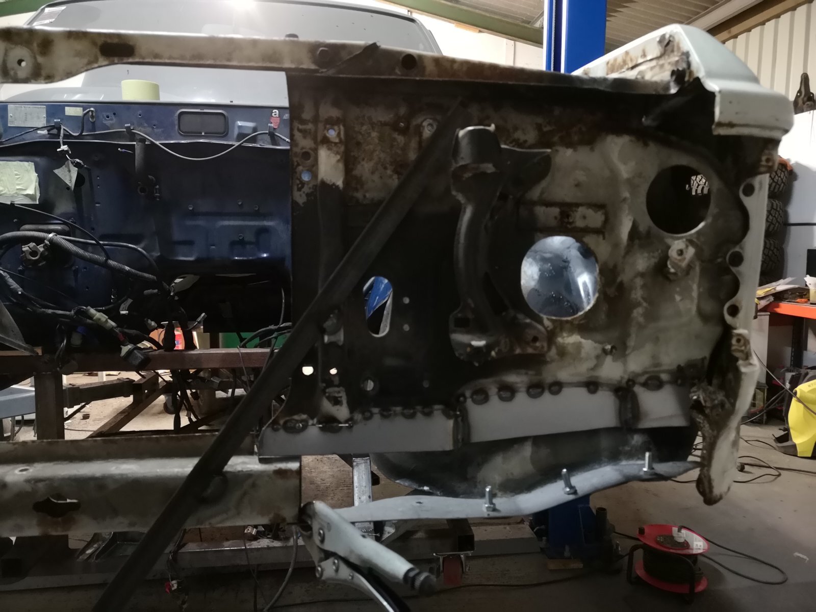

More progress on the front panel, few more hours and it will be done.
IMG_20190312_194301.jpg IMG_20190317_151329.jpg IMG_20190317_160535.jpg IMG_20190317_182724.jpg IMG_20190317_195603.jpg

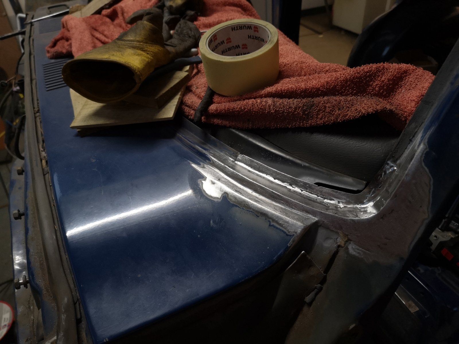

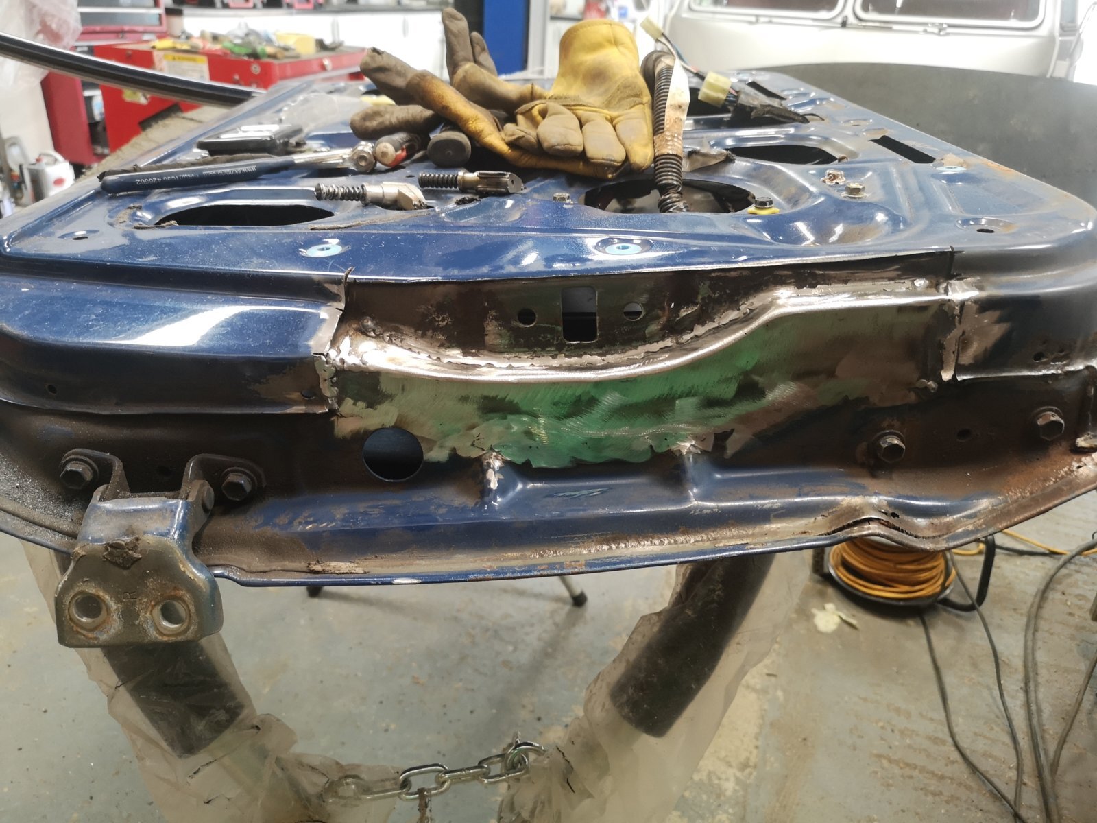

I like your Work Hayden..Its time consuming but with results like that, Rewarding .. If iv managed to get a continuous bead of weld over 50mm with out spatter or push back id be a Happy man.. Crack On:thumbup:

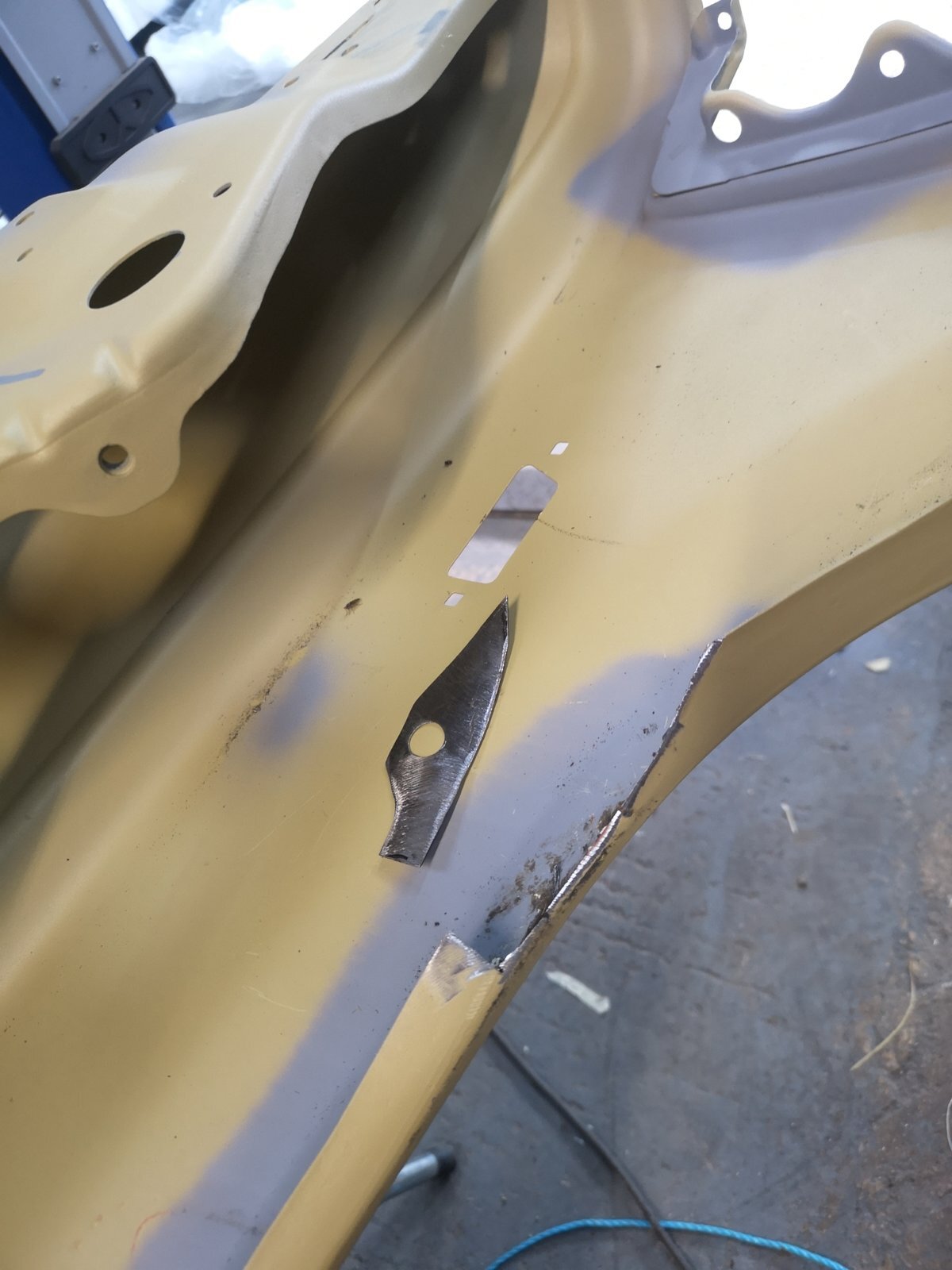

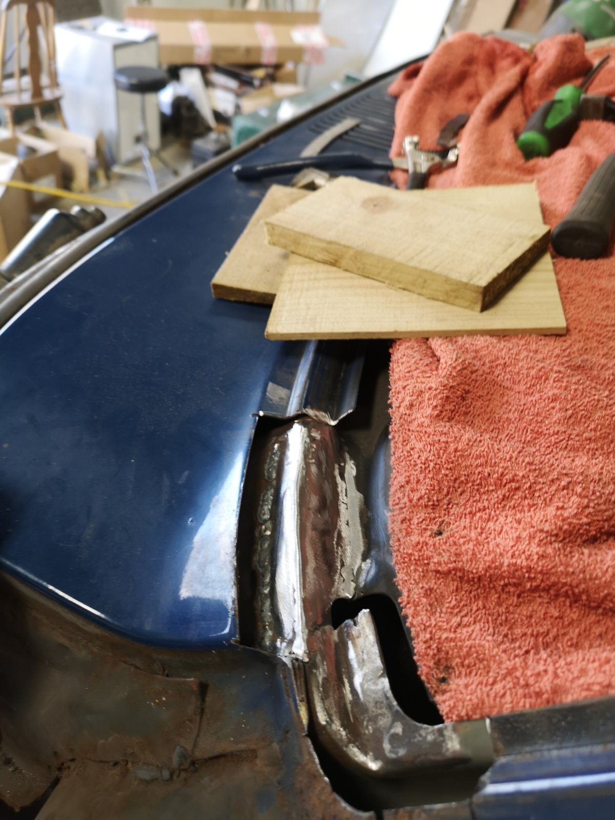

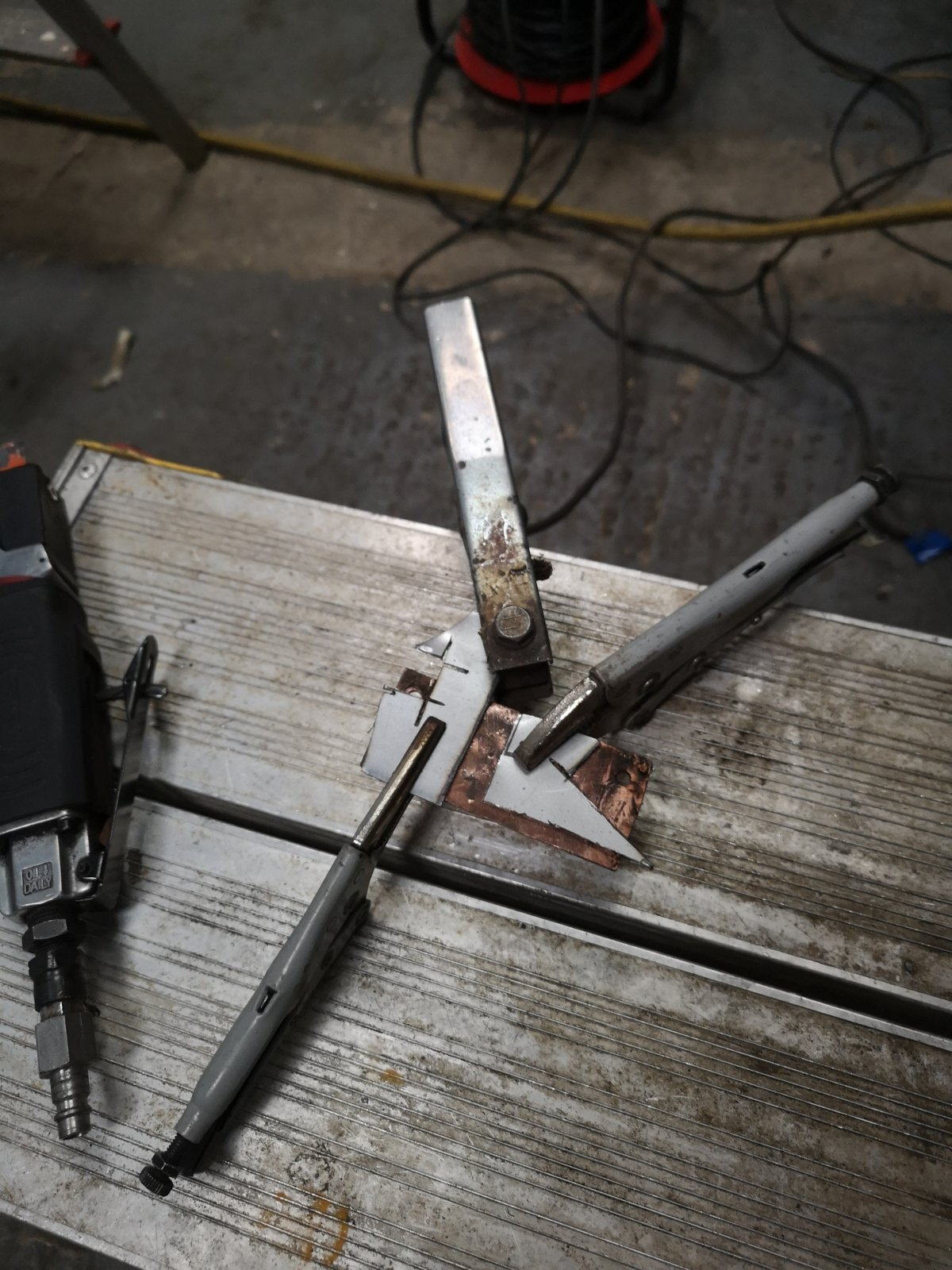

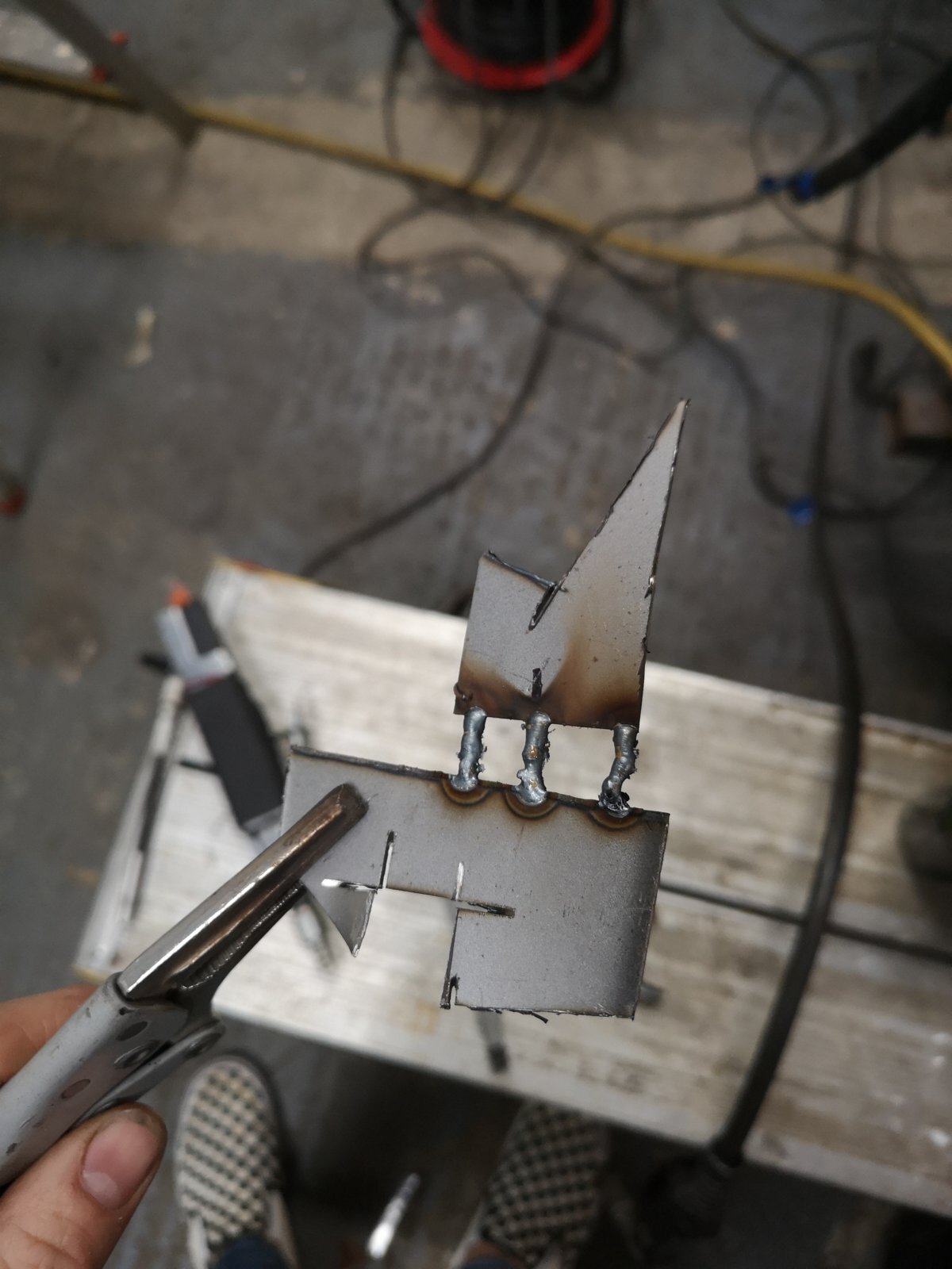

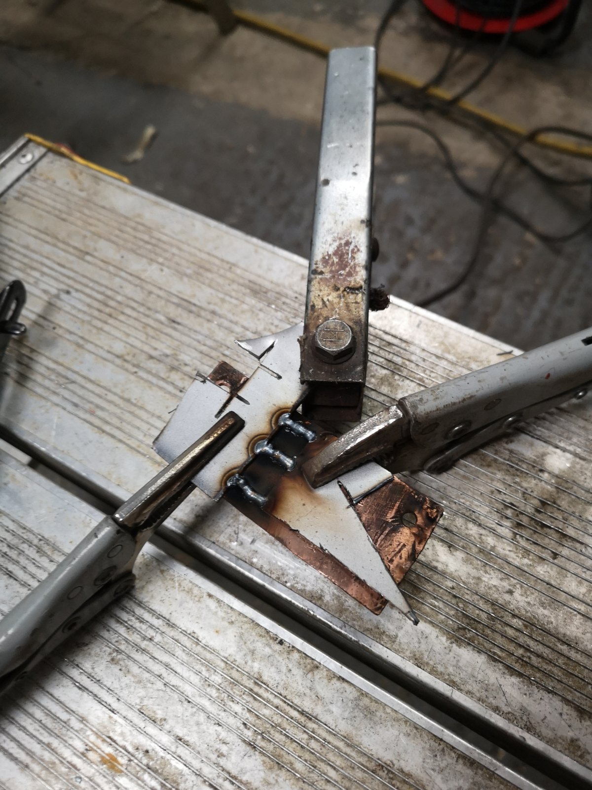

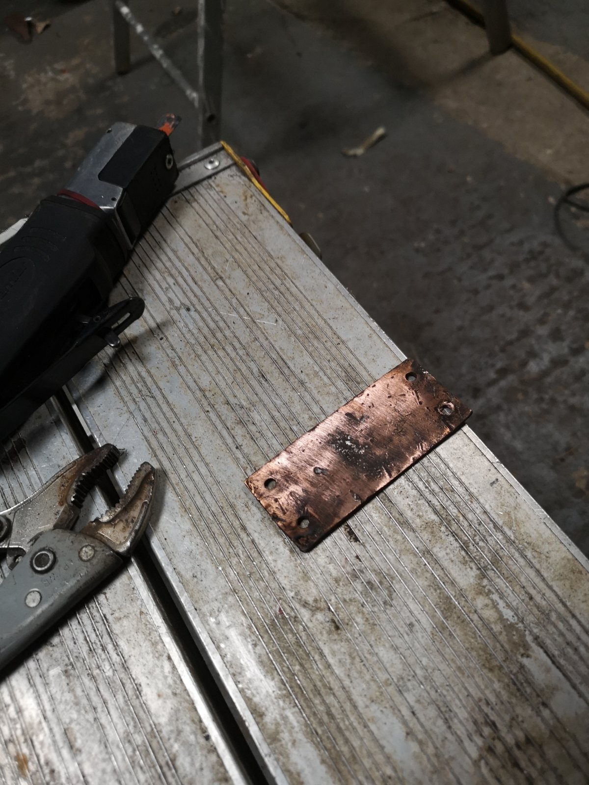

Cheers bud your right though takes hours but nice when it goes well. I use a Lincoln electrical MIG 180 really nice welder has a good wire feed into the touch. As you mentioned spatter and push back can be a pain, the best tip I was told about is to use copper. If you put a piece of flat copper behind what your welding it acts as a heat sink and if you blow through you can actually keep on welding.. The weld pool will sort of flout on top of the copper, great for filling gaps. A piece approximately 5mm thick works well.
This is what I mean, exaggerated gap but principle is the same. The weld doesn't stick to the copper.
IMG_20190407_074028.jpg IMG_20190407_074151.jpg IMG_20190407_074231.jpg IMG_20190407_074311.jpg
Iv seen this and done it before.. It works, I prefer Chassis work.. But all that body panel stuff impregnated with paint /Rust etc.... you got to have a lot of patience (That i dont have) ..... Iv got a 180 mig that iv had over 20yrs now... And a small 140 mig ..... I prefer em turned up a bit... You'v obviously got some skills mate..... Crack on!

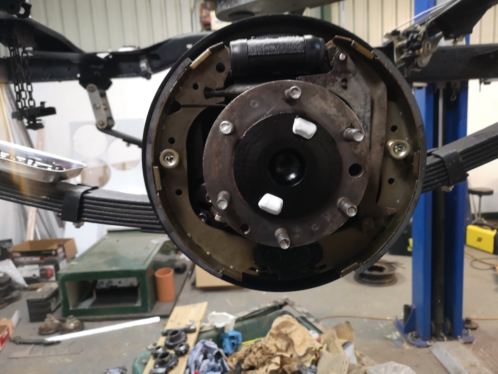

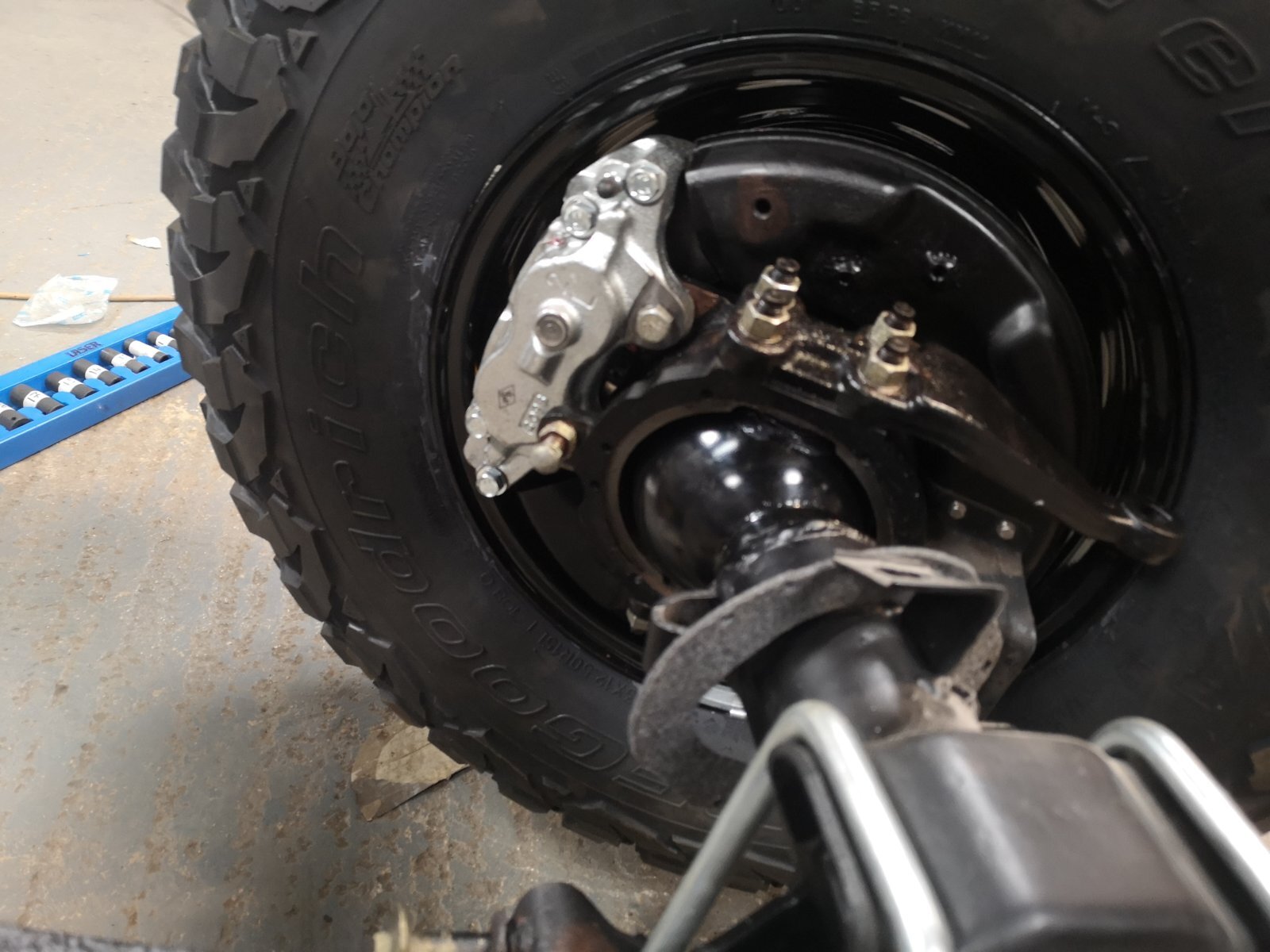

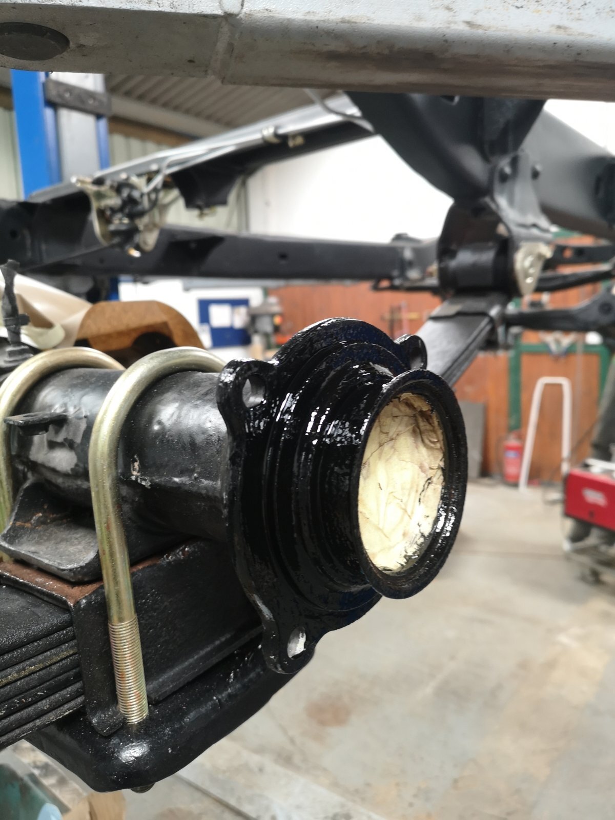

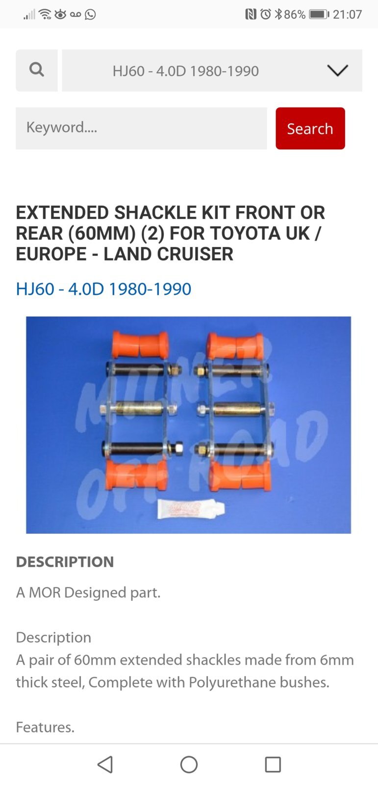

I bought some 60mm extended shackles but know I'm a bit worried about vibration etc After doing a bit of Google searching I think I need some caster shims to correct the propshaft angle.
Don't suppose anyone has any experience on this?
Really nice work happening Hayden! With the extended shackles, if they're extended in length then the lift would be 50% of the extra length. Because on a leaf spring it would have to be equal length from the centre bolt under the axle on both sides of the spring. I fitted a body lift on my 60 which gave the space for the bigger tyres.
I've also gained some inspiration from your welding examples etc and thanks for sharing mate!:thumbup:
Cheers for the comments guys that's interesting about the shackles. Found some Info on the probshaft angles. Some thing I will need to address when full weight is on the springs and can measure the angle of it. Body lift know seems like a more straight forward ruote.

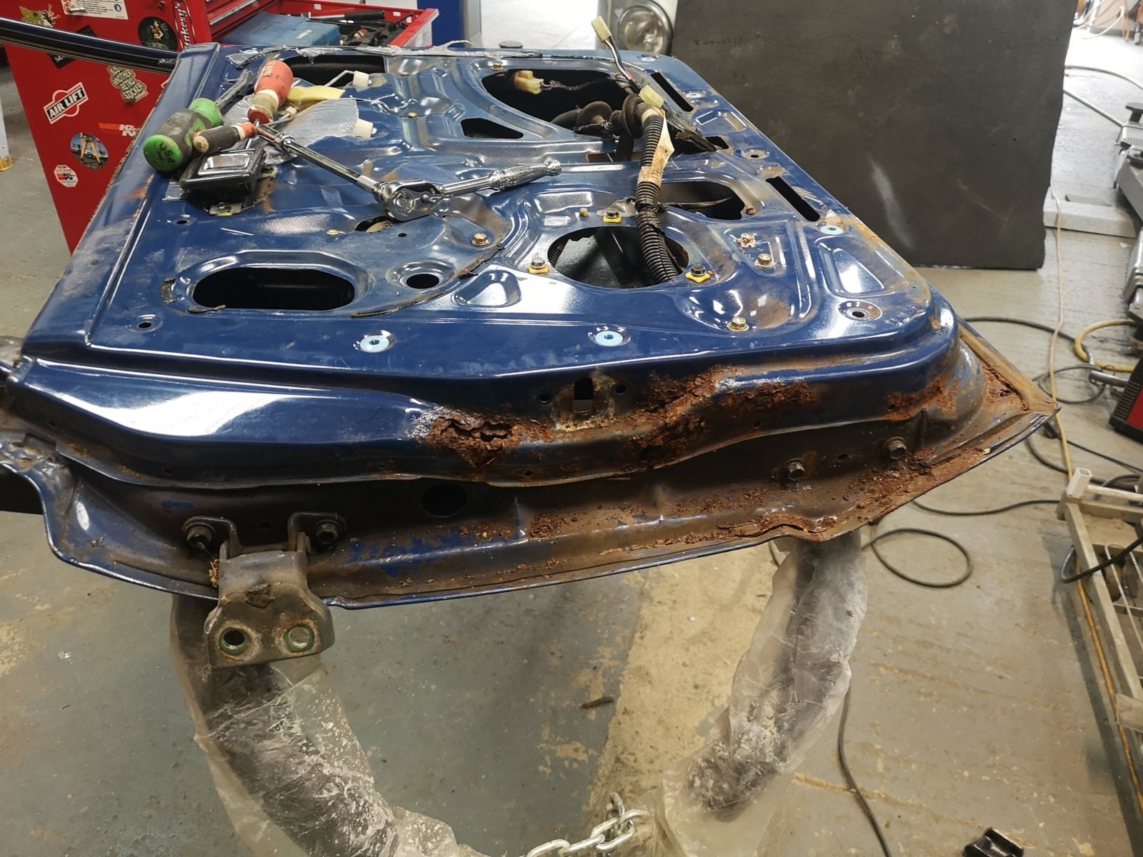

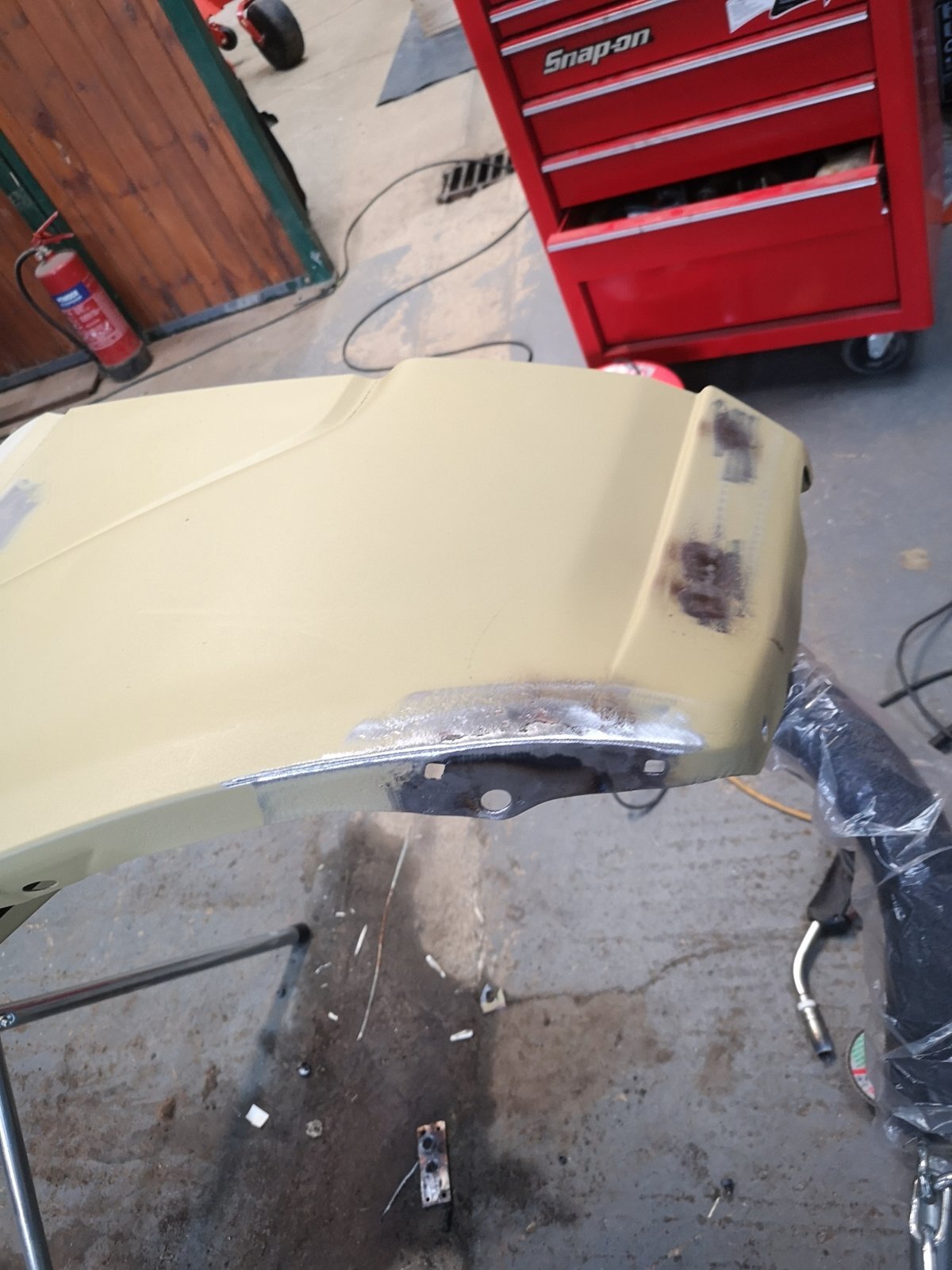

Some pics

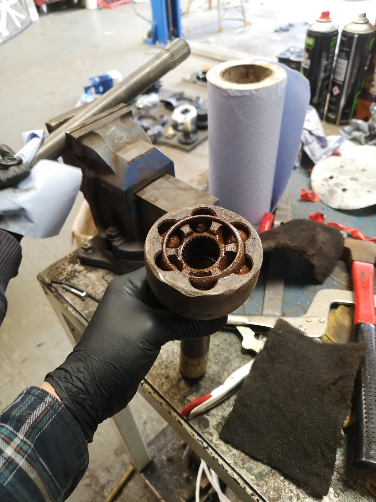

IMG_20190419_102928.jpg IMG_20190419_120619.jpg IMG_20190426_213546.jpg IMG_20190427_113427.jpg IMG_20190427_130331.jpg IMG_20190427_130338.jpg IMG_20190427_170521.jpg 15563834787205350766759574514177.jpg

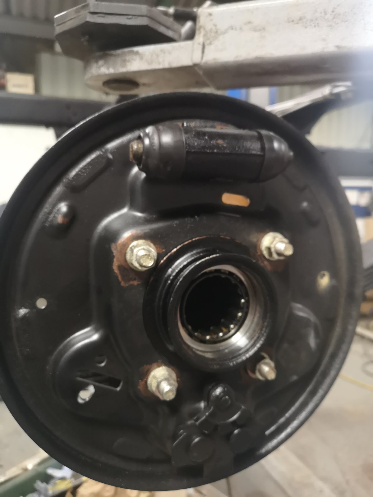

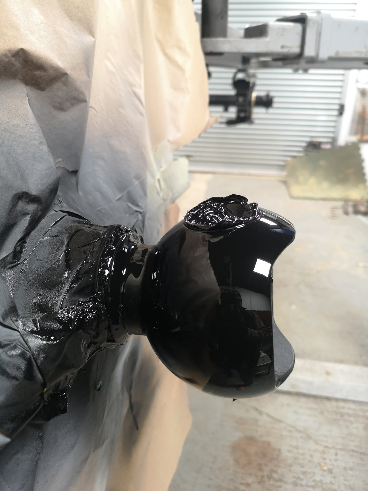

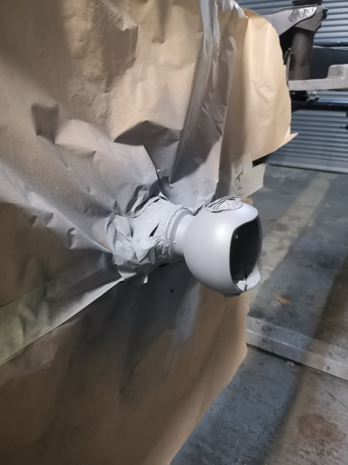

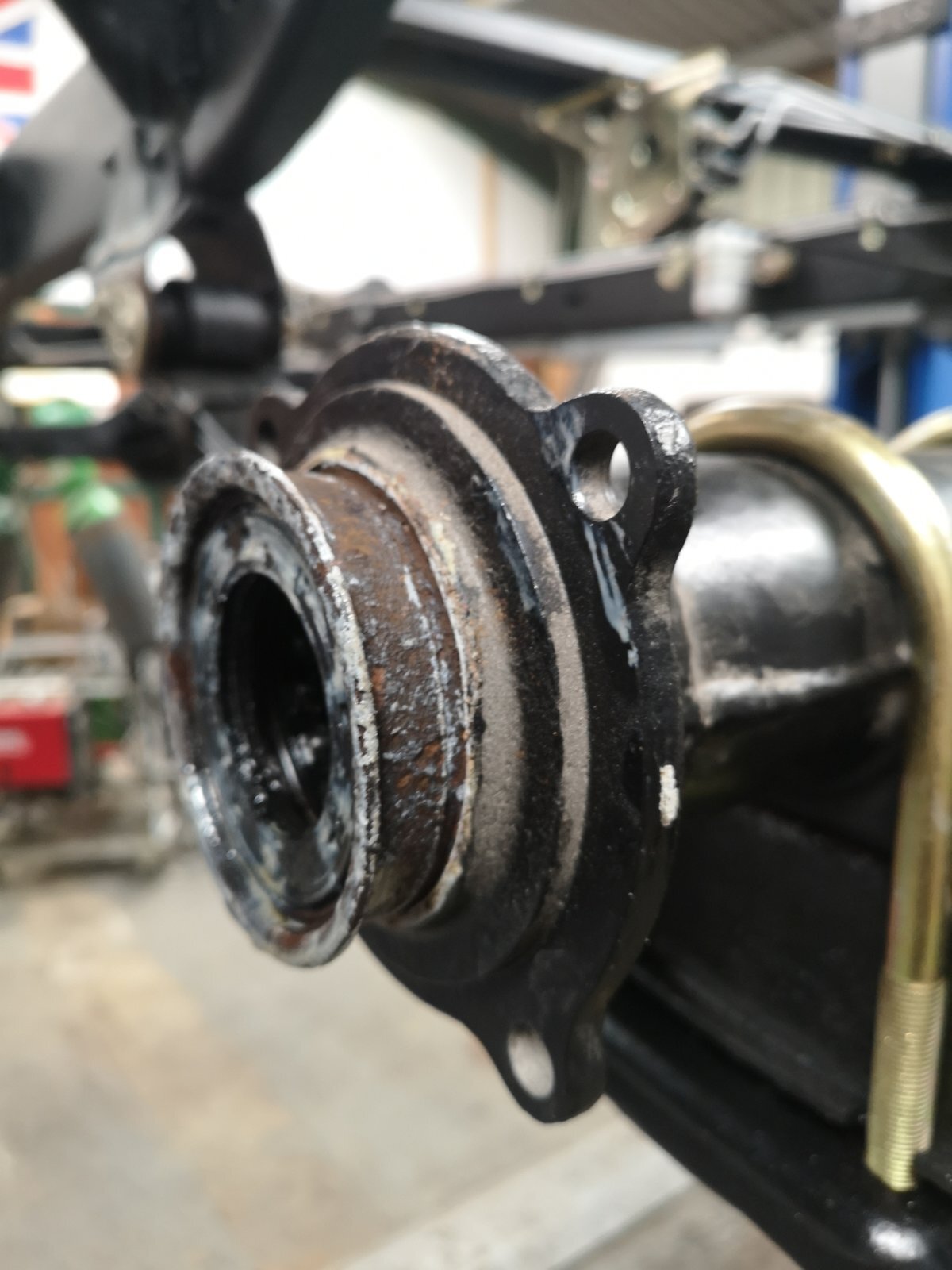

Looking good Hayden... some decent progress there Mate.. Is that a two pack paint your using there..Were the swivels pitted at all?.... Looks good

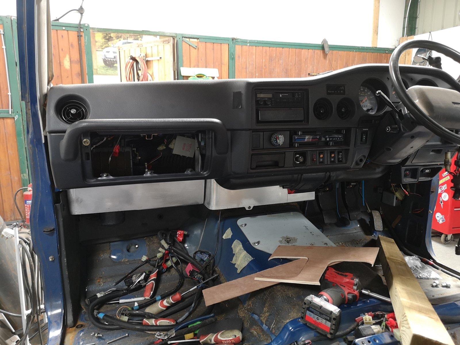

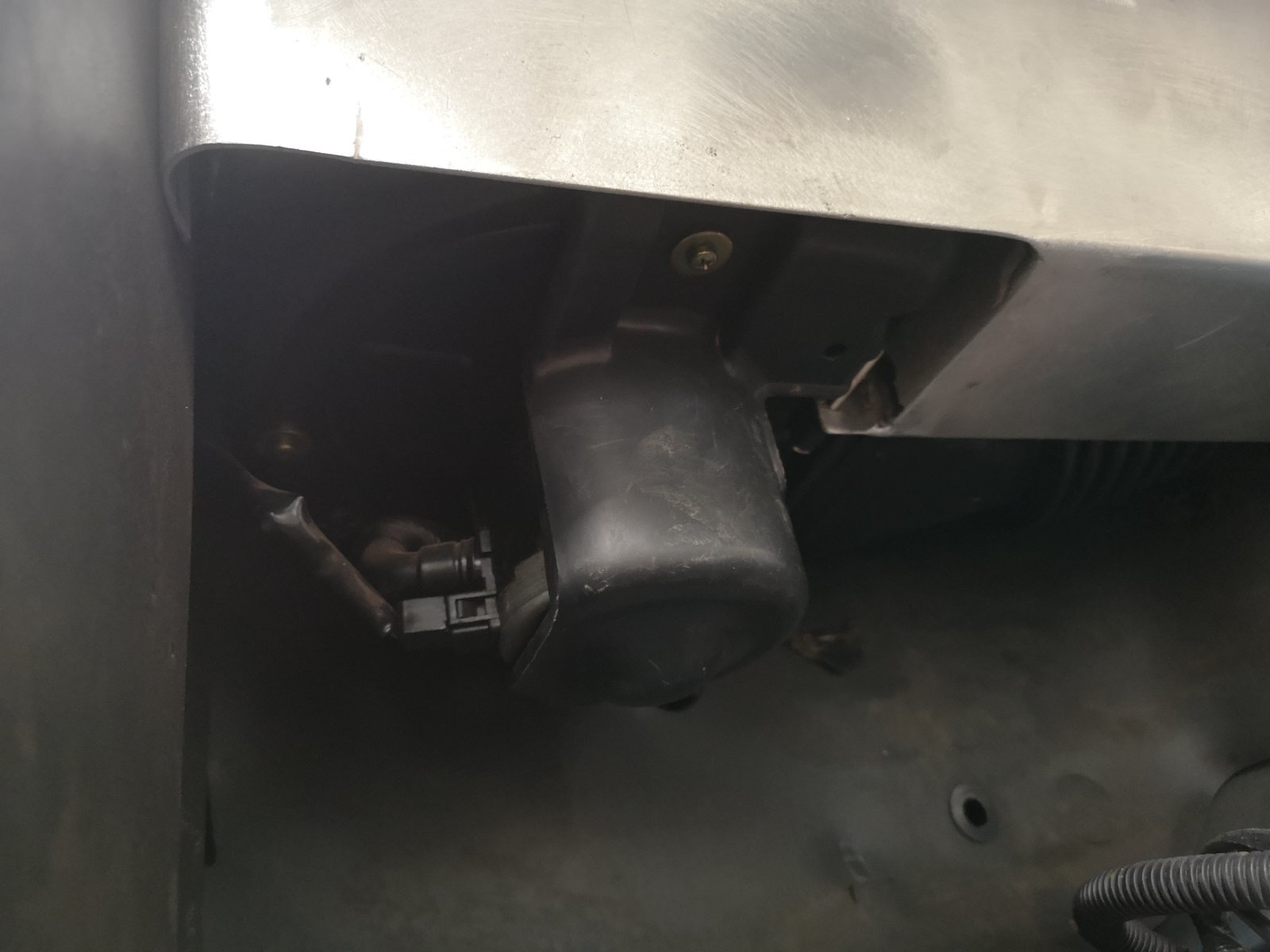

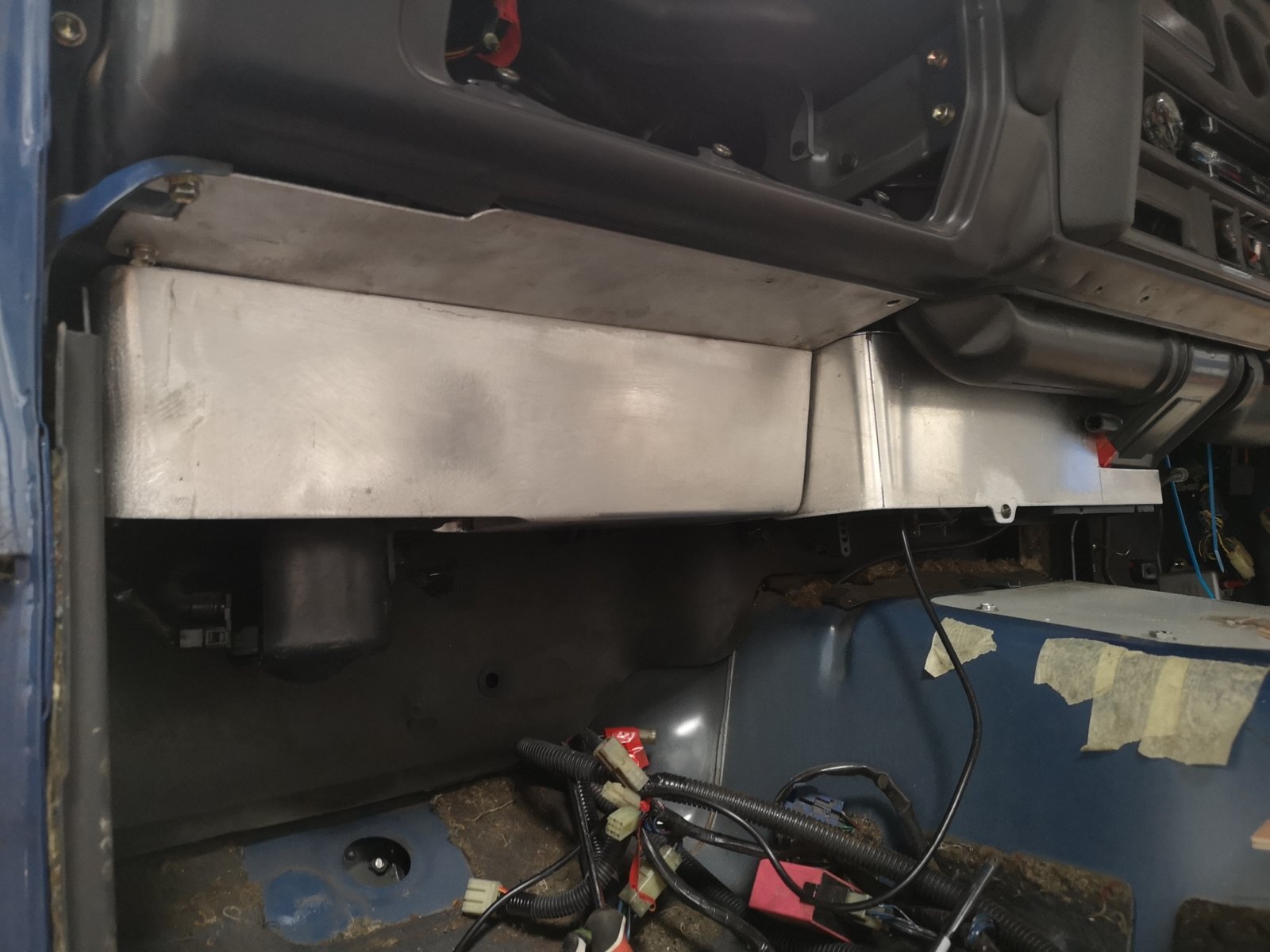

Made some lower dash cover panels as I didn't like how it's quite exposed under there. You can see the blower unit etc.
I th hope this wasn't just because parts were missing

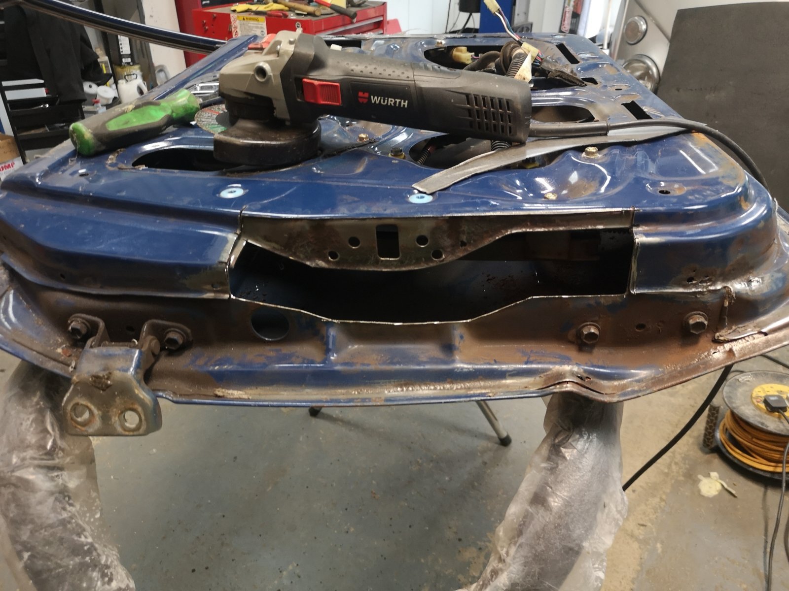

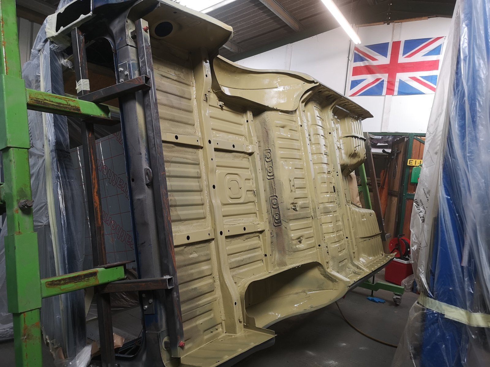

IMG_20190522_125256.jpg IMG_20190522_125244.jpg IMG_20190522_125229.jpg IMG_20190520_204122.jpg

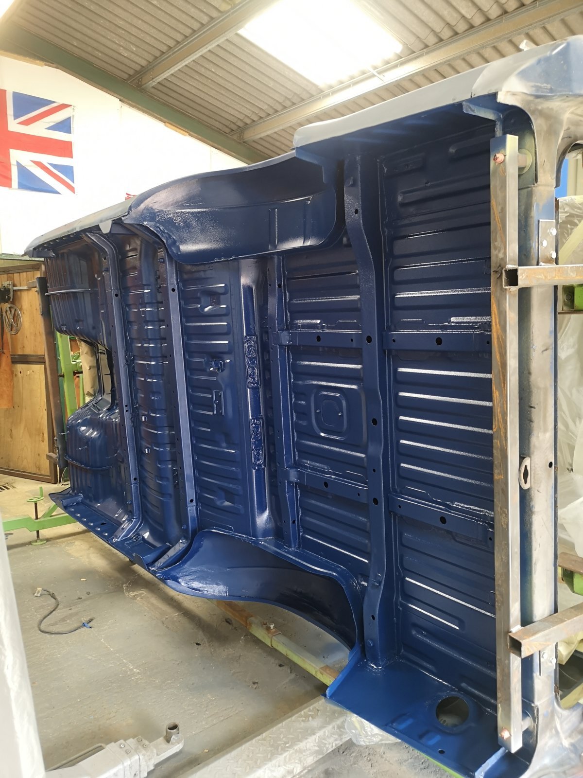

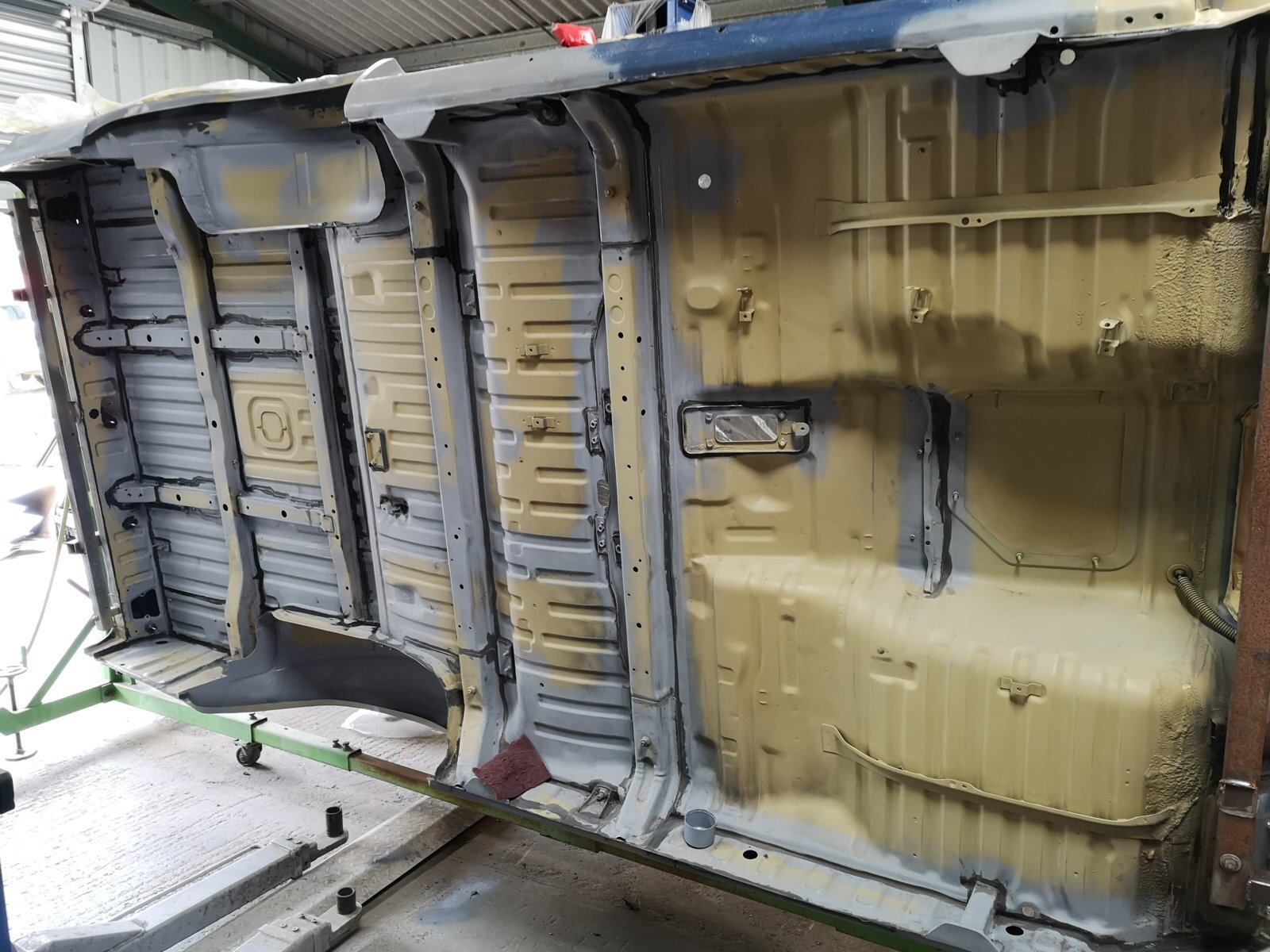

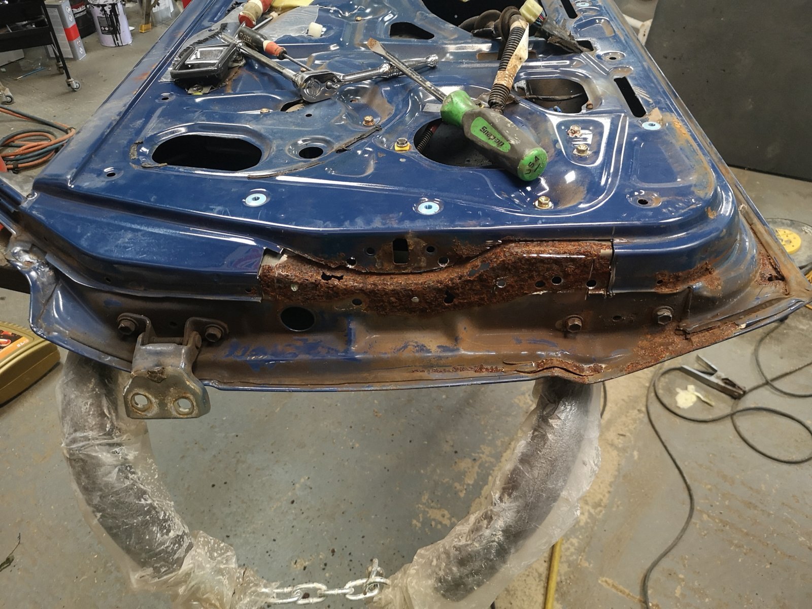

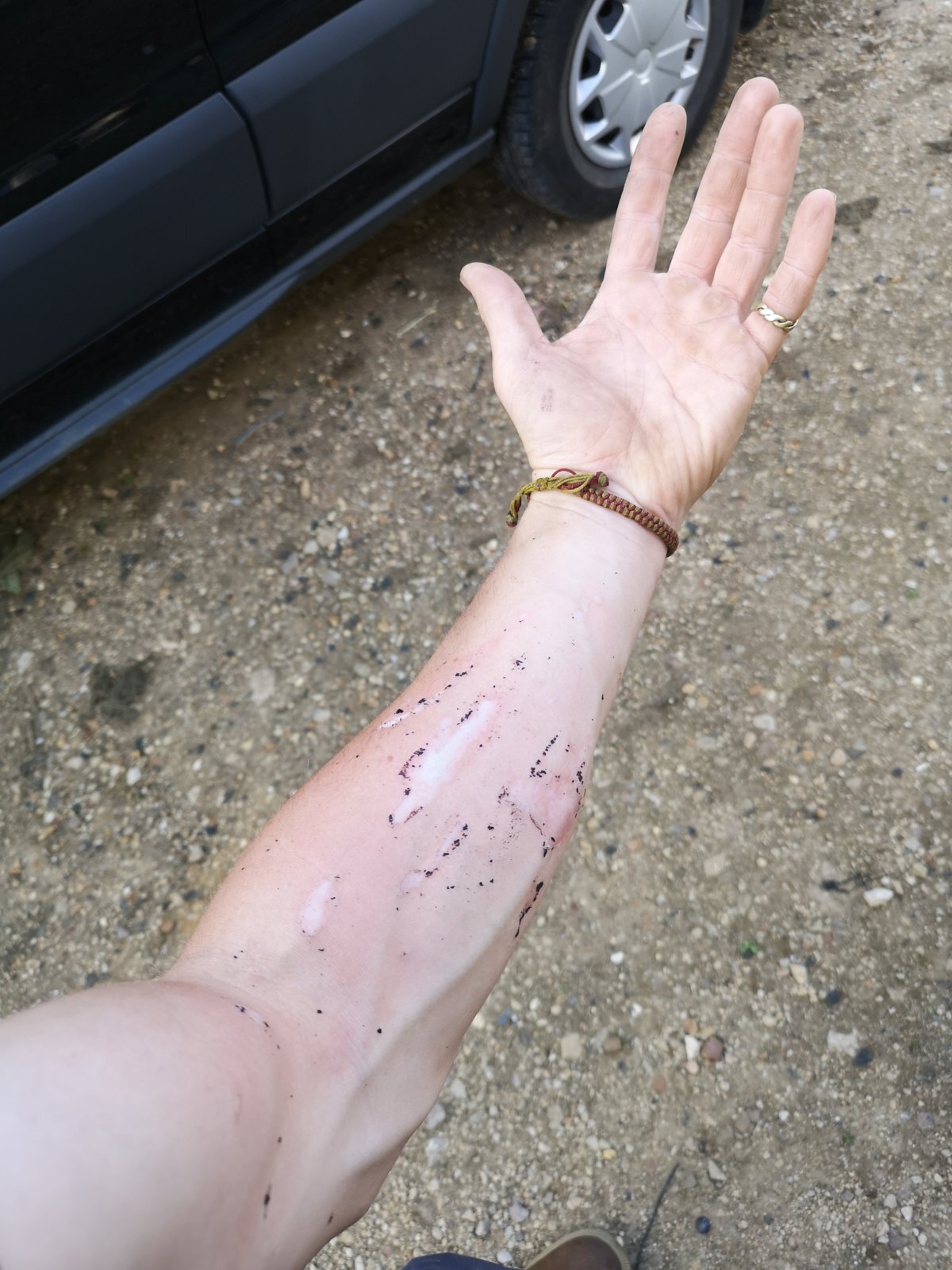

Underside has been blasted plus my first Toyota inspired injury. Whilst welding the sound deadening inside caught on fire by all the wirring, pated it out in a bit of a panic. Then the hot tare landed on my arm. Lovely.

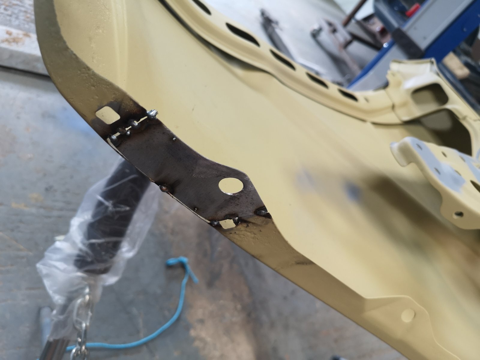

Looking good. Your fabrication skills are impressive mate... I love that colour.... Iv not been getting alerts for these Posts.. Uh! Impressive work Hayden
