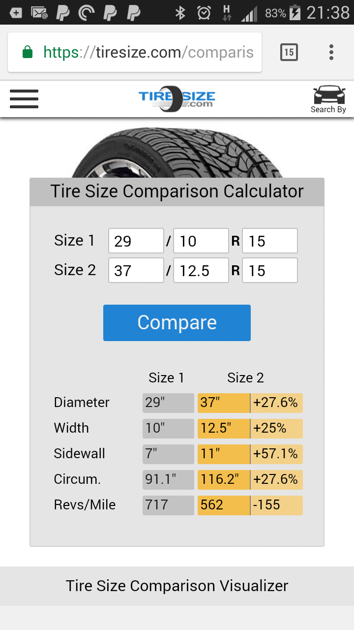

Any one else been experimenting with rim and tyre sizes? How about 15 x 10 rims, negative offset, 30mm hub wheel spacers and 37/12.5 R15's. Any thoughts?

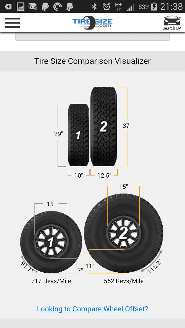

The most constructive comparison I've been able to make so far is from thus wonderful site.

The tyre guide is very interesting and with you having the farm, I guess, you do alot of four wheeling and the bigger size will change the gearing. No idea if that is important but it may be worthy of consideration.
