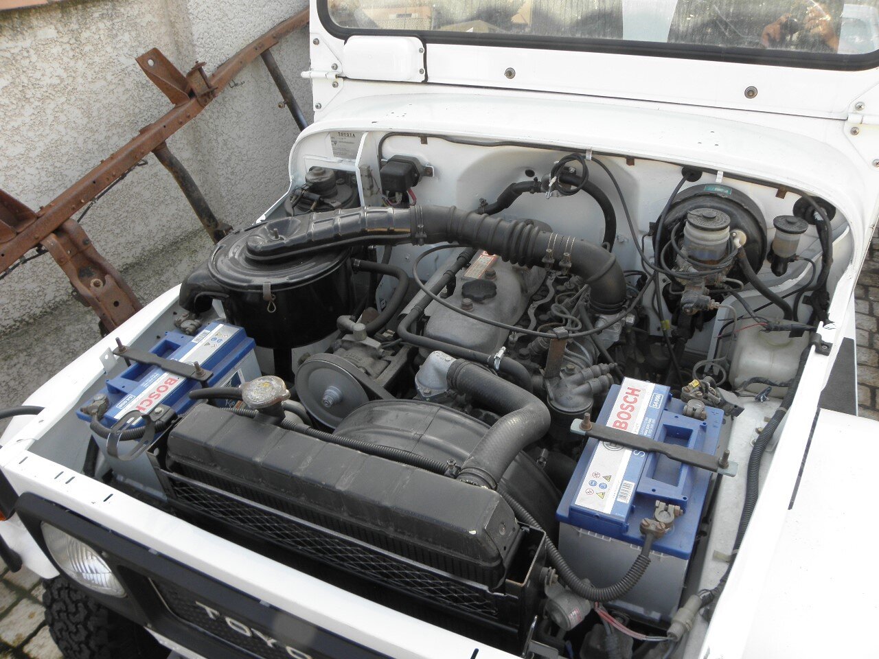

In the meantime, does anyone know where I can get an original 24v horn (Amayama have them, but as always, a little pricey...) One of mine was DOA in the parts box I got with the car and I can't find any information anywhere on getting it apart to repair it. I'm also a bit unsure on the mounting point for the second horn (passenger side in a LHD car) - is it on the rear brace of the battery tray?
Not sure if the following helps but....
My horns mount on the same mounting bolt - one above the other (vertical) but mine are mounted on the rad housing. A while back one of them stopped working and, like you, I realised that access to the internals is not on so I gave the only screw (in centre) a few turns and it worked again. Worth a try?
Cheers
Rodger
Thanks Rodger, I think mine are different, judging by the locations of the wires for the horns, but I'll double check when I get round to it. Whereabouts on the rad housing are yours mounted? Strangely I did fiddle with the screw and managed to get a gentle 'pffft' sound out of it, but it stops after half a second and isn't anywhere near the required volume. I'll just order one from Amayama if I can't get it working.
