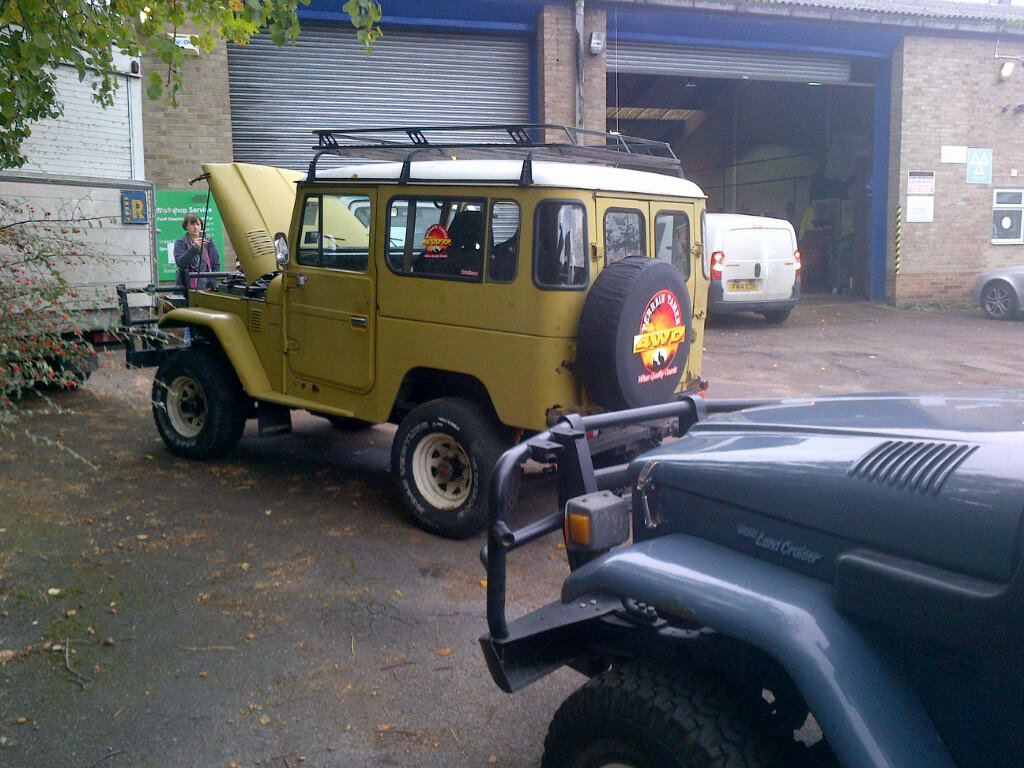

    Hello Guys
    Thank you all for your guidance. Yep, the shackle angle is too vertical and I guess a lot of that is because
    the springs are very curved with inbuilt helpers activated all the time.
    There are 8 leaves in the rear springs, forgot to count front ones: see pic (no that's not an oil leak up front just an old bucket!).
    I am going to try and remove leaves as suggested, as that seems the simplest possibility and I don;t carry much weight in it.
    Just got back from the MOT station (pictured below) where is failed on some welding on the floor and a rear number plate lamp, not bad!
