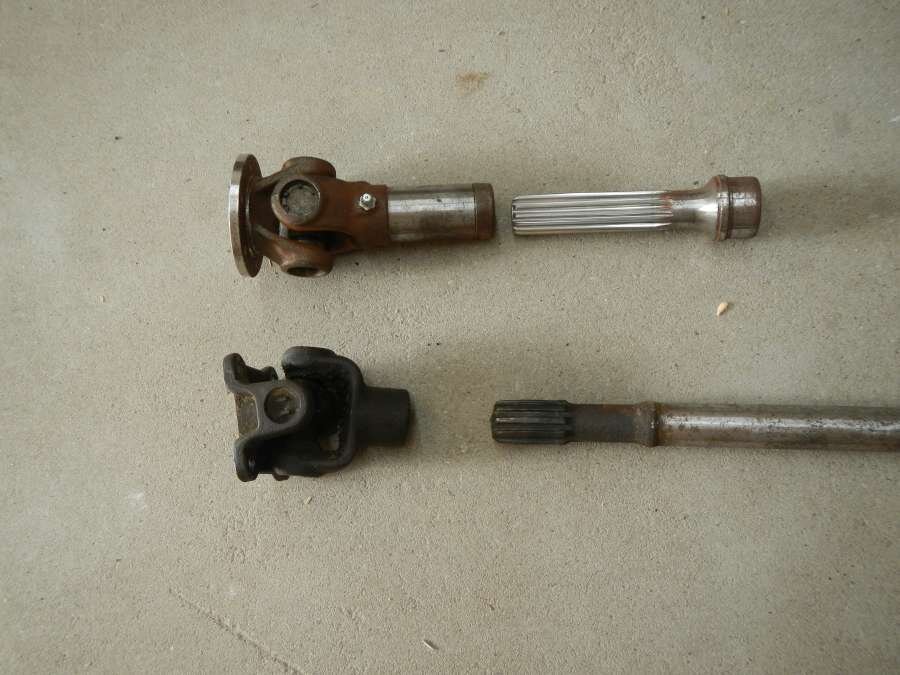

Sadly, the splines of the driveshaft and the UJ were well worn and needed fixing.
BJ without winch
worn driveshaft
A little fabricating is needed:
new end for shaft + new UJ
of course it doesn't fit right away:
measure twice, cut once :
make to measure :
weld into the shaft and stage 1 is ready:
for the uj, I used one half of the old uj and one half from the new one. Made 2 new bushes in the lathe and pressed everything together. Sadly forgot to take photos.
but I have some pics of pressing the bushes in the the front uj. First tried it in the vice, but without succes. Then I remembered I had a small tool from work that could do the job :
It worked!
