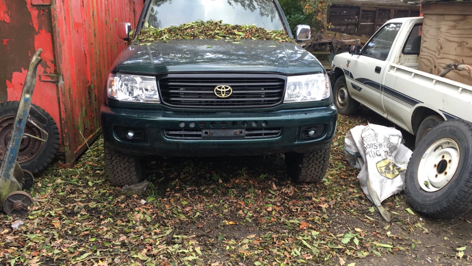

So with having the long weekend I had a bit of time to do some work to the 105, I was going to do the build based on a petrol 80 but luckily I stumbled across this 1999 1FZ-FE 105, so the plan is(for now) fix the engine as it had a bad bottom end, turbo conversion, 2" lift, standard front bumper, 285 AT's and update it to look like a 2004, while the engine was out it gave me time to clean up the chassis and treat it with Buzzweld, I also started making the mounting brackets for the intercooler

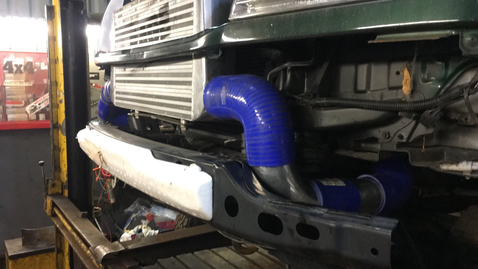

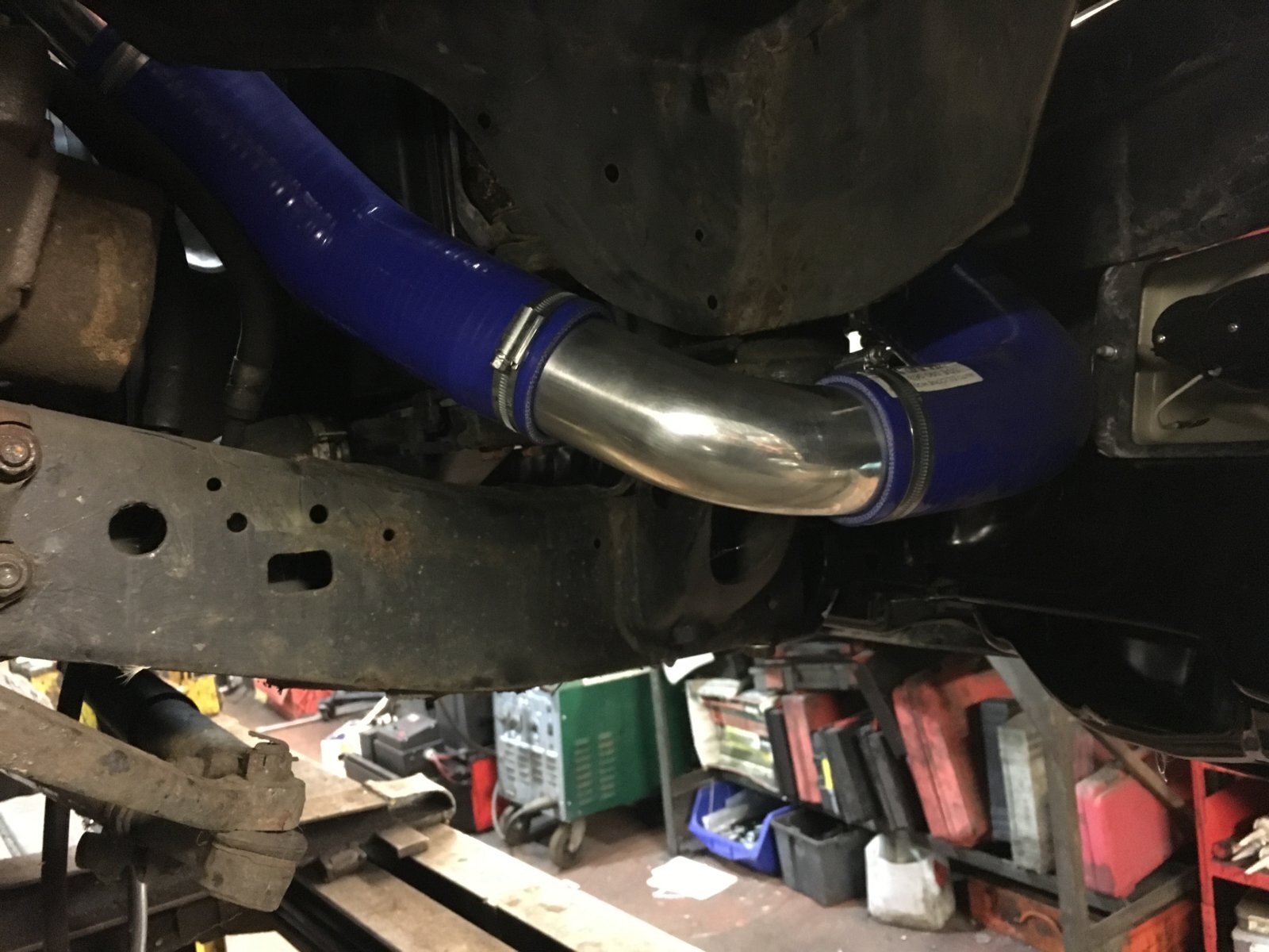

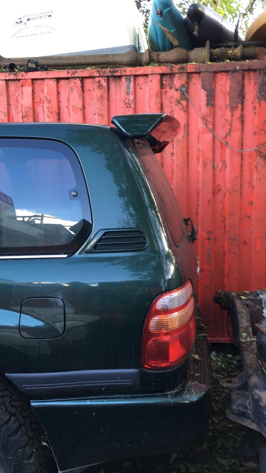

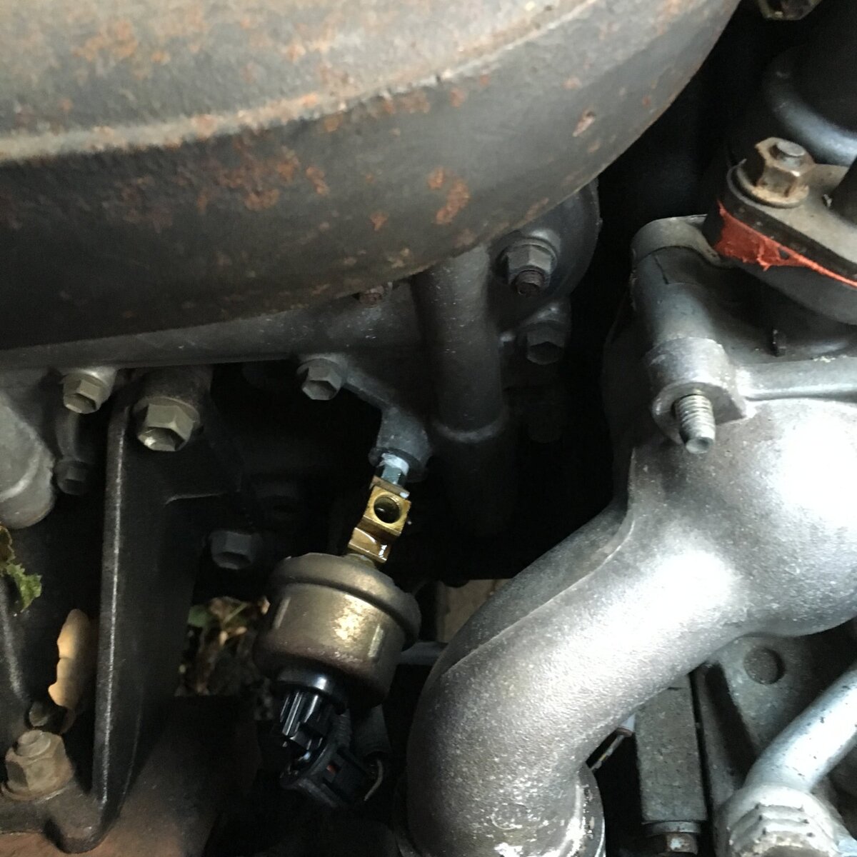

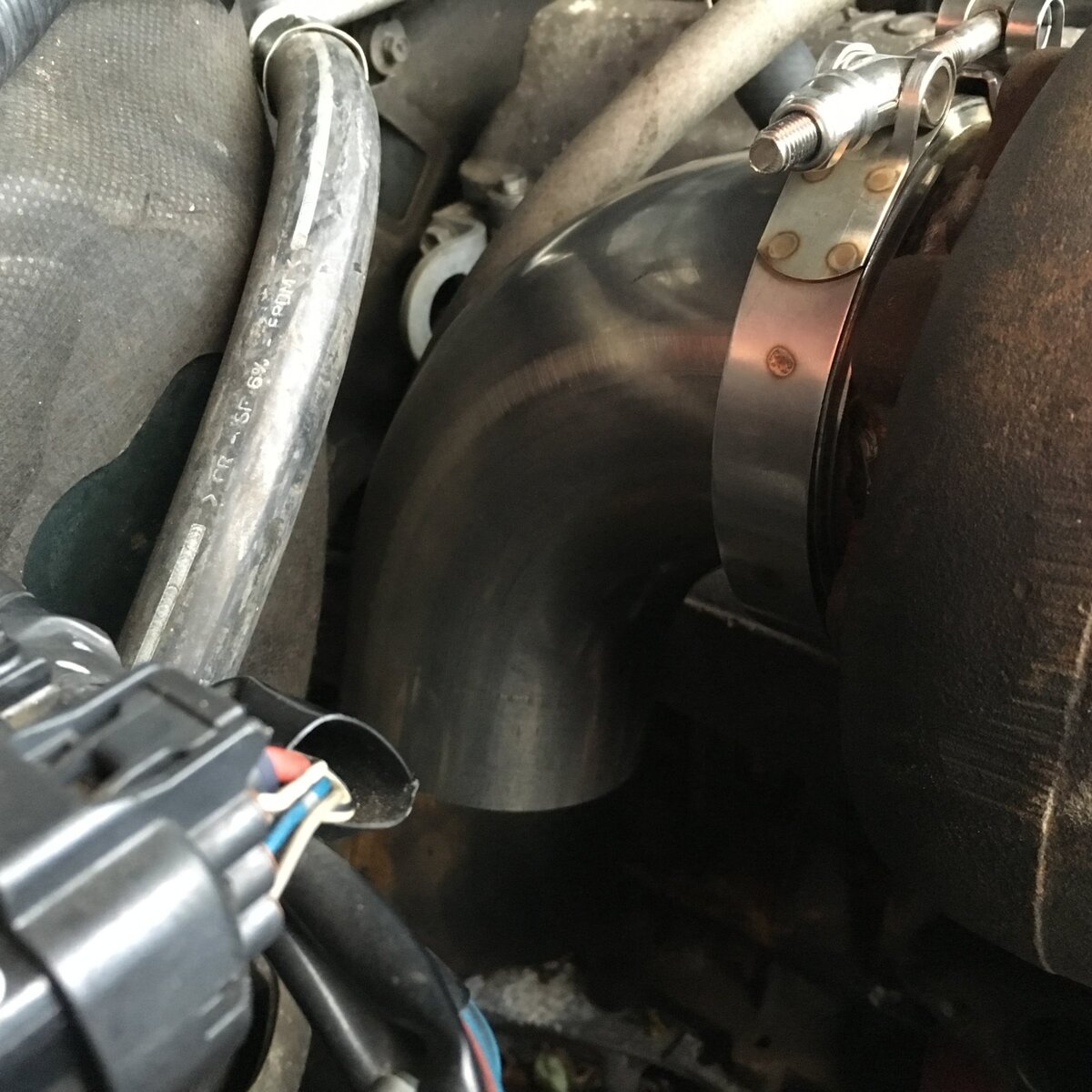

Not a lot of preogress but some, turbo is all bolted up, intake is on, intercooler pipe work is coming along, oils feed in 90% done just waiting on a fitting, oil drain is done, had the bumper, girl and spoiler painted, fitted some new fog lights, that's it for now. Just done a parts order few more bits of silicone what not, looks like the exhaust is going to be interesting to make, it will be a 4" dump pipe in to a 3" system with a decent size box.

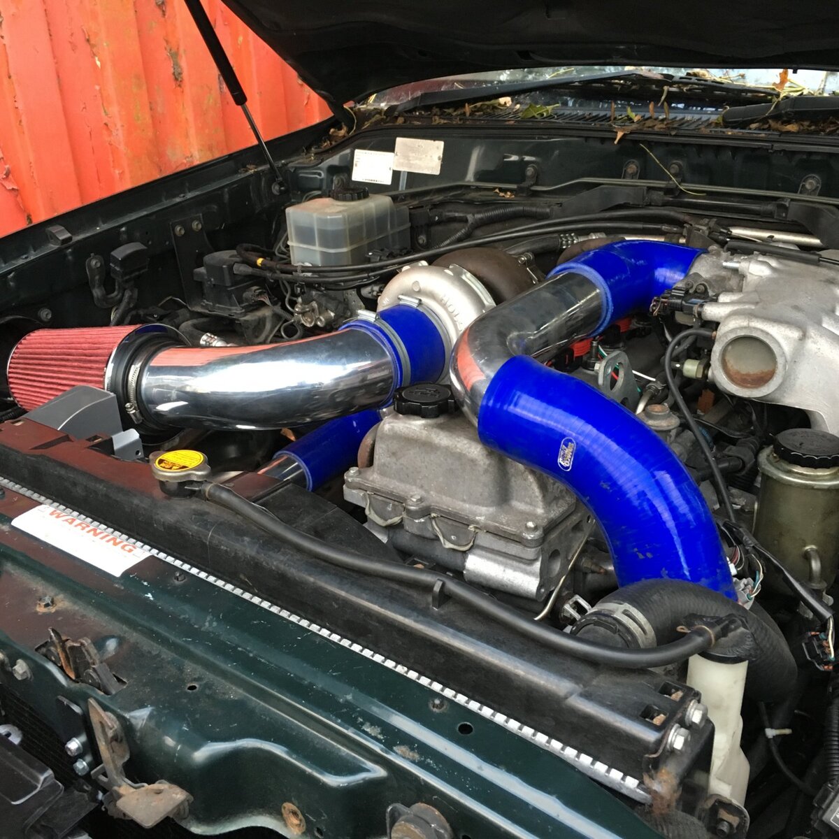

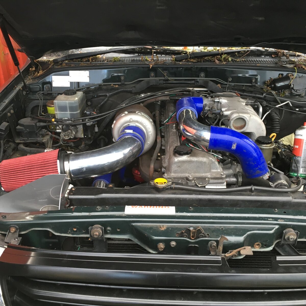

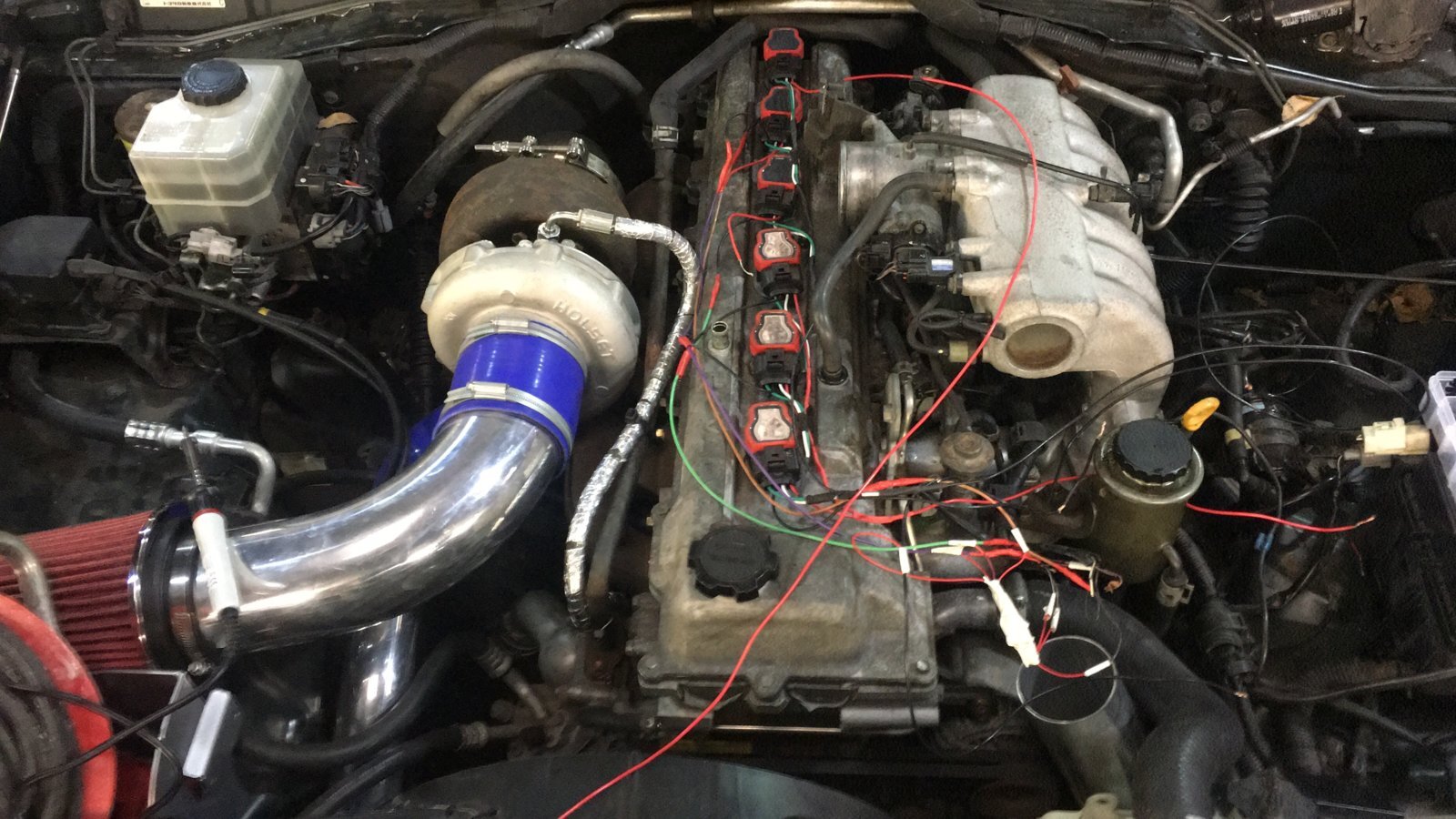

Well it’s up and running of a fashion, just having some fuel and boost cut issues, once a friend of mine had made a couple of circuits up to fool the ecu we will be away. Looks like I might have to go smaller on the turbine housing, currently a 25cm possibly a 22cm housing will do the job, worst case I will have to find a 19cm housing.
BD39A025-3D2F-43D7-9141-D439DBD07D81.jpeg 9F42E22C-FFA8-49C9-A960-21C37EF61415.jpeg DA695535-7403-4833-B106-FBA0312C777B.jpeg
So it turned out the original turbo was slightly to big, I’ve now got a slightly smaller turbo fitted up, it’s off to have the downpioe and exhaust made on Wednesday.

Fuel and boost cut issues have now been sorted with some clever wiring done by a freind.
