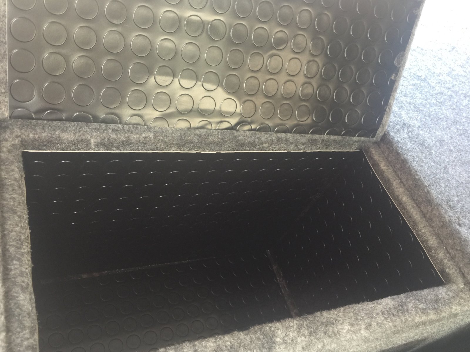

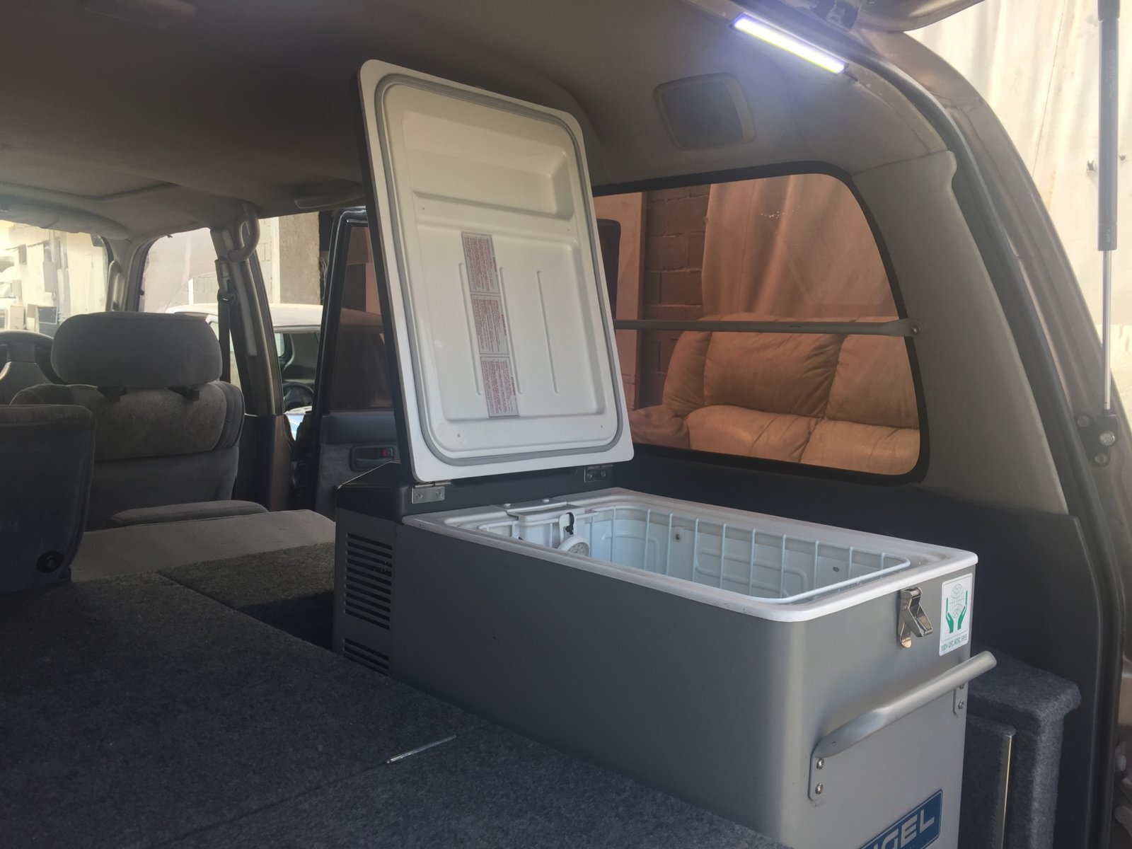

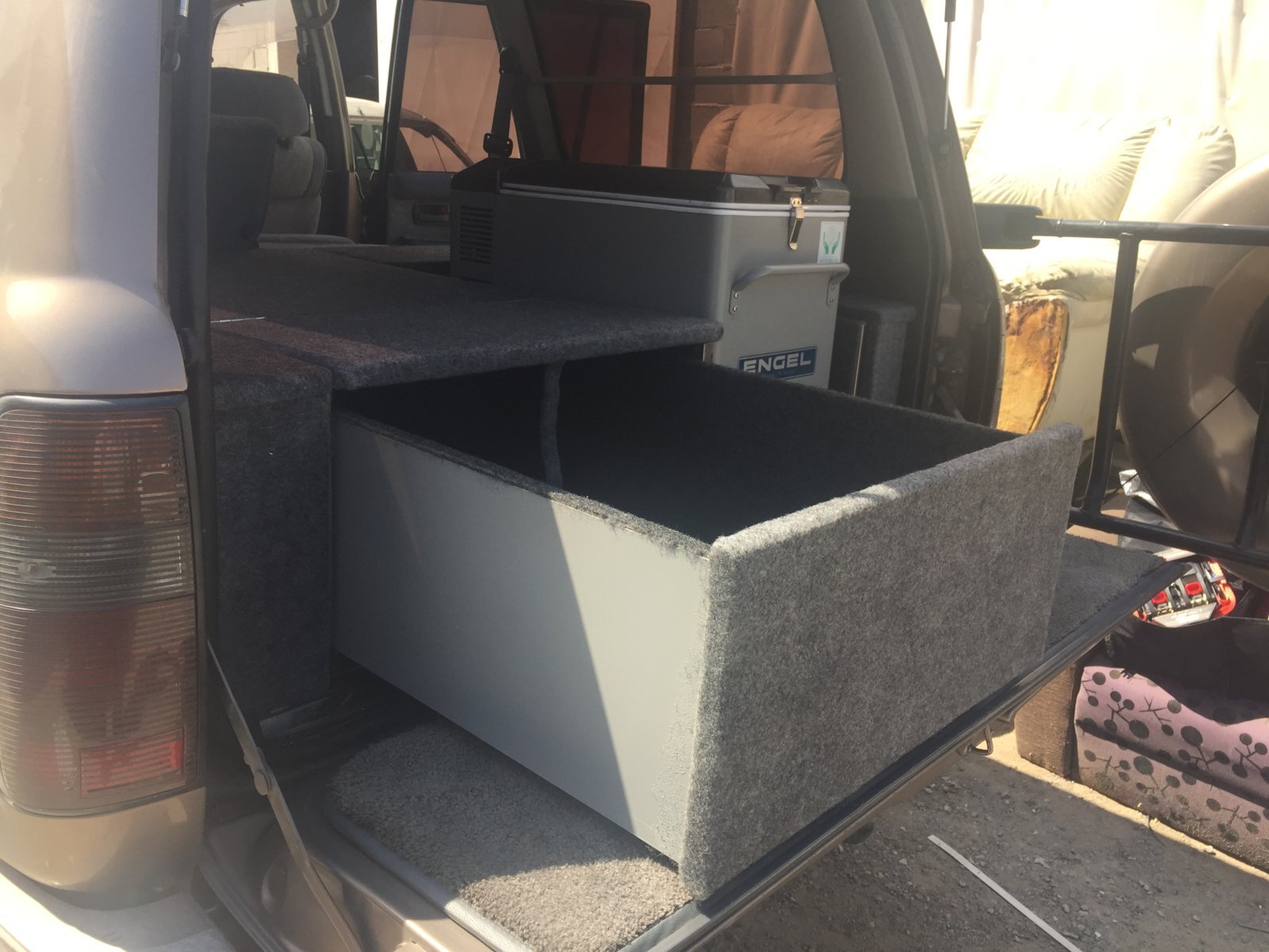

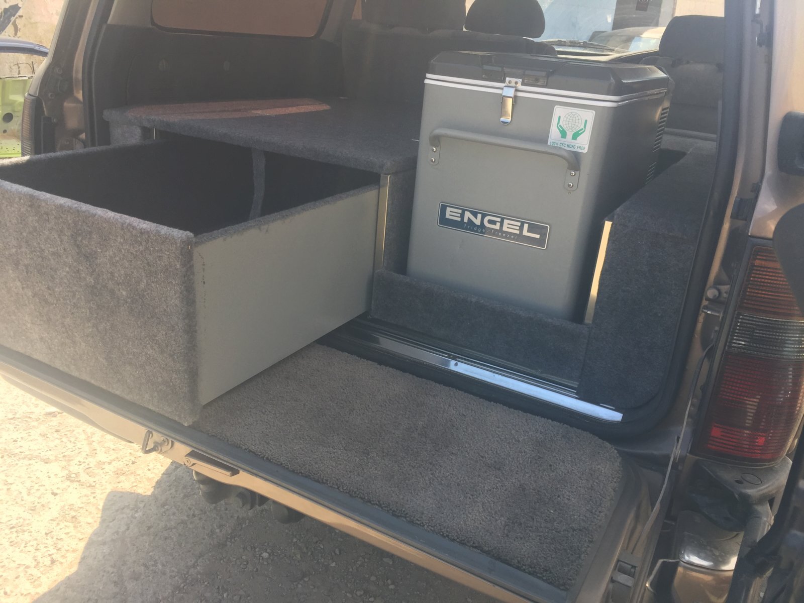

The slider with the lid open accessible within the tailgate for easy access works out low enough to be useful. IMG_6456.JPG View attachment 141676

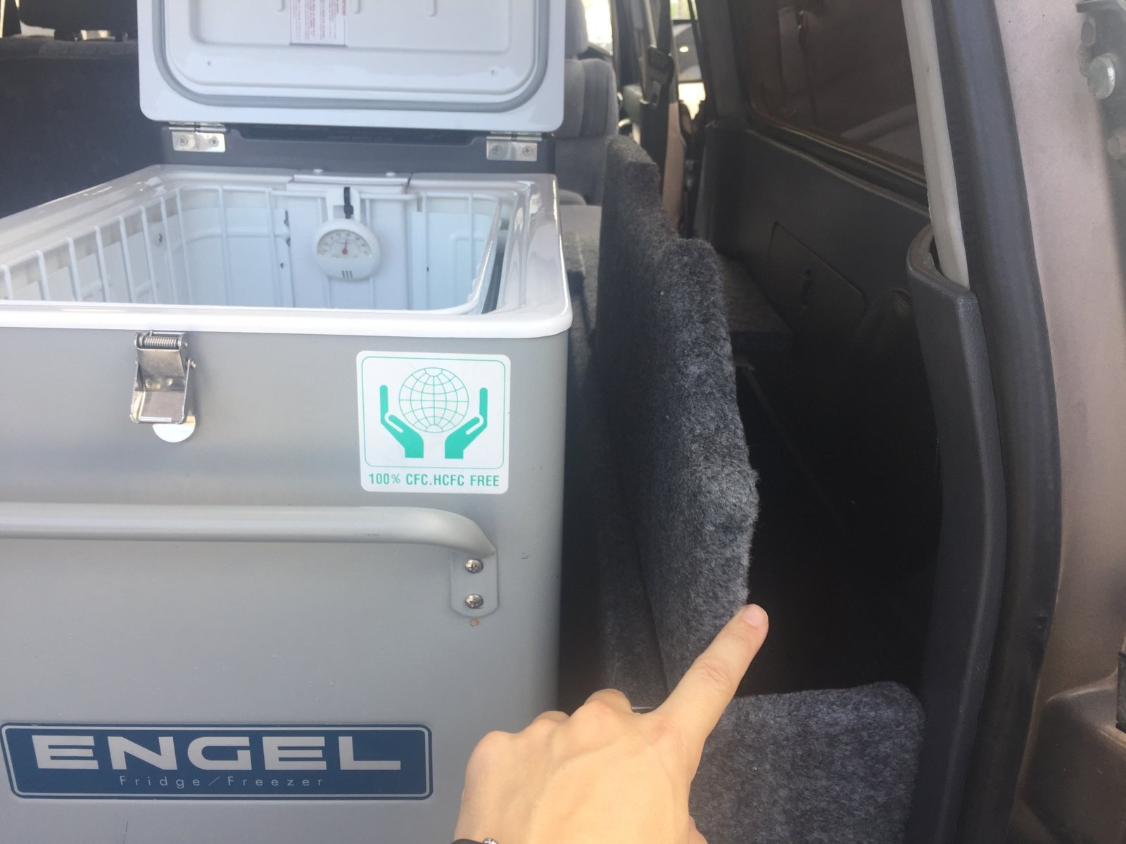

Both side access panels with invisible handles...storage for longer narrow items and importantly access to the factory vehicle storage areas.

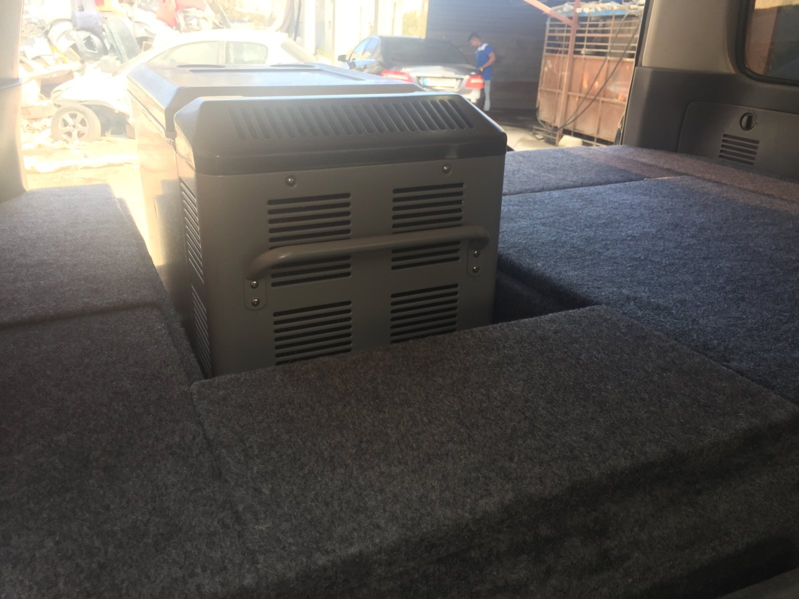

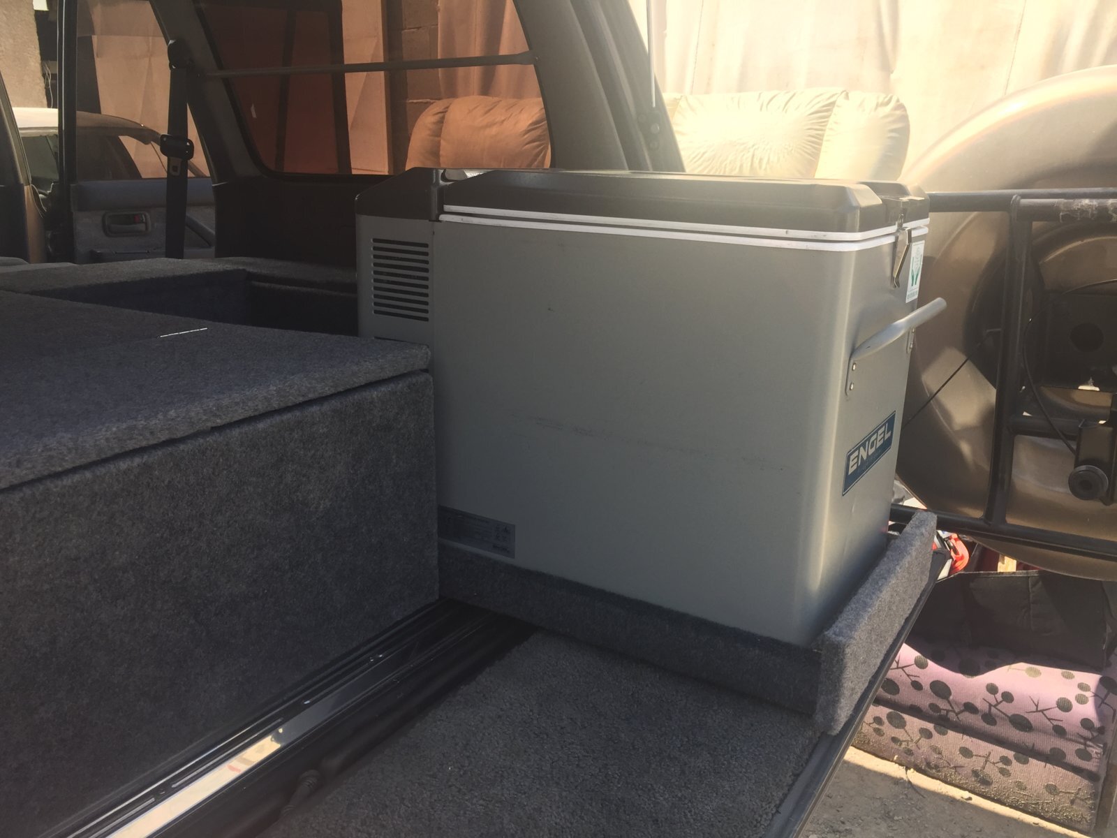

Pull out fridge slider with support fixings not to slide on the move. Handle is the fridge for simplicity.
Fridge view from the rear and battery enclosure with electronics fixings to be fitted inside.
left more than 2cm space on the sides and more than 10 cm at the rear for airing and cables.
Battery & electronics enclosure with plastic cladding at rear separate to everything.

@Dervis Garip, Nice work, I too went with a custom home built version, but had a carpenter friend construct mine, I am not very good with this kind of thing. To keep costs down and make use of space, I had a box built that houses the fridge, this is on a platform that slides out. The disadvantage is extra weight, but I do gain the ability to have another 'cupboard' on top of the fridge. This allows me to use space above the fridge without obstructing the lid.
Where I am struggling is with covering the wood, I used material designed to cover the outside of commercial speaker cabinets, a sort of thin carpet. Looked great but does not stay glued down on corners or edges, of course the speaker cabinets have corner protection which I cannot use on the drawer edges ect.
Still thinking about it, a friend has suggested the cabinet covering used on boats, takes knocks and is weatherproof, have to look into that, Mine is still a work in progress, so still have a chance to change the choice of covering, yours look very professional Dervis, any trade secrets you want to share, friend, good buddy? ;)

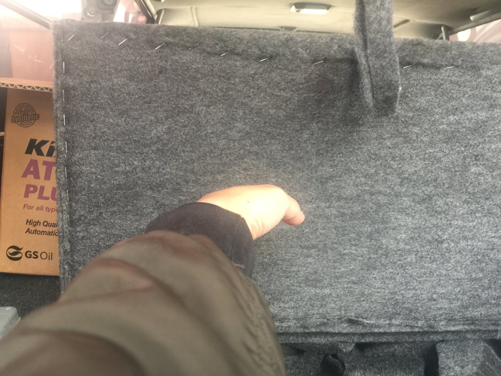

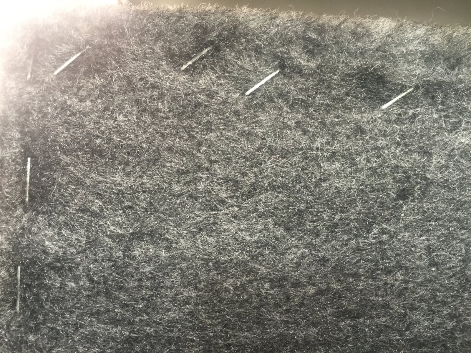

Two factors firstly. One is that for difficult areas mostly turning the material over the corners / back, the guy used a compressor staple gun that worked perfectly and because of the material it doesn’t show.

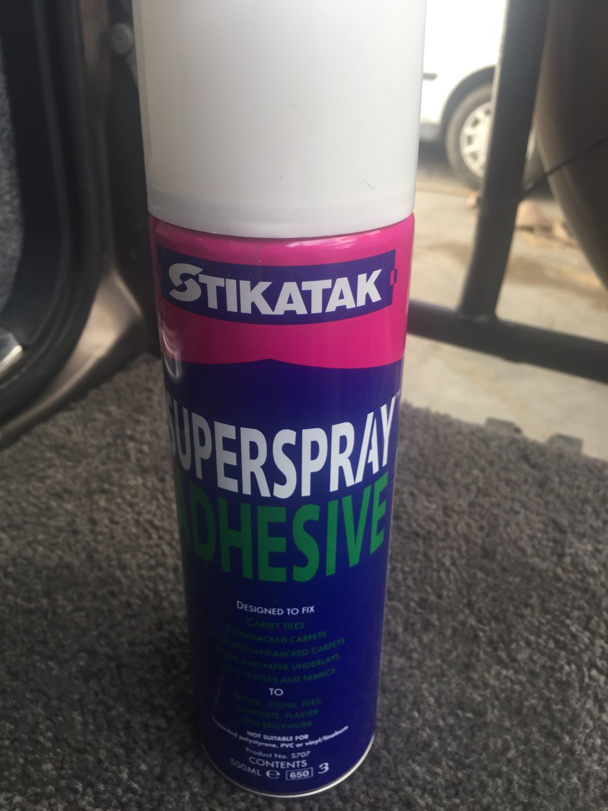

Secondly for flat surfaces used a carpet spray shown that dries almost instantly and hold he material firmly straight.
For your reference a couple of pictures.

9B50EB2F-ACCF-4ED7-8CBC-93441BB78FE8.jpeg 38ECF8D7-19BE-4167-866A-458086C6A504.jpeg FE0C4CFB-FA01-49C6-B30A-296ECACD6A0F.jpeg 55101395-B499-427B-BEB0-48F96A637175.jpeg

Here you go Dave, I wanted a spray adhesive too, https://www.ebay.co.uk/itm/Stikatak...hash=item520724330e:m:mLe80ulQ1dqhcRqdeZP5skQ
Thanks for that Chas, £4.88 a tin not bad, unfortunately they want £12.95 per tin to post it to me, :icon-biggrin:, I will try to source something closer to home.

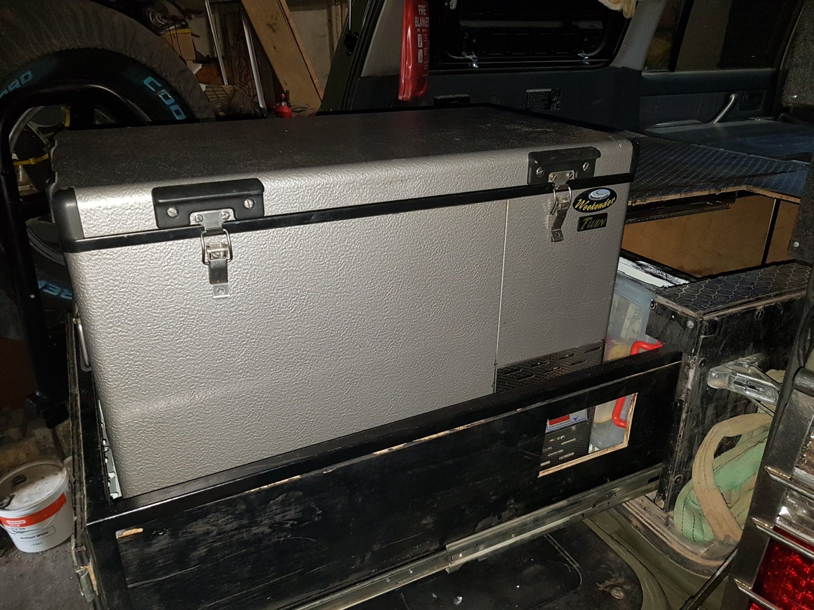

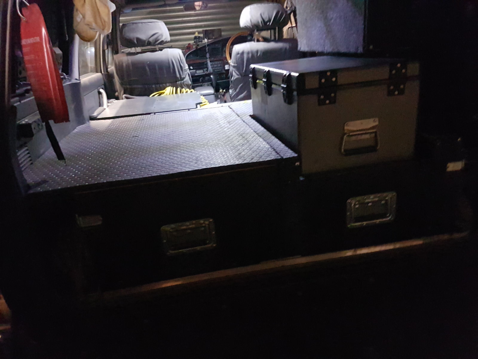

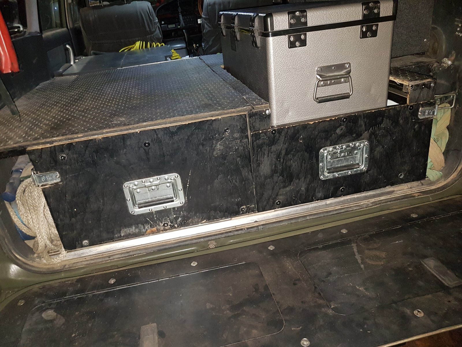

That's a bugger, it's free post here, anyway more pics of my relocation of the fridge;

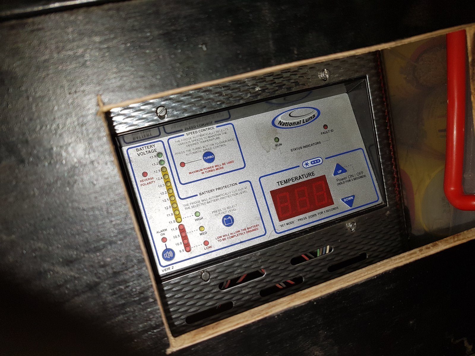

Hole cut in the side of drawer for access to the control panel (to be cut a little larger I think), drawer pulled out, drawer pushed back, and sleeping area with a nice memory foam mattress (not there at the mo), and a fresh coat of paint on the back of the drawers would be good.

Yes, I am very pleased with it, I have lost some storage area but also some has been freed up where the fridge used to live, it remains to be seen where I will fit in my camping equipment though.

Nice cut out there Chas, I see what you mean now. Your fridge looks a bit bigger than mine there. How's losing a draw affected your storage requirements for you?
