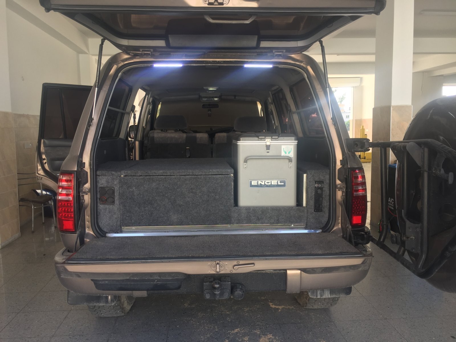

    Guys quick update electrical work competed.... fridge freezer now working to use at leisure. More to come shortly.

    Budget update on cost Guys are set below.
    Carpentry
    1000TL carpentry labour and materials £190
    100TL Material trim labour £20
    145TL Carpet / Plastic £26
    40TL Carpet spray £8
    7TL Hinges £1.20
    Grey Spray already had - FREE
    Electrical & Accessories
    Handles draw £12
    Lighter 4 plug £10
    Switch 3 plug £15
    12 plug Twist £6
    Bat guard £18
    600TL Auto Electrical Labour inc 100amp battery £120
    Total £426.20
    Fridge Freezer £400
    Grand Total £826.20
    So guys pretty happy with this price point hopefully Living up to the listing name.

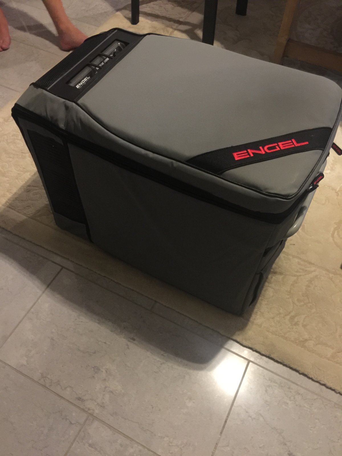

    Today sprayed the bronze galvanised handle ready for fitting next week. Also kinda have to get a fridge insulation cover for the Engel MT45 as the heat here is intense to reduce amps and also cool down faster.
    Sadly these are pretty pricey not budget material!! :crazy:
    Other than that pretty happy so far having a functional fridge in the car for food, water making life that much richer in every day life. :thumbup:

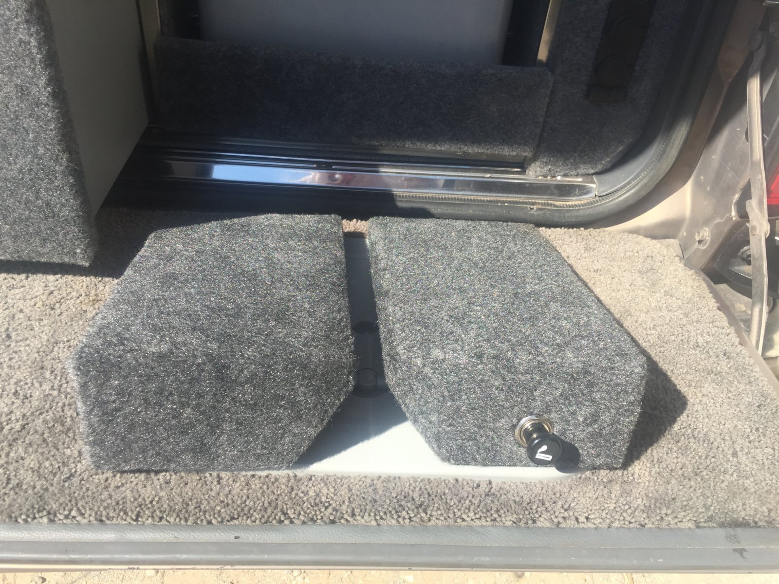

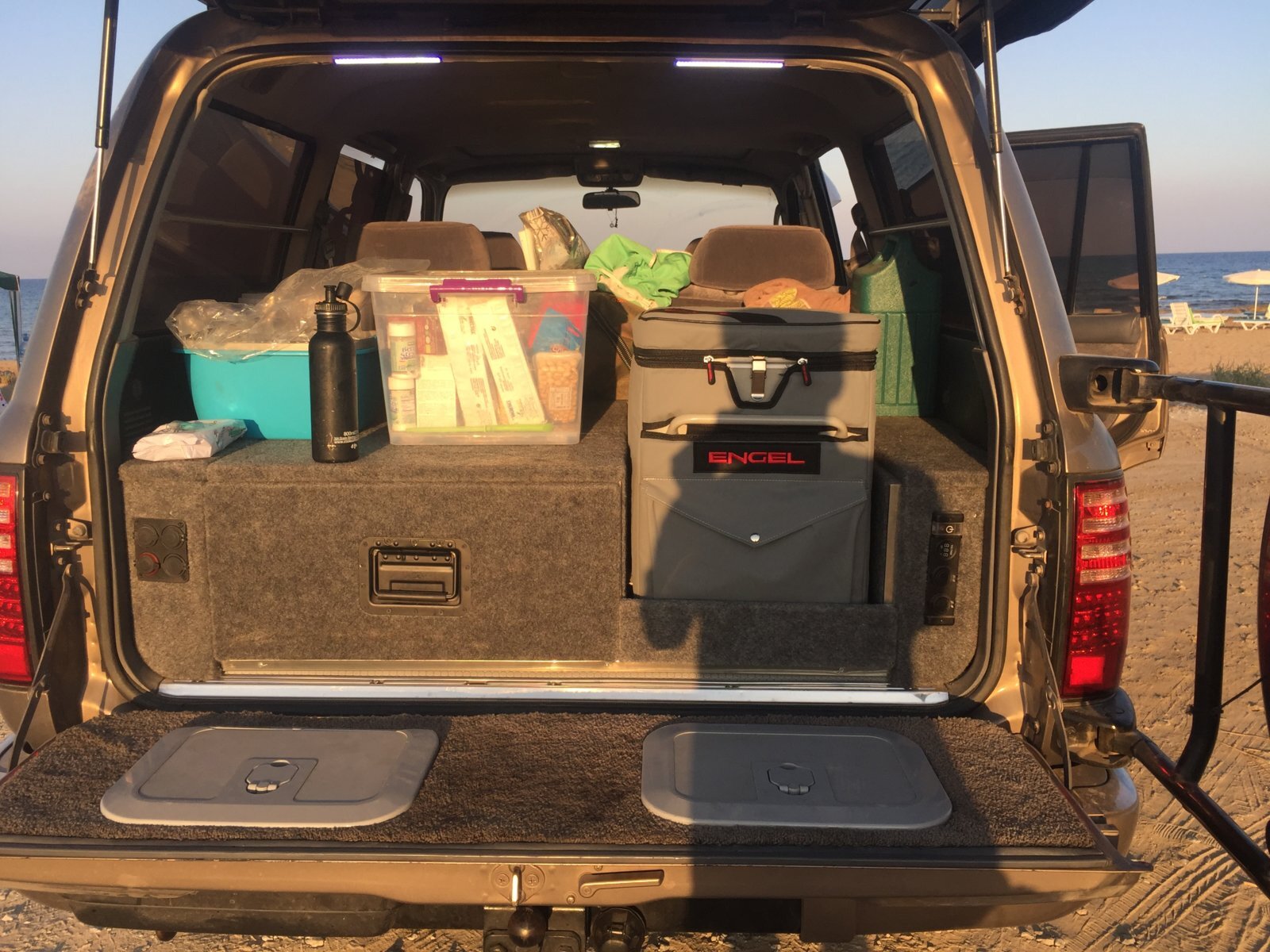

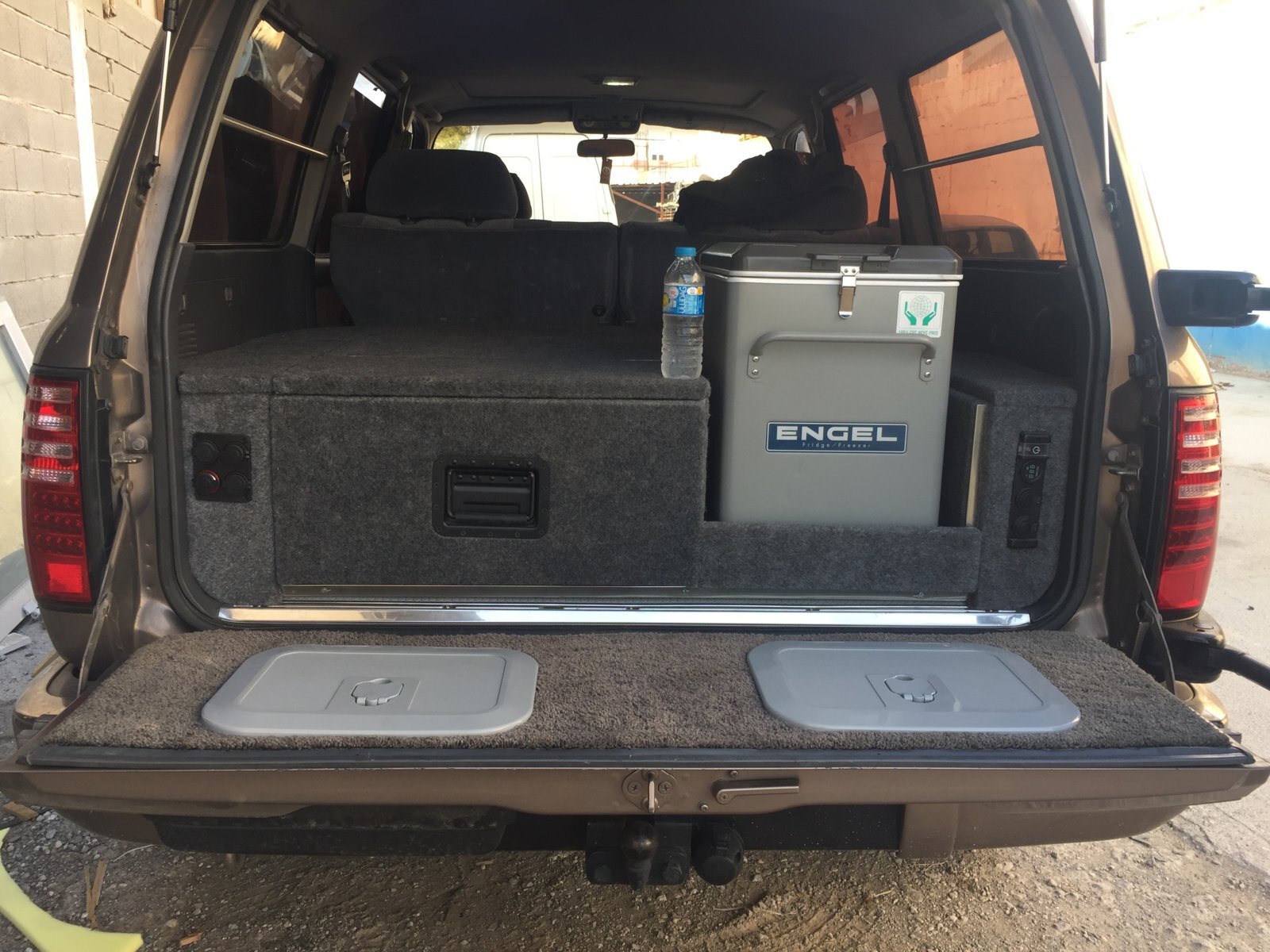

    Guys today fitted the handle and made two side wooden covers for under the flaps to protect separate and the electrical wires at the rear.
    Just need to carpet them next and their finished.

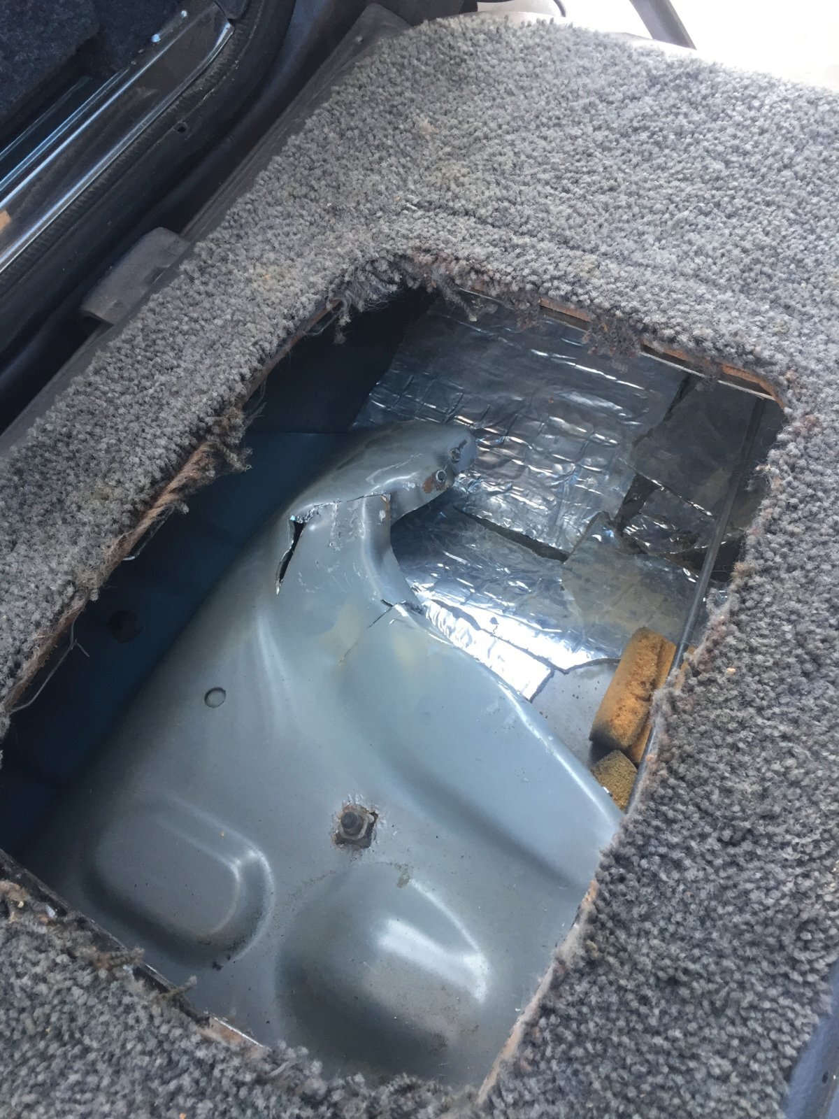

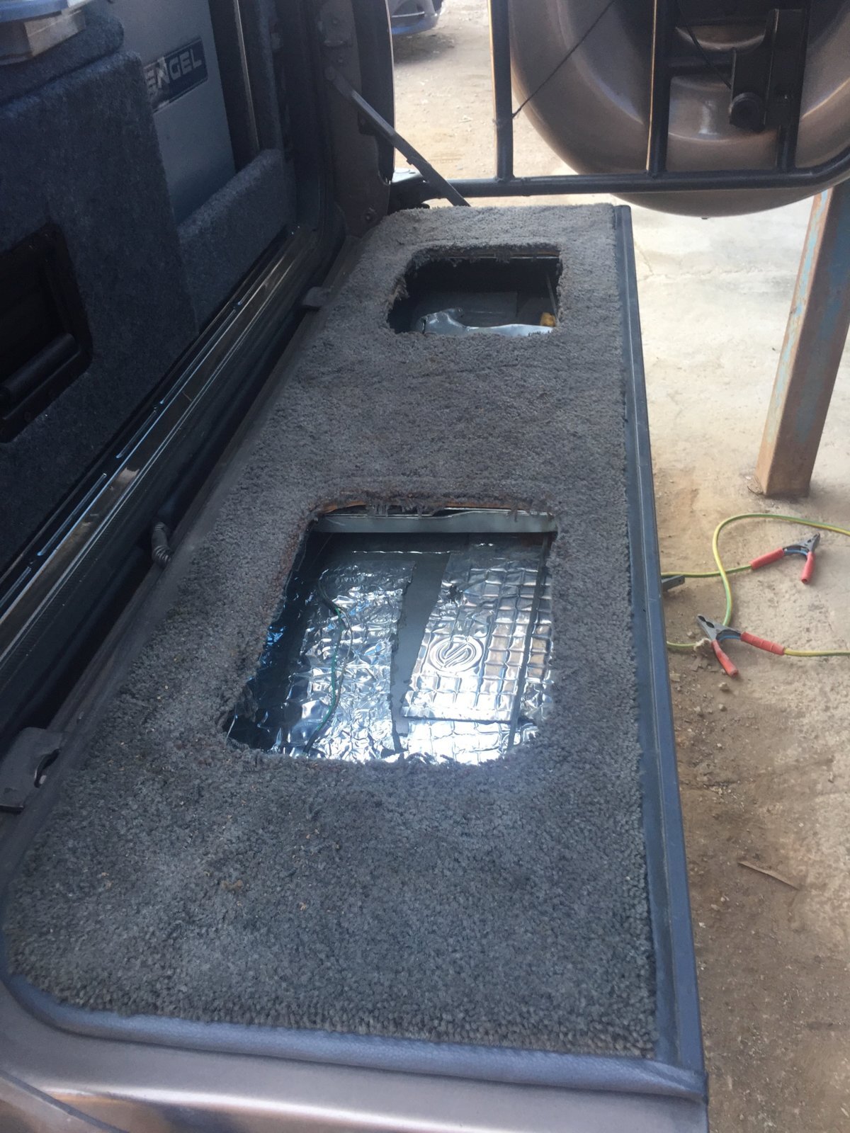

    Also part of this budget build ordered two marine hatches to cut and fit to the tailgate for recovery gear.
    There’s not a great deal of space so couldn’t justify a large price tag so £50 was the total cost here.
    Got the idea from a lady member off IH8MUD some years ago.
    A nervous attempt on cutting started then visited a car Bodyshop friend where they thankfully cut away the sheet metal for me.

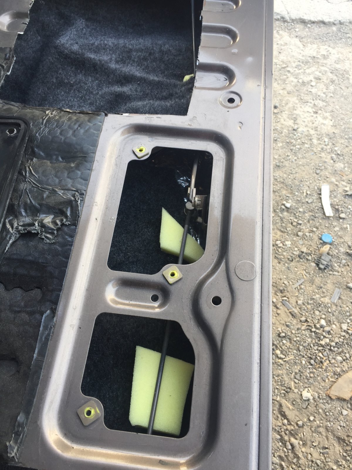

    First measured and cut around the carpet then marked out the metal sheeting.
    The right side was harder as their were a sheet brace attached to the top sheet. This was cut and beaten down as much as possible.

    Then I used some spare carpet with adhesive I had left over to cover the unattractive , no flat sharp cuttings with newly cut sponges.

    The final look I'm pretty happy with for a morning work been worthwhile upgrade. The marine hatches come with locks but not sure at this point if their necessary.

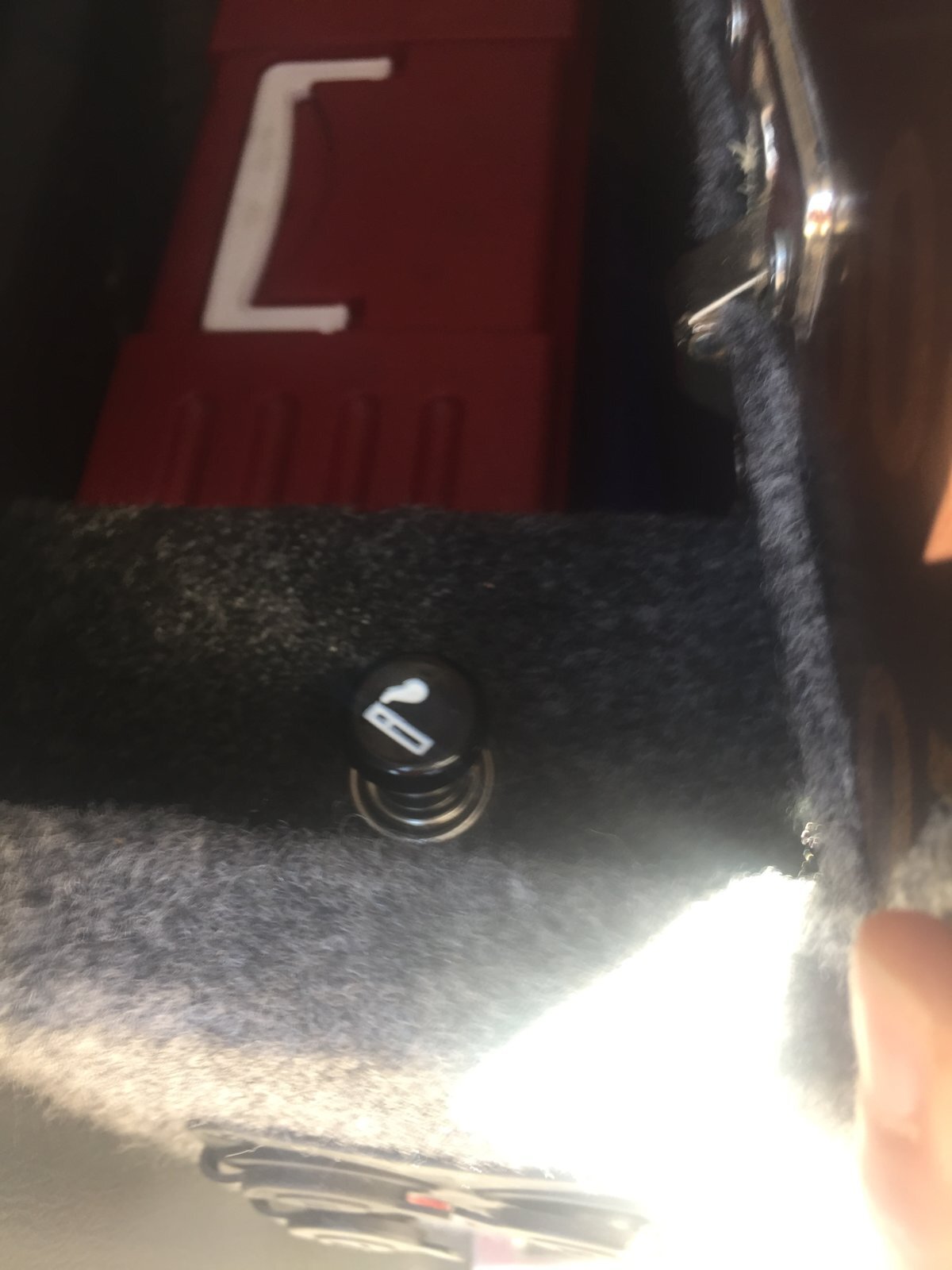

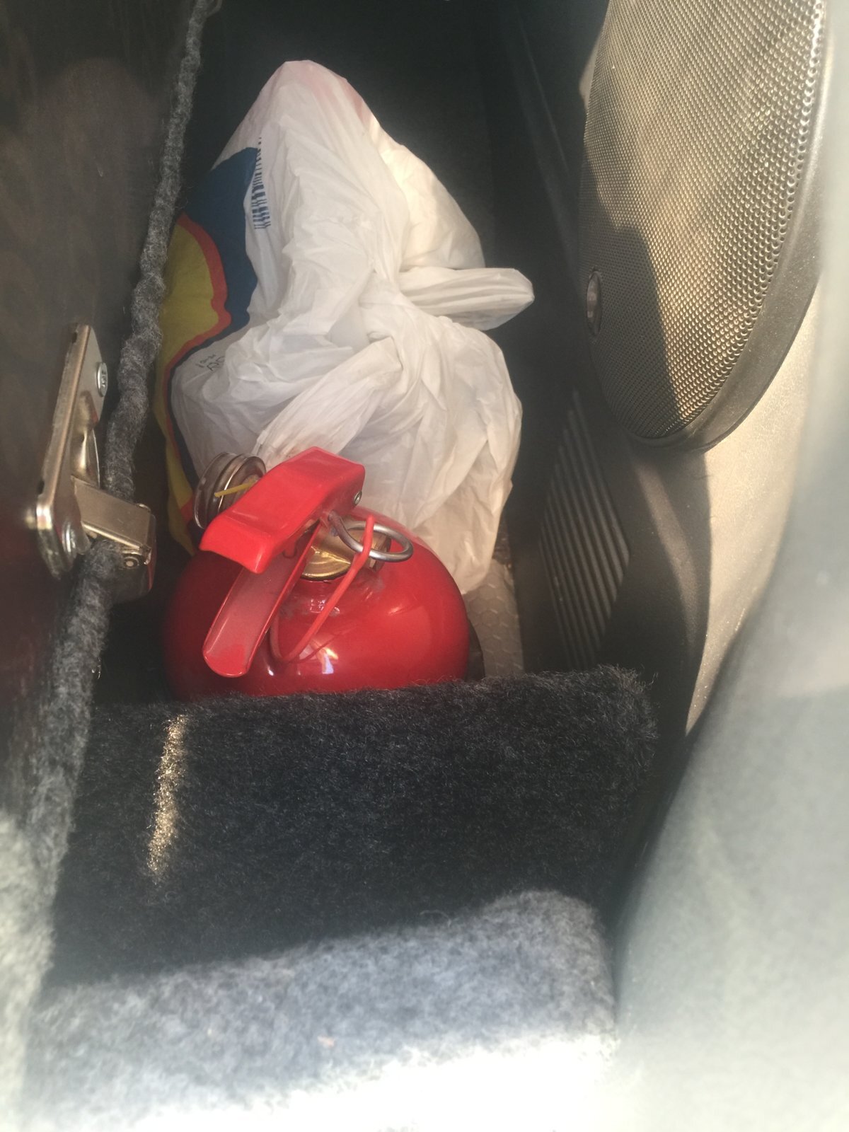

    Another small detailed job was to protect and shield the electrical wires on both side enclosures. Cut and measured to fit then wrapped in the front only carpet gave a nice finished.
    Extras were a lighter housing home on the left and an 2kg fire extinguisher fitted with bracket to the right side protection cover.

    That's looking superb. I have some of those marine hatches saved on my e bay wish list. Don't know what for but they just looked great. Great idea to use them in the tailgate
  13. Dervis Garip
    Dervis Garip Well-Known Member Supporter I am in cyprus
    1,664
    797
    113
    Garage:
    Map
    Thanks Chris just frees up space for a home for recovery gear and tools. Paid like £45 on eBay for them and then just ones own labour to fit.
    I couldn’t fit the 1kg in the tailgate so I opted for the 2kg and rearranged on the side enclosure.
    Going through the motions on all the things to pack and organize I’m realizing there’s a lot !!
