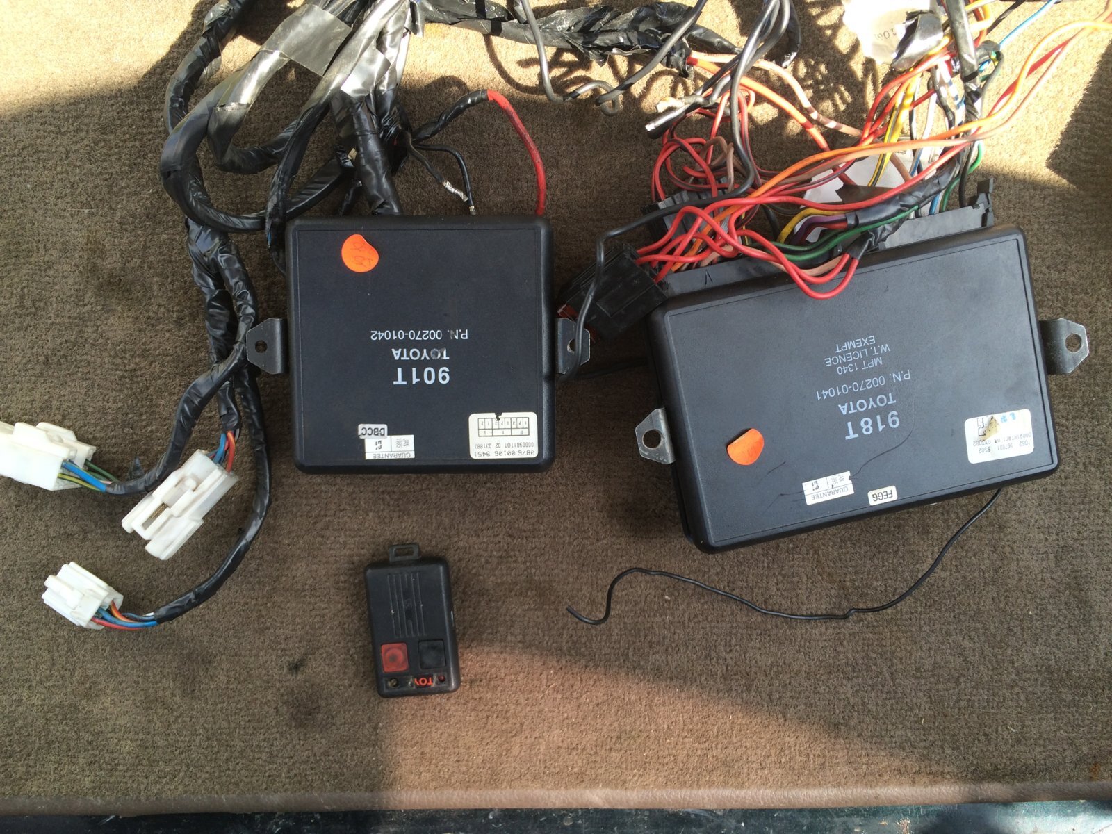

my guess is the immobiliser, was it just a flat battery in the switch for it? did you just run a bypass wire to the fuel solenoid to get it started?
I striped it out of the ignition completely to get it started. Now I'm behind the glove box taking the rest of it out, what an uncomfortable job, And you need hands like a midwife! :icon-biggrin:

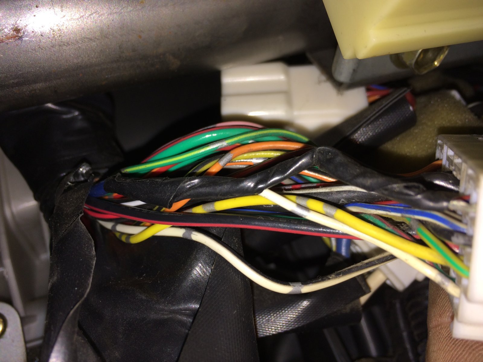

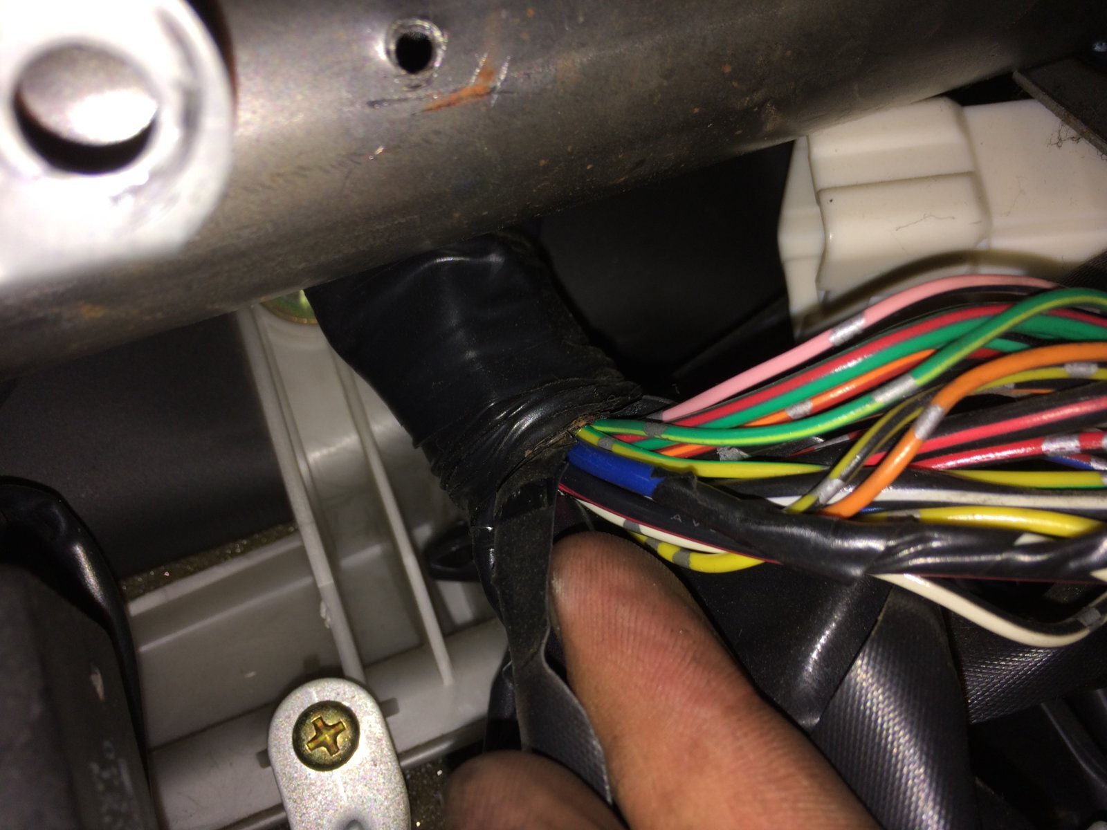

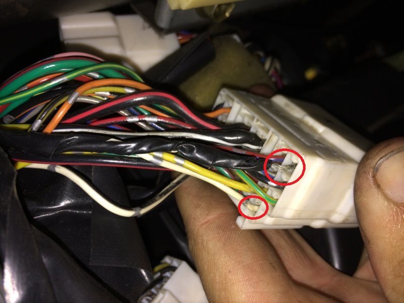

A large white plug behind the glove box where some of the wires from the immobiliser were connected has a odd connection and I'm not sure what to do with it.
The larger blue wire at my finger has a light white wire with a silver dot wire graphed to it and connected to the plug. Where does the blue wire go?
The blue wire looks like a outer sleeve with a raw wire and the white wire within.:think::think::think:

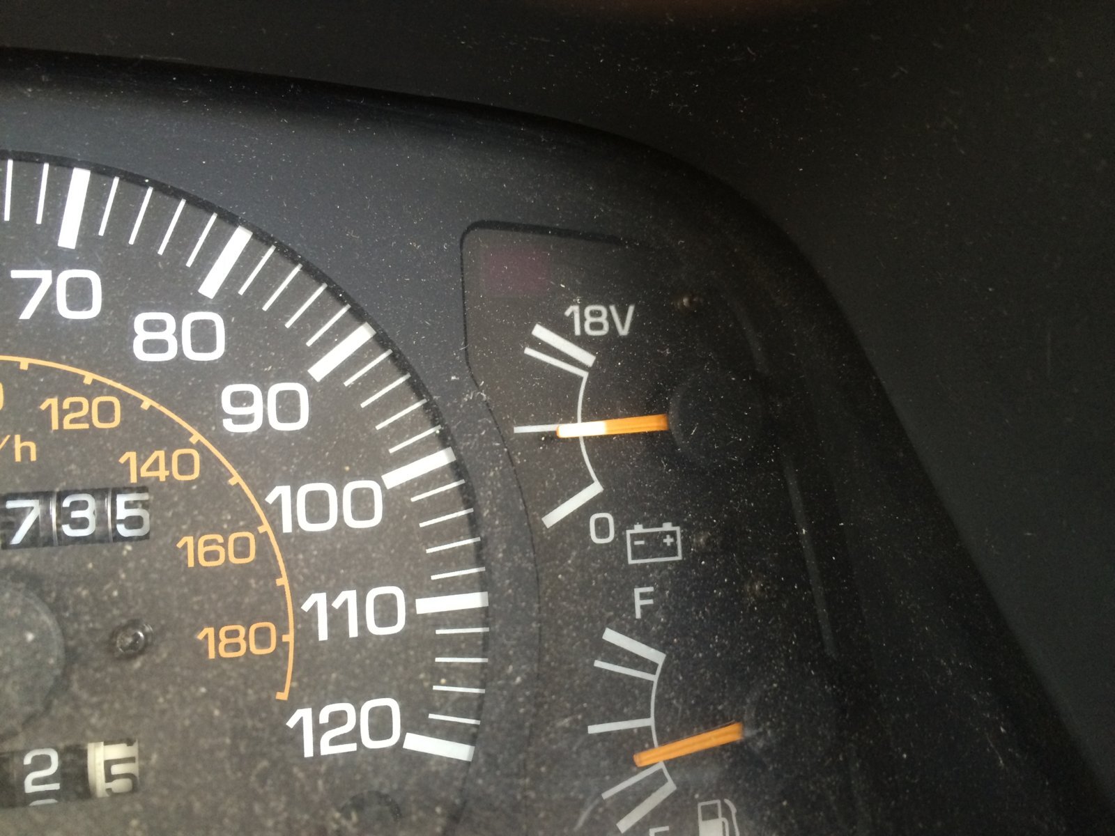

What do you's think of the volt meter only showing half way? First is on start up second is a few minutes later. It's always been like this
Voltmeter looks ok but you need to connect a multimeter to really see with any accuracy what's going on.
Do you get this effect with the engine running, not running, or both?
When the engine is off the volt meter shows just below half as above.
