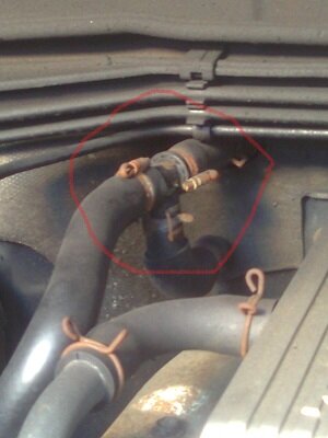

I had planned on pulling these two hoses to flush out the rear system.
Is this the best place to try and flush the rear matrix?
