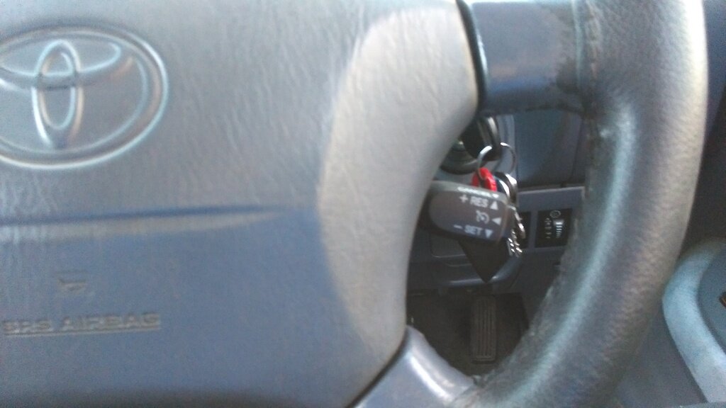

The stalk itself has to be mounted to the steering wheel frame - as Andy suggested, it uses a bracket to do this. I didn't have this bracket, so I made with some light aluminium that I forgot to take a picture of - but holds it steady as a rock.

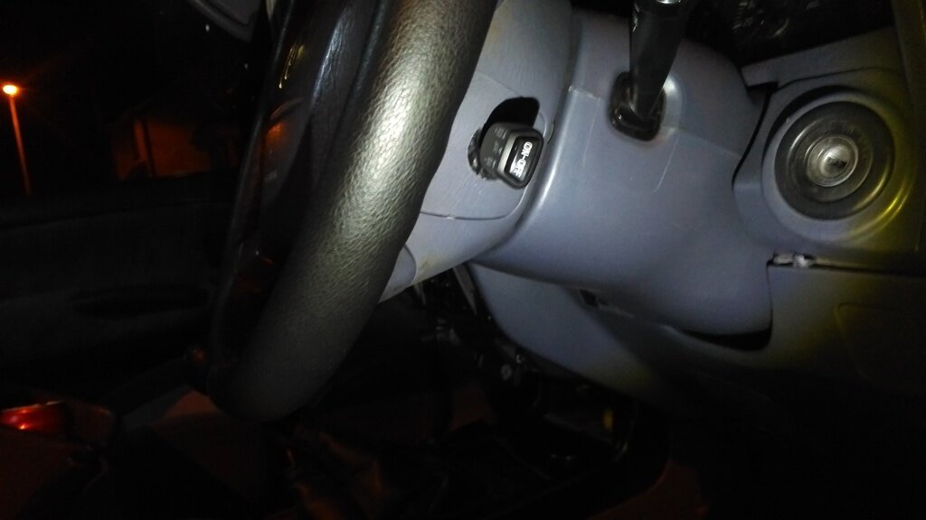

Then replace the bolt that limits clutch pedal return with the switch unit seen here. The wiring loom for this is already in place. it can be found taped to the bulkhead up near the steering column.

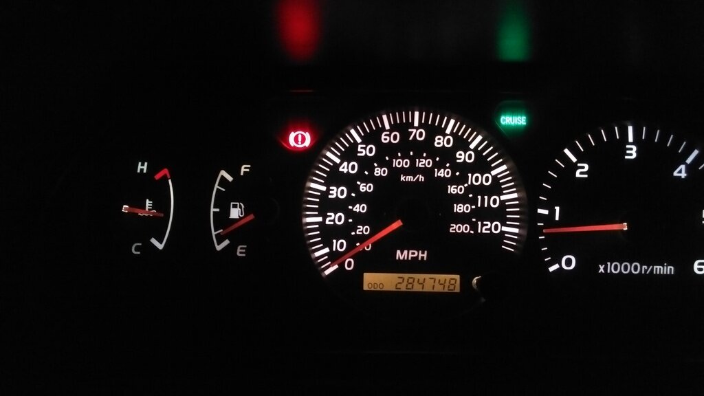

Put the airbag back in and reconnect the battery and voila! Cruise is active...
Took it out on the road and tested everything, and it works exactly as indicated on the stalk. Auto cancel on both brake and clutch works perfectly. Happy days!
Cut a 28mm hole in the cover, and put a piece of rubber in it to keep out the dust.

No worries Andy. I'm not convinced that it's designed for the 90 wheel in terms of physical fitment inside, though very easy to fit (start from the wheel centre, not the outside) but in terms of operation it's perfect. I have a feeling the internals are the same on the 2 wire stalks, but the plastic mount is not

Guess what I did today in a spare 3/4 hour this afternoon? Yes Cruise Control for under£16. Simple as Bob says, biggest challenge is fitting it to the steering wheel ( which it wasn't designed to fit). I got some pins out of another plug and joined them to the 2 wires after snipping off the wrong plug and inserted them straight into the socket on the steering wheel.
Took it for a spin up the road, works as it should.
