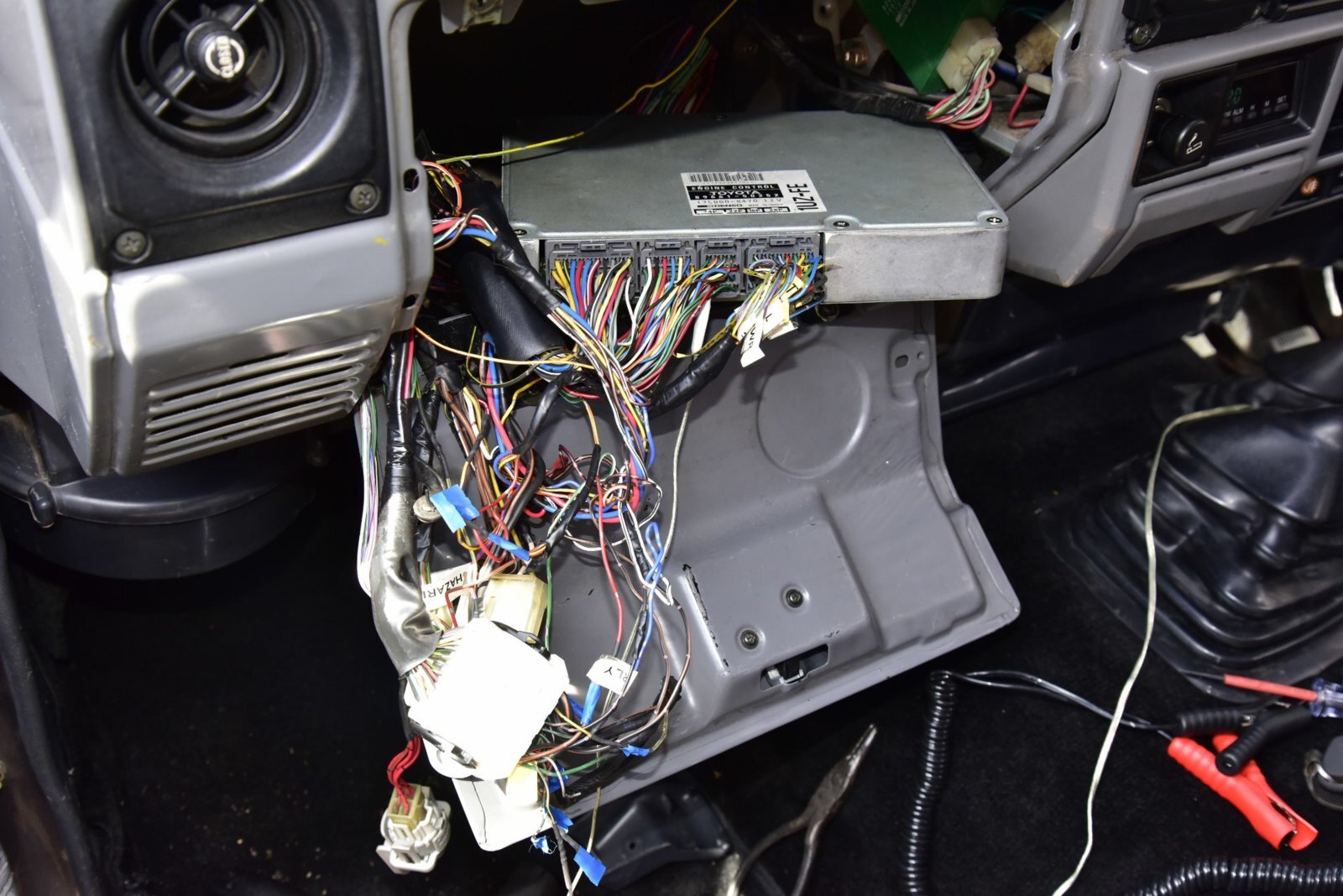

I checked nearly every wire (60? 70?) from the ECU for continuity to its sensor/earth etc. and all good there. Frustratingly, I couldn't read ECU codes with my home-made test light last week, so I bought an LED test light which arrived this morning and worked great by grounding TE1 at the ECU and running the test light from the W terminal on the 16pin ECU plug to the hot side of the ignition switch...and codes at last!
Codes: I got O2 sensors, 1 front (er, the missing one, surprise, surprise genius!) and rear (3 codes in total, 27,28 and 29 I believe). Not a bad start, I figured I'd have a ton of other codes...

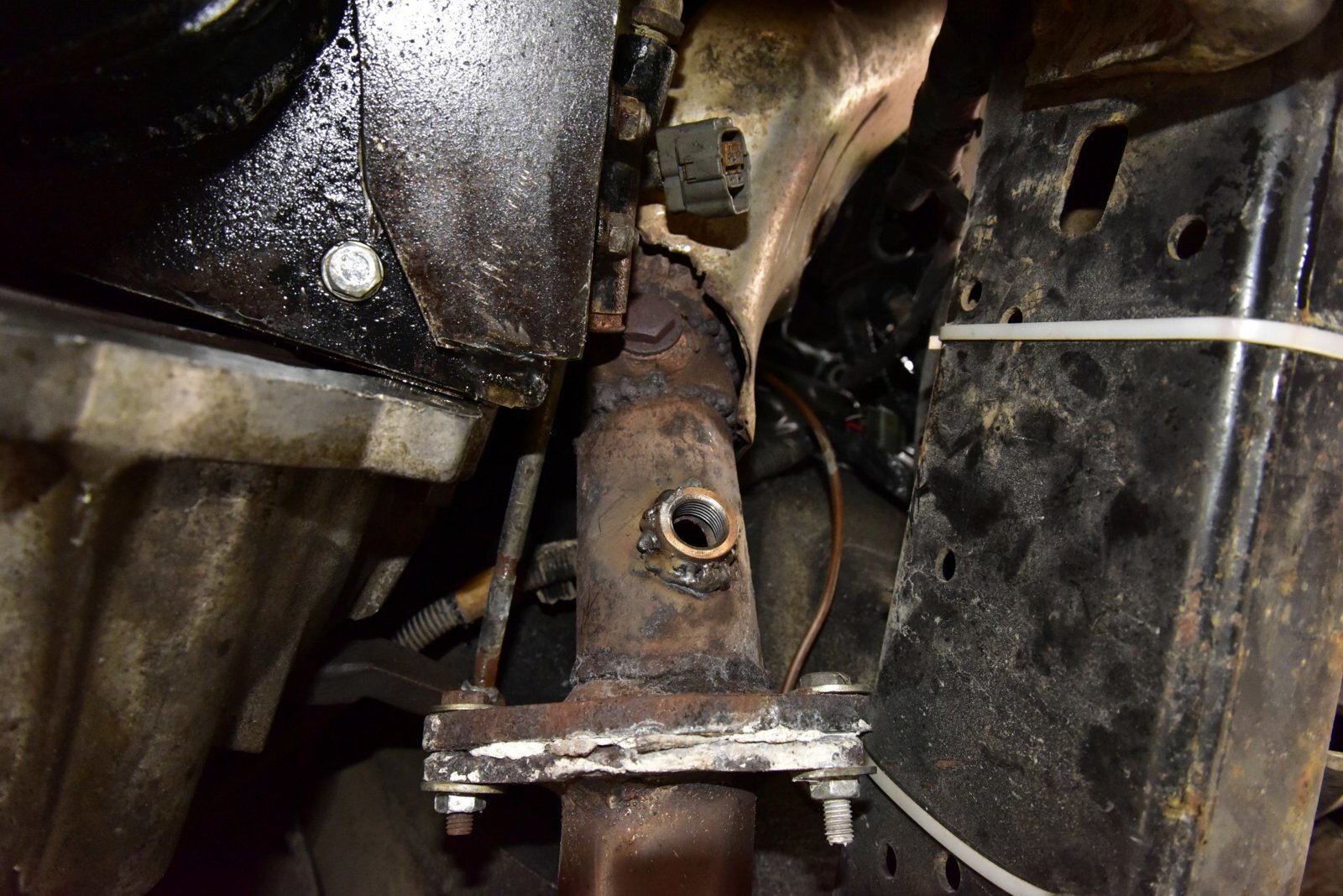

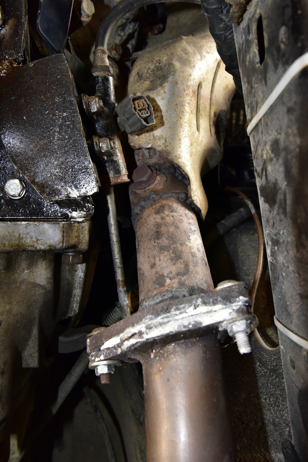

As some may recall, I bought the LJ70 with a missing O2 sensor on the passenger side manifold with a blank screwed in the hole due to clearance problems with the clutch slave, and it was just left this way. Amazing. I don't know how two shops missed this, or did they??

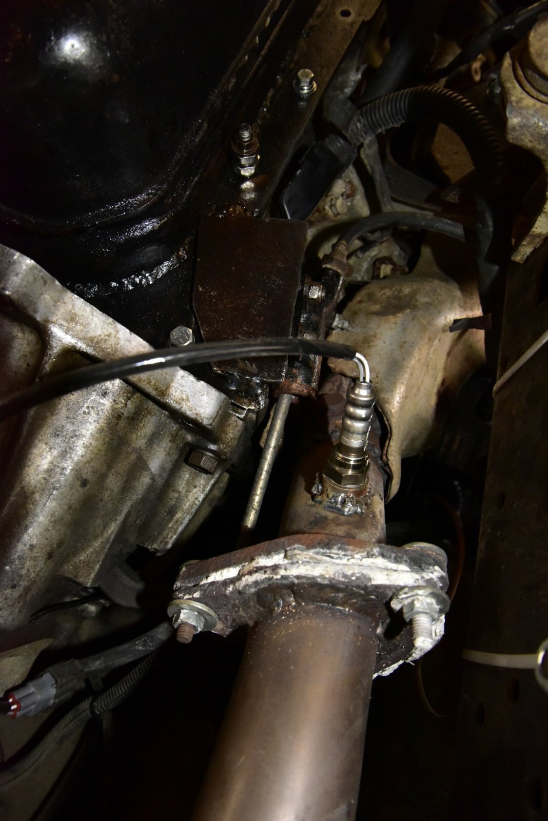

I located a suitable spot, drilled a hole for the O2, MIG welded on a bung and installed/connected a new aftermarket O2 on that side at last. Back in the game, sort of.
I also replaced the O2 on the other cylinder bank as it was black as night and covered in soot.

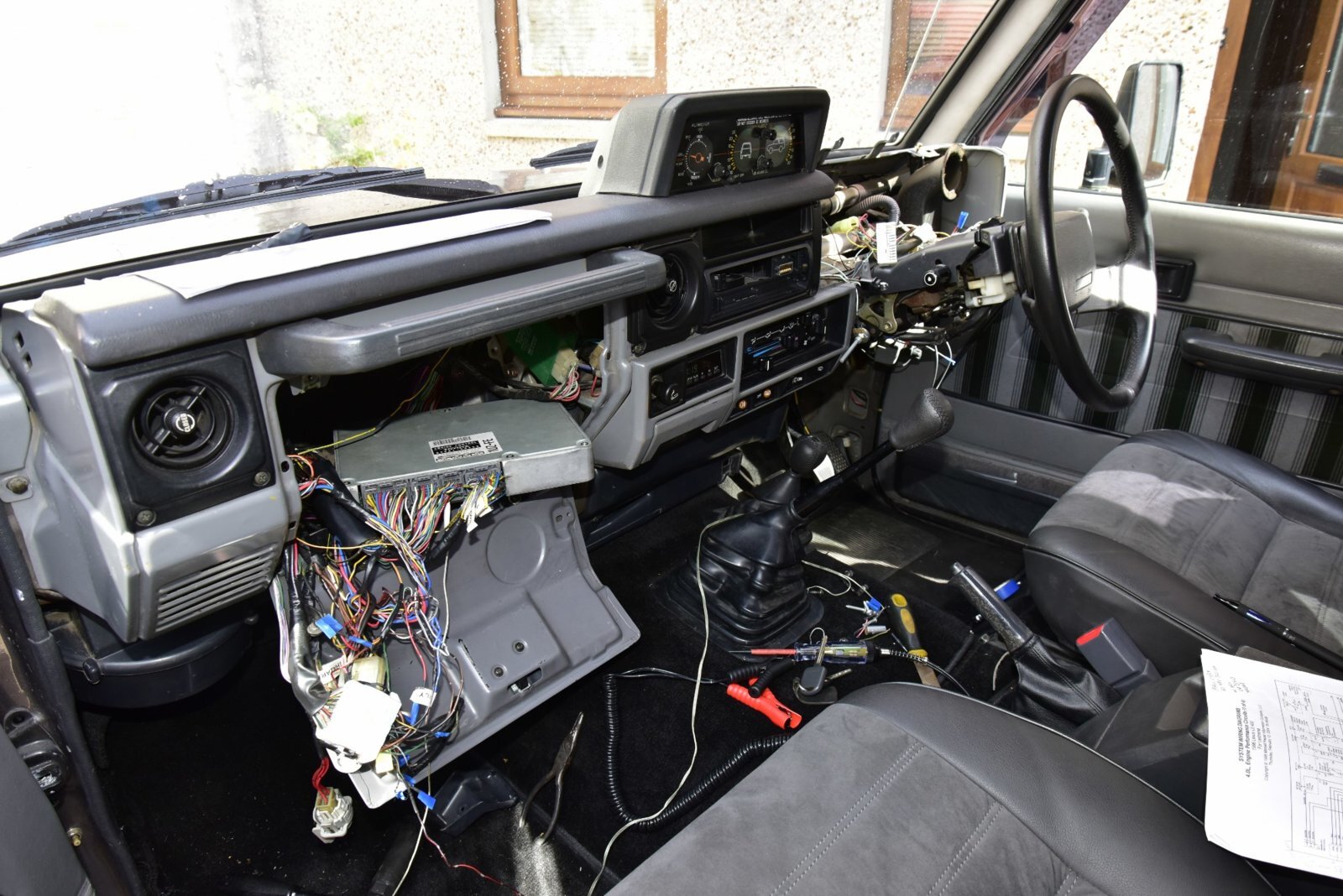

The 'How to Wire a 1UZFE' manual from Nigel Wade in New Zealand has been hugely, I mean HUGELY helpful, but after my DIY O2 install, I'm still stuck with sub-O2 codes (27,29) for the missing rear O2s (post-cat on a narmal LS400, no cat/rear sensors on mine).
The trusty manual says clear these codes by tricking the computer with some 'ghost' sensors. As per instructions, I ran a jumper wire from the missing O2 sensors control output wire to the output wires on the active front O2s on the ECU connectors. I did this, even soldered the connections, but still getting 27,29 sub-O2 codes. I'll do some research, I have to be getting close to this thing running in closed loop and solving my misfire/rich condition! I think I will need to find the connectors underneath for the rear O2s and ground the brown wires - hopefully this will do it.

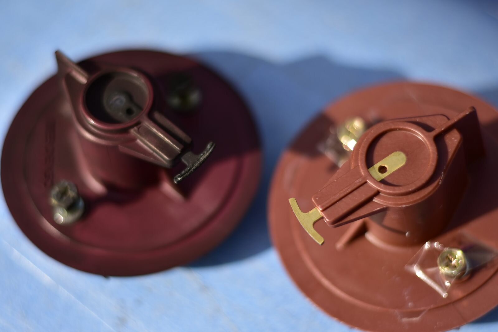

My new plug wires, dist. caps and rotors arrived Sat am, so I put those on, wires first, just to test, no discernable change, so pulled the dist caps after a lot of grief and strong language got them out. Whew. (the covers are a pain on these).
The rotor arm and cap on the left bank of cylinders was awful! Surely this was it! The right side dist cap & rotor was better, but still pretty grotty. I am convinced these are original 1995 parts. Good bye and thank you for your many years of service!
