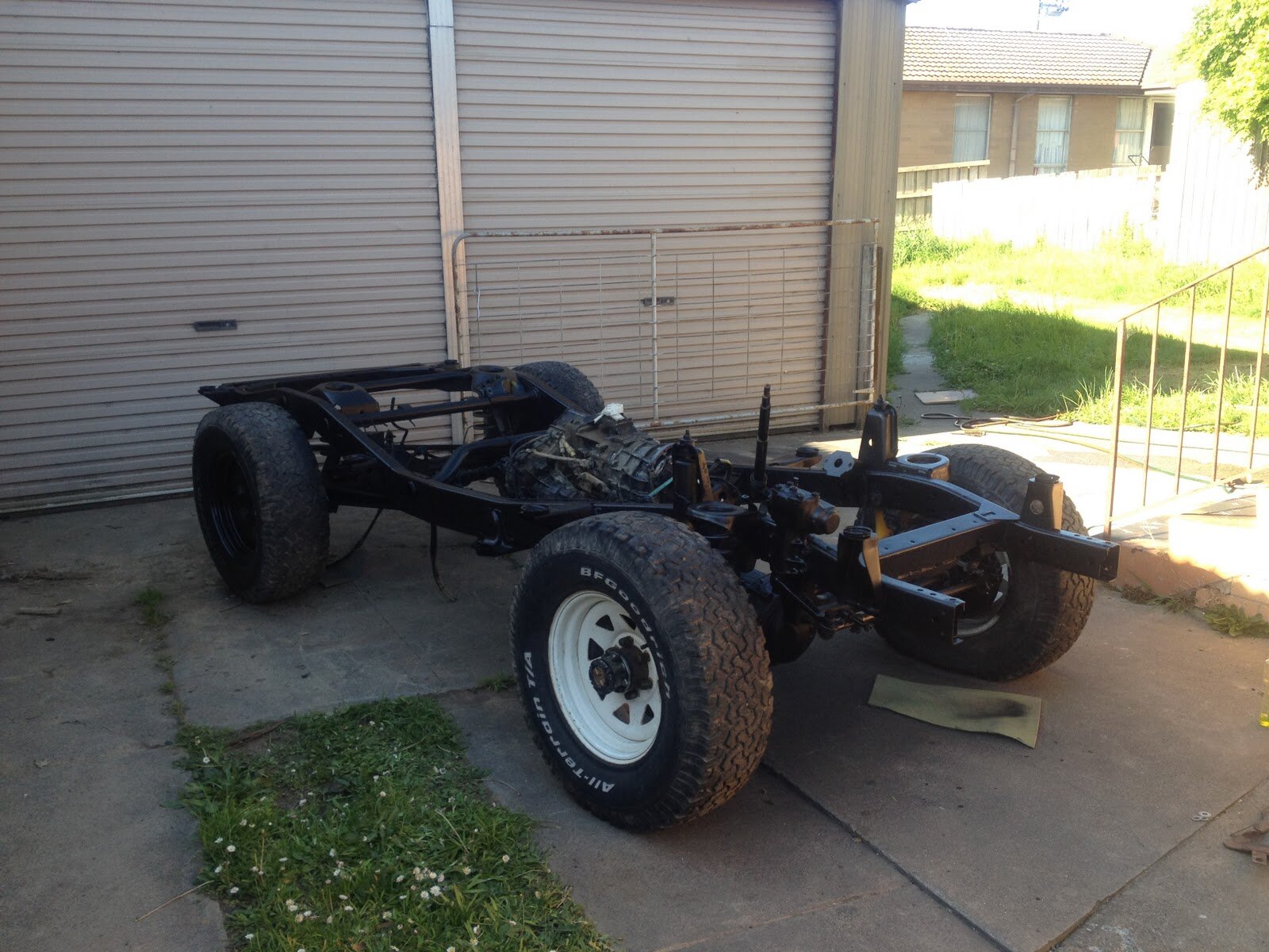

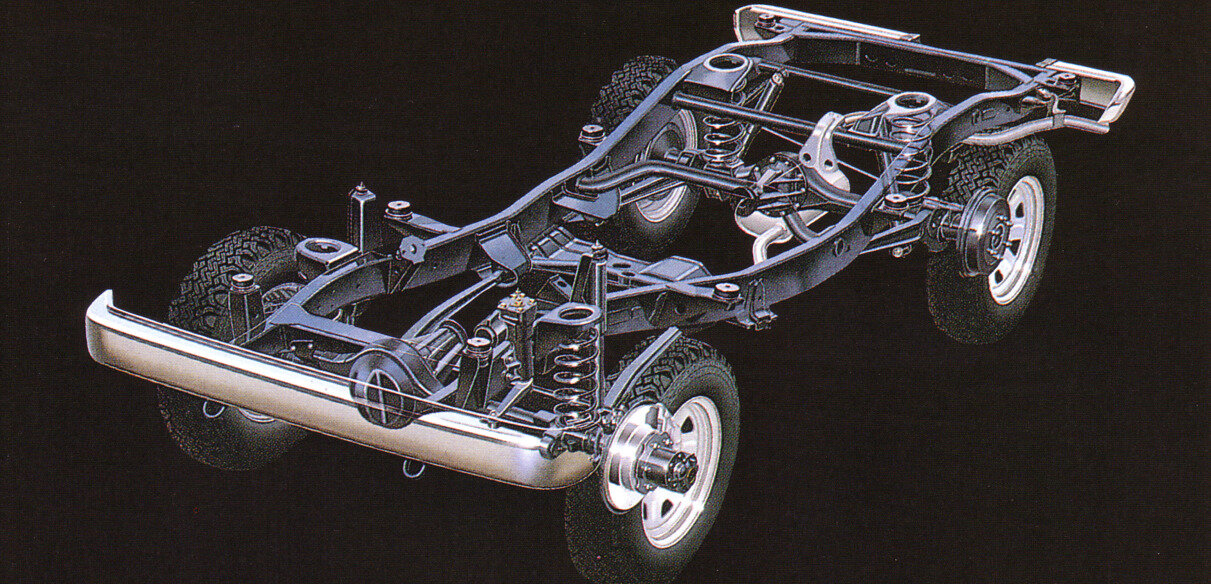

This is what the all coil 70 series chassis looked like?

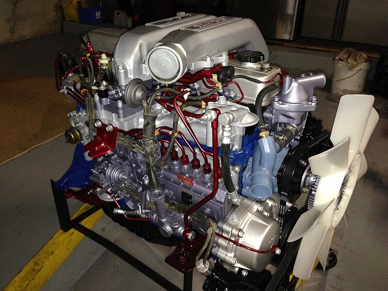

You then take out the small diesel or petrol engine and you drop in a 12HT?
Then you have economy, diesel and plenty of power
