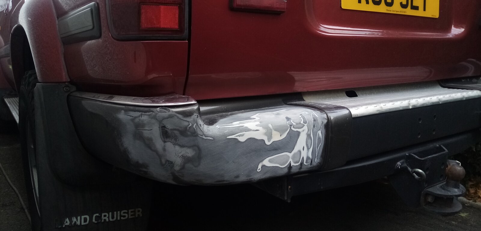

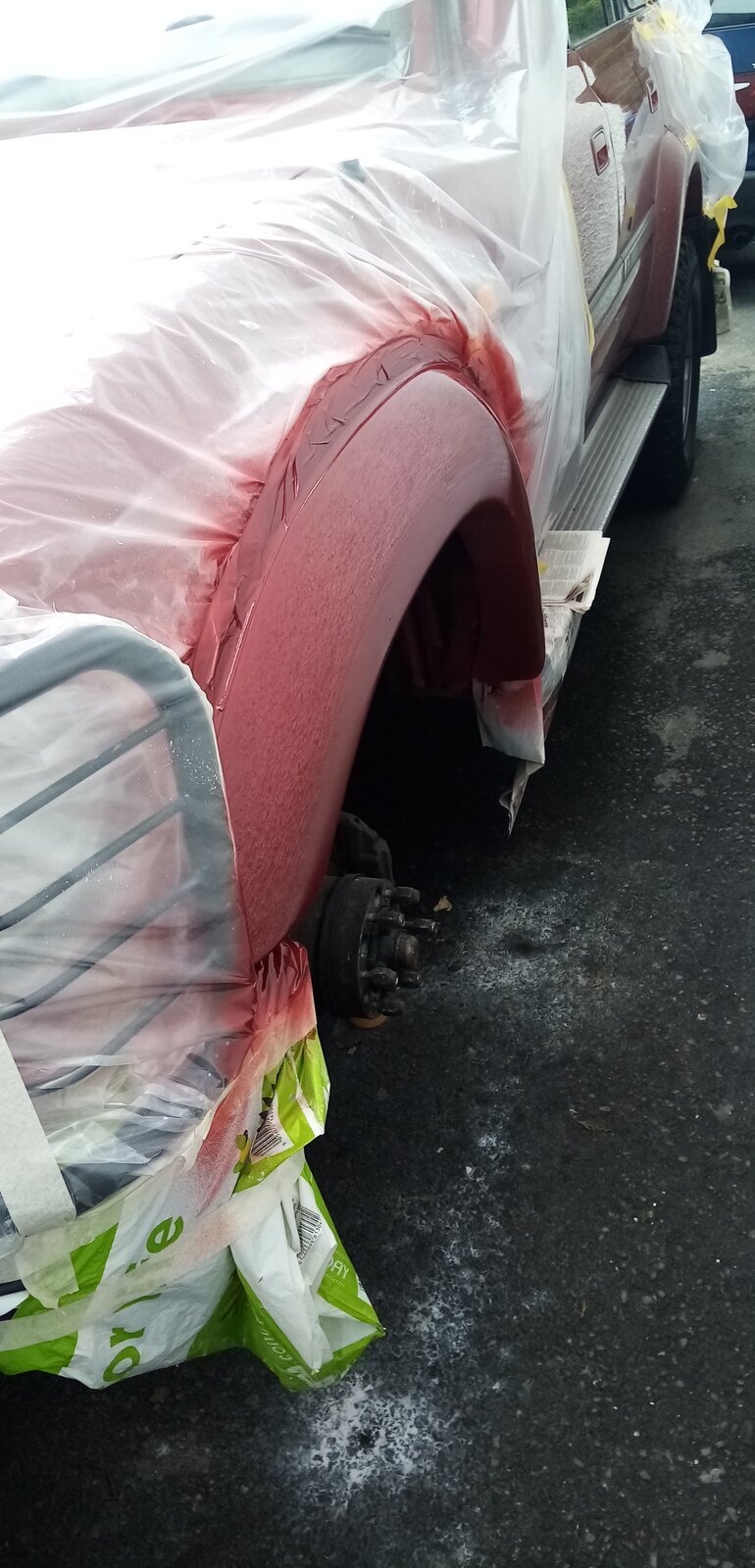

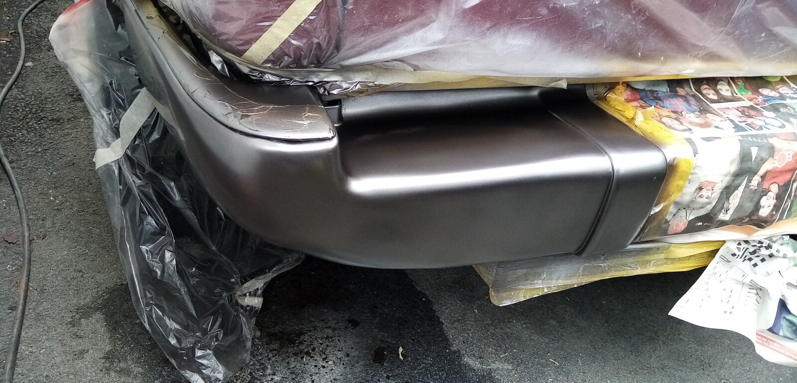

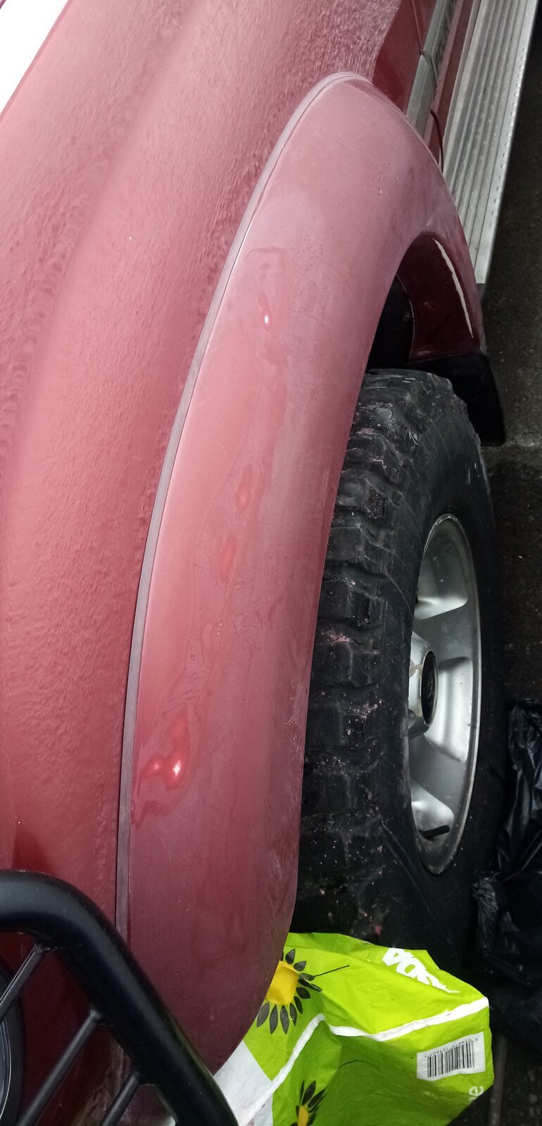

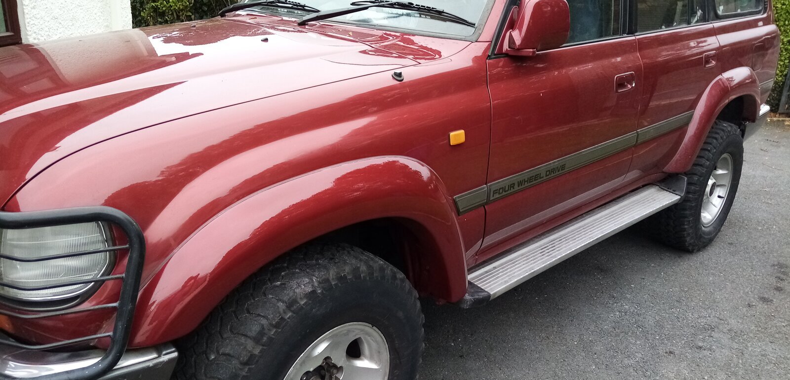

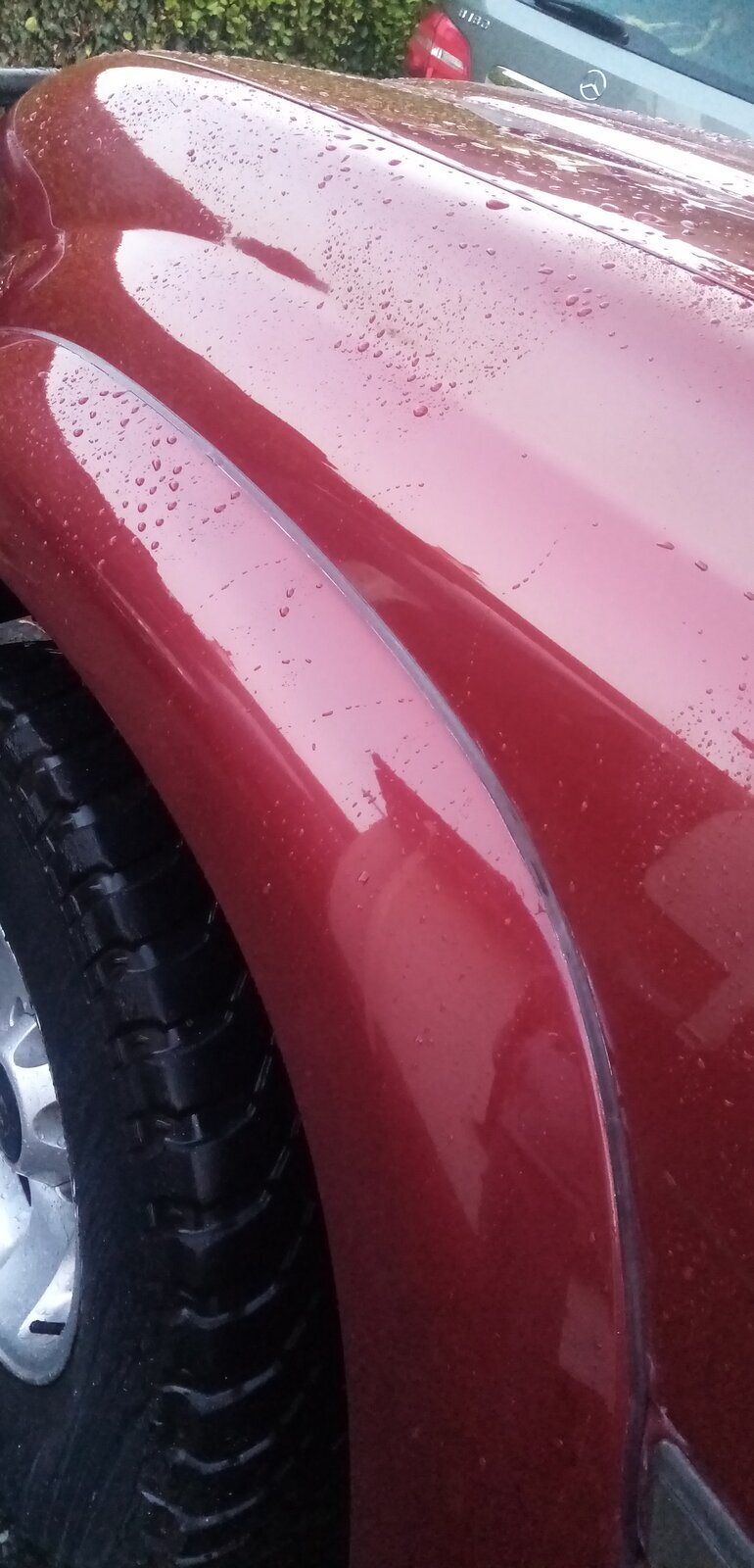

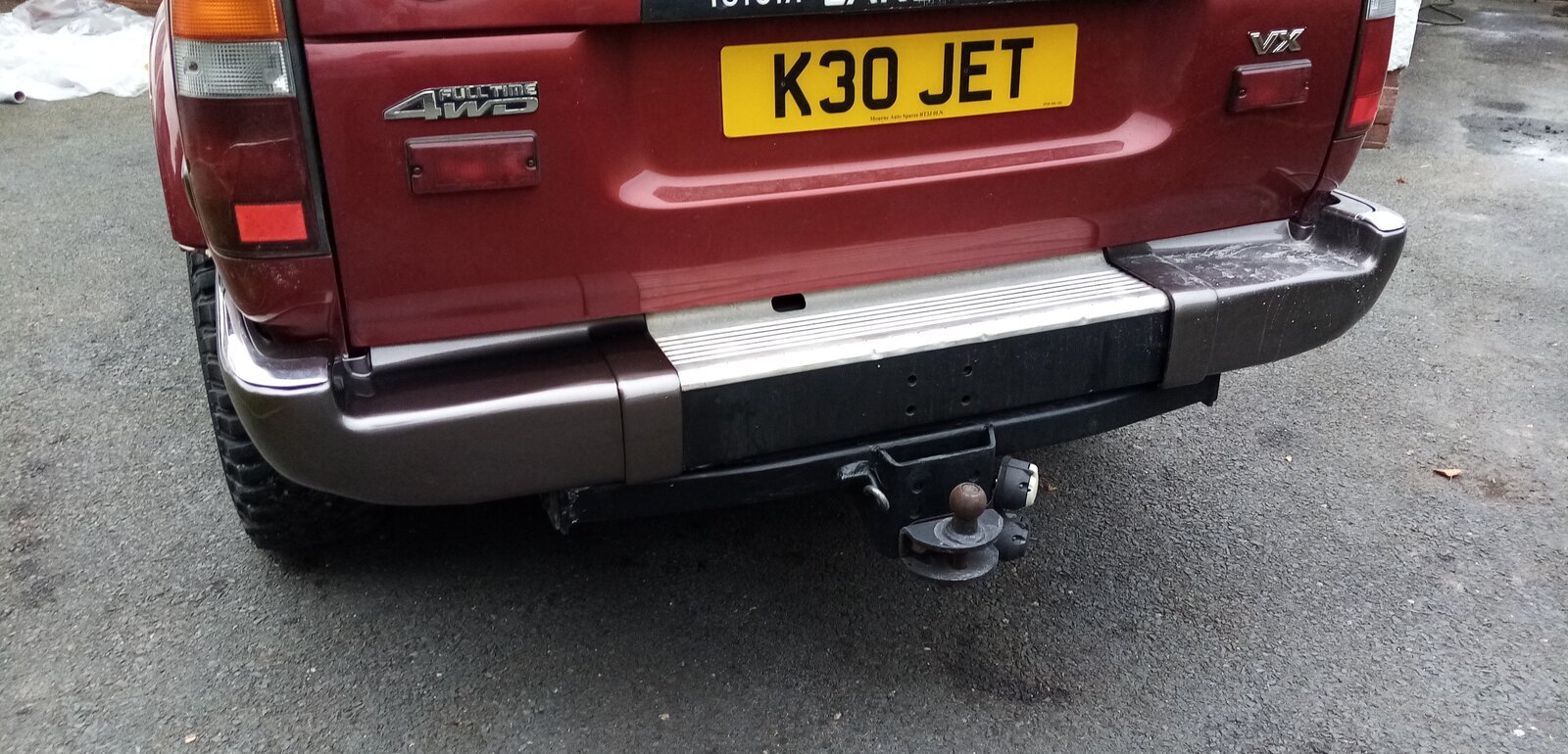

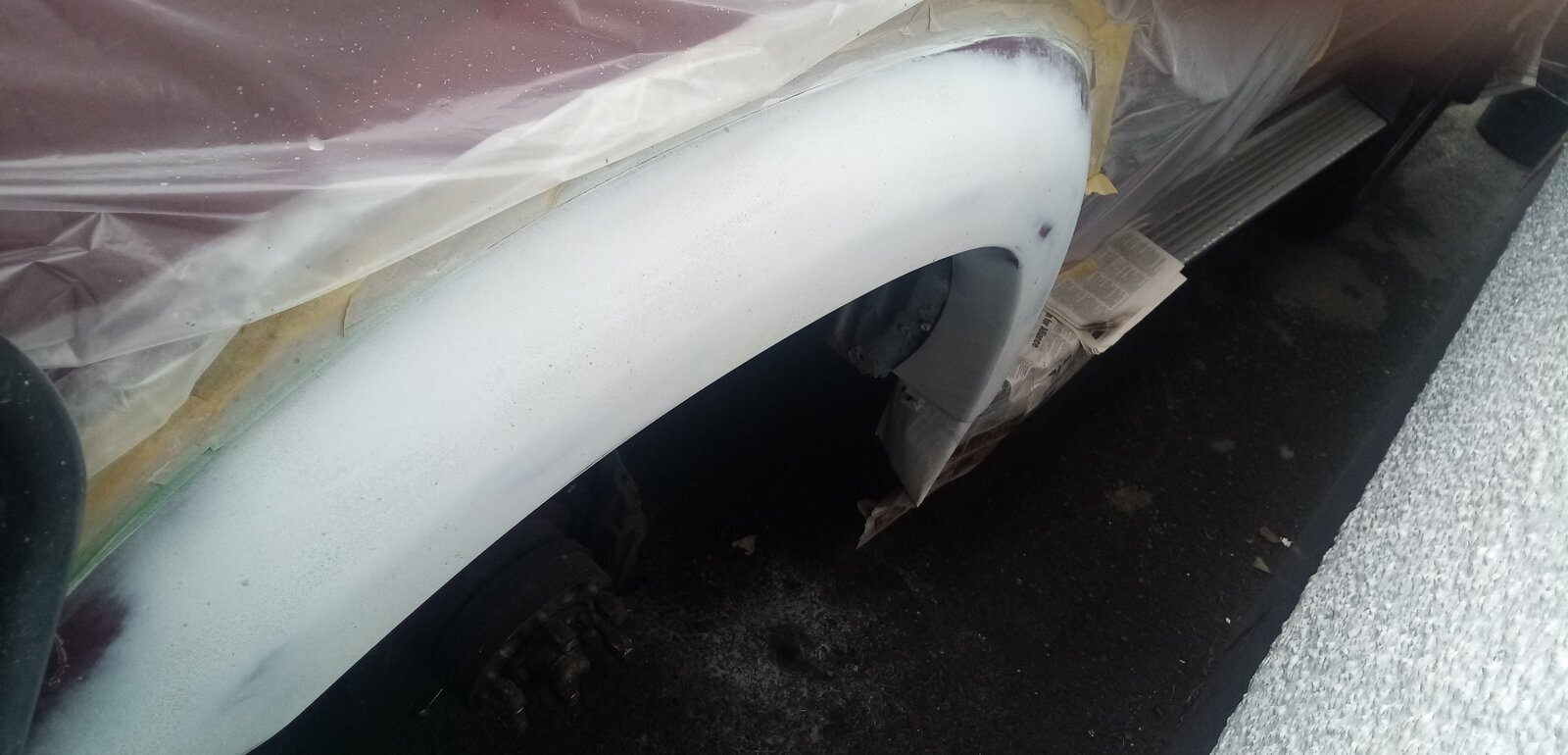

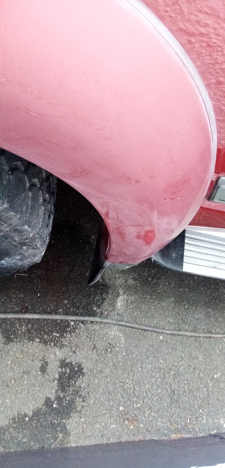

I thought I would take advantage of the recent spell of high pressure to execute some paintwork repairs that had been bugging me for a while... The left hand 'bumperette' had been in close contact with a Victorian parking bollard and the NS front splash guard had some lacquer peel which unfortunately went right to the gasket so I used 9mm 3M fineline (which is the same width as the gasket).

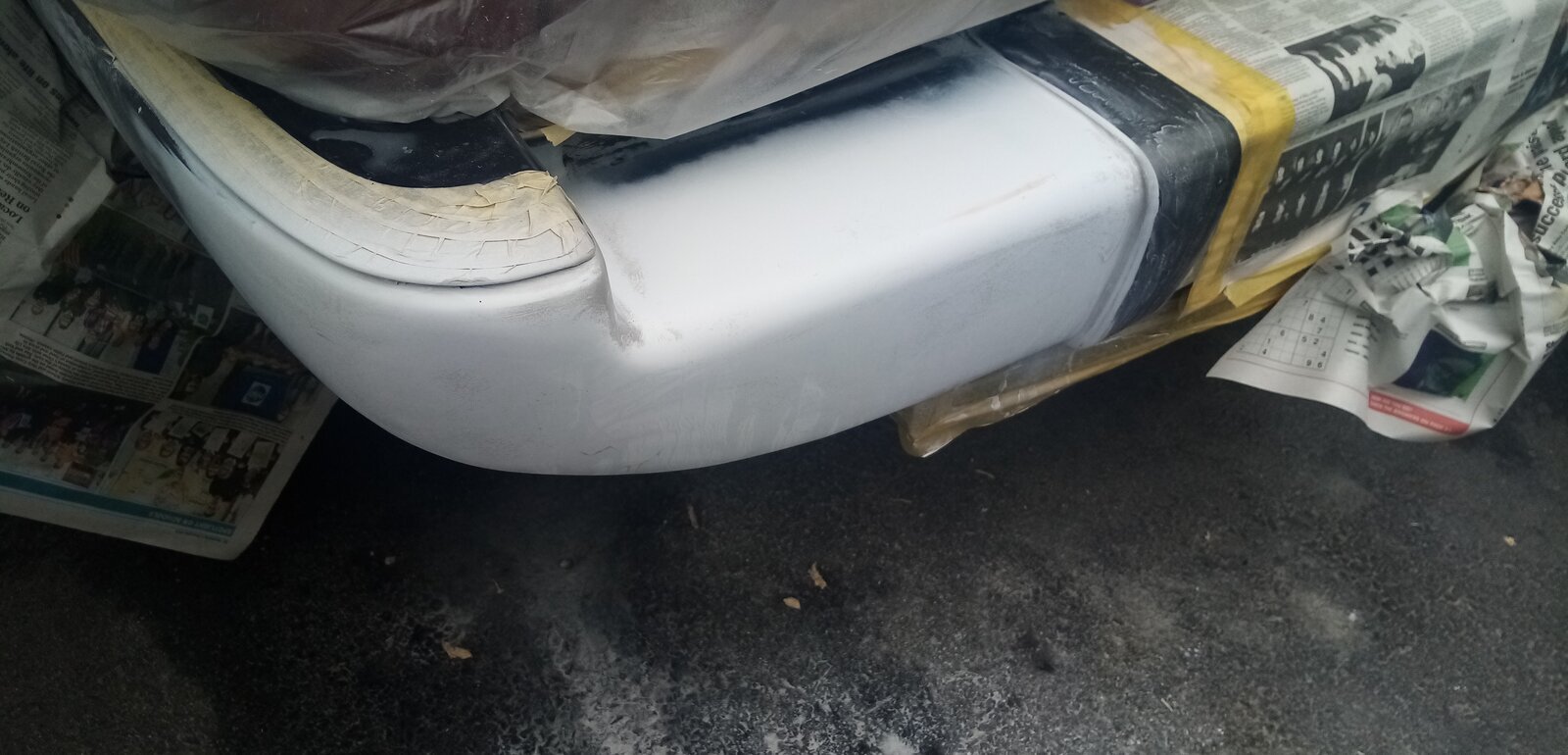

I always prefer to use white primer and apply two medium coats of base as I find it helps obtain a better colour match. Grey primers always seem to produce a darker finish and at least if its looking a bit light, then on a white base then you can apply a bit more colour. If the base is applied heavy or with gloss topcoat then I don't find the primer colour makes much difference. I used a paint I got matched from the fuel cap from a generic brand but it certainly wasn't max meyer priced paint.
On the splash guard the lacquer surrounding the peeled area was feathered with 320 then 600 then 800 which meant I didn't have to apply filler. when the primer was mixed I didnt use and thinner in the first coat and let it rest in the pot for an hour so it didn't attack the old base coat. The second coat I did thin 10% to achieve a smoother finish applied a guide coat using light grey aerosol primer and then left for 24hrs before flatting with 800. 2 medium base coats and 2 medium clear but with slow activator as I find it allows solvent more time to escape which gives a finish that can be sanded sooner given this was probably going to be necessary. Fast Activator gives a quicker dry time, but can be days before it can be sanded if not using a heated workshop.

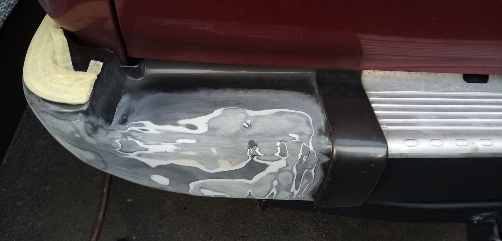

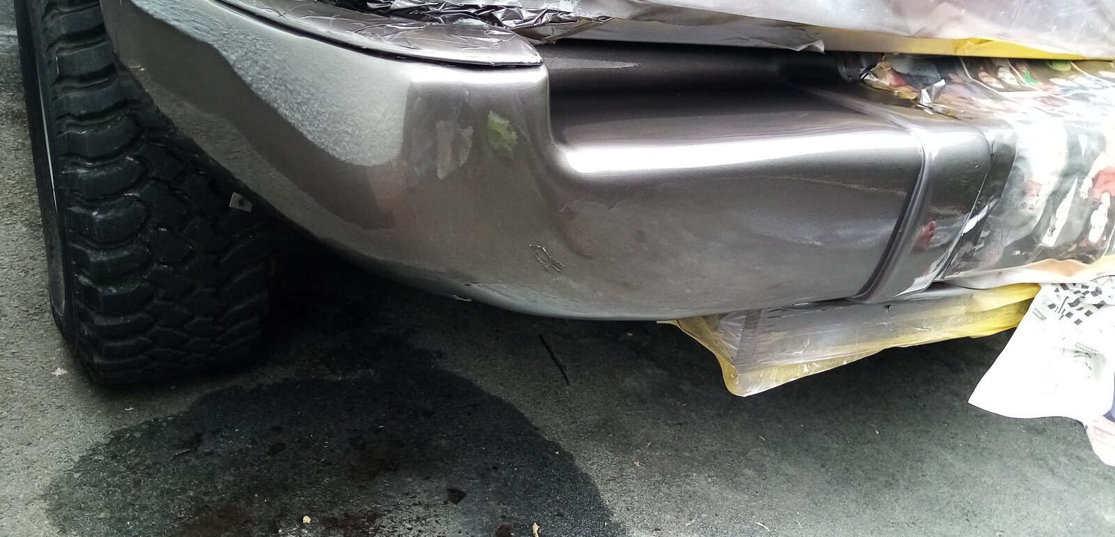

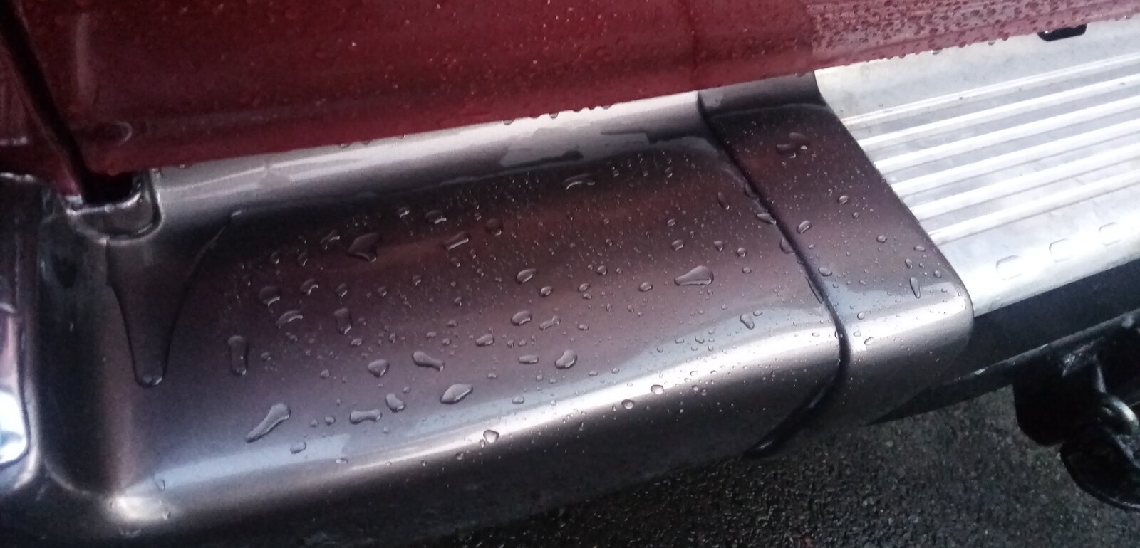

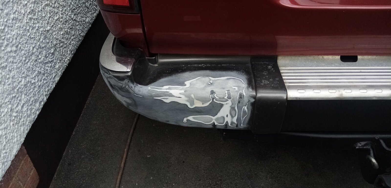

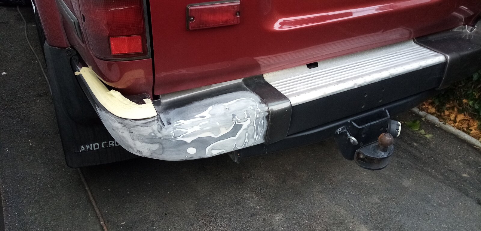

The Bumperette I learnt from repairing the other side is best left in situ to prep because it is such a freggin awkward shape to work on the bench without mentioning the pia it was going to be to free up the bolts. you can just see the 3 vertical imprints from the bollard so with a bit of heat and filler I managed to straighten it out and used the same technique as the splash guard. when i got the paint mix for that last year I forgot to bring the part with me and picked one from the toyota trim chip card that was marginally lighter, but didn't have enough green in it. The landcruiser grey trim has a fair tint of green in it. Its ok but cannot claim its the right one.
