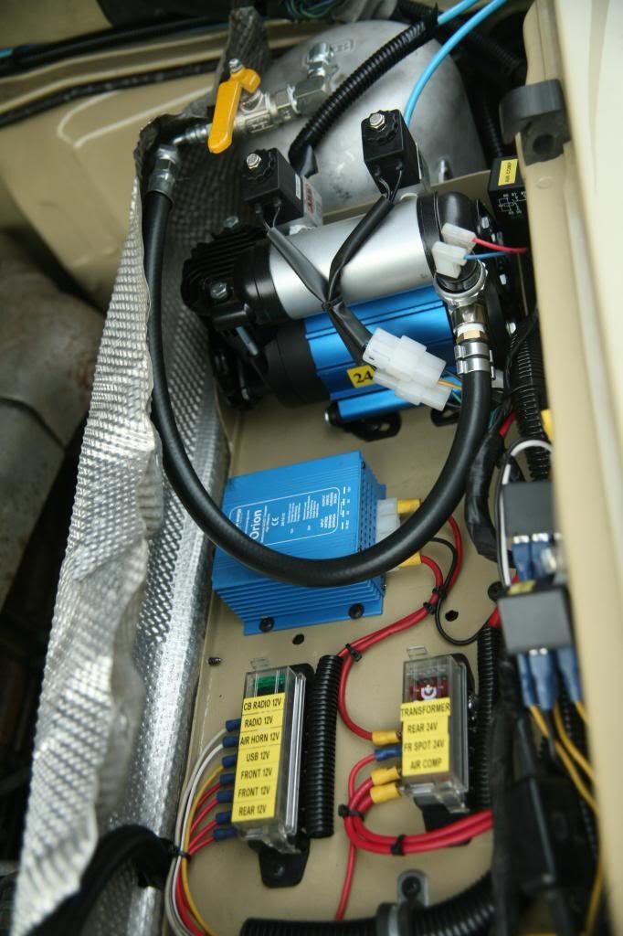

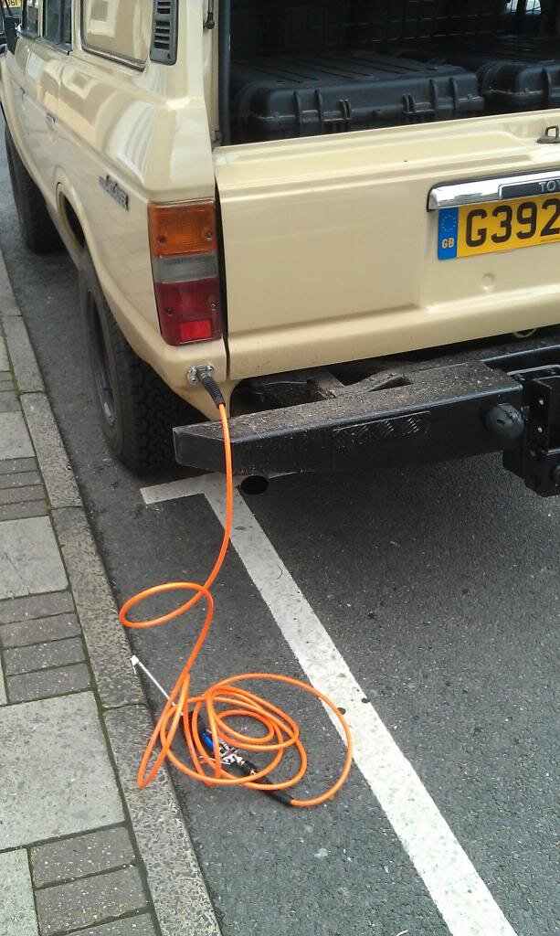

You need a decent compressor though, otherwise you won't air down when you need to. I had 2 truck airs and both failed on a dune in a sandstorm, leaving me to reinflate 8 tyres with a footpump, not fun!. Now I run an ARB onboard compressor with an outlet on the back of the truck and a remote tank. It inflates the tyres as fast as a garage airline.
