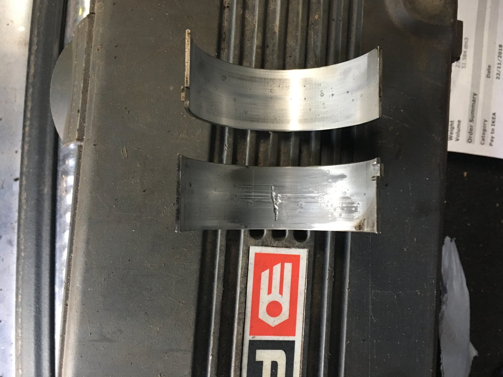

This is cylinder 3, all others looked ok, with some light rubbing marks in the centres, not sure of the miles as it’s had a clock change before coming north, but probably just over 200k

Yes Karl, number 3 is pictured above, all the rest were fine with just a little rubbing, probably consistent for around 200k

I think it was Taiho Karl, my neighbour works in a big motor factor and I get special prices!
I was very surprised to see how clean it was inside, both top and bottom ends with the “high” level of servicing it’s had for the last 4 or 5 years
