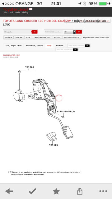

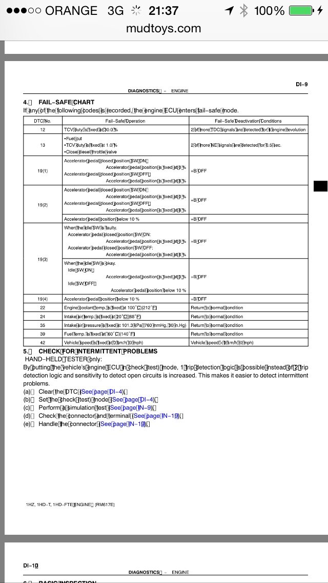

Need your help with Error code 19(4) for LC100 2006
This is the 4.2 diesel type and there are less than 10 of those in Israel ...
What to look for? Any ideas?
Any suggestions for good technical guide book ?
Thank you and happy holidays...
