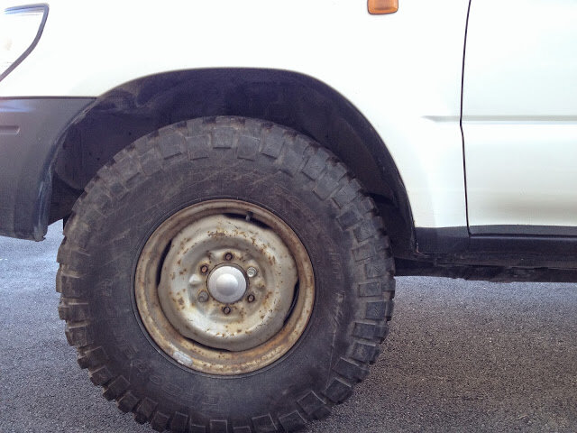

Finally bit the bullet & called my local tyre fitters to order five 255/85/16 BF Goodrich MT-KM2's for Fiery now she has her new Ironman suspension lift fitted
Right up until I walked through the door to their reception area this morning I was still very much in two minds about them & could have easily said 'f... it get me some 285 Cooper STT's in would you' Then when I walked through the door there they were in a big pile in the middle of their now quite busy reception area proudly on display to all
I felt physically
They did look really skinny & the tread depth didn't look great either Or was I just being cynical as deep down I'm really feeling disloyal to my Cooper past With that came a quizzical voice from behind the counter 'What do you reckon then? Look good don't they Give us your keys & we'll get started fitting 'em?' 'OK' I said! 'Here's the keys' I added
And so on they went
@ this point I started to warm towards them
All done so up onto the laser alignment gizmo
Mmmm....not so good I hope all of those caster & camber bolts a free from rust
Superb Almost perfect
Jobs a good'un
Here we are all back home & very, very happy Thanks for all the support & advice guys
Ah That's the only problem Spare doesn’t fit Bracket needs to go up @least an inch Spares just balanced for the piccy
So to sum up I like them They look great Fit well & although there is a little more road noise compared to the Avon A/T's that came off this is nothing compared to the induction noise that I get from my snorkel
What have I gained Well ground clearence & traction hopefully
The minimum ground clearence Fiery had before the Ironman suspension lift & the tyres was 240mm both front & rear. She now she has 270mm @ the rear (bottom of diff to ground) but @ the front she has gained 75mm to 315mm below the lowest point of the OE skid plate (maybe there is a plus side to IFS after all ).
