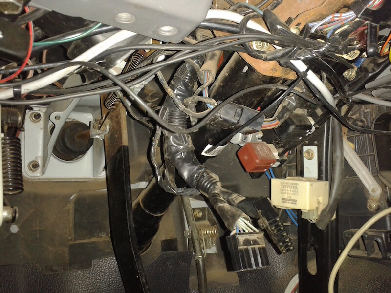

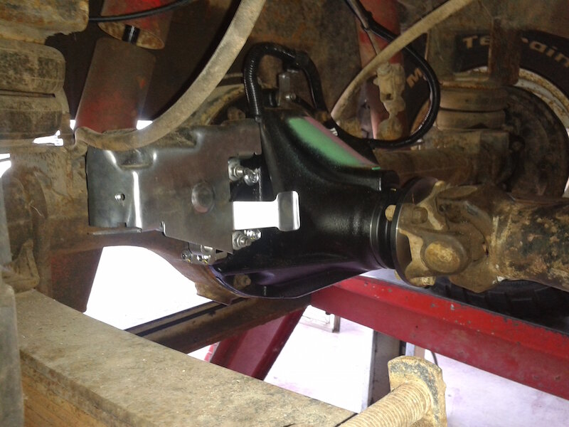

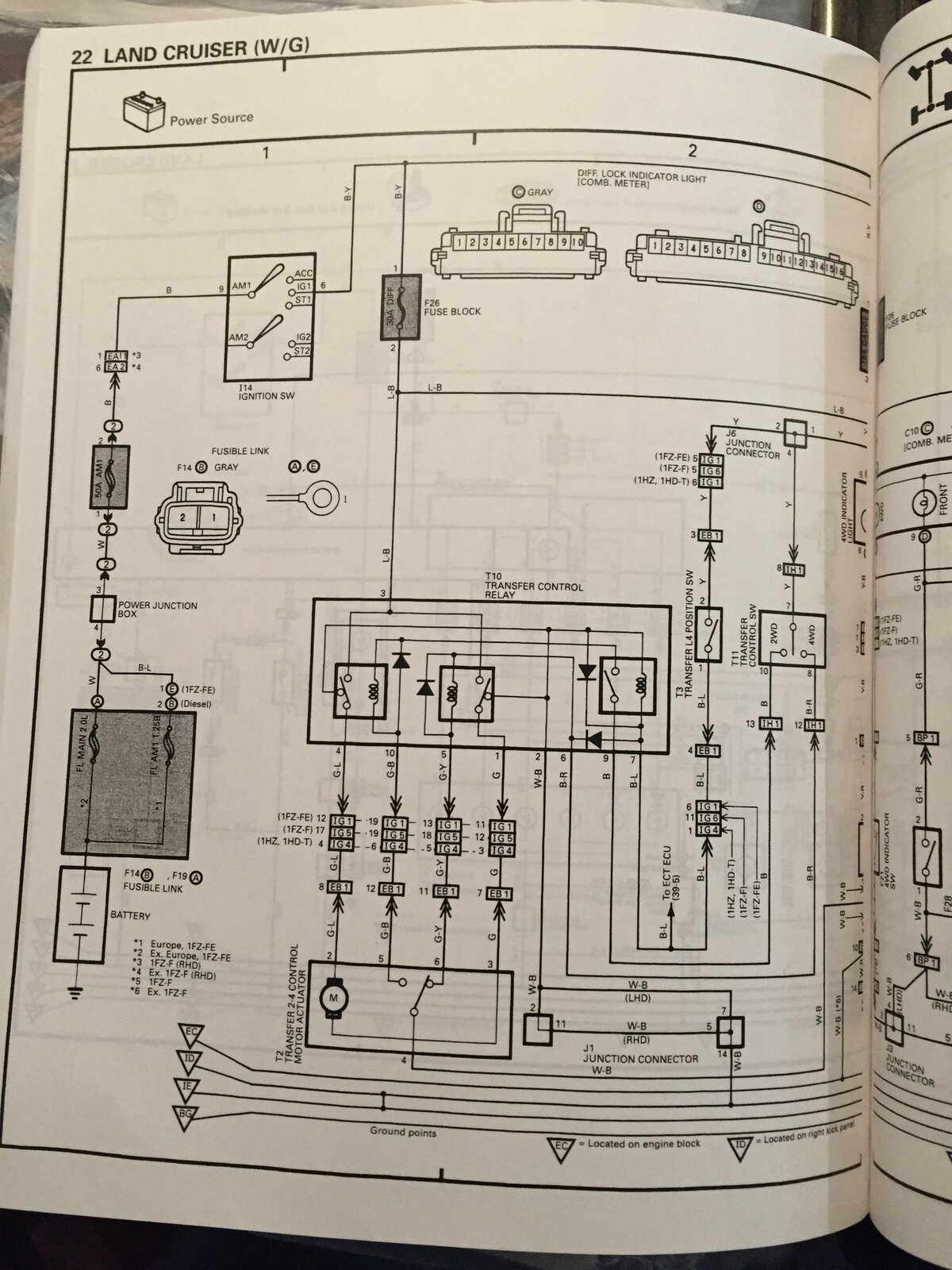

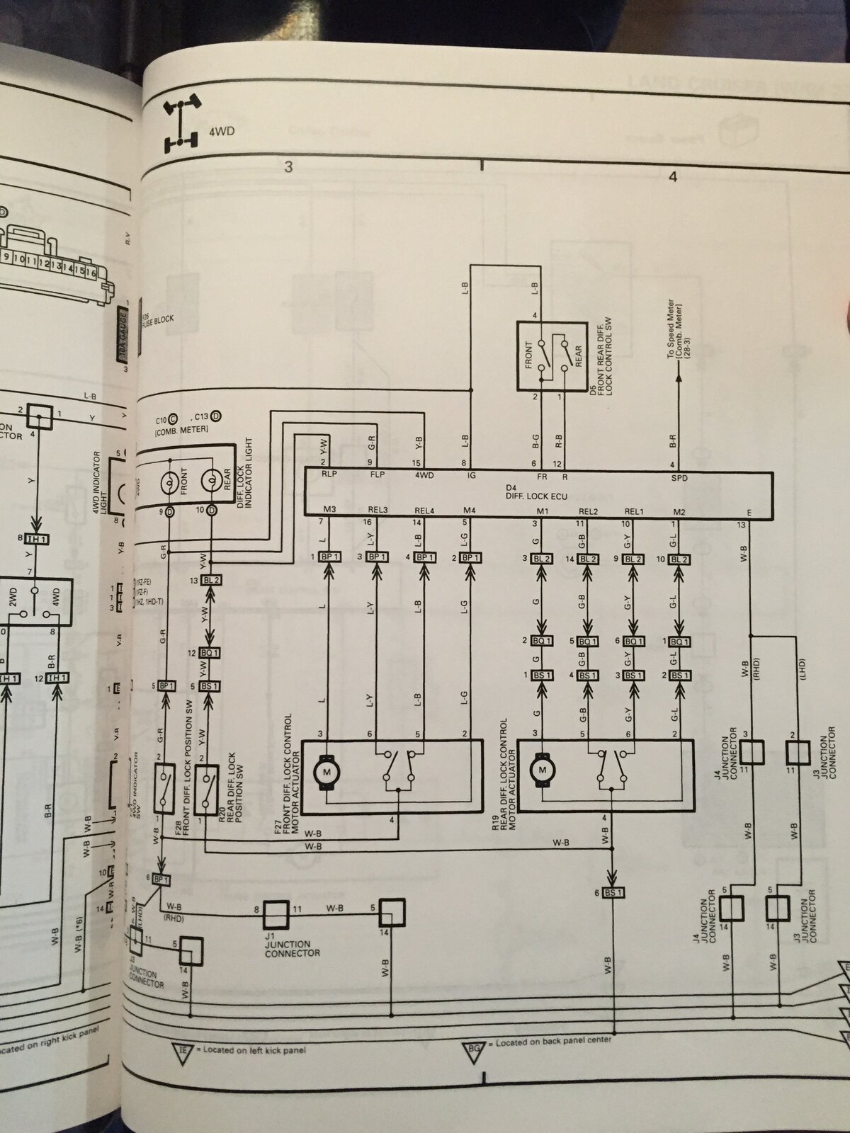

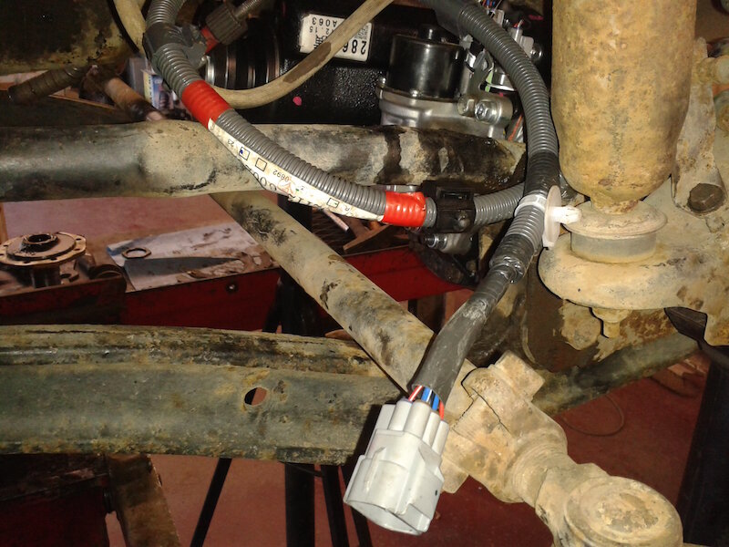

I am trying to fit factory lockers onto my 2001 HZJ79 (Left hand drive) Chassis nr: JTELB71J407012145. It comes in a nice kit will the needed (original) parts. The lockers are in place (some cutting to be done in the axle housing) and I am now trying to hook up the electrics. In ALL HZJ79's I know, the original wiring loom has the connecters available for the factory lockers... except mine it seems. At the rear the cabling is there. At front it isn't. What I cannot locate:

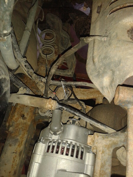

- Connector near the alternator that goes to the front locker. Supposed to be a 6 fold plug.
- Connecter under the steering wheel that goes to the switch for (dis)engange the lockers (white plug, 3 connectors I think)
- Big connector that goes to the the 4x4 ECU

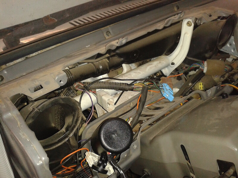

I am bout to dismantle my entire dashbaord and battery box so I can follow the cableloom that comes from behind and see if I can locate it, but I was hoping for some forum wisdom.

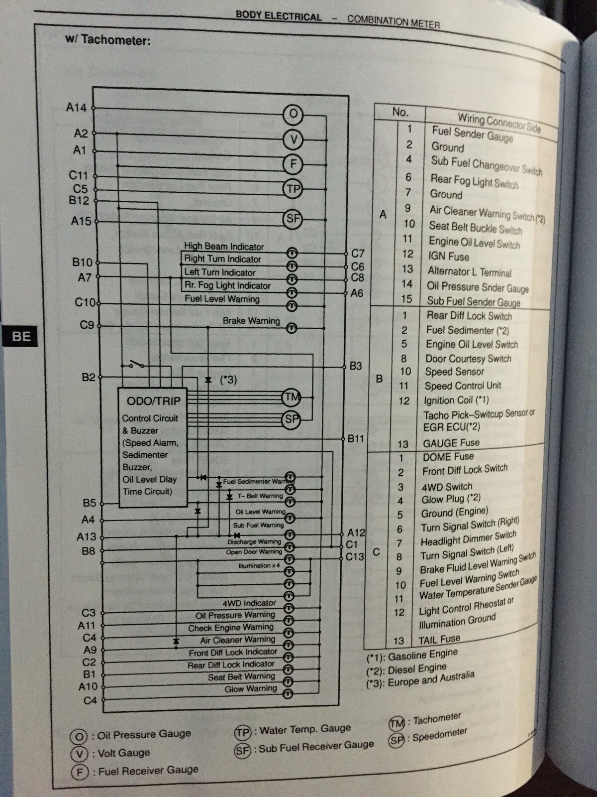

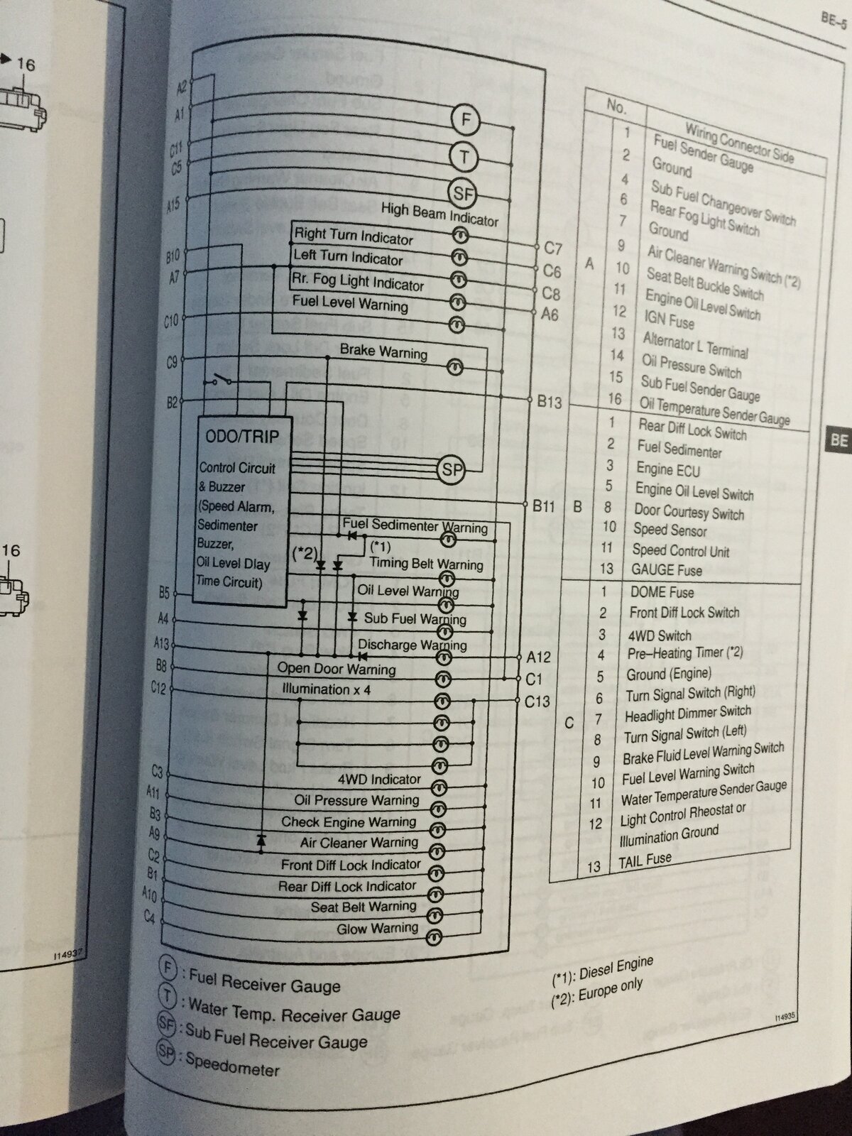

Am I right in thinking ALL HZJ79 as of 1999 have the same wiring loom - with connectors for the lockers?
Is there a wiring loom that has the cabling for the rear locker, but not for the front?
Are there variations in the wiring loom that have the connectors in a different place?
If for any reason I do not have the necessary wiring in my wiring loom- does anybody have a clue on how to get the factory lockers working anyway?

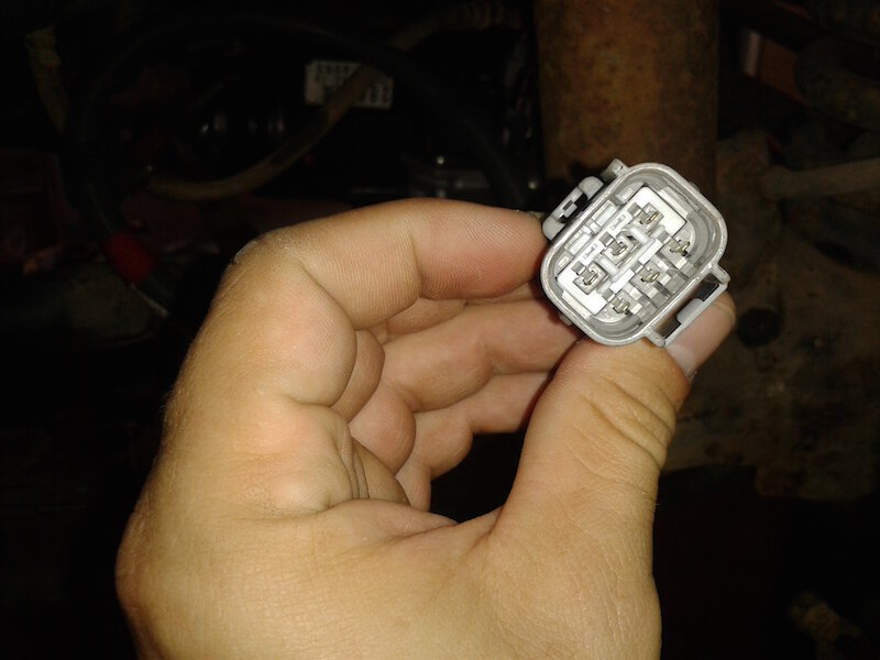

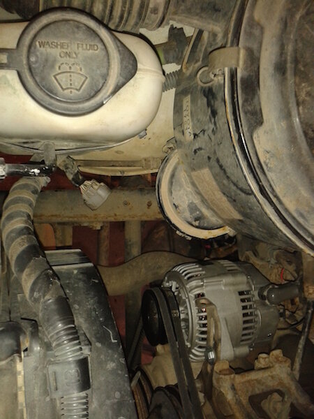

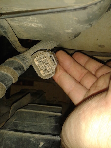

I did find a "mystery" connector in front of the the air filter - I have no idea what its purpose is (cannot find it on the original wiring diagrams). could this be part of the locker loom?
Location of the mystery connector:
Detail of the connector:
