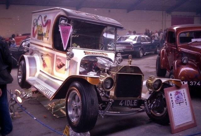

The first C cab that Andy Brizio built was sold to the late Jon Bonham and it was shipped to the UK where it still resides today. I've included a couple of photos of 'Andy's Instant T' taken in 1977. The motor it runs today is a blown Camaro SS unit and that came from another famous UK car that is still around today - Mick Cooke's Silhouette.
I think the tech guys at the NSRA in the Uk would be interested in the way things work in Oz as there is currently a move to make registering hot rods extremely difficult in the Uk. I've also included a photo of another C-cab - Revenge - which was voted the UK's hot rod of the century (last) in 2001 but you might find some of the body styling interesting.

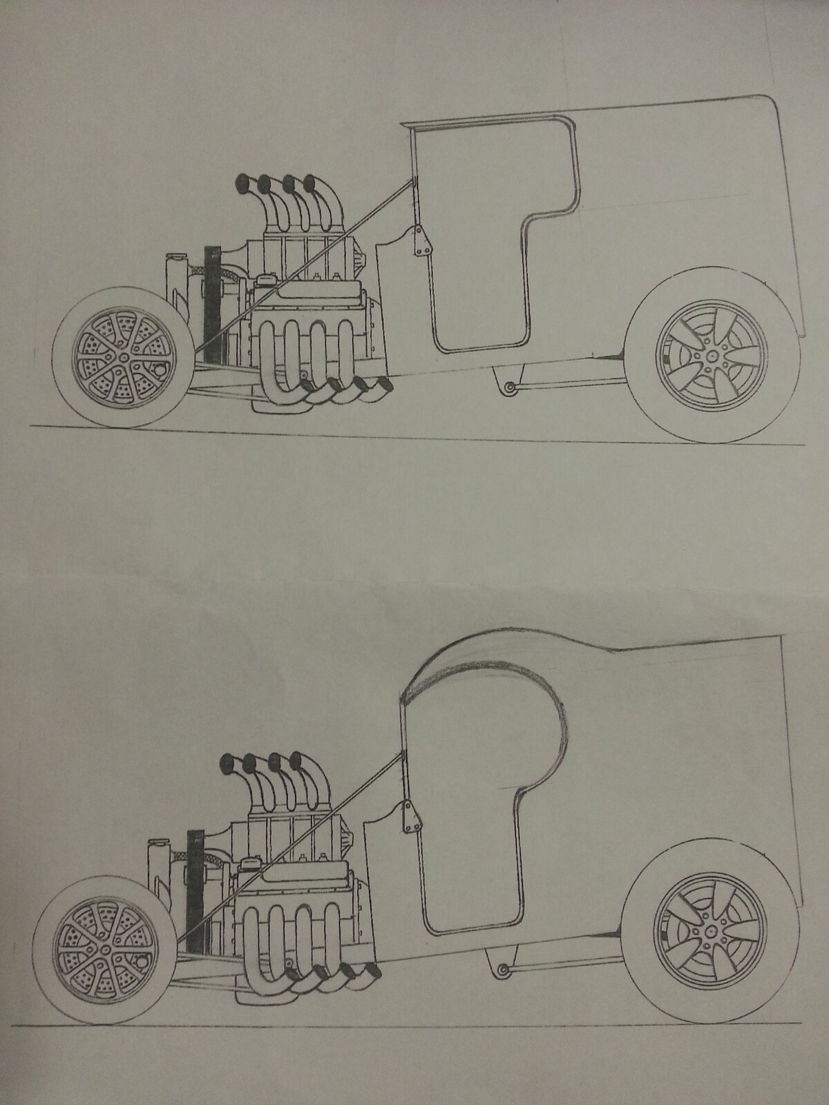

That beige car that Mark W showed is indeed the one that sent me down this road. I've seen pics of Andy Brizio's C-cab and also Revenge. I love the body on Revenge but it would have to be made from scratch and that means engineering and testing. No thanks. Another rod I've always liked is the Milk Truck (which I saw when it and a several other toured Australia in the early '70s and again 6 months ago in the Galpin Ford Museum) so I'm half-considering a square C with a flat roof. Here is a drawing I did of both versions of the body.My Drawings.jpg I'm in WA at the moment but when I go home in a week or so, I'll go and look at the chassis I mentioned and if it's suitable and in reasonable nick, I'll buy it. Even if I do, my house won't be done for 6 months or so. I'll have to put the chassis in storage until I'm moved in and have set up my workshop. In other words, nothing's going to happen for a while but when it does, I'll post some pics.

That beige car that Mark W showed is indeed the one that sent me down this road. I've seen pics of Andy Brizio's C-cab and also Revenge. I love the body on Revenge but it would have to be made from scratch and that means engineering and testing. No thanks. Another rod I've always liked is the Milk Truck (which I saw when it and a several other toured Australia in the early '70s and again 6 months ago in the Galpin Ford Museum) so I'm half-considering a square C with a flat roof. Here is a drawing I did of both versions of the body.View attachment 25480 I'm in WA at the moment but when I go home in a week or so, I'll go and look at the chassis I mentioned and if it's suitable and in reasonable nick, I'll buy it. Even if I do, my house won't be done for 6 months or so. I'll have to put the chassis in storage until I'm moved in and have set up my workshop. In other words, nothing's going to happen for a while but when it does, I'll post some pics.
this is awesome, in particular I like the first drawing as it will show more resemblance of the fj40, deffo looking forward to seeing this and catching up with you once you get set up. You will be 40 or so away!

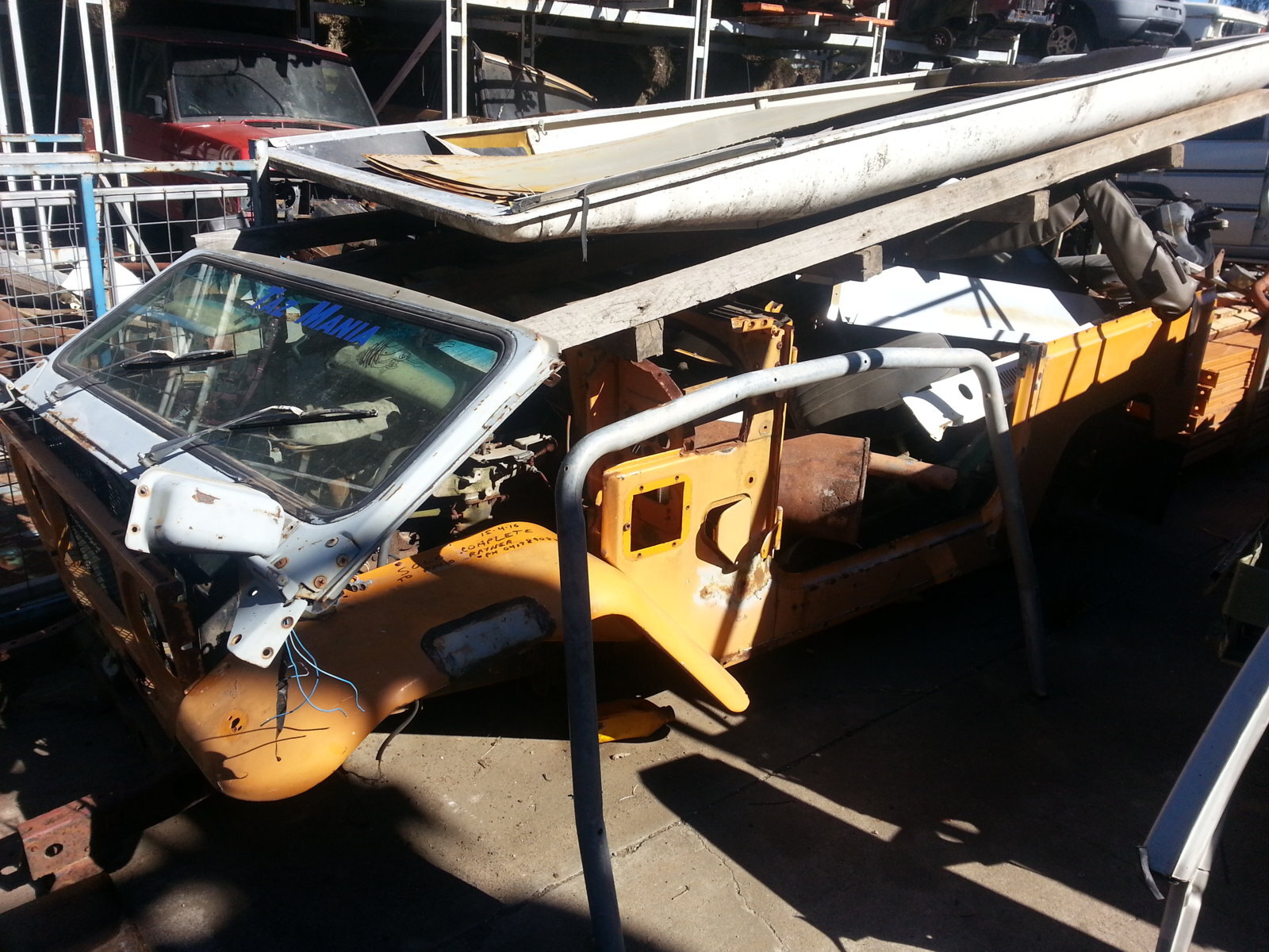

Well, I went and looked at the "chassis" for $400 at the wrecker's the other day and it turned out to be a lot more than that. Most of the body is there, as is the motor and trans, rear axle, most of the steering, and a pile of parts thrown in a heap inside that I haven't even looked at. On top is the roof of a Land Rover which I have no use for. When I said I was told it was a bare chassis, the wrecker said he'd strip it down to that but then said (thinking aloud I suspect) that it'd cost close enough to $400 to do that, so I bought the lot for $400 and it's being transported to my shed next Tuesday. It'll sit in a corner for a year or so while the house gets built (not started yet but about to be), garage is set up, and two bike projects get finished off. I'll continue this then.
