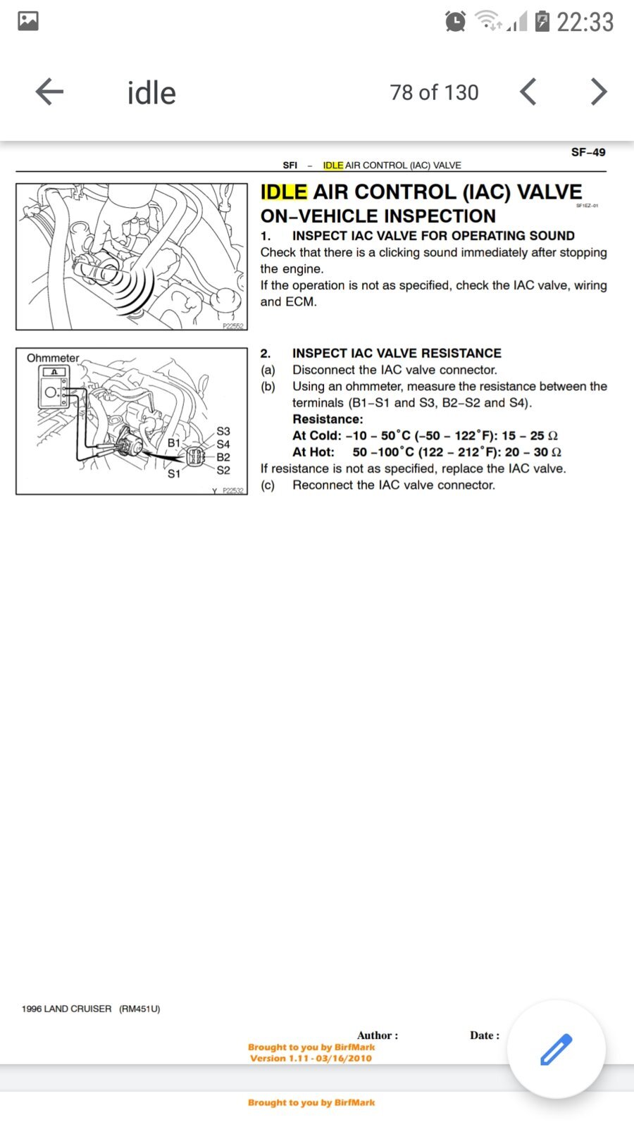

Do you have a service manual for the 1FZ? I only have one for an 80, but hopefully these pages may help. There is no special procedure for fitting a new IAC, the ecu just moves it by trial and error to find the right speed. If it cannot find the right speed it will put a fault in the ecu.

I will test the IAC connection with the an ohm meter. I really do think at this stage its electrical/sensor.
