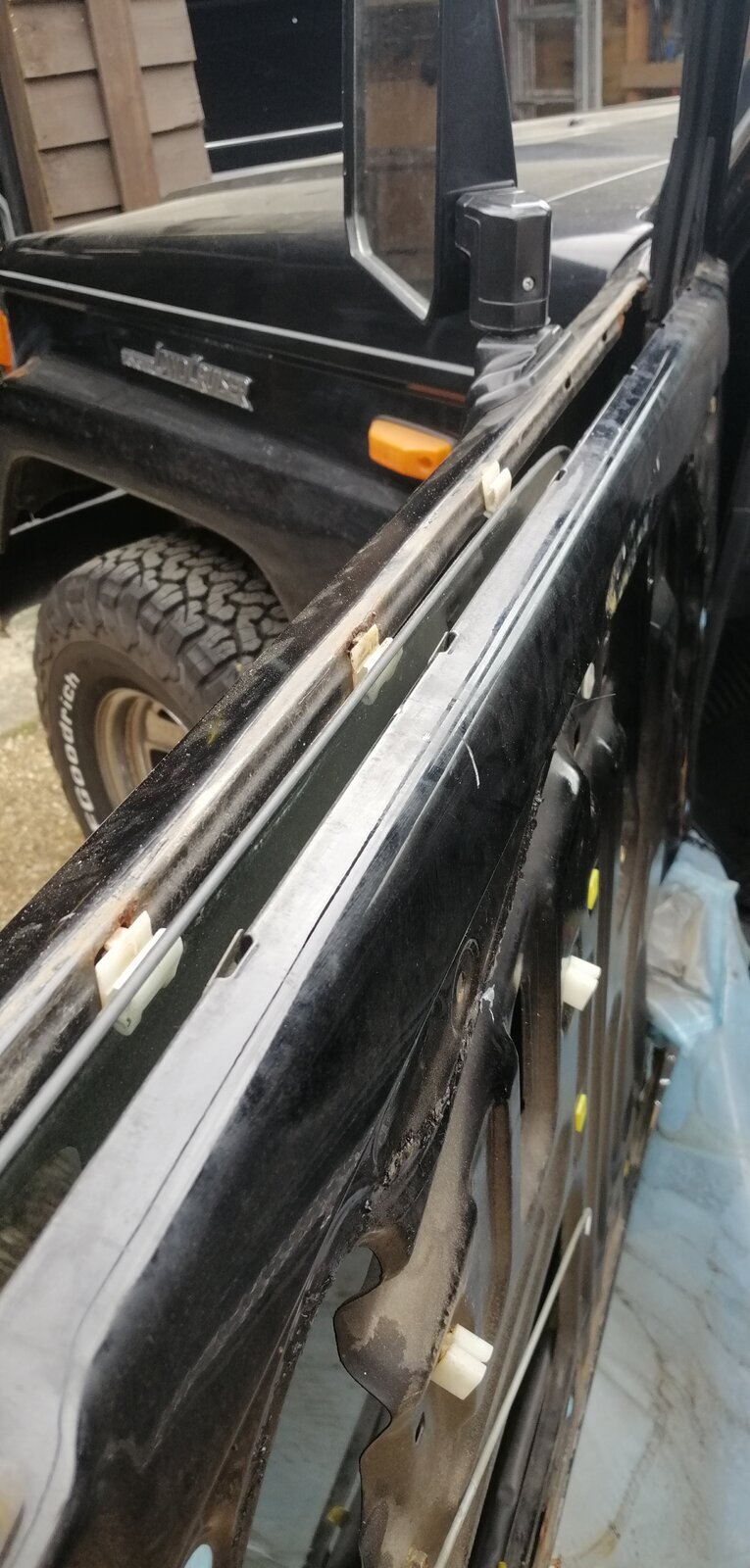

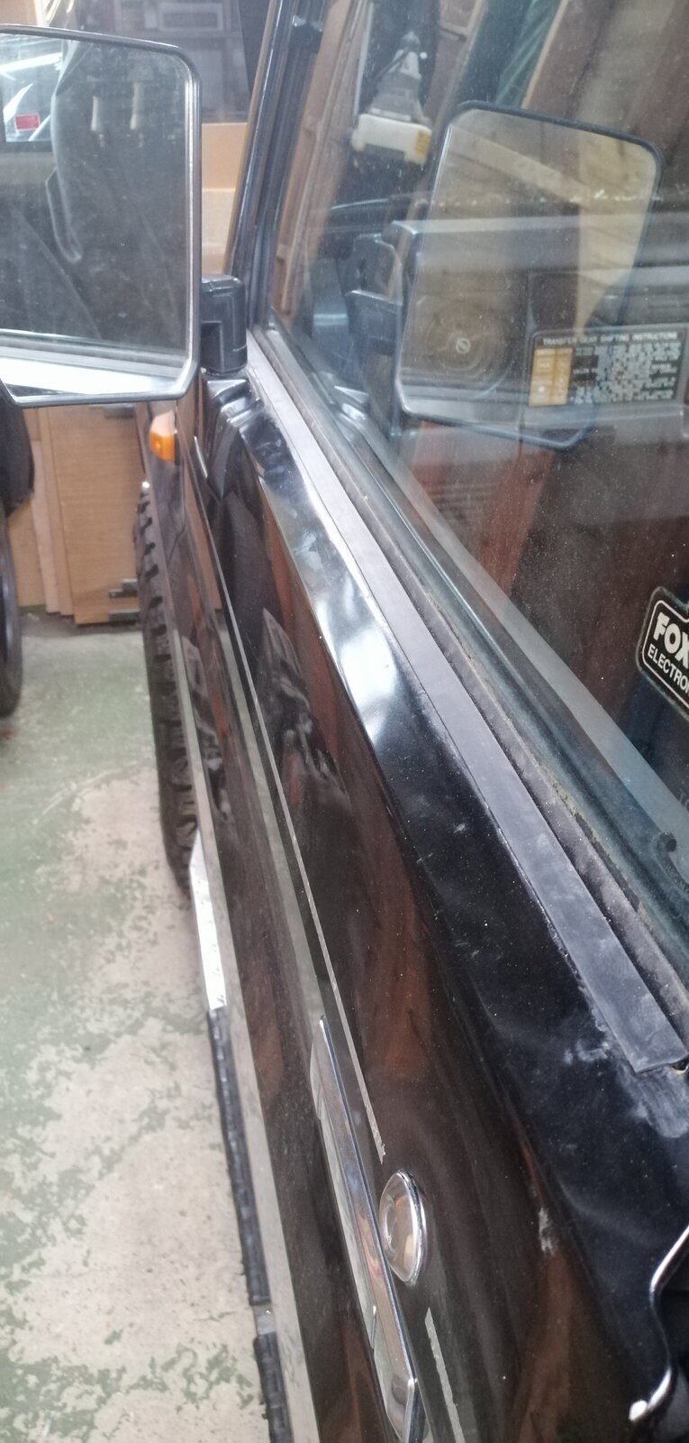

I replaced the outer weather strip on the LJ70 recently as it was misshapen and hanging off the door - not a good look.
I ordered the part from JP-carparts.com. It cost a fortune, but arrived very quickly.
I made a point of ordering a set of clips but the part arrived with the clips already attached!
It went on very easily with the window wound fully down and the door card and the inner trim out.
