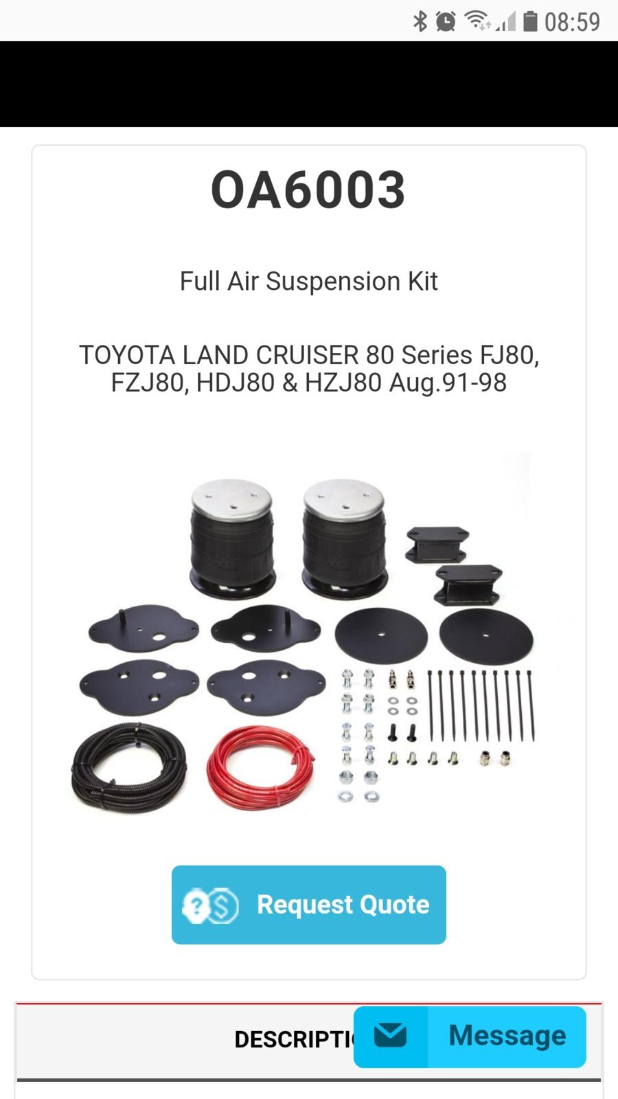

Some investigation on shocks and springs, to replace the shocks and springs with Toyota ones will be about 500-550 depending on shipping etc. There are options on the rear shock absorbers and springs.
Why would slightly earlier ones be different?
Options on rear springs, again earlier ones are different part numbers. You can have either rear seat or no rear seat version.

I have emailed a company in Australia about air springs and no coils kit all the way round (perhaps the natural choice for a lorry mechanic who has found pairs of pliers etc on the roof of an air ride trailer from the last service 6 weeks ago) but I think the cost may be too high.

I have investigated more into full air suspension, I can get a set of air springs and the brackets to fit them for about £1500 shipped from a distributor in Dublin. It is still a lot more than replacing with oem springs, especially as I would still need to replace the shock absorbers, plus there would be additional expenses such as a compressor and tank and something to control the height, valves etc.

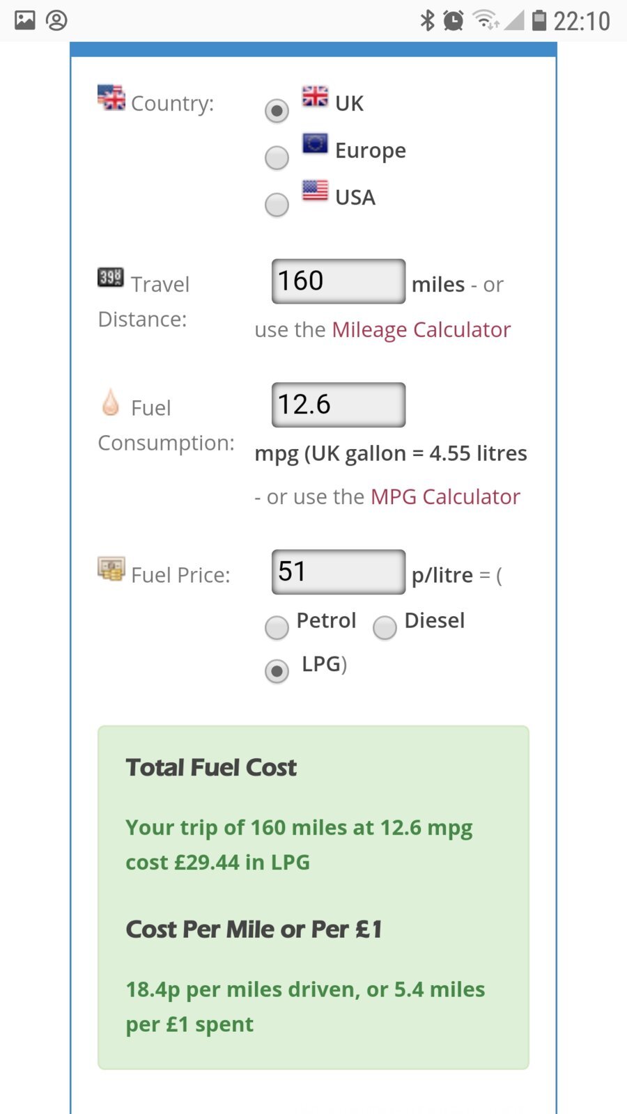

Some calculations of the costs of the LPG system,
The LPG did 12.6 mpg on the last tank,
The petrol normally got about 13/14, you could get up to about 16 if you drove gently and didn't do 90 on the motorway etc. But I don't do that.
160 miles is a week of commuting to work,
Petrol cost at 127.9 is the cheap price from the Sainsbury's near the Calor LPG pump, not the 136.9 that I normally get petrol at from the shell on my way to work.
Each week using LPG saves £36.98,
Using LPG for commuting for a year costs £1530.88, but saves £1921.92 over using petrol.
So the LPG system will have repaid itself in just under 6 months.
It also means that the Land Cruiser costs the same in fuel as the GT86 which is doing about 32mpg (but only if I filled petrol at the Sainsbury's).
There are costs with the LPG such as you use a bit of petrol warming up the car, and you also need to put Flash lube in, but these costs are negligible compared to the cost of running on Petrol only.

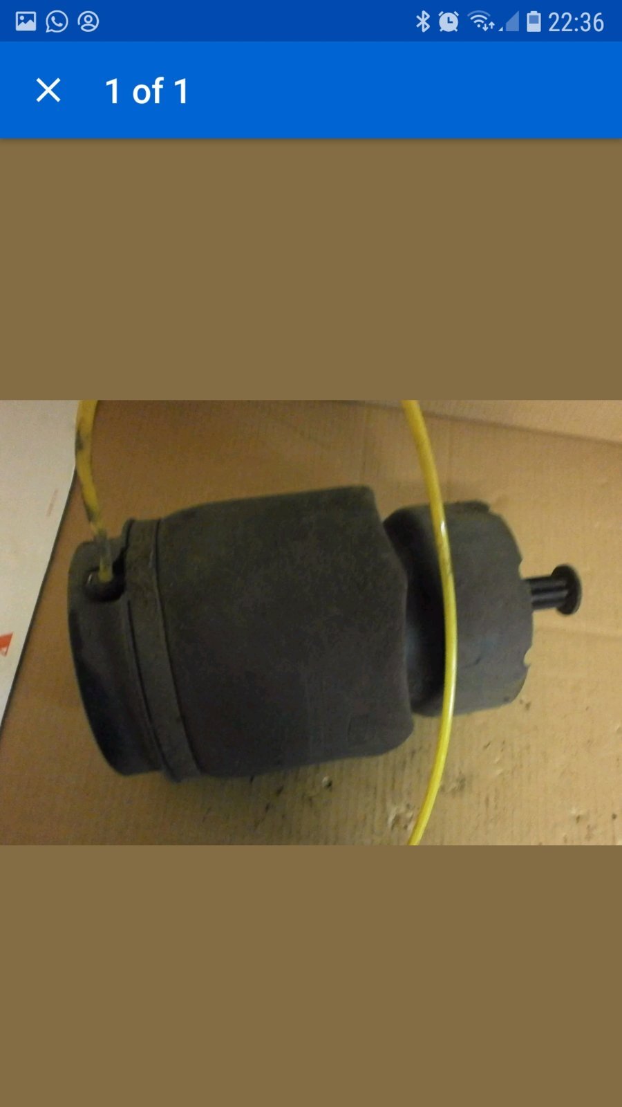

Although the savings mean I should be able to buy full air spring kit from Dublin I have decided it is too expensive and have bought a £20 used Range Rover L322 air spring from EBay as a test pattern for making my own rear air kit.
Hats off to 'ya' Richard, Having a go at doing your own.. What size are the bags, say in comparison to the bags on a 'modernish' 7.5 tonner.. With your HGV skills is it doable. Or are they just to big....
The bags are about the same size as a rear coil spring on an 80 really. Not that much smaller than a truck airbag. We have single leaf springs on our 7.5's so I don't have any to look at. The ones on the 44t are too big. They will be too bumpy, like if you were driving a tractor unit solo.
I think they would be too big though, a Range Rover has similar towing capacity and weight to an LC80, and also they are a high volume production so parts are quite cheap. Even brand new Range Rover L322 airbags are only about £100.
Seems they have big problems with the electronic control system of the airbags on the Land Rovers, but I will just use a mechanical system. Also when the bags start to leak they don't get replaced and that leads to the compressor running flat out, and wearing out.
I must have looked at all the oem airbags on eBay - the range rover are about the right shape and look possible to fit, watched some videos on youtube of people changing them, the mountings look similar or at least I can make some.
The fronts will be more tricky, may be worth getting the kit, but I will see how I get on with the rears.

These kits are about £750, each including vat and shipping, you could inflate them with a normal tyre pump as they include Schrader valves, but really I think you would be better off with an on board compressor and tank, the kits for that are about £600, more if you want electronic controls. But there is lots of 2nd hand oem stuff on ebay, nice aluminium tanks for £40, old ambulance pumps £60 etc etc.
