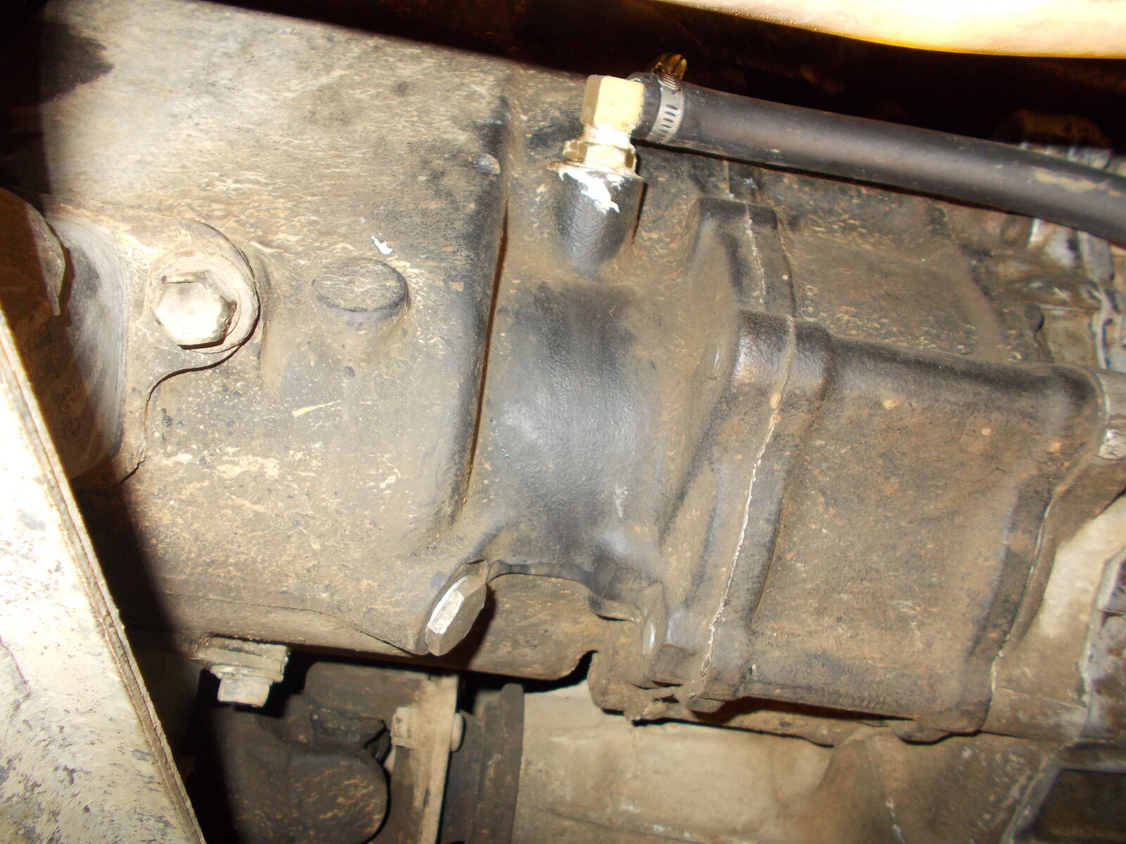

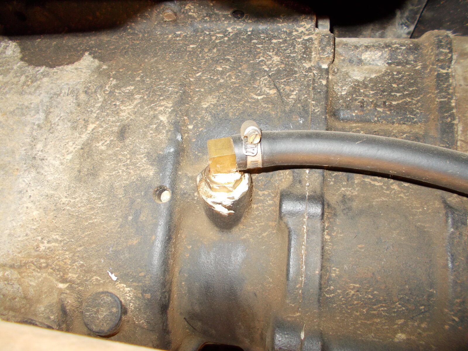

    re 60 series gear box filler
    hey there
    i have attached some photos from my 60's gearbox
    the filler is the one that has the pipe attached
    the drain plug is he one directly below the filler
    with these gear boxes the seal between the gearbox & transfer case
    goes & the oil leaks out of the gear box into the transfer
    that is the reason for the pipe from the filler of the transfer to the filler of the gear box
    hope this helps
