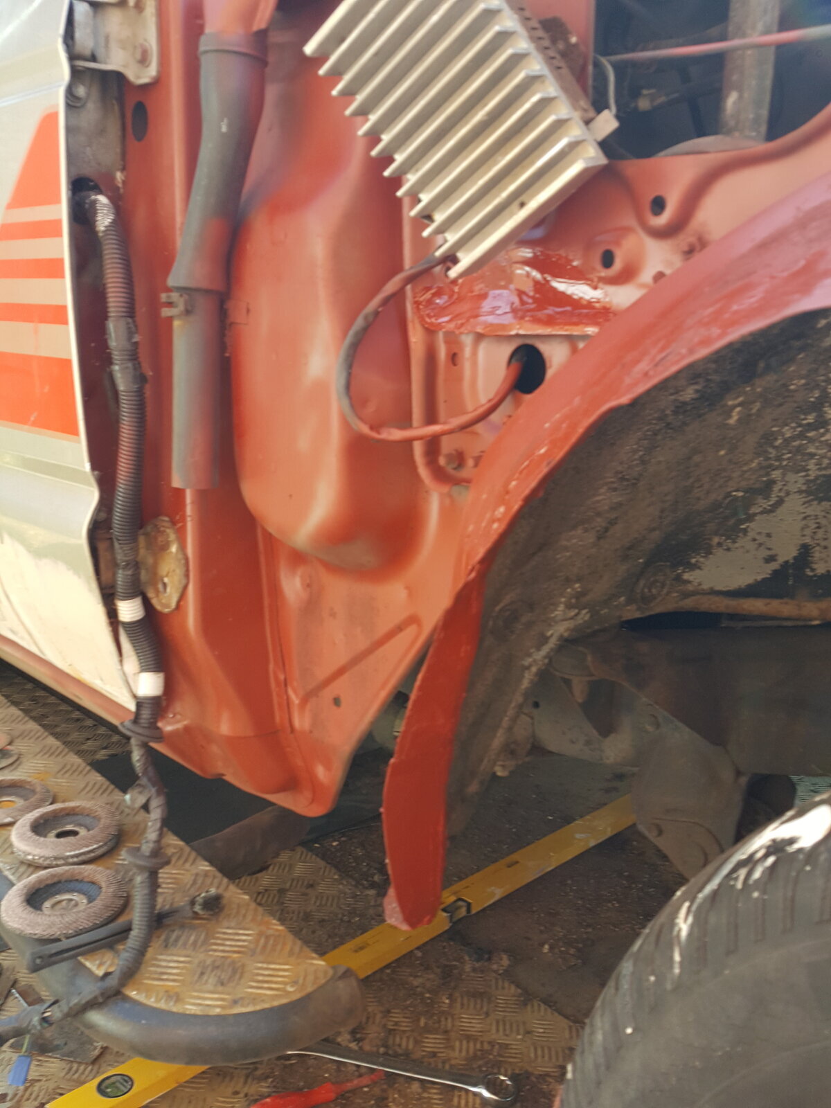

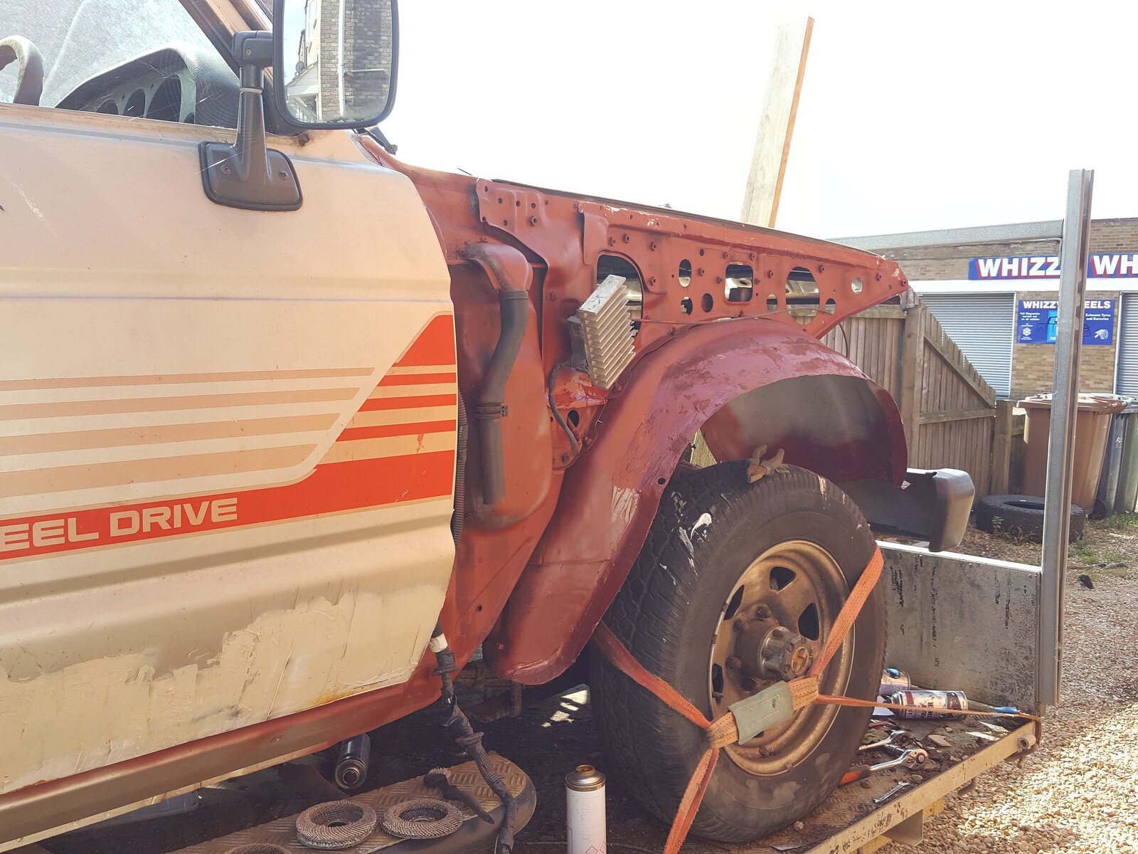

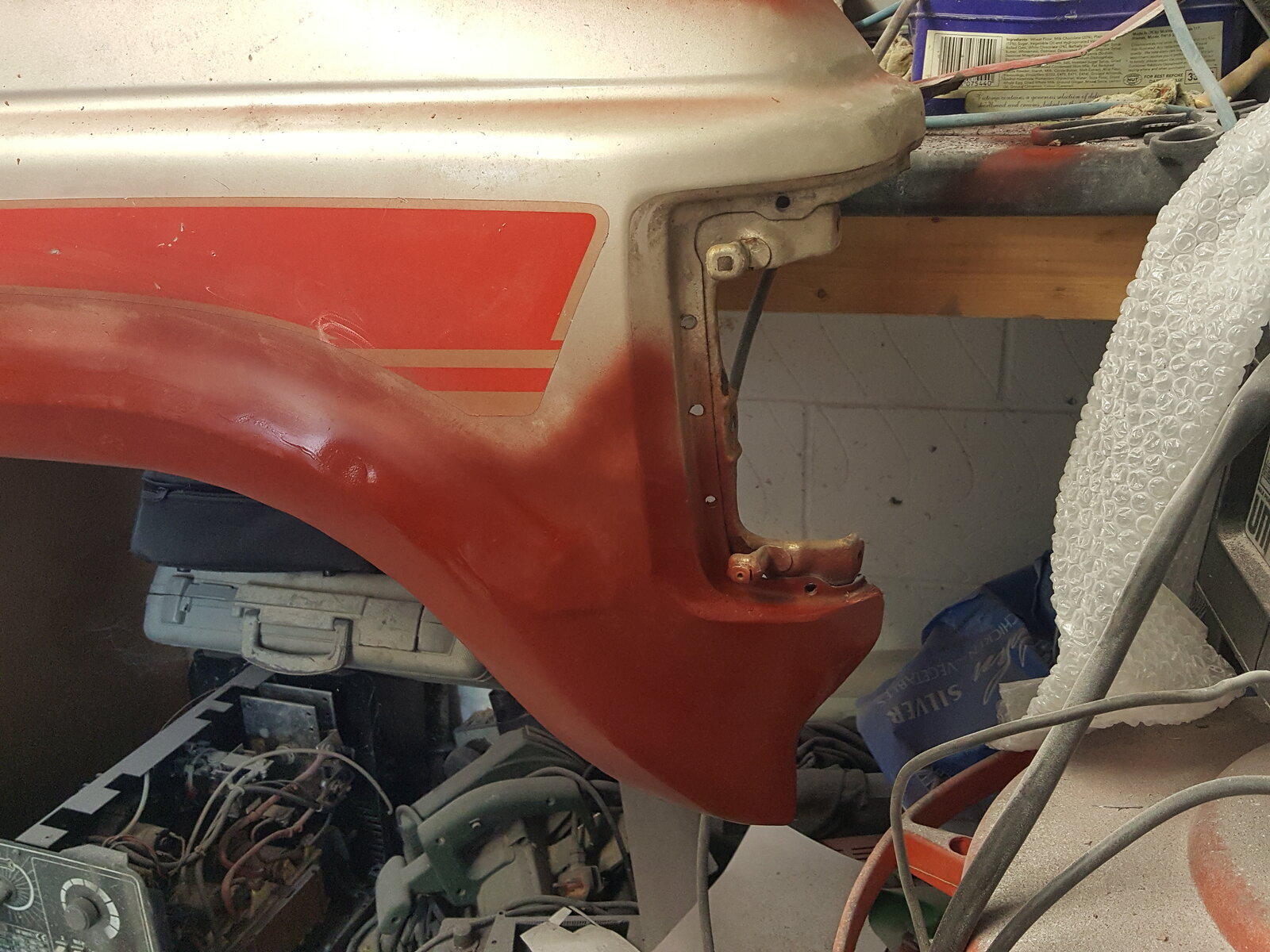

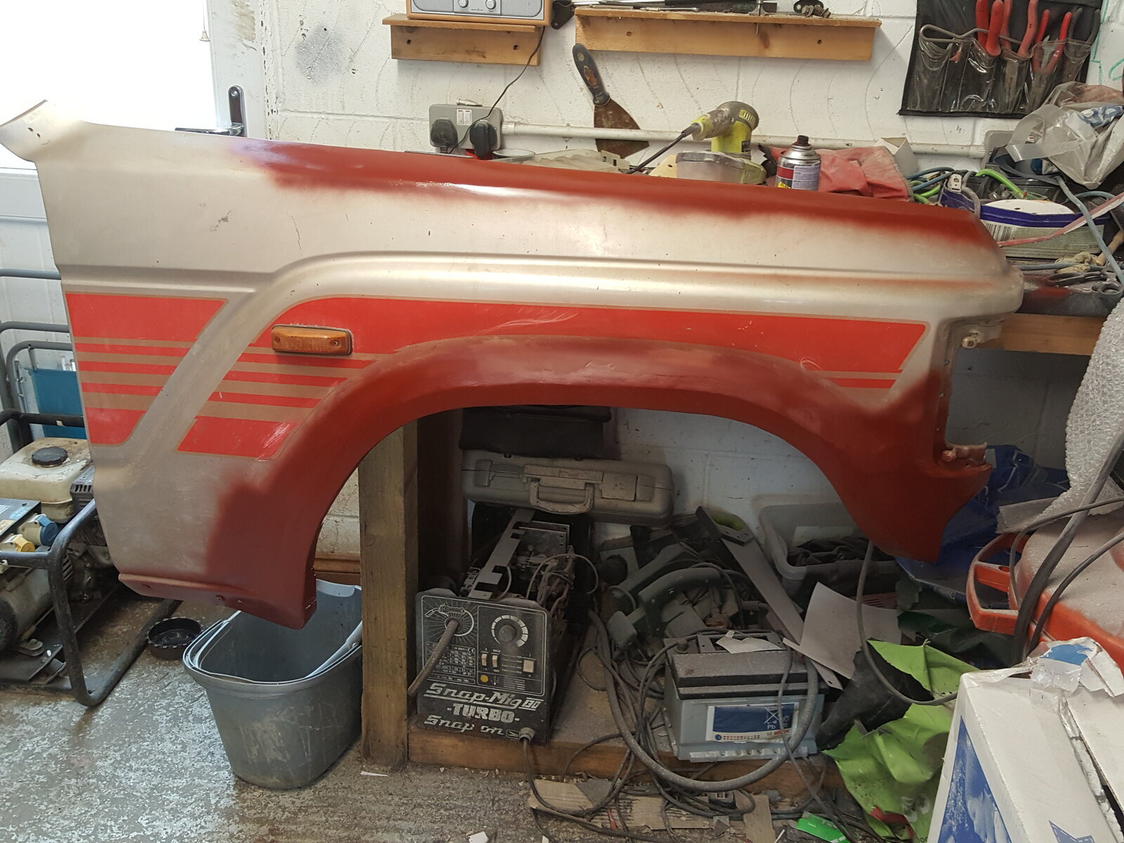

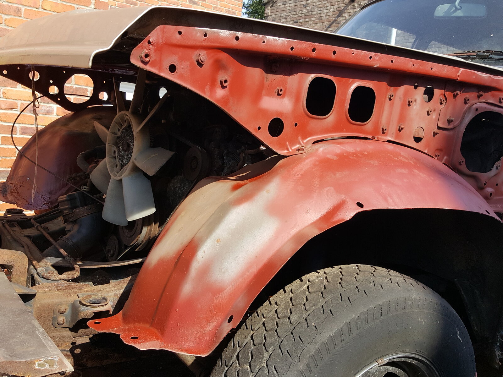

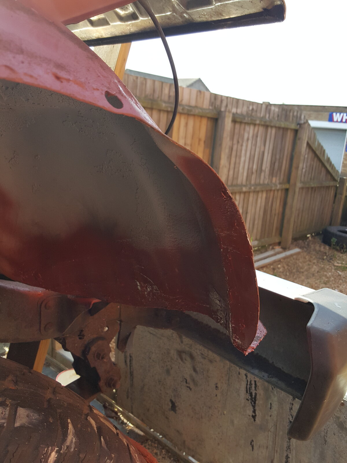

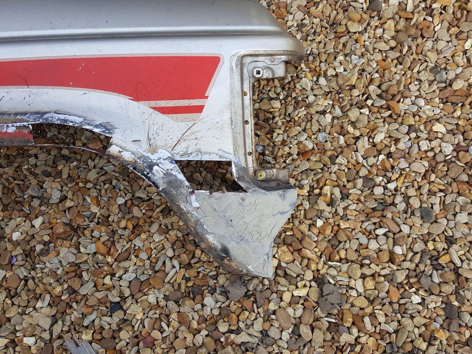

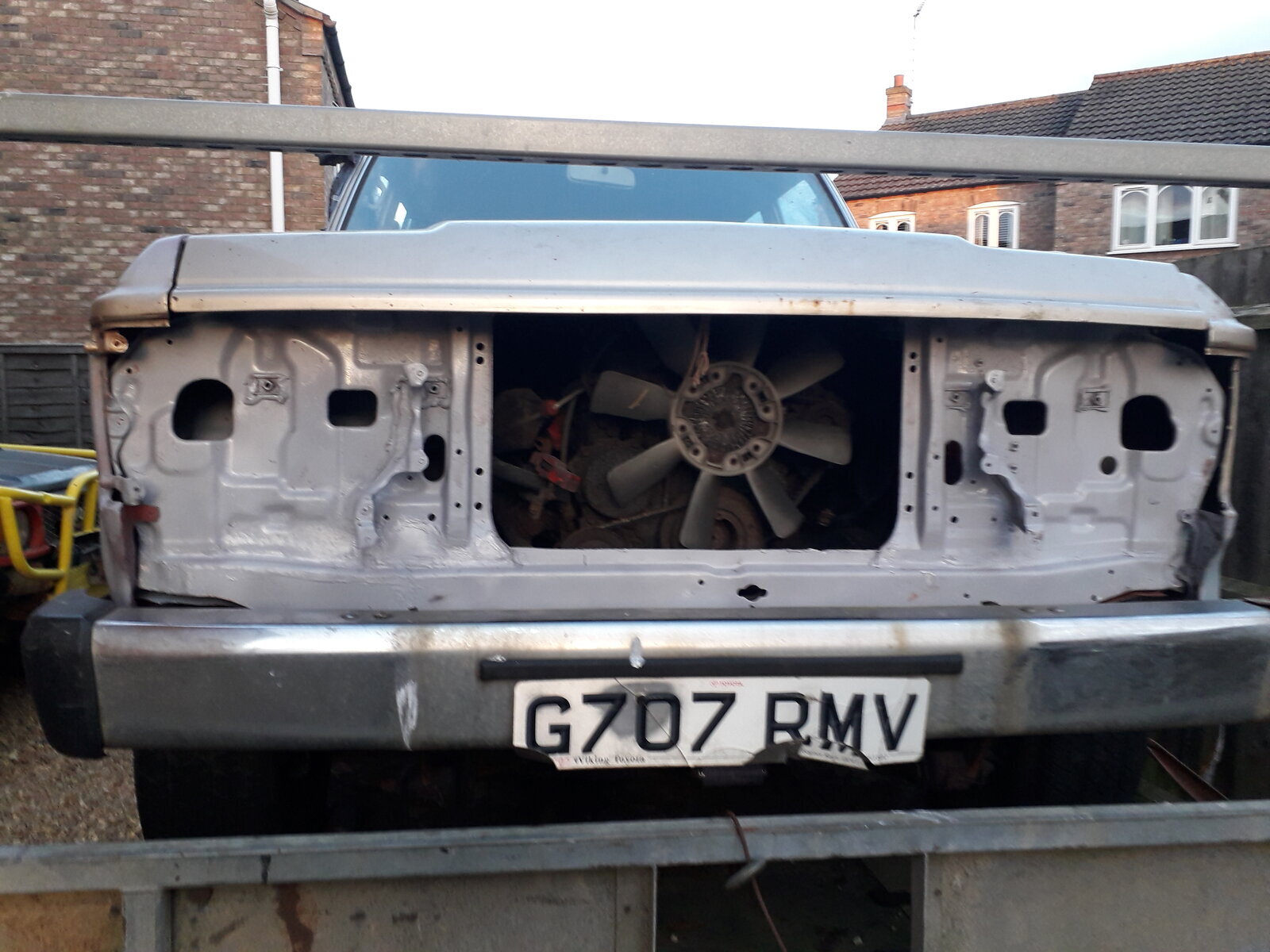

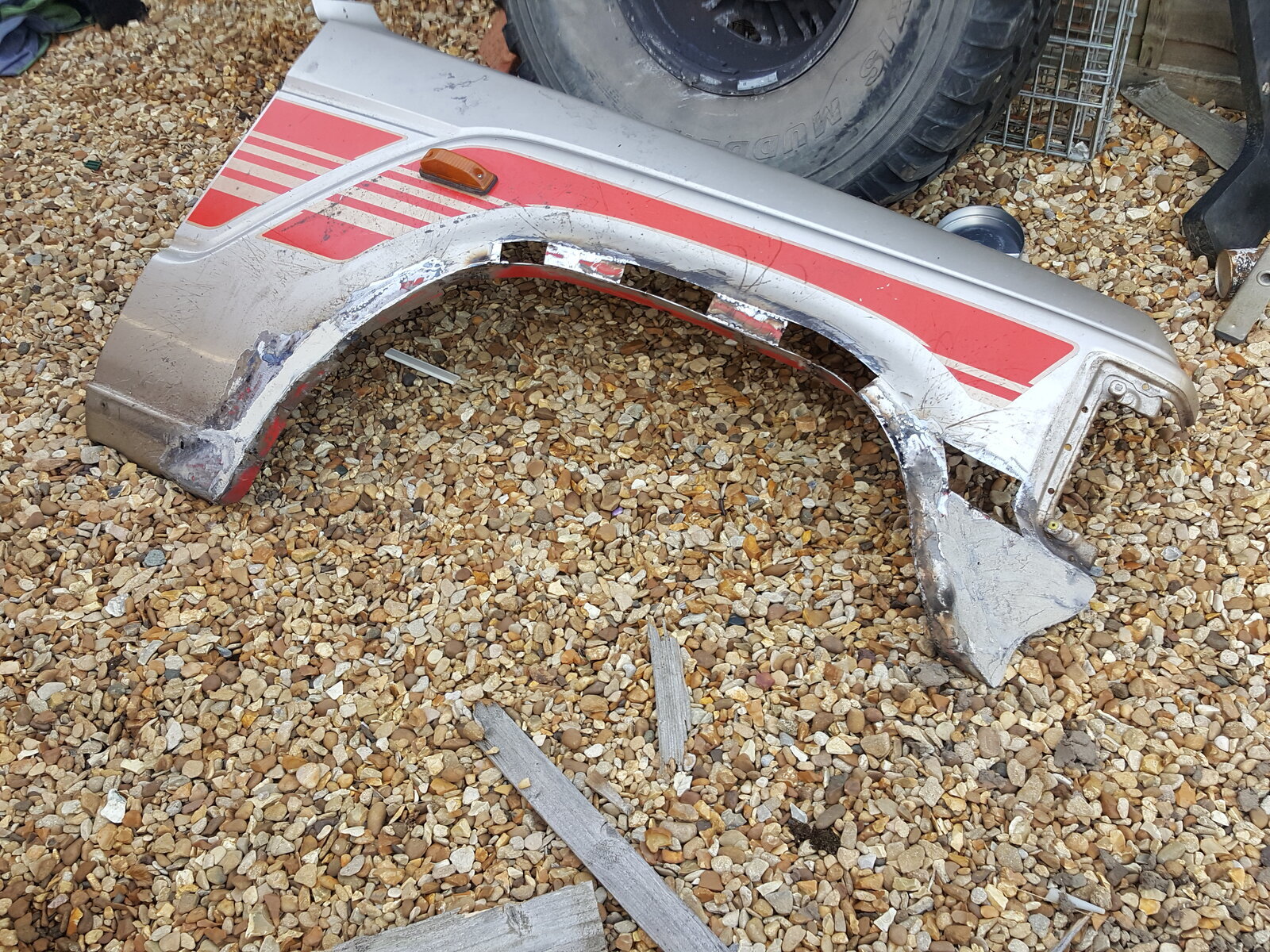

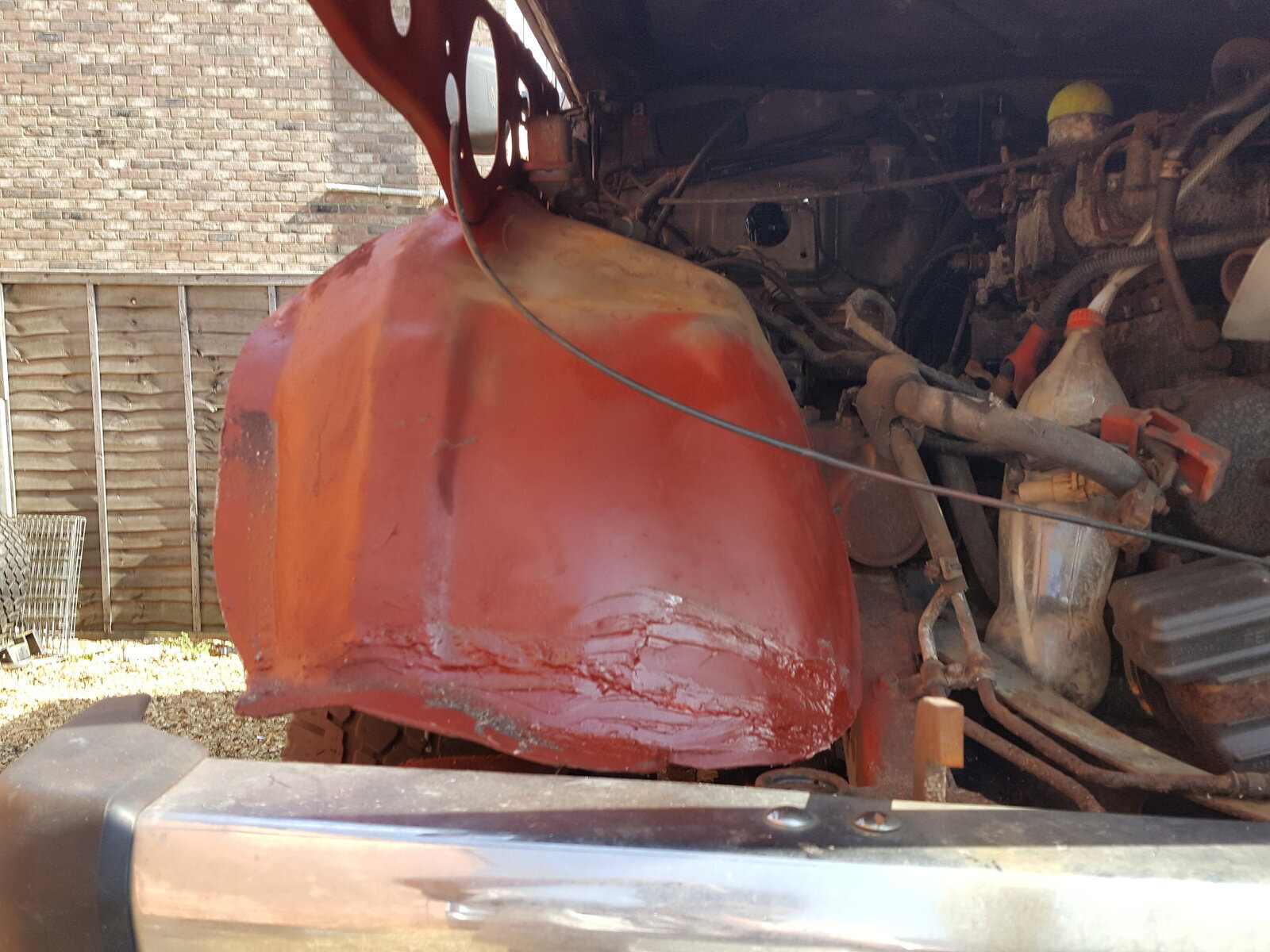

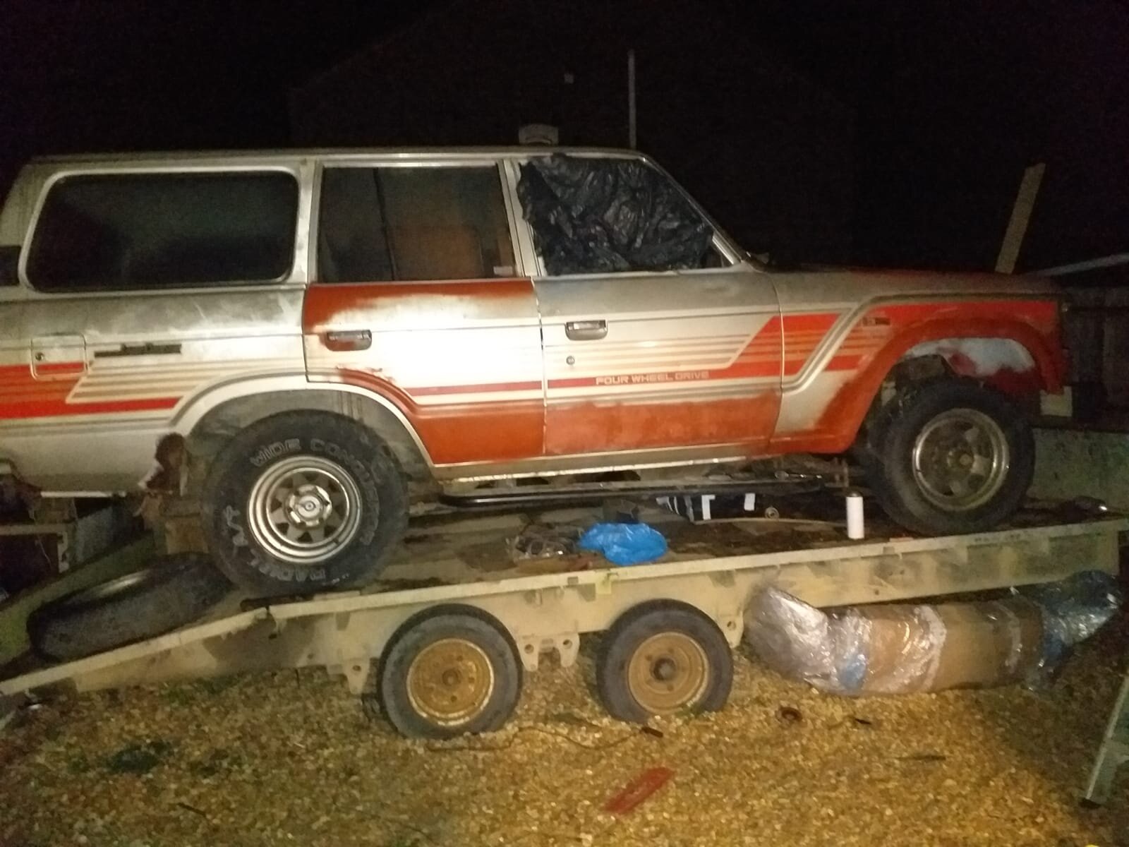

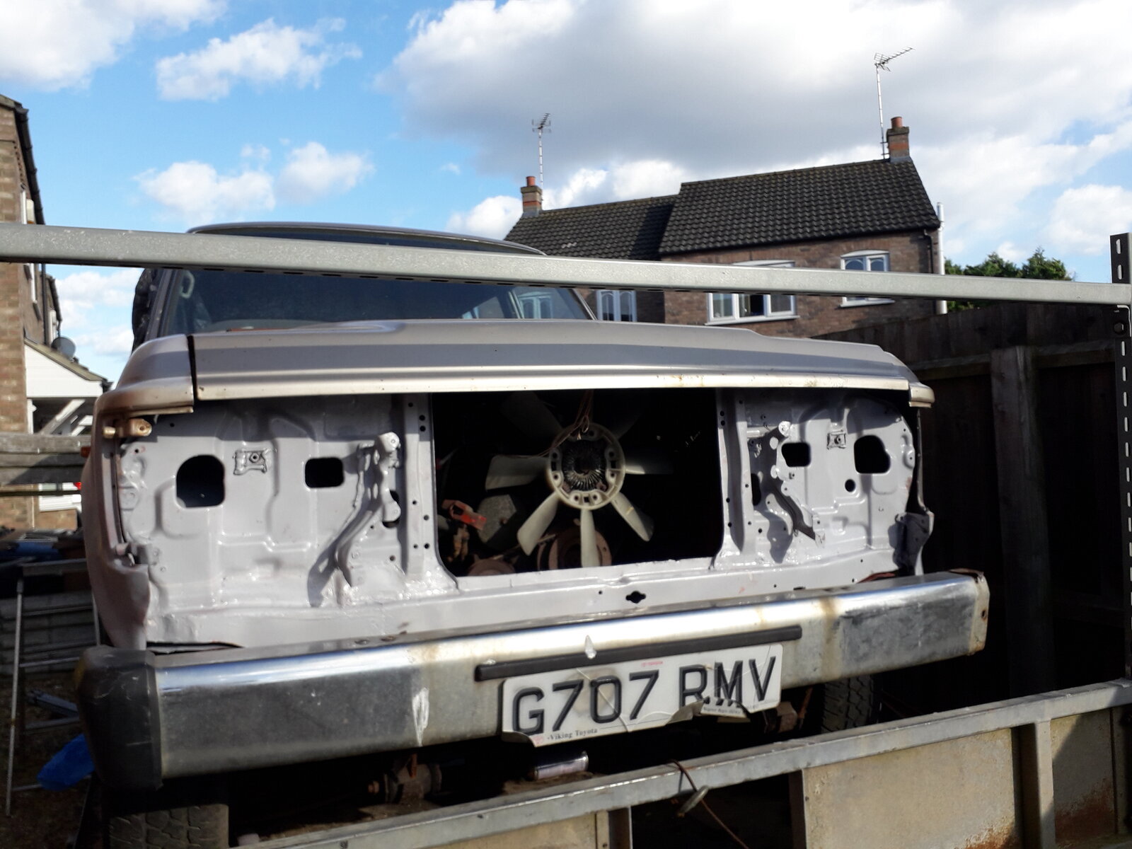

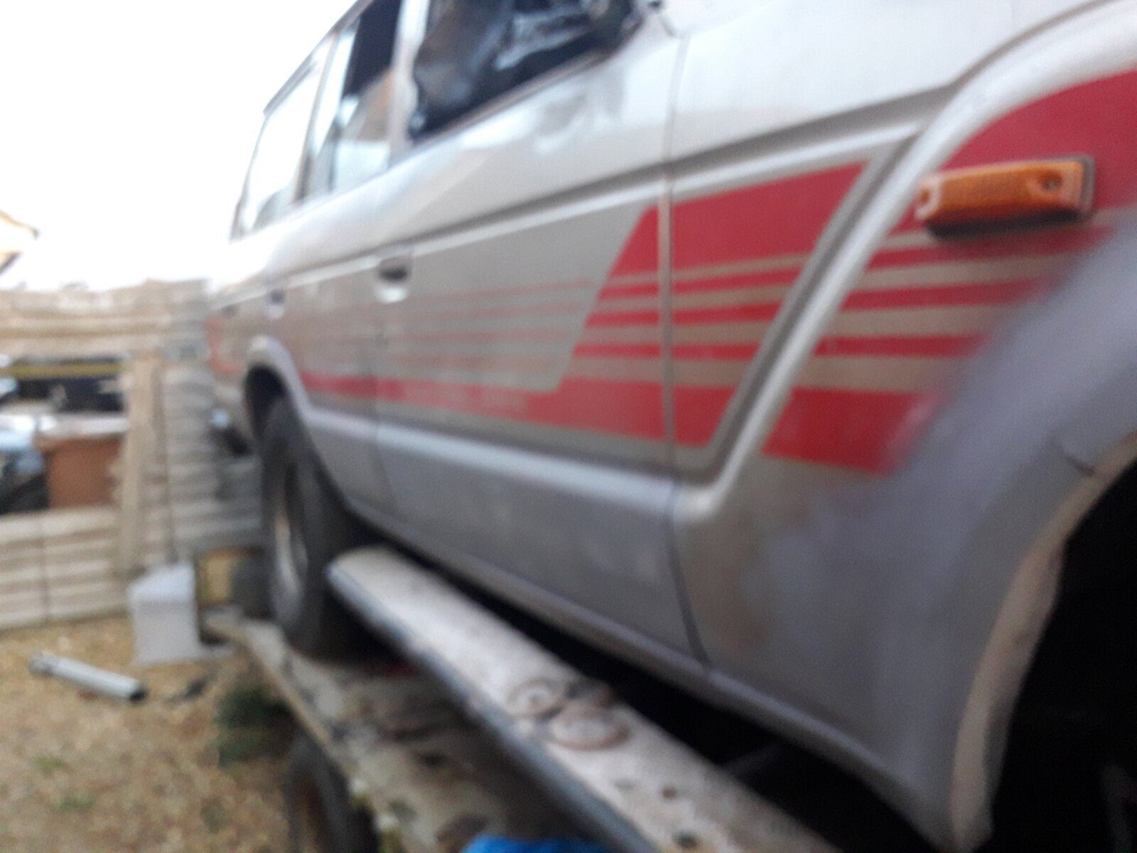

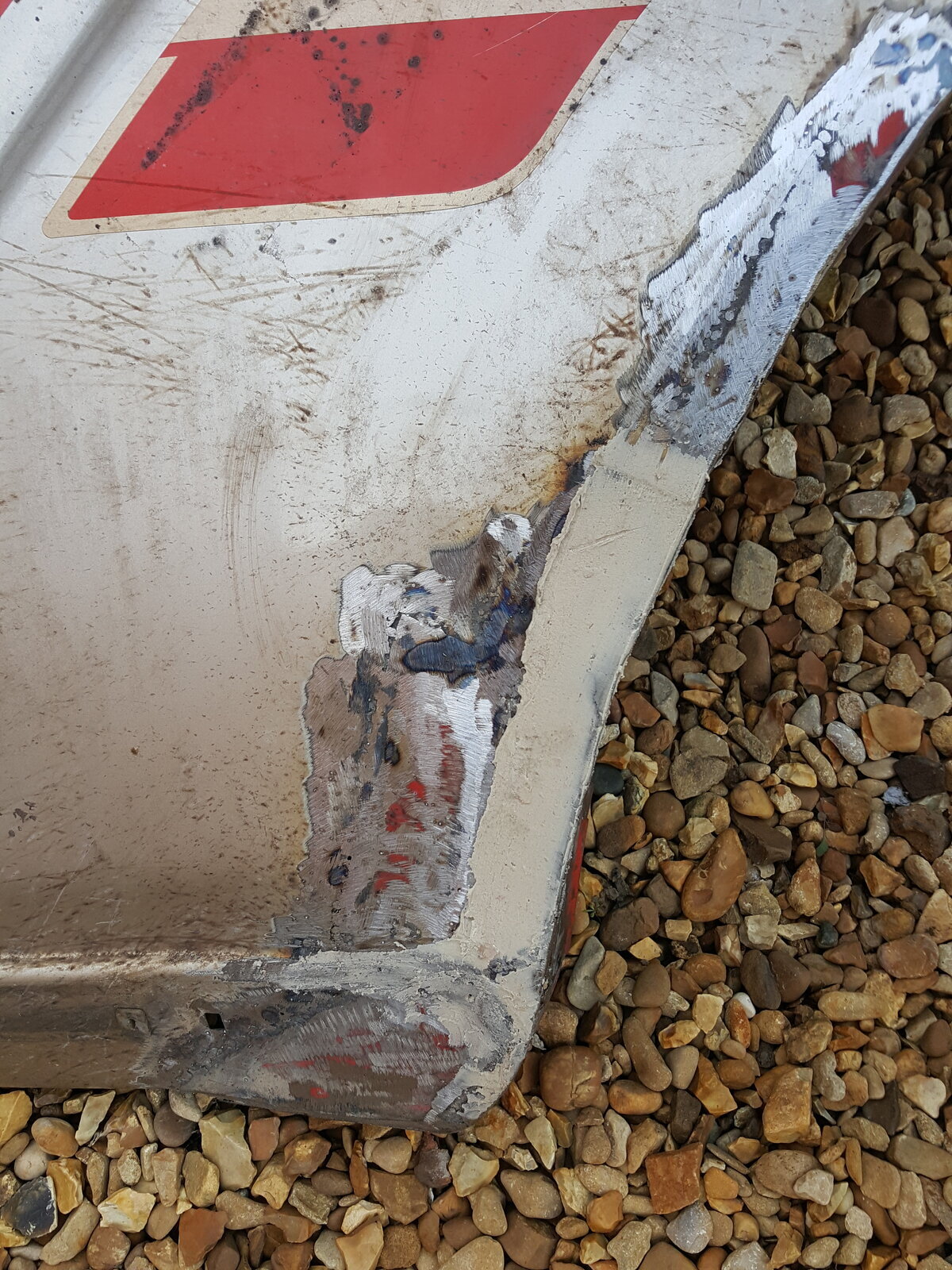

Well 8 hour's of cutting grinding and welding and the drivers side wing the worst of the two is almost done. Whole front section from the light down all the arch lip and bottom edge of wing and the bottom of the wing where it meets the cill were all but dust. Made paper profiles and lots of measuring from the better drivers wing and it's just about saved. Waiting for more metal to be delivered Tuesday. Got desperate to get on so cut up an old welder cover to keep going. Started to skim with filler before realising it seems to have gone off. Enjoying this. For a boxy old truck the wings have some tricky curves to try and replicate. It fits the front balance so cant be far out.
