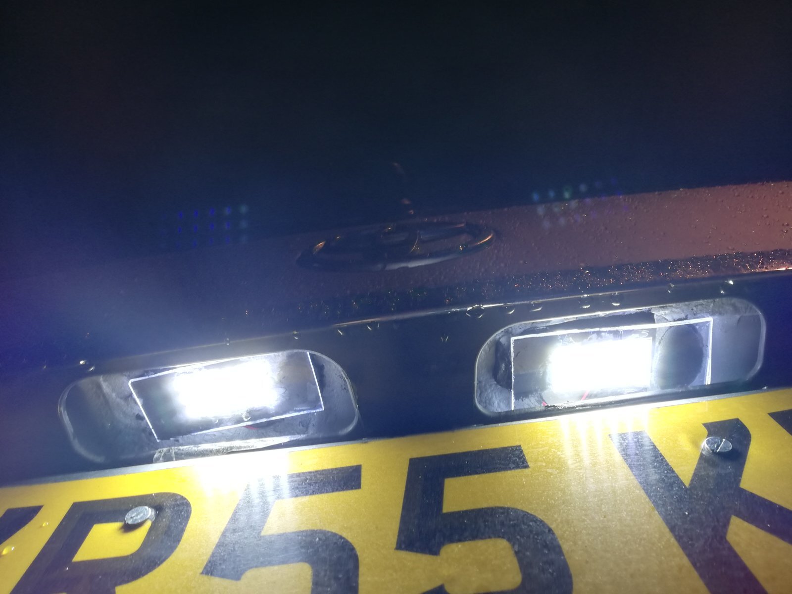

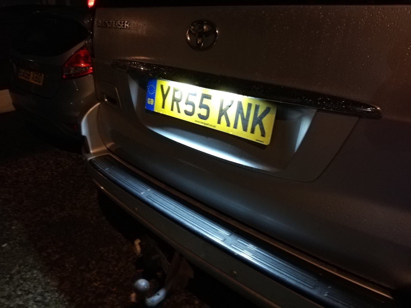

My latest upgrade is my number plate lights and door lights.
I have bought 5x18 led pads and clear perspex 6mm.
Taken my old number plate bulbs and holders out and replaced with my led ones and look cool.

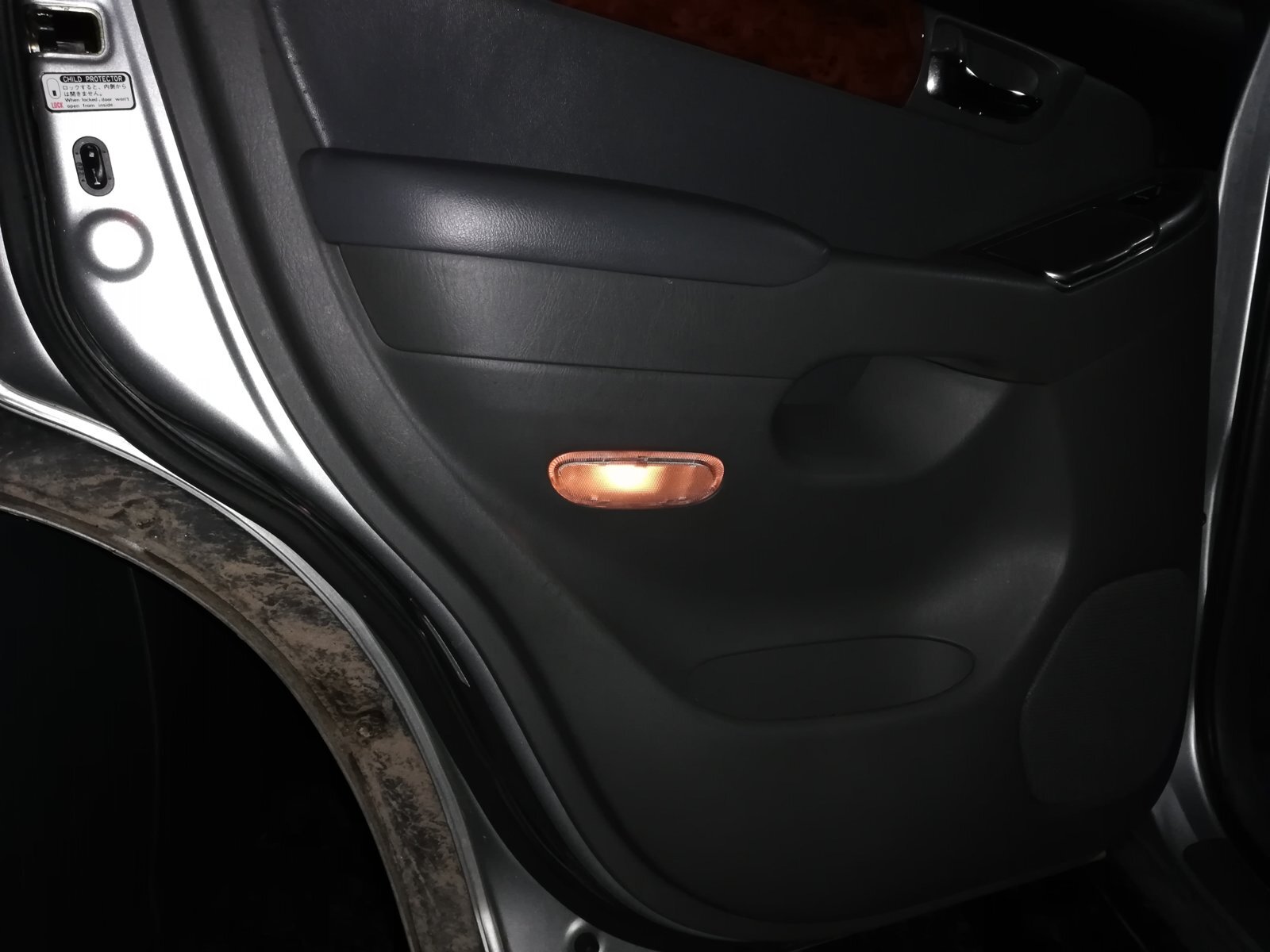

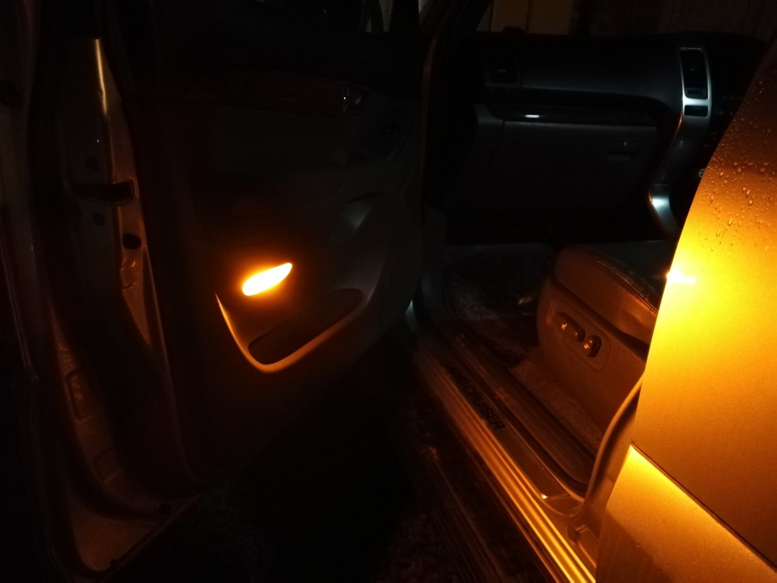

My door light upgrade is i bought 2x amber wedge bulbs 15w for my front side light just as an experiment but since you have to take the front bumper off to remove the headlight components just not got round to it.
I removed the door light components and removed the glass to remove the wedge bulb.
You will need pliers or something to remove the bulbs as very tight fit.
I replaced with 15w amber wedge bulb and wow what a difference it makes as so bright and looks cool (just my opinion anyway ).

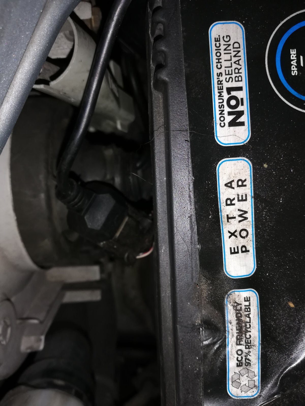

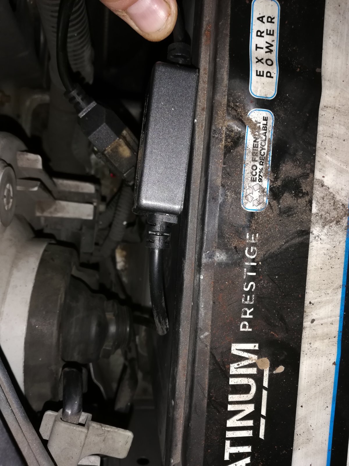

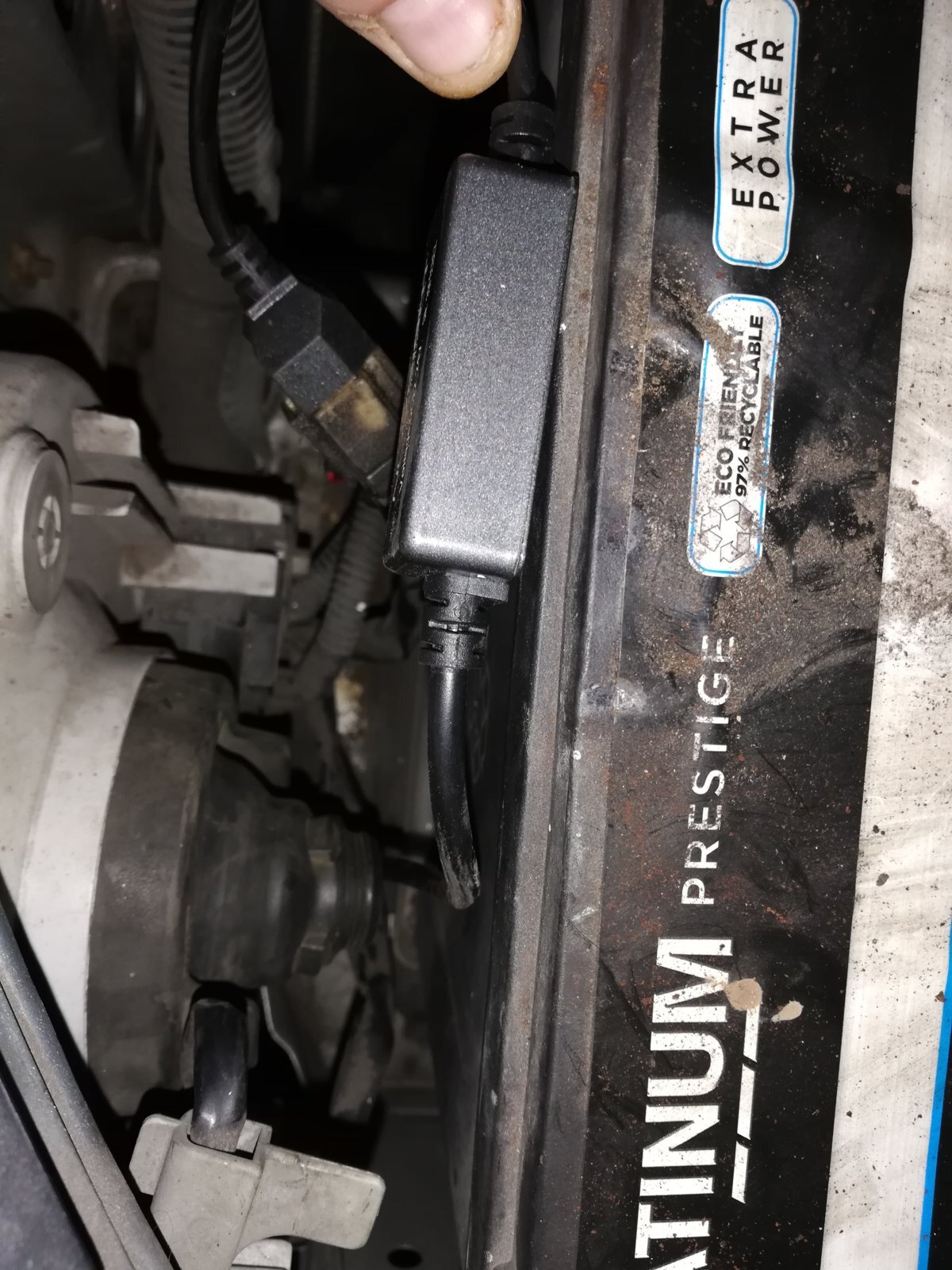

I changed my fog lights to LED after I did the headlights , I got some cheap ones on ebay that cost about £2 each and after a few days they started to flicker whilst driving as did the LED side lights and led number plate lights and smelled of disinfectant like TCP , so I changed them to Samsung LED 15w Hb4 fog lights and Samsung side lights and interior and door leds , have had no probs with these and are much brighter than the cheap one that I fitted .
tony rodaway
I am in uk
Aug 28, 2016
406
115
43
liverpool

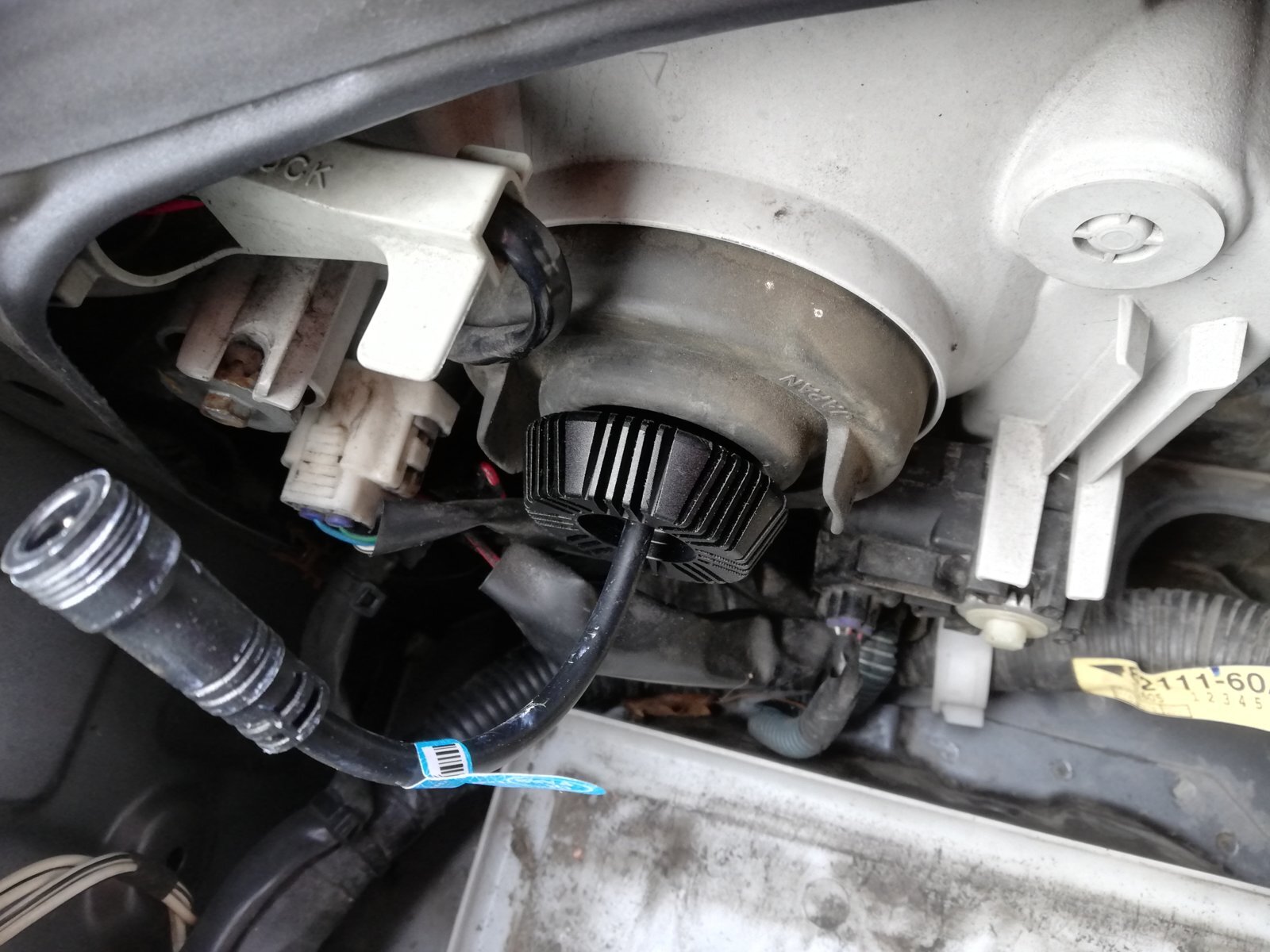

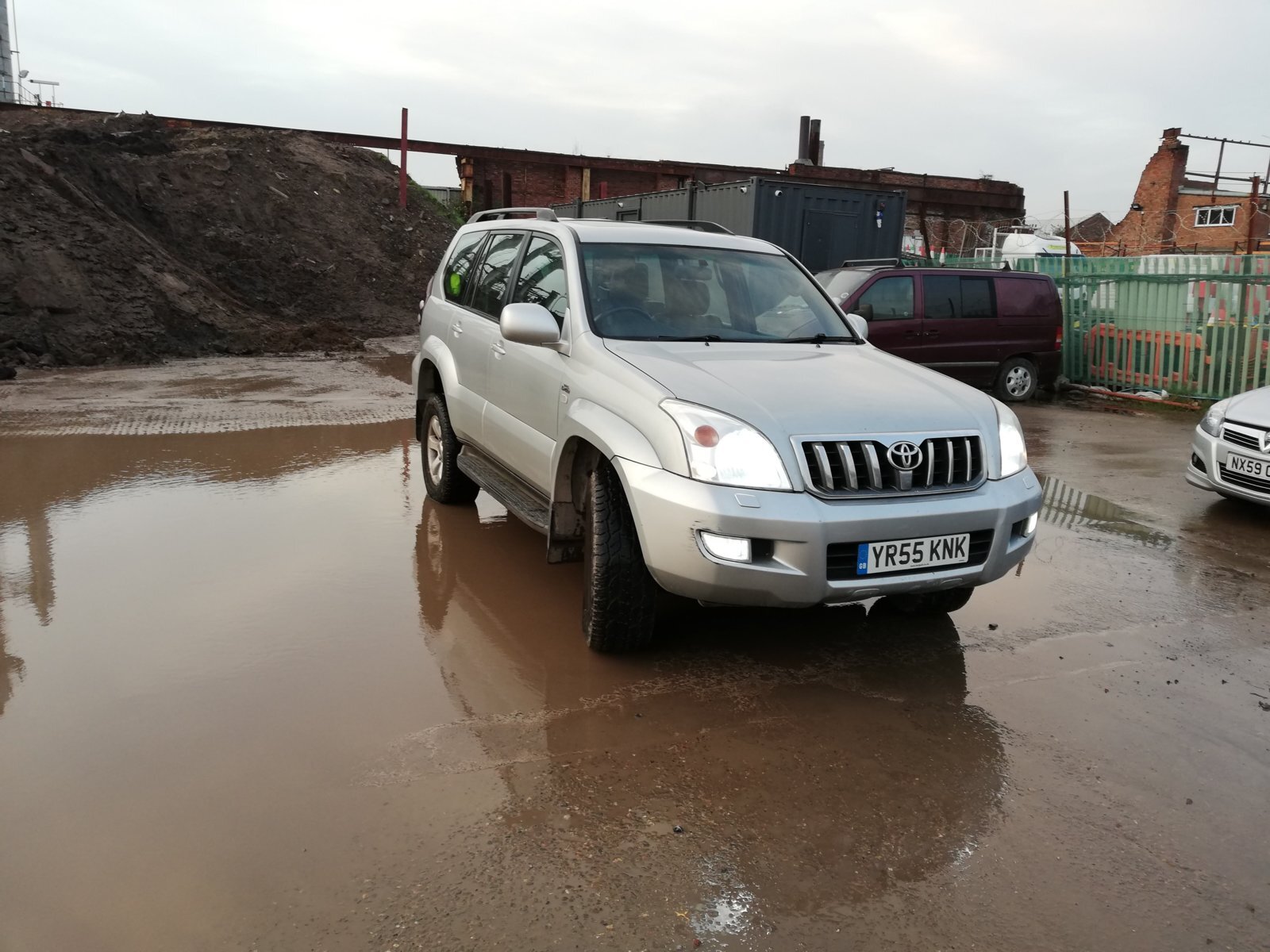

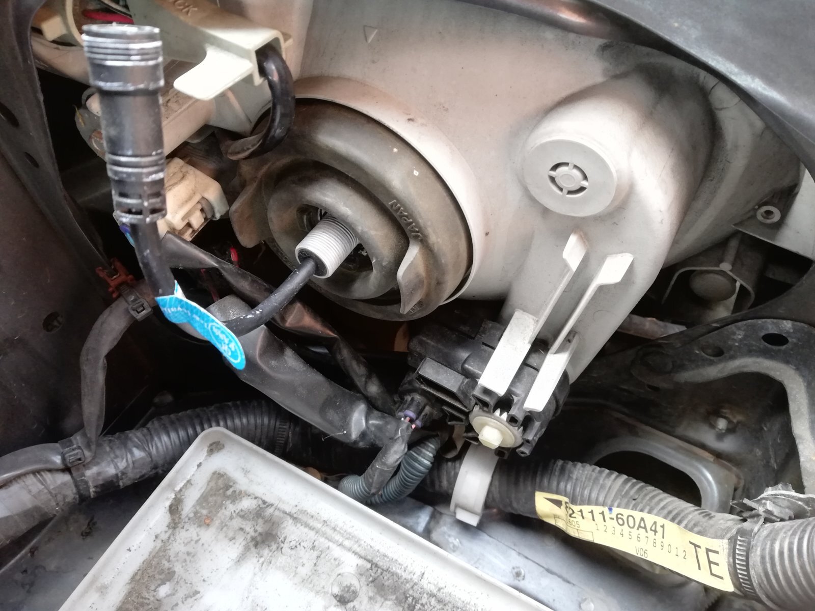

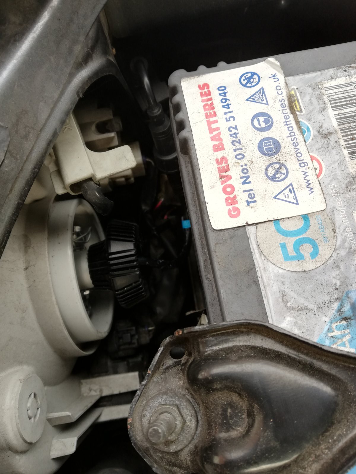

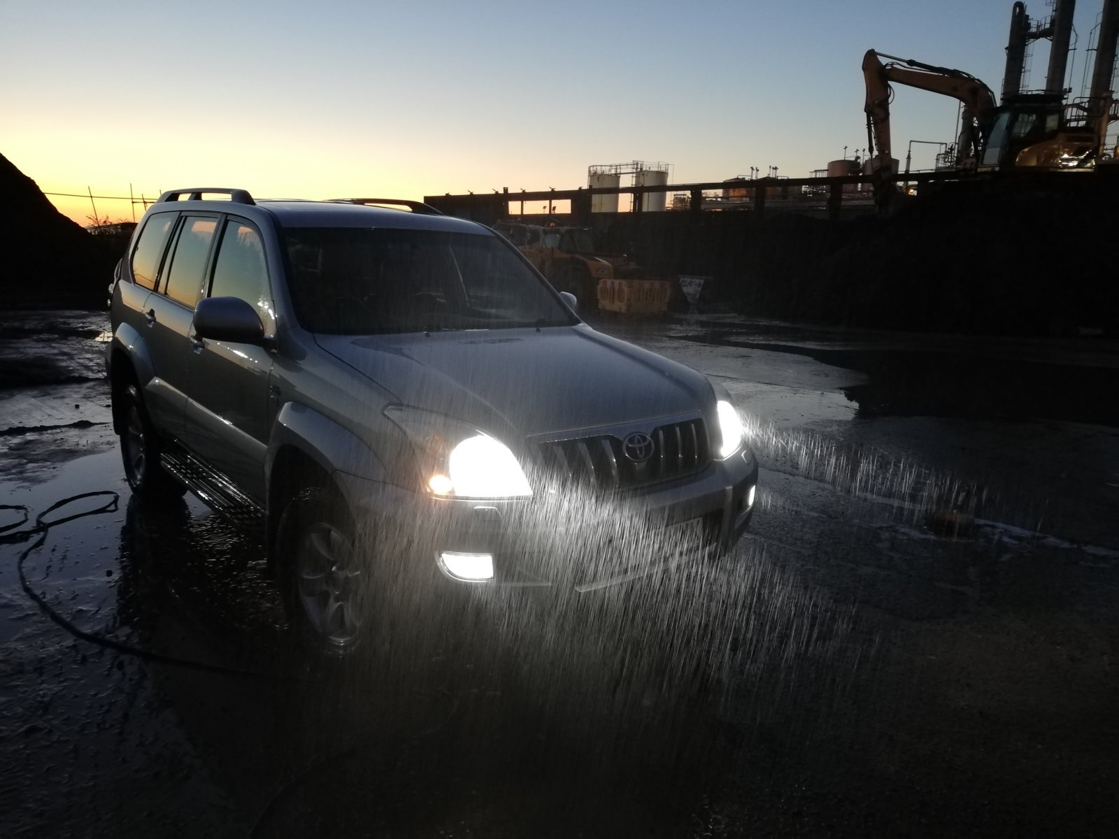

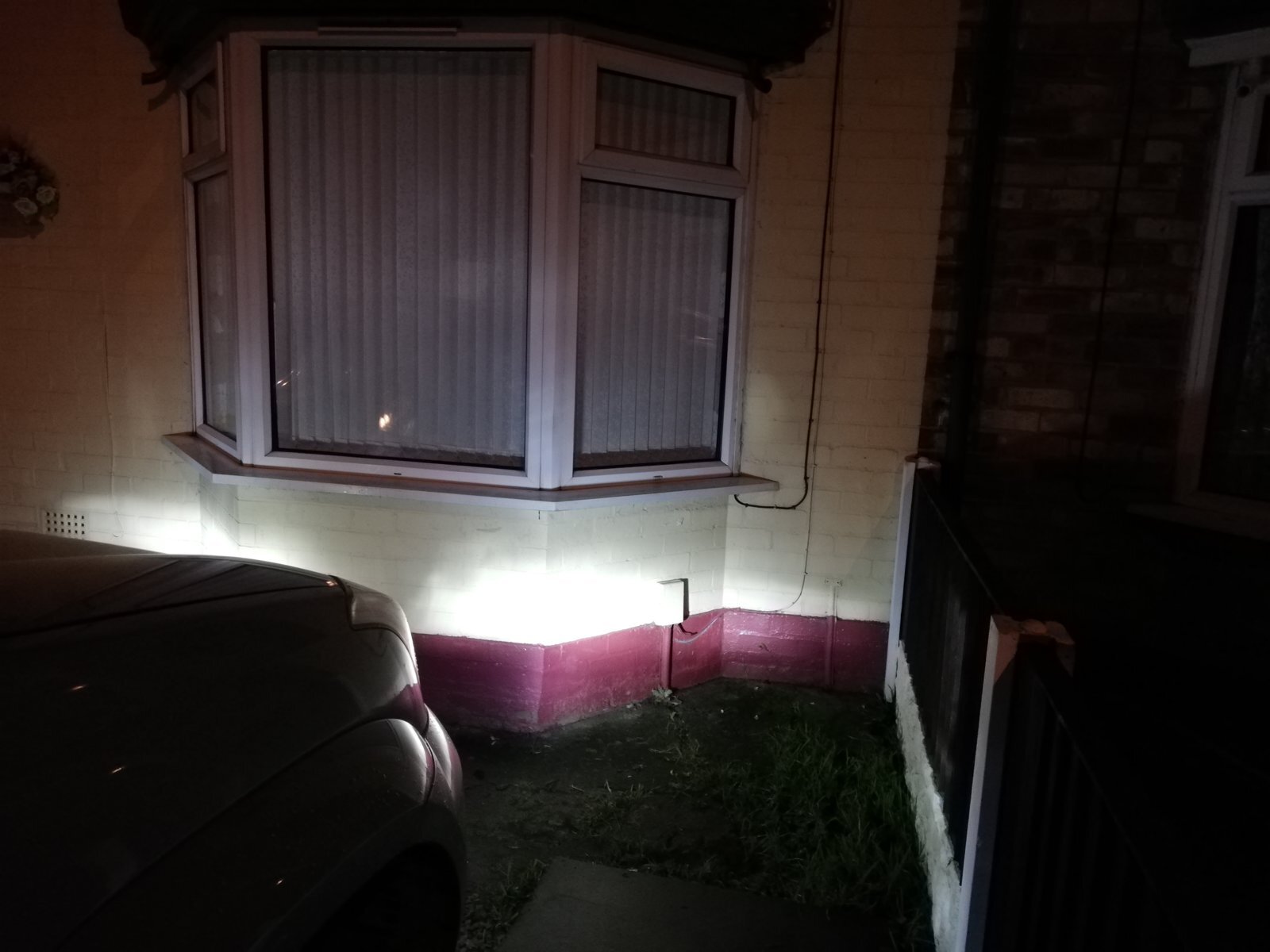

Will show some pictures of my new led lights with fan assistant headlights and fog lights both 6500k.
Headlights are 10000lms
Big difference to stock halogen bulbs.

My headlights are fan assisted and the water cover fits back over perfectly.

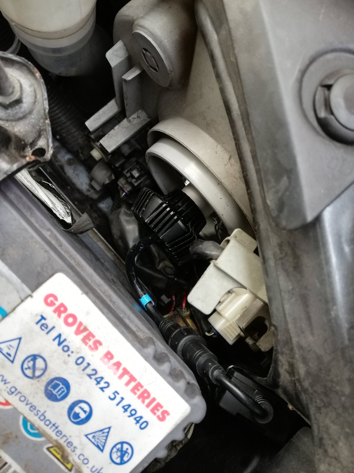

ive swapped out the old headlight bulbs for LEDS successfully over the weekend, thing is as you can see, although i have plenty of room around the battery, i cant get the rubber boot fitted without it coming into contact with the led heat sink......would you say this was acceptable ? or not ? knowing the led's get hot/warm ? etc.
thanks

I cut the inner circle of my rubber boots so that the heat sink was not obstructed .

My led bulbs are a different shape and just feed the plug through the rubber grommet and resealed perfect fit no cutting.

tony rodaway
I am in uk
Aug 28, 2016
406
115
43
liverpool
thanks
View attachment 161672 View attachment 161673 View attachment 161674 View attachment 161675
Sorry about the picture quality as was dark and cold outside :openmouth::text-blondmoment:
