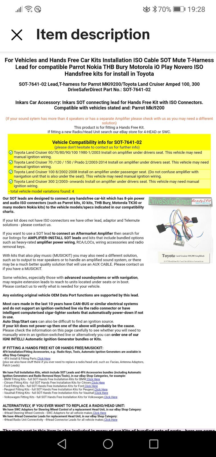

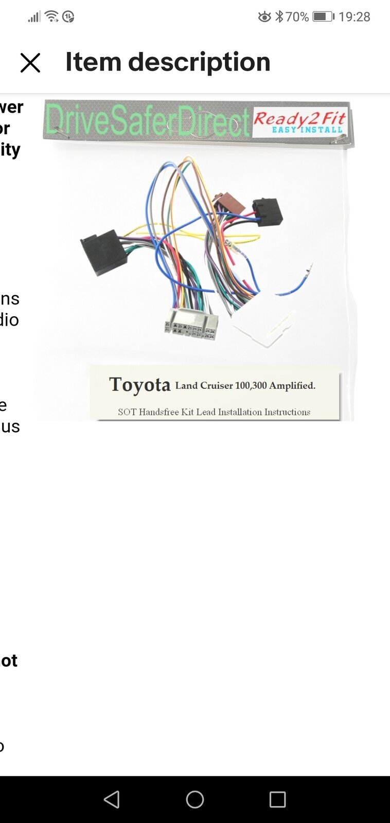

Sorry to be a pain but my parrot mki9200 just arrived today and was wondering how it fits.
I bought a harness for my car to fit my amplifier under the drivers seat.
I can access the amplifier plugs with out removing the seat but my harness only fits the plug nearest to the middle of the car is this correct.
The plug from the loom fits my harness but what else plugs into the harness. Will take pictures and send them to u if you wish and would be greatful if u can take a picture and send me it please as I'm confused.
Not sure I have the correct harness yet but I may have missed something out.
There are only 2 plugs that are in the amplifier are there any others under the seat I am missing.
Many thanks
Tony rodaway.
tony rodaway
I am in uk
Aug 28, 2016
406
115
43
liverpool
Many thanks
Tony rodaway.
The amplifier is under my passenger seat not my drivers seat as I said sorry.

I did not have to connect to anything under the seat, it all goes in behind the radio in the dash.
Mine is a LC4 though, but I know these have been installed into LC5's

As Tony said, a parrot kit goes behind your head unit. They come as standard with ISO audio and power block connectors, and often you need an adaptor harness for certain head units to convert them to ISO. (Almost all older gen aftermarket head units were ISO, not sure what's in the 120) other than that they are plug and play. I've installed dozens of these in everything from a Mini to a Range Rover.

That's interesting because the harness I bought for the 120 lc5 states its fits the amplifier under the passenger seat. The clips I have seen include pictures of the installation as he removes the passenger seat to fit the harness.

The lc5 has the amplifier under the seat and apparently the harness connects to the amplifier. I will find the link and show you. Hence why I'm confused.
