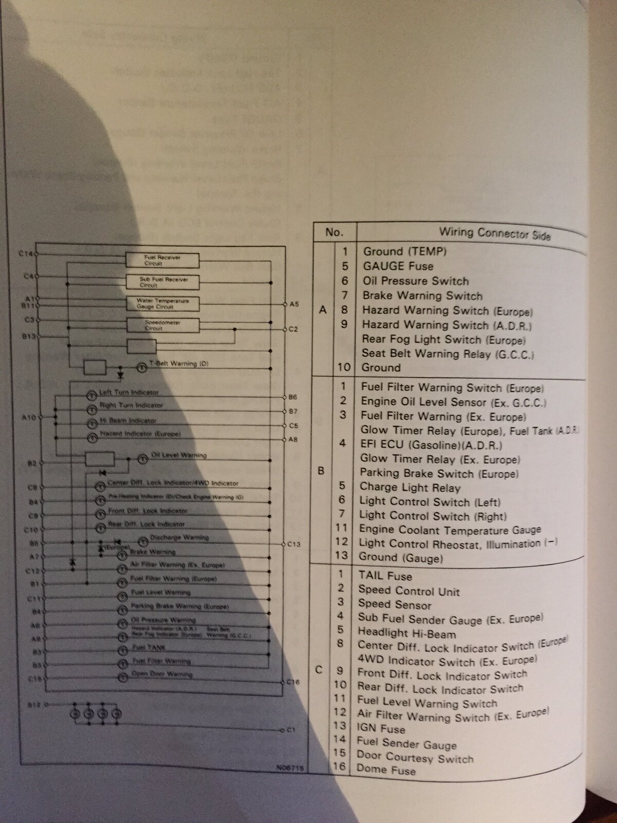

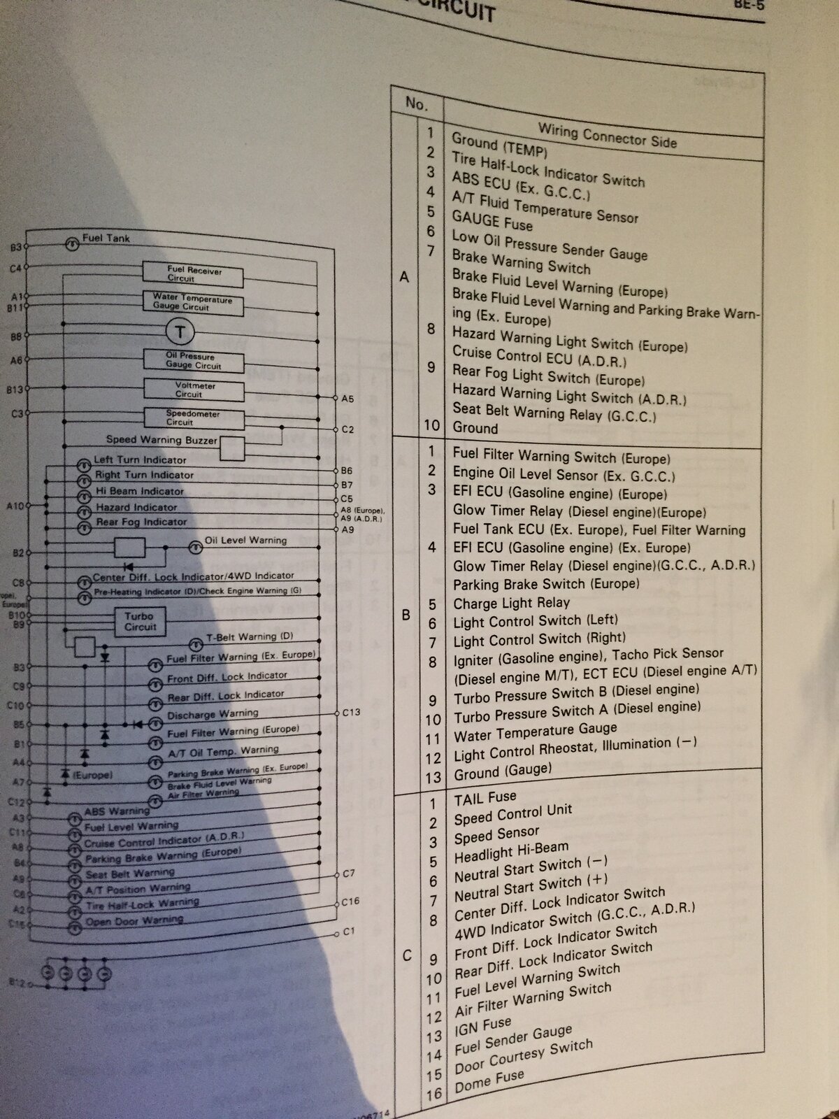

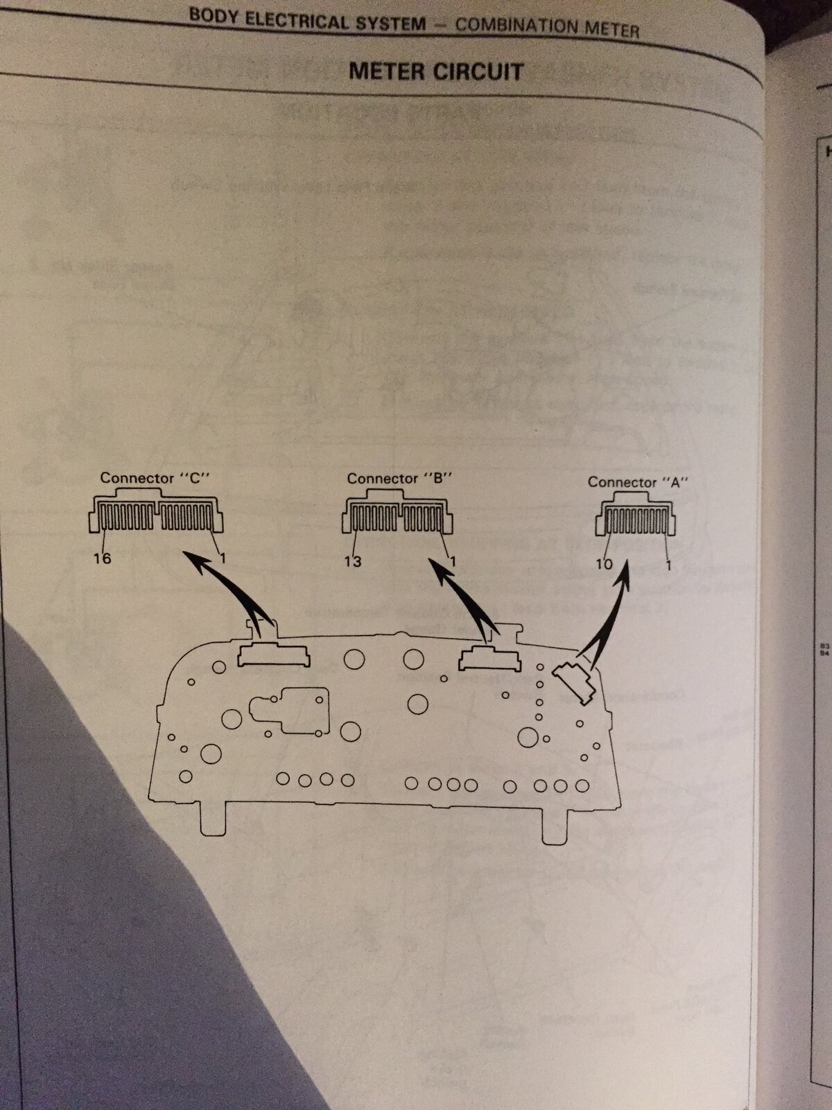

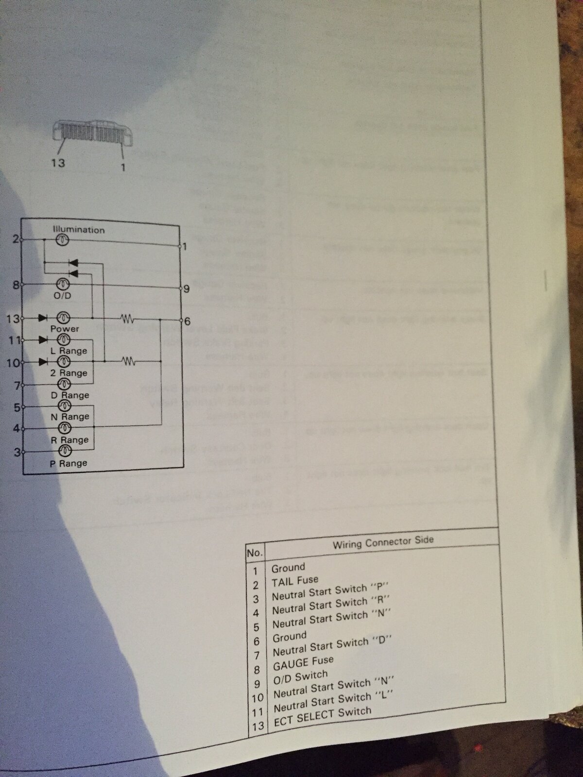

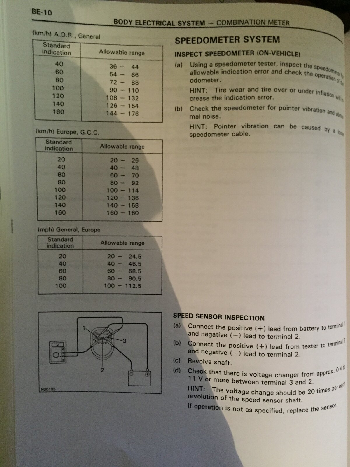

Anyone have a wiring diagram or the pin configurations for a HDJ79 (1HD-FTE) main instrument cluster?
Hoping to find the pin/wire with the speed signal OUTPUT to the ECU (I found the INPUT on green-orange).
