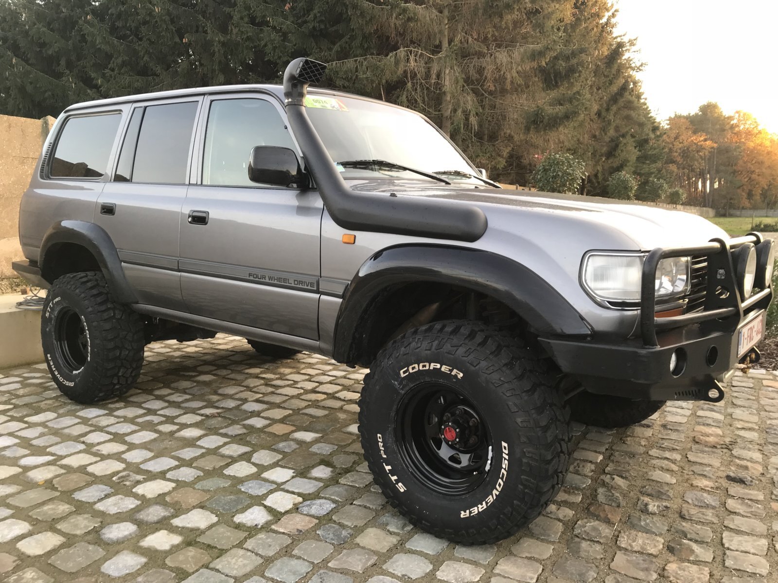

Here is a picture of how high mine sits.
It has sagged over the last months tough, i think it’s more of a 3” lift.
Rear OME863 +2” +200kg springs, they were much more than 2” but have settled a bit now ( my cargo space is empty and no rear seats)
Front are OME2419 competition +4” +50kg springs, but a bit more than weight than 50kg so they settled at a 3” lift i guess.
I’m not a great fan of the OME springs as I’ve had alot of them sag.
The pedders 4” will be what I try next if the OMEs sag any further.
15x10 won’t fit on hdj80 after 1993 because of the large calipers in the rear.
15x8 et-25 with 6mm spacer might jusr clear it, but 10 hits.
I fitted -44 16x10 from a mate and they stick out the arches a fair bit, too much for me, and I think they will hit the arches on the top. Also depend on how much you will lift it offcourse.
If you are like me and like the deep dish wide rim look with 35s I’d get these:
https://www.4x4tyres.co.uk/16-tuff-torque-modular-steel-black_s16613932blkmod
-32 offset instead of -44 or -50 so they wont stick out too much and still are 10” wide.
