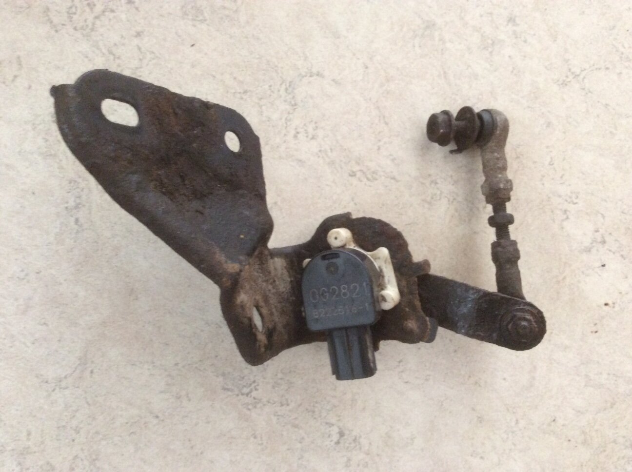

Anyone had this problem?
Getting flashed at night by other drivers. I noticed that both dipped beams were bouncing up and down - very noticeable when parked nose-on to a wall. They were both bouncing up and down in unison so not the motors.
Shortly after that I started getting an AFS error light on the dash (auto front lighting system - swivels the beams L or R as you corner). I suspect the 2 systems are linked, and the levelling fault gives AFS indication.
After finally getting the seized bolts out of the bracket i removed the headlight level sensor (just forward of the back axle RHS) but now can't get the arm off the potentiometer shaft (also seized). Pretty sure the pot is screwed as the shaft rotates thru 360 very freely.
So - anyone know where I can get a replacement, without resorting to Mr T?
